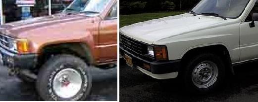

Does anyone know if there is any difference between 2WD and 4WD 1984 to 1988 Toyota Pickup front fenders? JC whitney says the 2WD and 4WD fenders are different and I can't think how they would be...

They are not the same.. any 2wd or 4wd fender can mount on either a 2wd or 4wd truck... the 2wd fenders are actually a lot flatter, and the 4wd fender bulges out more with an aggresive look.

Yep, Nix Toy is dead on - they are vastly different looking, but can be interchanged just fine. The corner lights are different too, so if you change the fenders get the lights.

truck fenders and runner fenders are the same.

84-88 4wd pickup and 84-89 4runner share the same front fenders.
i think both corners are the same (2wd vs 4wd) the next generation they changed...
