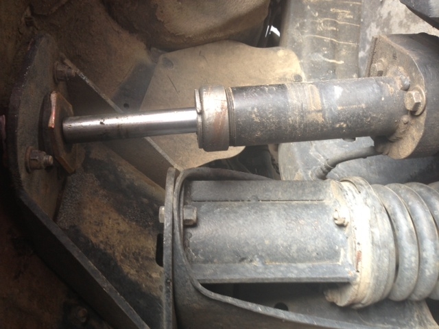

Can anyone identify this lift, it is on a 1996 toyota tacoma. I need to replace the hyd cyl in the photo but jhave no idea the manufacturer of the lift. Thank you.

that lift looks so ghetto and skectchy...

So this kit gets rid of the upper arm and puts a strut in? Seems pretty silly.

I think that is old school Trail Master. This is what they before the balljoint spacers that failed. Your best bet is to buy a new 5-6" lift and use upper control arms.

cant believe that ˟˟˟˟ removed the upper a-arm. so sketch. these threads pop up every year. same lift. lol.
