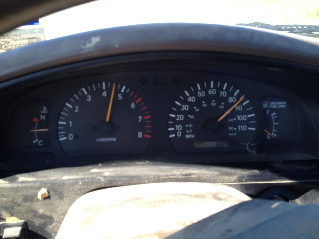

If it's steady, I wouldn't worry about it. 204 isn't bad.
Here's what mine sits at.. And that was me pushing it on a 60* day.

@scuba, dude put some gas in that poor truck.
Gas gauge doesn't work. I still had ~3/4 a tank when I took that picture.
