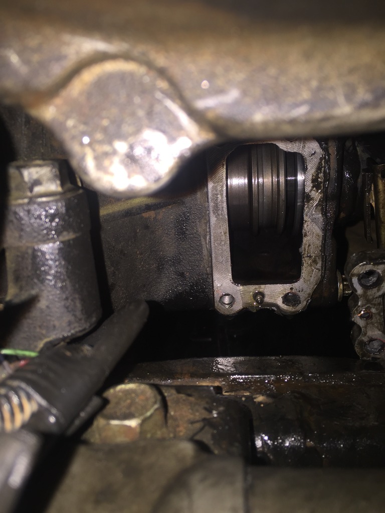

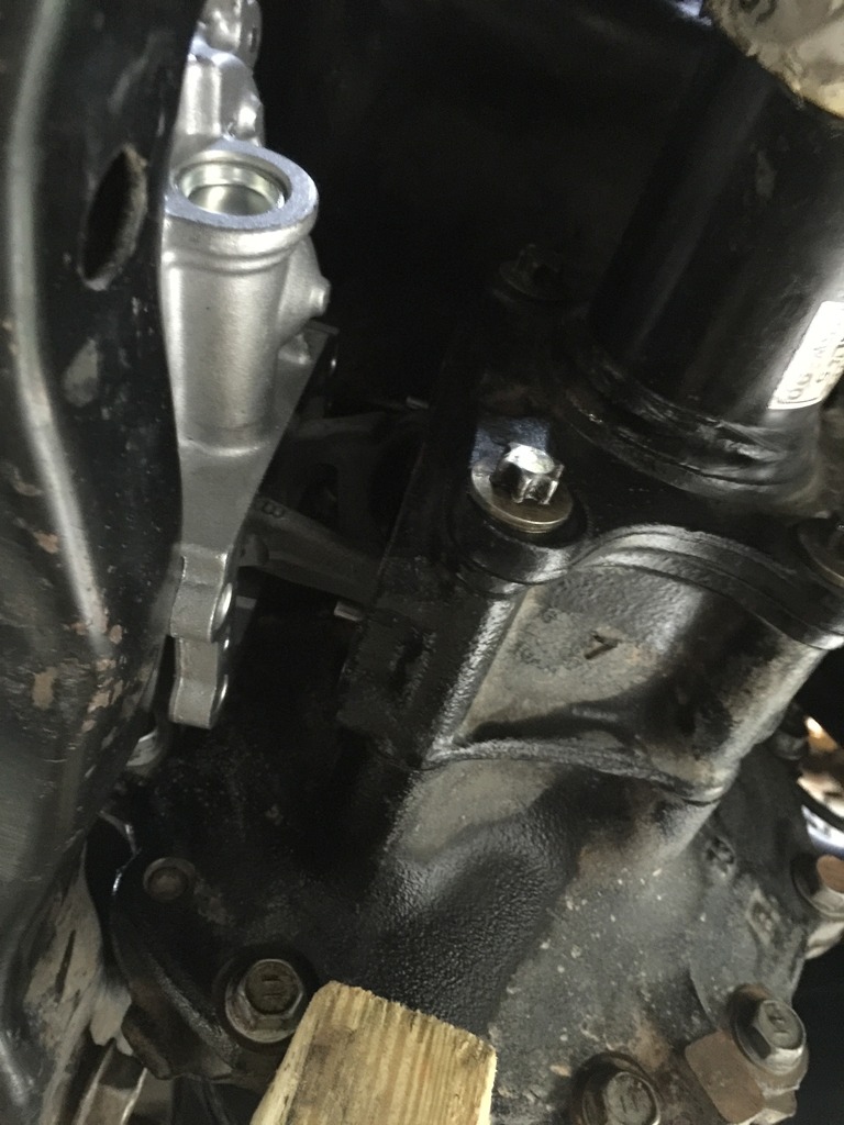

I did.
It ended up being the switch inside the Front Differential Actuator. I simply ordered a new one from ebay - use this search and find one there (http://www.ebay.com/sch/i.html?&_fro...tor%20Assembly)
I loosened up the Front Differential Mount Bolts then let it sag, unbolted the actuator from the diff. You're going to have to be patient and find just the right way for it to come out, it will though. Clean the mounting surfaces, put some black RTV on the surfaces and bolt the new one it. Easy fix - shouldn't take more than 1-2 hours.

You can "benchcheck" the old and new front actuator by pulling the slack in the harness down a little bit and plugging an actuator in.
Turn the truck to the "on" position, no need to actually start it.
Push the AWD button and see if the fork moves left to right
