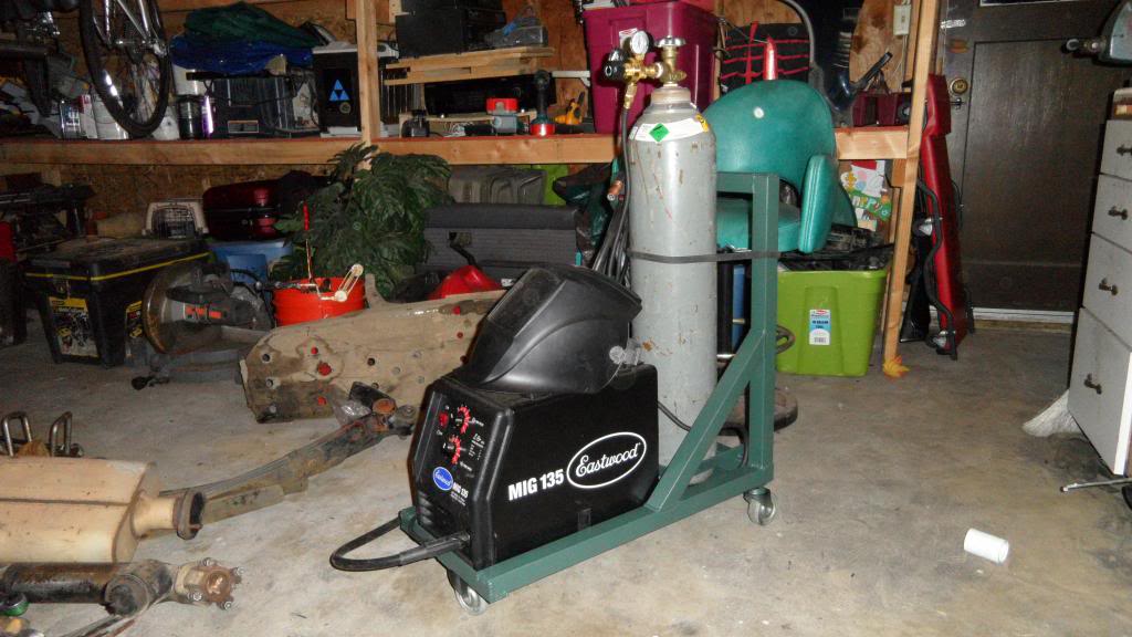

Ohh but i did finish my nice little welding cart now everything is tidy and stable!

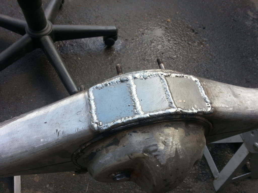

So first thing i did was clean up my axle and shave the bottom with 1/4" plate

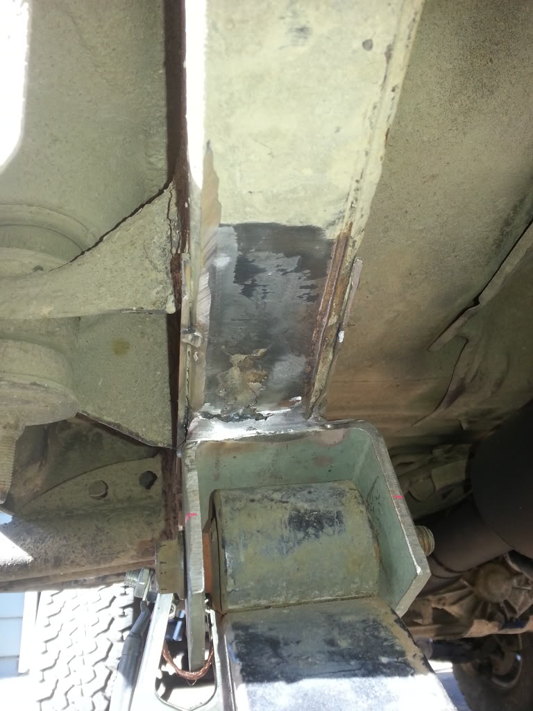

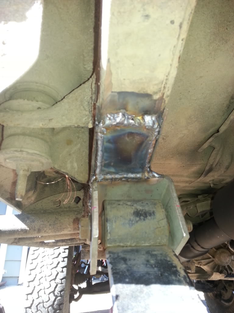

But as im sure you all have experienced, there is rust in the most unfortunate of places... Like the middle of your frame right next to where your new leaf spring mounts go!
But i just plated over that with a nice clean weld

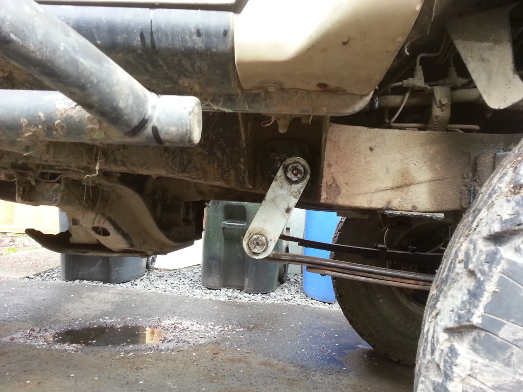

Everything is tacked up and i tested the location and shackle angle till i got one i liked.

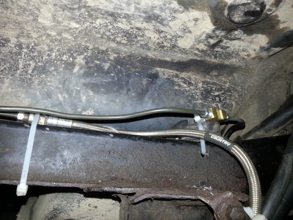

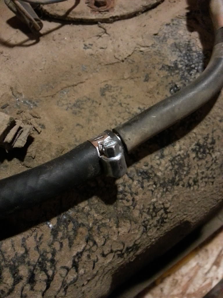

Next i had to fix a broken fuel line issue, so i made a cute little jumper soft line

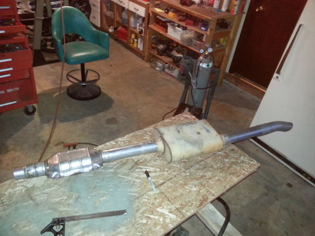

I then proceeded to mock up my new exhaust with the 2.5" flowmaster that i got from the junkyard! So i bought a new cat and got 2' of tubing and an adapter from autozone and taaadaaa!

I also painted it with a nice coat or two of matte black header paint to keep it pretty from all the muck.

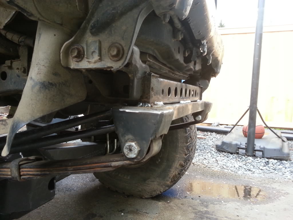

Next i made an extension to my LSPV arm and welded that to the axle to help my brakes work and went for a drive.
In that last picture you can see my nice extender and shackle angle.
Flexes WAAAAAY better than the stock links (;

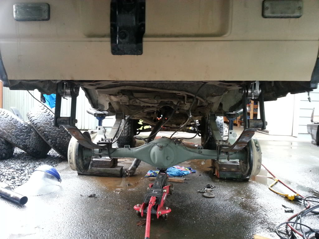

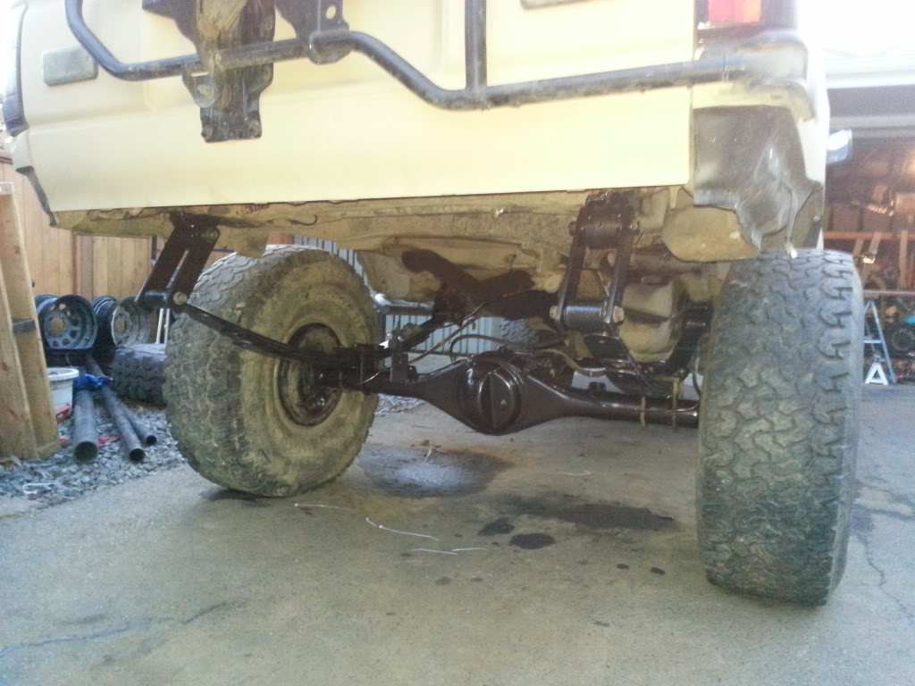

This set up is a wheel base stretch, with an f150 3pack, minus overload and i added the bottom most leaf out of a tundra pack. Has a nice lift for 35's or 36's, i just have to trim for the bigger tires
Unfortunately, i went to mount my bilstein 12's aaaaaaand, the damn LSPV is in the way!
So i did some research and turns out that due to toyota's sucky rear drums, it isnt necessary to limit the volume of brake fluid to the rear brakes at all! especially with bigger tires. What this means is i went to auto zone and picked up a brass Tee fitting and just looped the three lines that go into the LSPV together.

Now i cut a new crossmember out of 1.75" .120 and welded some upper shock mounts to it. Im going to use my buddies plasma cutter again to cut out the cross member that the LSPV was originally mounted to to make room for my new crossmember.

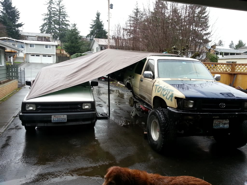

Well i couldnt have done any of this without the help of my loyal dog Bentley, he spends every day with me! Rain or shine!
and trust me.. It does rain in Washington!!

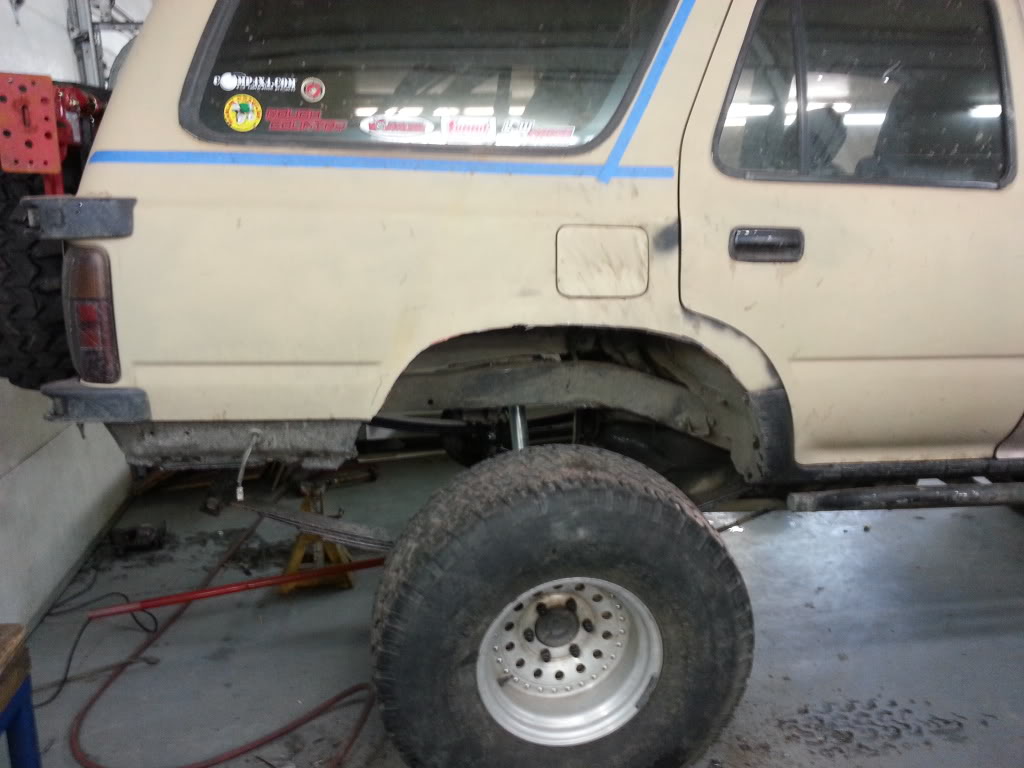

I did get around to trimming the wheel wells as you can see,

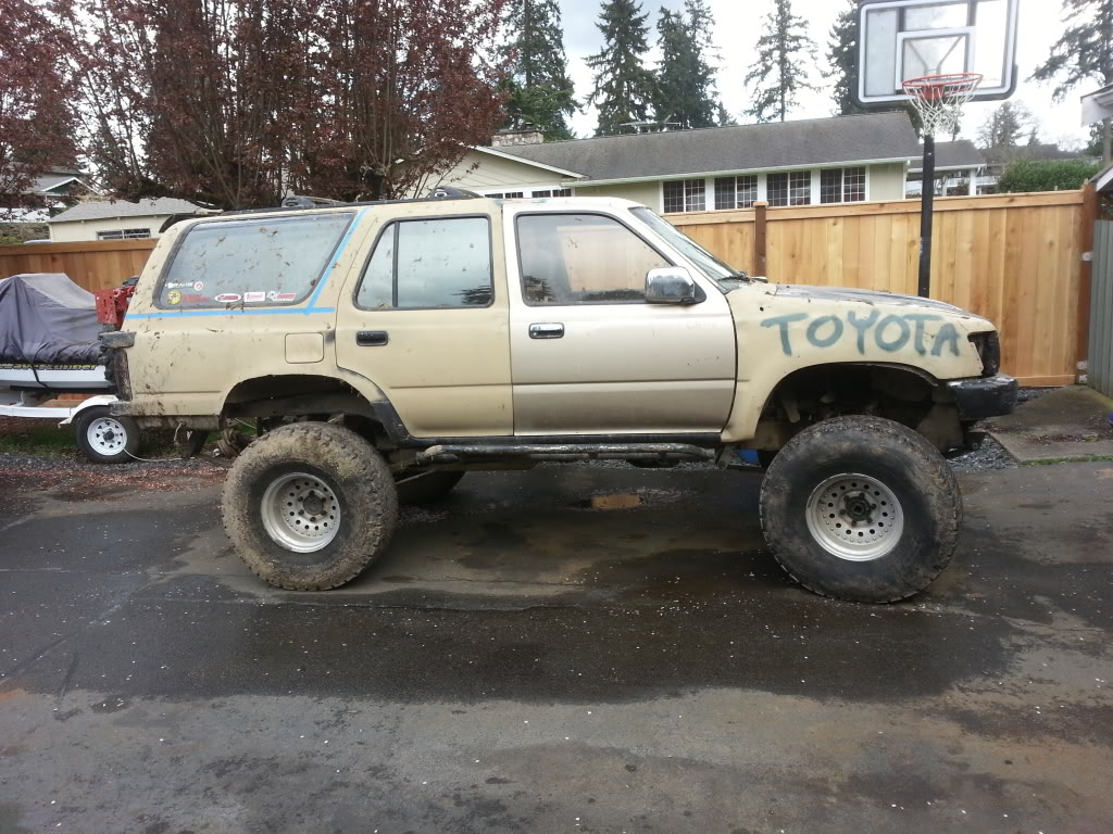

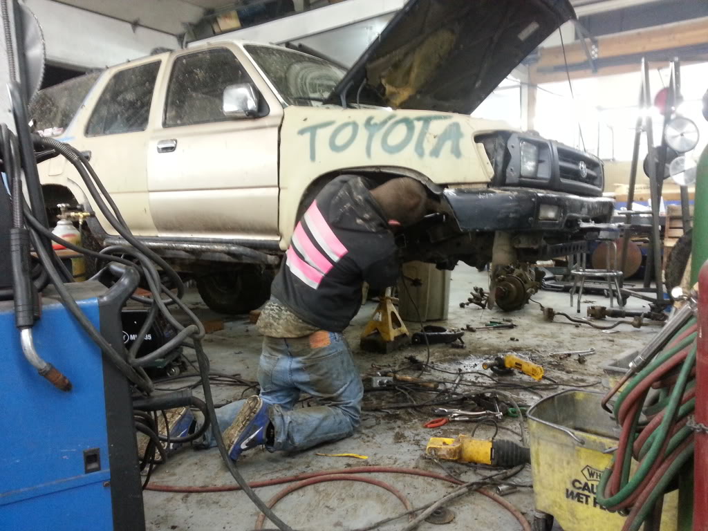

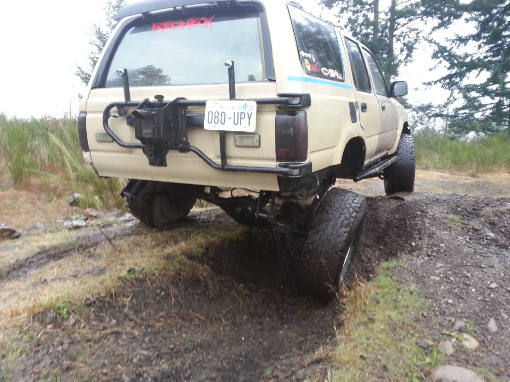

Yuppers! I'm sure you all guessed right, you know its a big project when i share a picture of my buddies undies with all of you kind people!
Got the yota back in my buddies shop! The scenario we had was this:
I had just gotten home its about 10, my truck has been sitting at his house and i have a garage full of parts. I'm feeling a bit energetic, so i load up my 2wd B2200 and bottom out the springs!
The next logical step, before calling Ryker is to head up to McChev and buy 4 redbulls to accompany me on this long night.
Now i show up at his house and explain how we are starting my SAS tonight!
We pull my truck into the garage at about midnight and he tells me we have to be out of the shop by 9am... GO TIME!
And here she blows!!

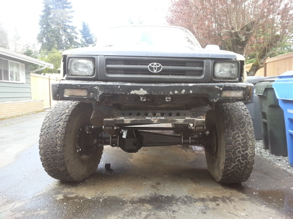

I got an appropriate shackle angle:
And i moved my axle foreward to clear for future tires and save my firewall some heartache!

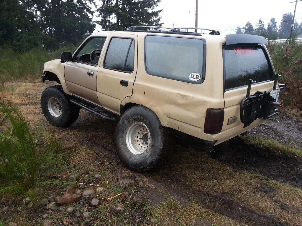

This picture makes the front axle look like it isnt as far foreward as it is, due to the way the wheel is turned...weird... or maybe that's just me?
