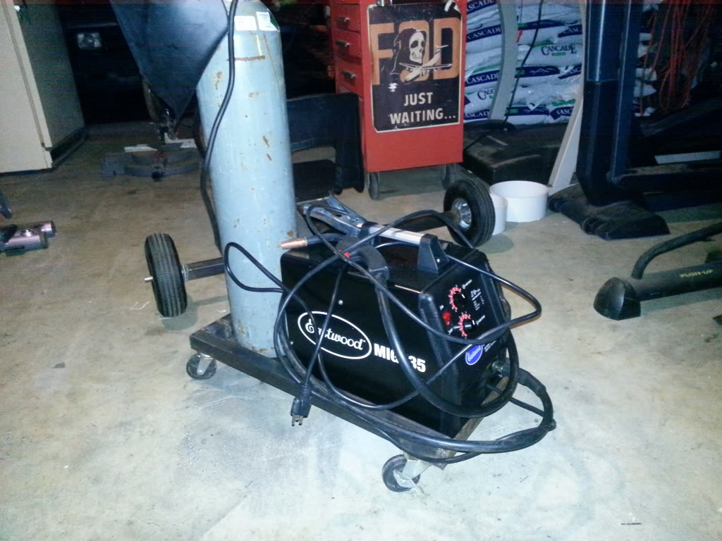

Finally got my new welder, like i had promised
As you can see, i whipped up a nice cart for it with some scrap metal and old casters i had laying in the garage. Need to put a handle on it to secure everything to.
I then proceeded to hit the regulator and break the flow guage!
But it's whatever, ill have to go pic up a new gauge soon, but for now i just electrical taped the cover back on the cheap piece of crap to stop any gas from leaking while i proceeded to weld with it anyways

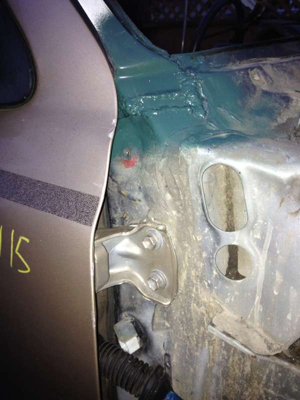

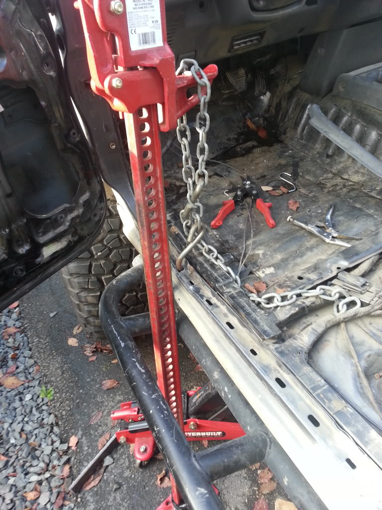

On the passenger side door, i was able to line the hinges up and get a good feeling seal. However on the drivers side i had to get a little more redneck innovation goin to make the fit feel stock again. Due to the roll, the portion of the body the hinges mount too had been knocked inwards where the upper hinge bolts to, so i had to file out the hinge and make a spacer plate for between the hinge to get it in the right location. I will take pictures tomorrow if i remember.
Here is some more of that redneck innovation that i was talkin about! This is how i straightened my floor

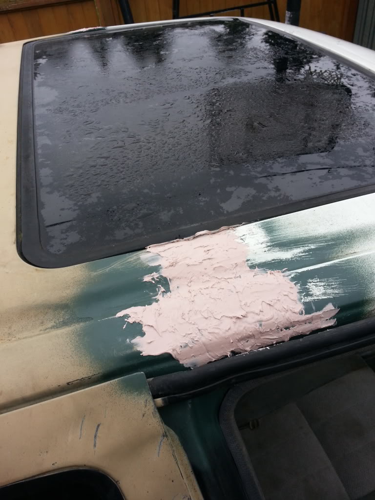

Threw my body filler up top to seal it up nice and tight
will have that sanded and hopefully painted soon, tho it is a low priority atm. Due to the fact that im already jumping into my next project on the truck. But first...

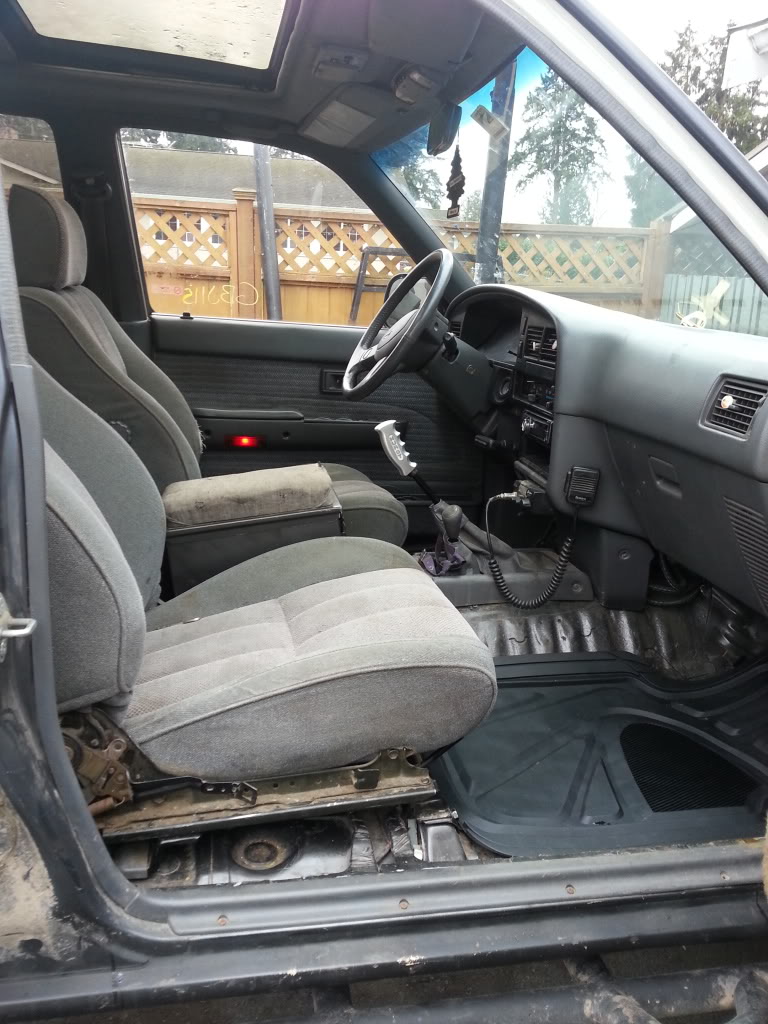

Can you believe my interior went back together as if nothing had even happened??
I was very excited to see this!

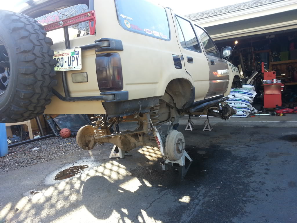

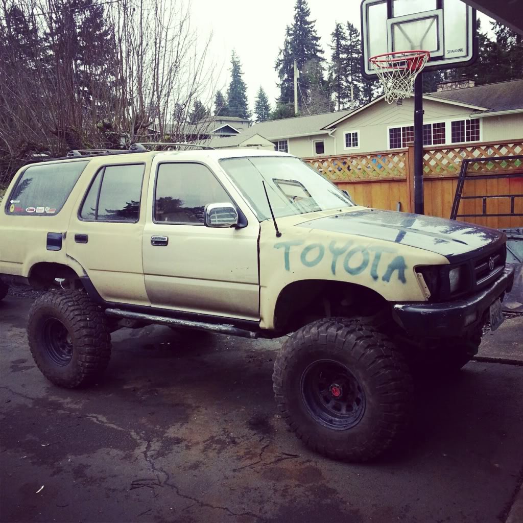

And here she stands! Well, stood i should say

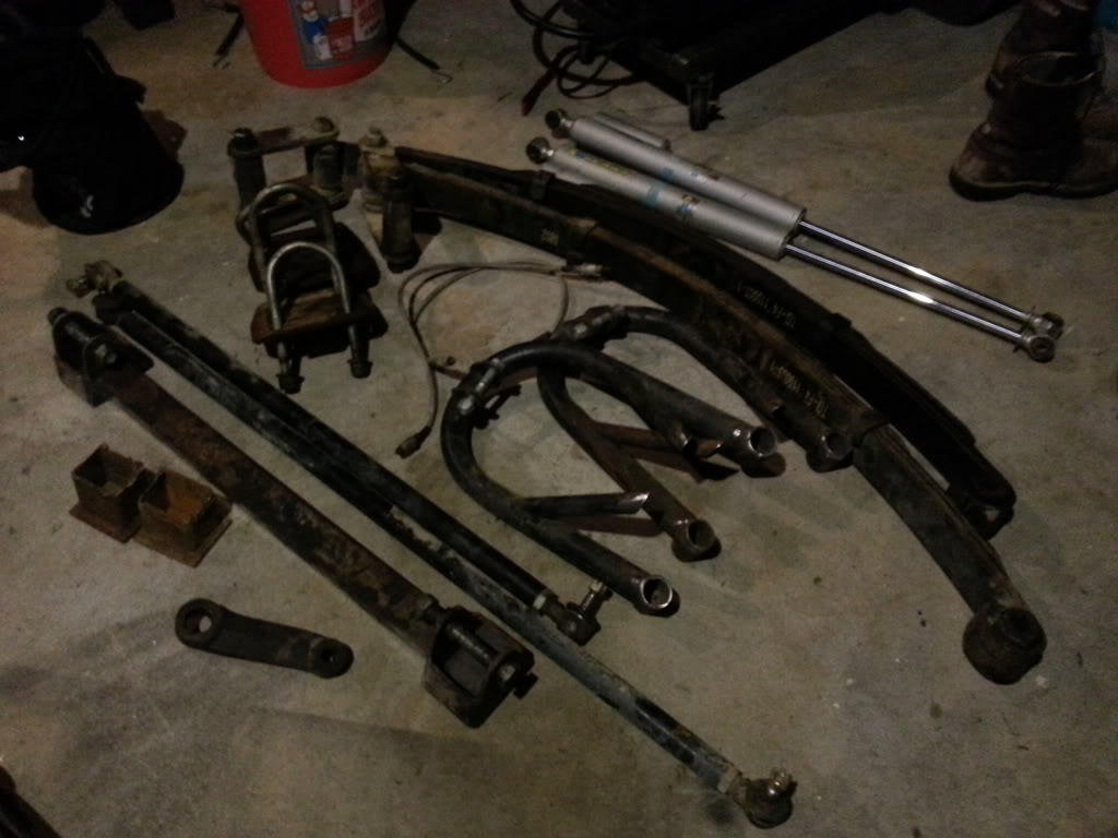

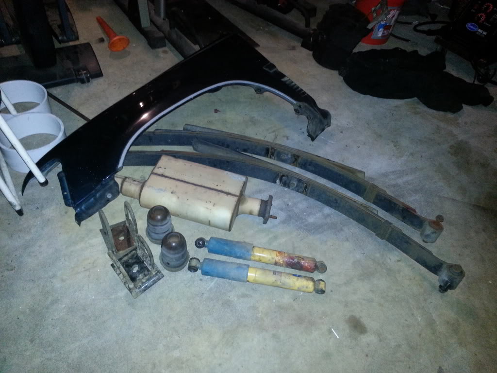

Because ive traded the wheels, and she is on jackstands with her rear end torn out because i wend junk yarding and picked up a set of 2wd f150 leaves, u bolt kit, flowmaster muffler, bump stops, a new fender, and some ifs shocks all for $40 bucks, because i got a local guy that hooks me up!
So she is actually sitting outside like this as of today:

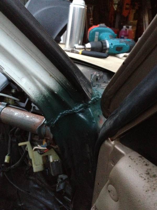

However I had to stop and weld a couple gussets on a buddies new axle:
I like being able to see the inside of the axle and it has the discoloration due to propper penetration and no warping
means I have a bad ass weld!
Don't get me wrong they arent all that good but its nice to know they are solid!

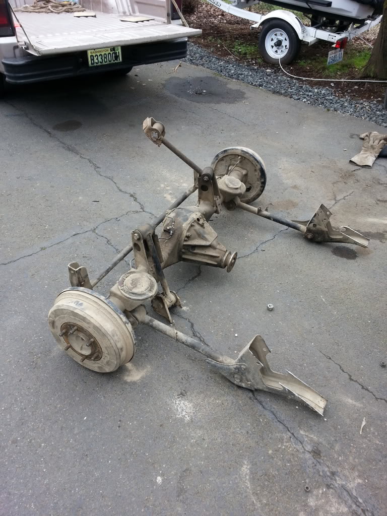

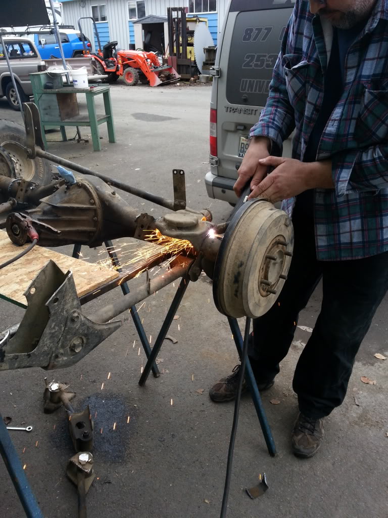

Finally dropped the rear axle!! Then brought it over to my buddy, Ryker's shop, where his dad cut all the god awful stock 4link off!
I now need one of these
Then we loaded the now significantly lighter axle into the truck and packed a set of 35x12.5 rollers on some decent aluminum Center Line rims into my tiny truck bed! Was only a tad sketch considering i didnt bring a tie down, only had a big ass rope just laying in the bed of my truck hahaha.
See how lucky i am?? These are the kinds of friends i have! Ryker was having so much fun grinding that he did nearly half the grinding to be done in one sitting!
