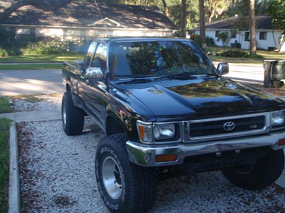

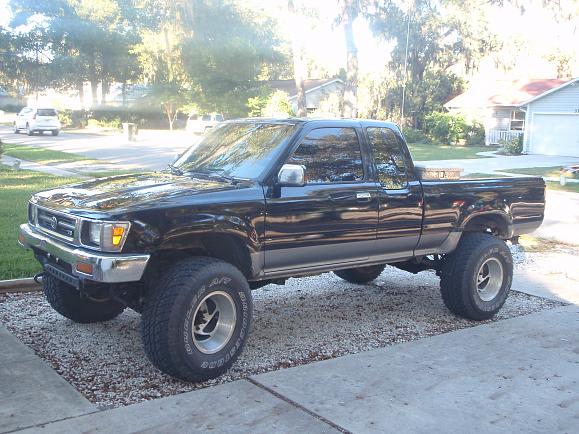

I have been having all kinds of problems with my toyota ifs front end first i blew my front chunk i stripped out my ring and pinion i bought a new one and put it up front then about 3 weeks after it locked up on me again then i had to replace the barrings on both sides and the final straw was i was driving down I4 and my tire started clapping so i pulled over and i had broke off 4 of my 6 studs on my passenger front tire so its just time for a SAS.. i have a good buddy who owns DEEP SIX OFF ROAD in EDGEWATER FLORIDA guy does some great work and builds some monster trucks. i got to talking to him the last 2 weeks and we have come up with a deal hes going to give me a set of 84 pick up axles he has at the shop with 4.88 gears in them and he is going to SAS my truck with 10 inches of lift for $1000..... i cant beat that it goes in on thursday the 19th which is tomorrow ill post some pics i just took of it today and ill post some after he is done. im going to throw a set of 38inch TSLs on it that he has laying around the shop.. ill keep it posted..

pictures
Attached Thumbnails YoterUp's 1990 Pickup Build-Up Thread-pb130026.jpg   YoterUp's 1990 Pickup Build-Up Thread-pb130028.jpg   YoterUp's 1990 Pickup Build-Up Thread-pb130030.jpg
