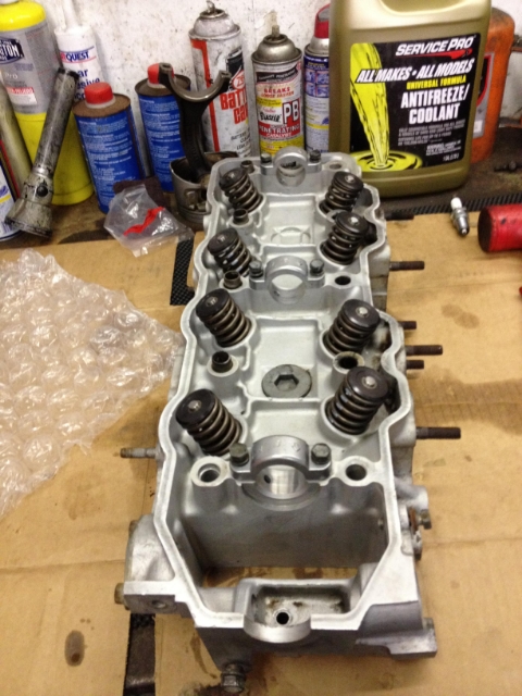

I finally assembled the head that I was talking about, and put it on the engine. I used Engnbldr's oversized valves and RV springs, with the LC Engineering EFI Pro camshaft.
Here are some pictures of the process. I am sorry about the lack of pictures. I thought I took more.

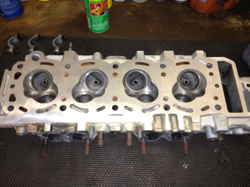

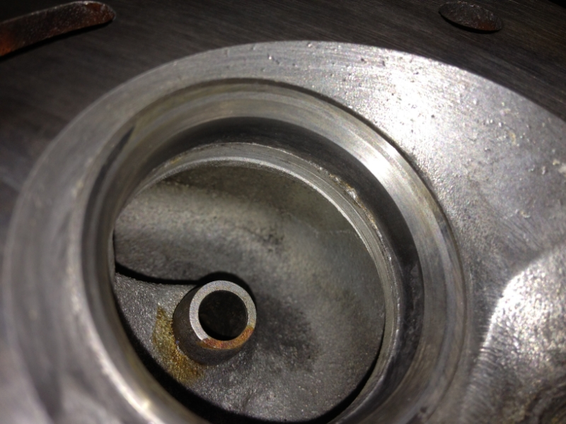

Here is the intake port after the valve seats were cut bigger to accept the bigger valves. I didn't really port it, because I don't know what I'm doing, but I did remove the ridge under the valve seat. I blended it as best I could without removing much material. Unfortunately I forgot to photograph the ports after that operation.

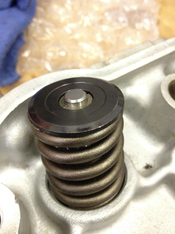

After installing the valves, I noticed that the keepers and retainer for one of the valve did not fit right (shown above). I sent engnbldr that photo and he quickly sent me a new retainer and keepers.

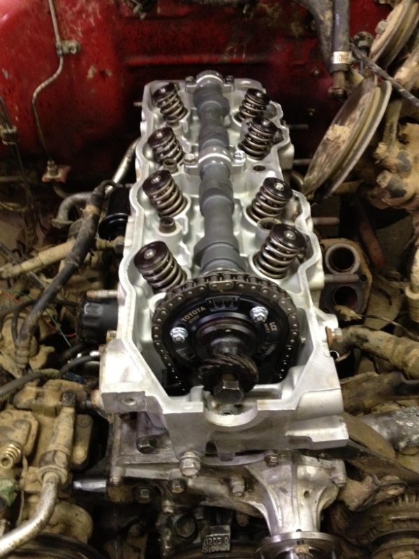

Just before rocker assembly installation.
I really thought I took more pictures. At any rate, it's running now. I definitely feel more power. The difference is not huge, but very noticeable. I'm very satisfied.
This weekend I might start fiddling with the adjustable cam gear to see if I can get a bit more out of it. I think I'm going to try advancing it 2 degrees.
