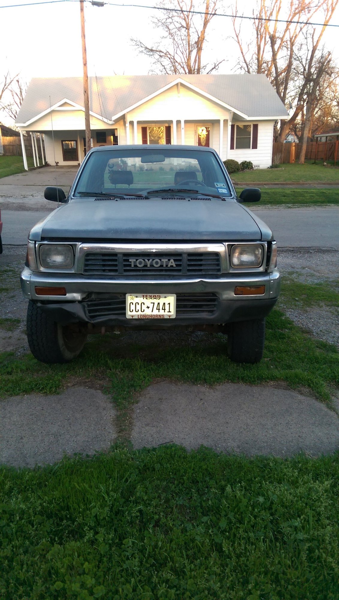

Unmolested 1989 XCab Truck
Old Mar 18, 2016 | 04:50 AM
Fuzzy69's Avatar
Joined: Mar 2016
Posts: 19
From: East Texas
Talking Unmolested 1989 XCab Truck
I found a rarity. It is an unmolested 1989 Toyota XCab Truck 4X4. It spent some time on a farm here in East Texas and has sat for the last two years. The positive battery clamp was broken. So I jumped straight to the cable, connected it back to the battery before removing the jumper cables, and drove it home.
It need a fair amount of work to make her streetable again. Catalytic converter is plugged and drilled. Tune up. All fluids changed. Then, hopefully, the miss in the engine will be gone. She needs some body work.
1989 Toyota XCab 4X4. 22R-E, 5 spd.
Over time, it will become an overland truck so we can go camping in remote areas without the popup camper. First things first, make her run right, then tires, then inspection so she can be driven legally again!

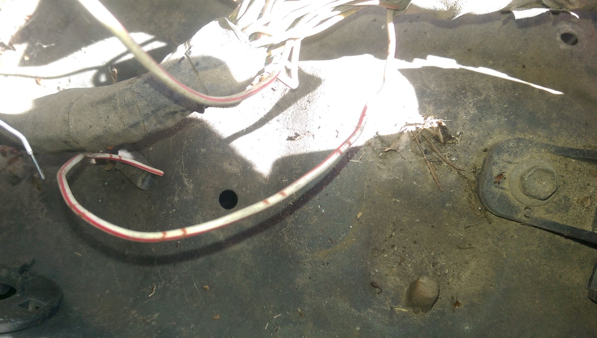

Sometimes you just want to beat someone. It runs great, but the idle was like 2k rpm. So I start reading. I know now how to check the CEL. I connected TE1 to E1 and bumpkus. This pisses me off for some time.
Then I start looking under the hood because I thought maybe there was an issue with the connector itself. That's when I see this.
Cut power wire.
Then, I see a cut brown wire. The two white/red wires look like they belong. I start tracing. The white/red and brown go to the diagnostic port. The other white/red go ?. But all of the other sensors that the white/red connect to are all connected to the ECU.
That brown wire is the ground for the diagnostic connection. Grounded the TE1 to the battery and I need an O2 sensor and a new TPS. That explains the high idle.

Soldering the white/red tomorrow and putting brown back to ground.

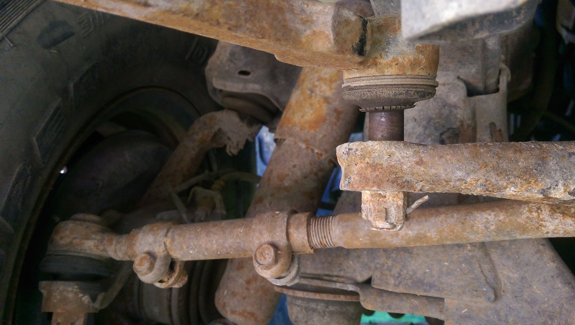

Steering was loose, so while it was up in the air I had the boy turn the steering wheel back and forth. I need new Pittman and idler arms. Should probably go ahead and replace the tire rod ends as well. Well have to look at the drag link as well. But the TPS first when next month's paycheck hits. At some point, I will have to transfer the title and pay the taxes as well.

Looks like you are making some headway on it. Not sure why you would need a new pitman arm, it should just be bolted straight to the steering rod, maybe you just need the TRE that is mounted on the pitman arm.
There is some adjustment in the steering box that can help too:
new joints etc will probably do wonders for the truck. Might check the front bearings too.

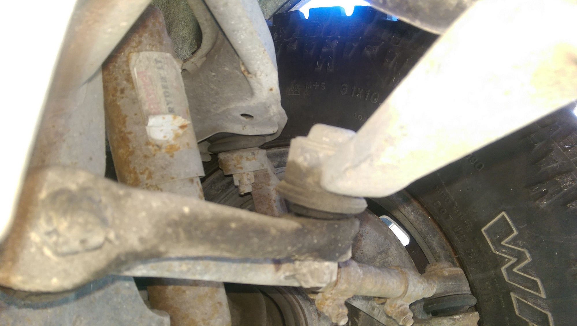

Both the pitman arm and idler arm ball joints are shot.

Idler arm
Pitman arm

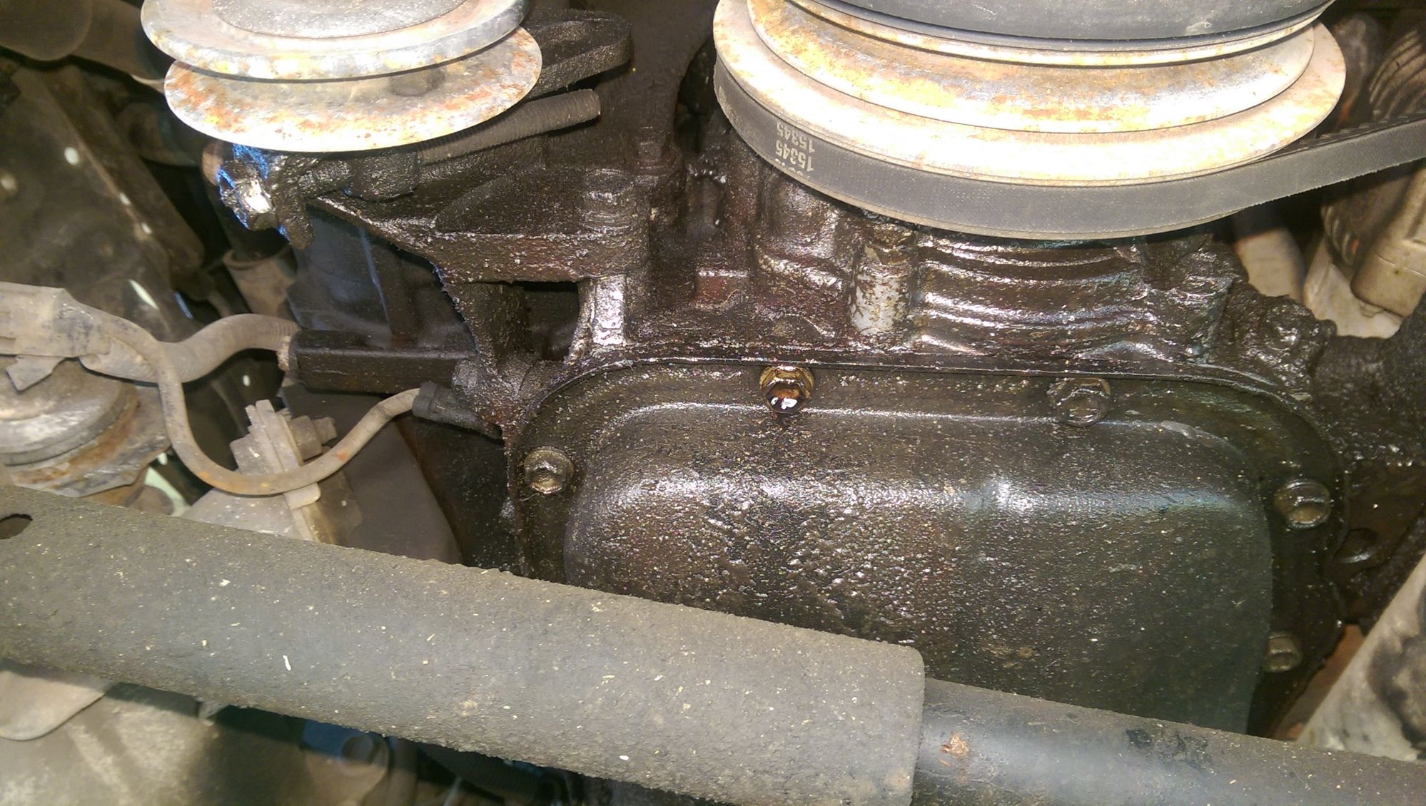

Oil Leak

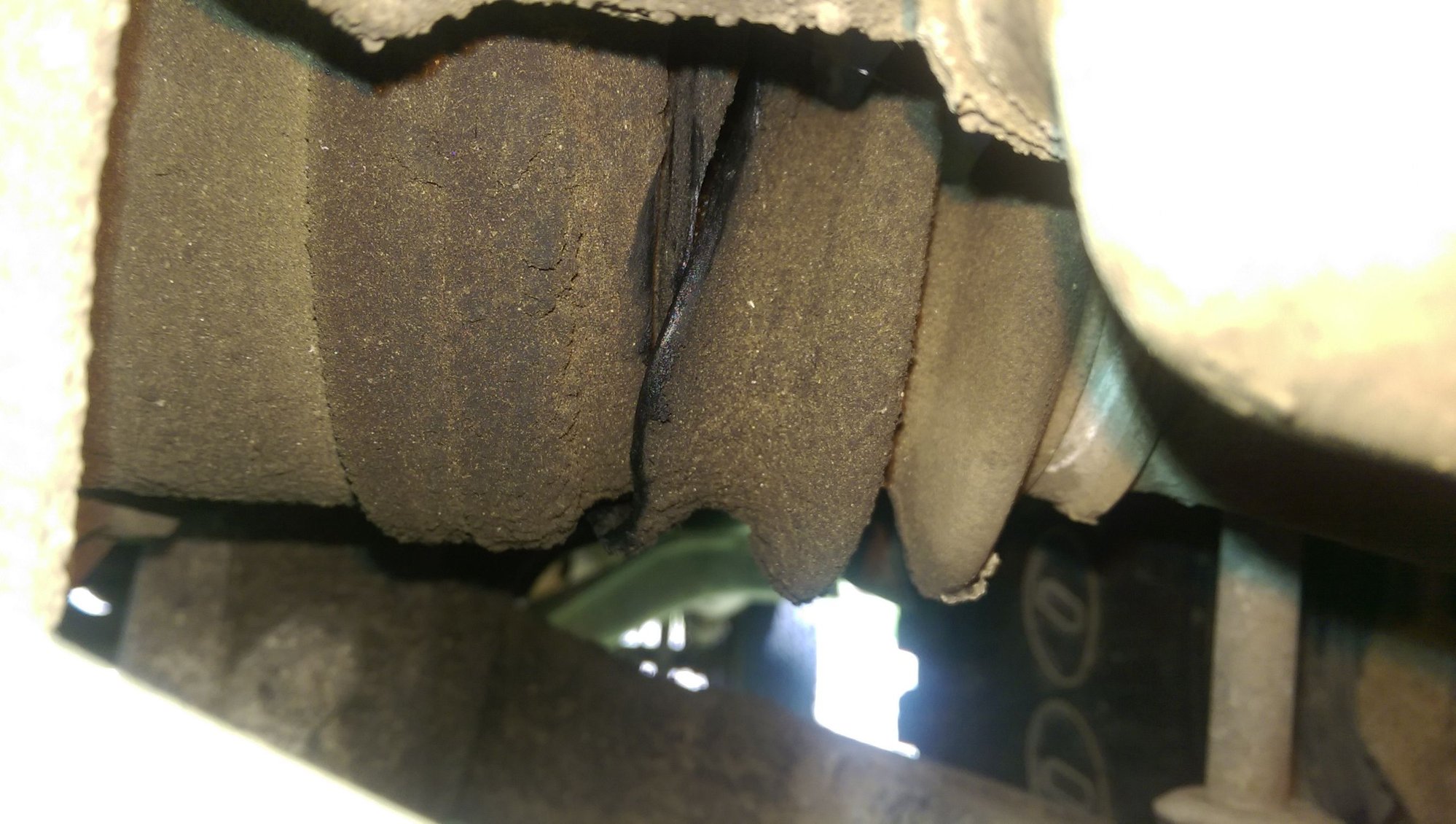

Drivers side cv axle

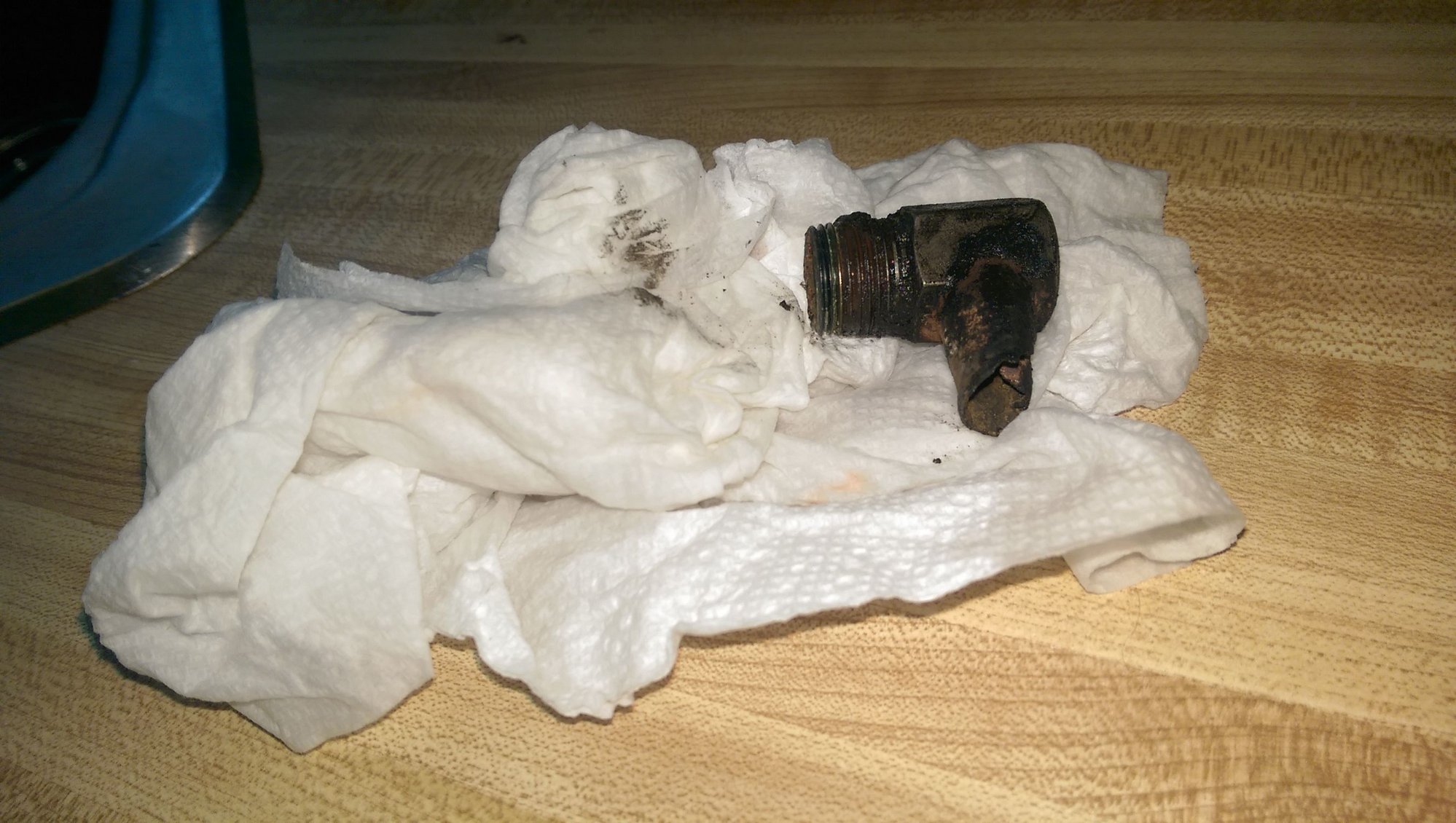

Radiator drain plug

Pittman arm and idler arm replaced. Pittman arm from I'Reillya was 1/8 inch long and would not fit. Ended up at AutoZone.

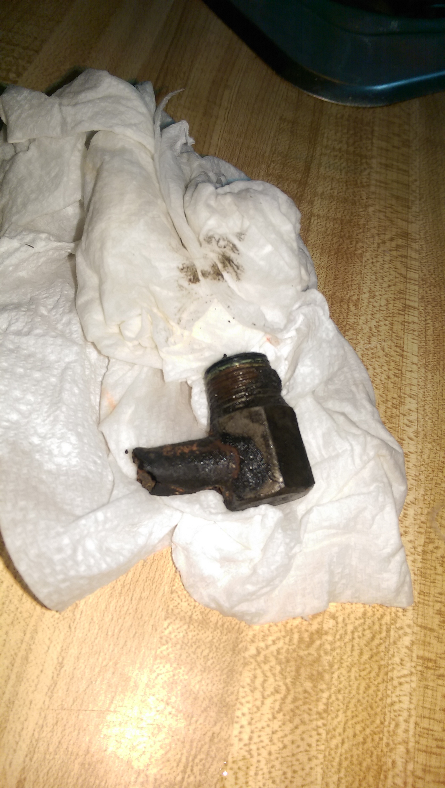

Well. I've driven it for a month. Have a new list of repairs.
Shifter bushings. Won't stay in 5th gear.

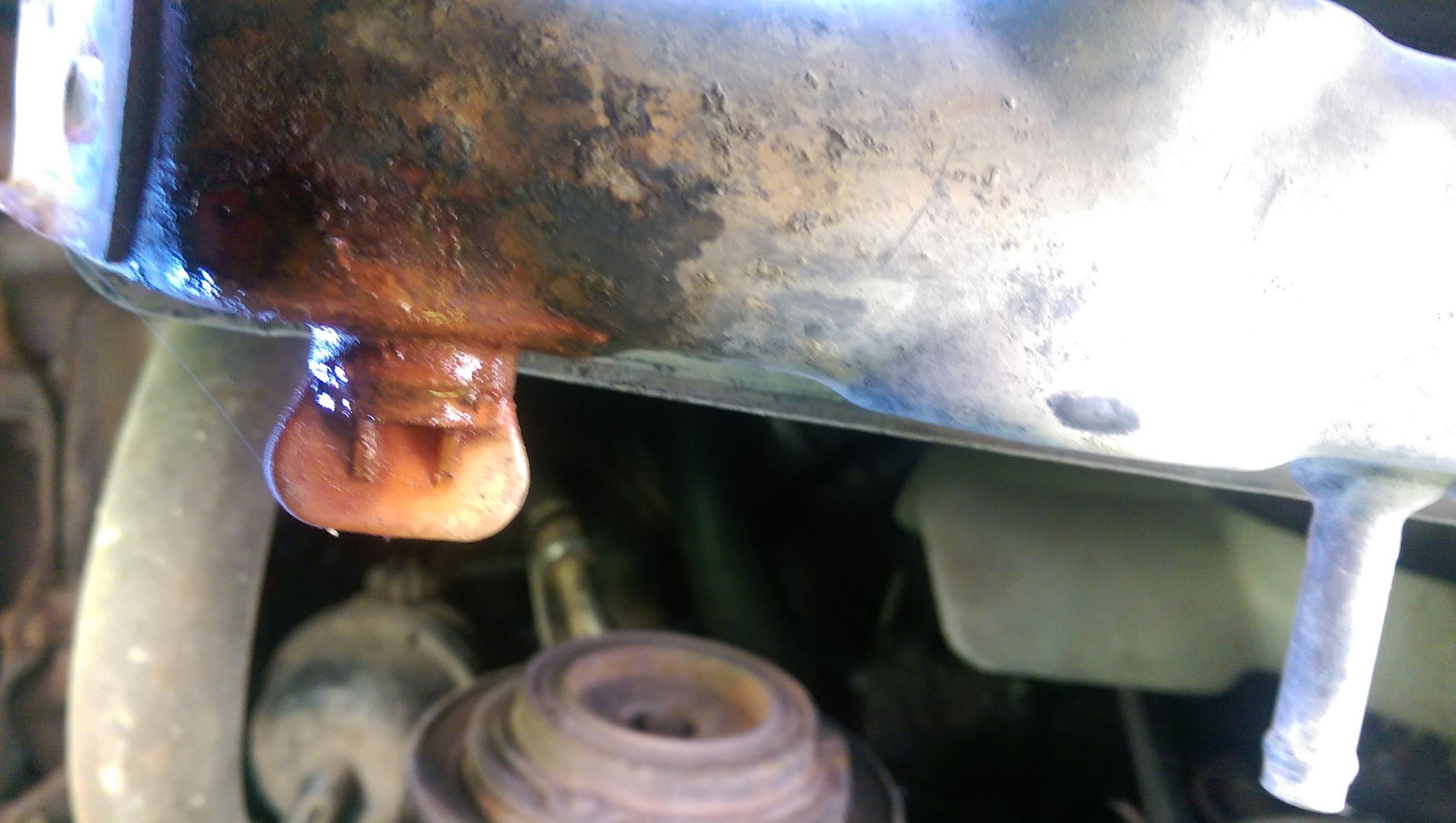

Bought a replacement coolant hose (u shaped) that connects the manifold to the block. Glad I didn't cut it. This is the problem.
Coolant connection on the underside of the intake manifold. Seems to have rushed just a bit.
