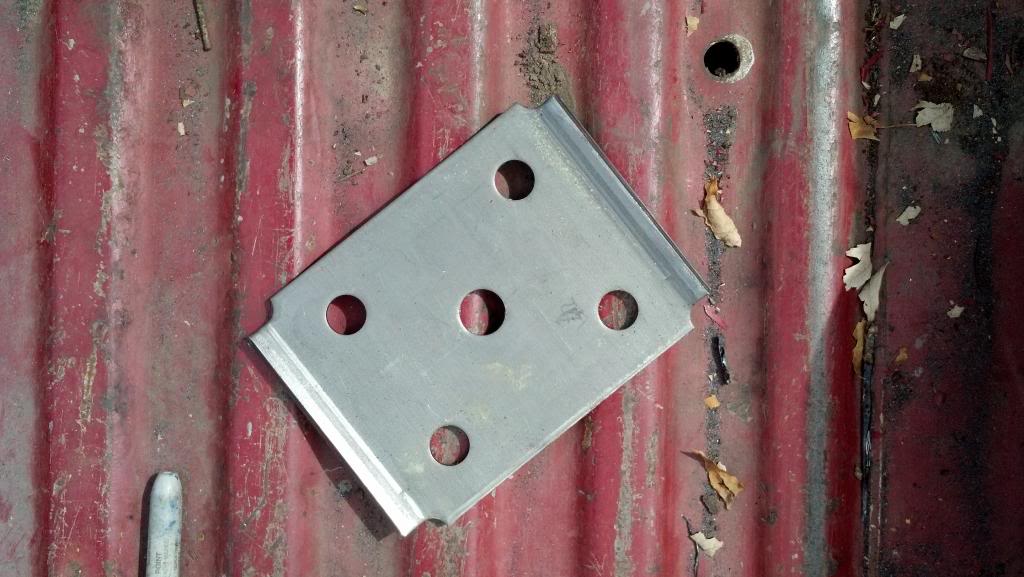

I found some steel plates that already had holes in them. They are originally designed to be spring mount plates for a trailer. I found them for $10 a pair at a ranch/farm goods store.

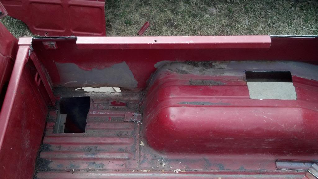

I removed the inside panels of the bed sides, which ended up breaking off many of the bolt heads. They were so rusted in there! I had already decided I would need to re-tap the holes and put some new hardware in so I drilled out all the broken bolts while I had it open.
I started with the 4 holes through the bed. Now, I never had really used an angle grinder before but I jumped right in. Turns out it's really not that hard to use! I also found that I would have to cut away parts of the bed rail to accommodate the width of the plates.

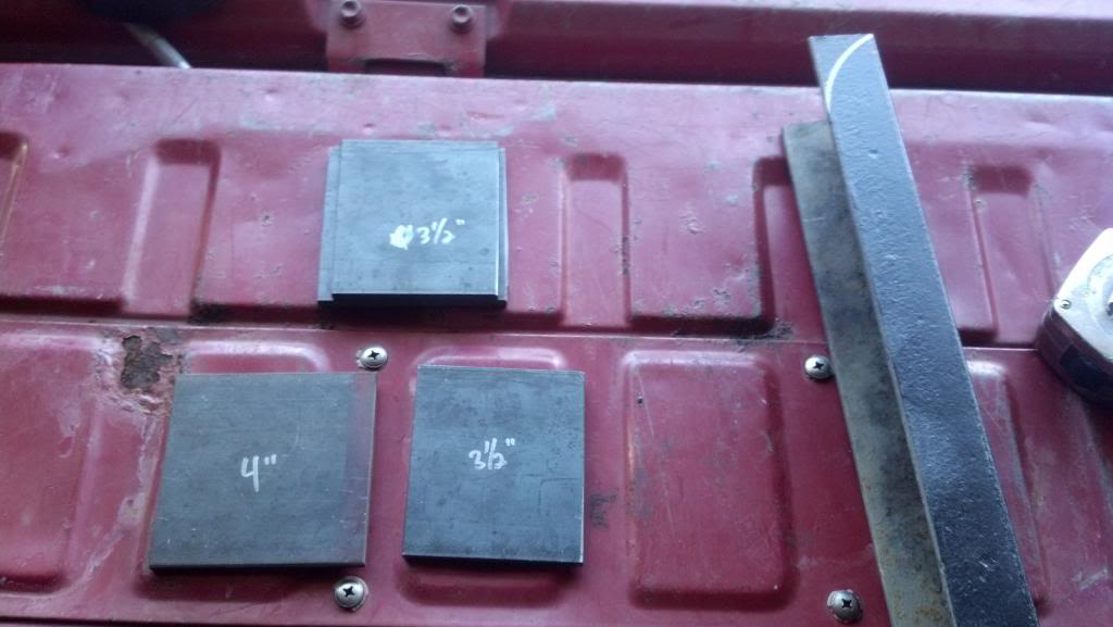

The next part took most of the time. I spent alot of time cleaning up the steel to prep it for welding. I also stood around alot and eyeballed how everything might line up. I had a rough idea in my head. So I cleaned up the ends of the roll bar that had been sloppily cut by the previous owner. A chop saw with a cutoff wheel was really useful here. Then we welded the plates to the bar. Important here was to bolt the two paired plates together tightly prior to welding since the plates will warp a bit and it would blow if the bolt holes didn't line up.

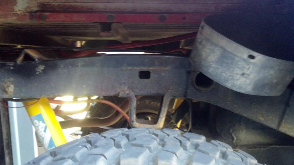

The rear mounts could come straight up from the front of the frame under the wheel well. Then weld a horizontal piece that would weld to the plates. And a gusset for strength. The only concern was to make sure the tire couldn't crush up high enough to hit the mount. I found there is plenty of clearance with the OME HD springs!

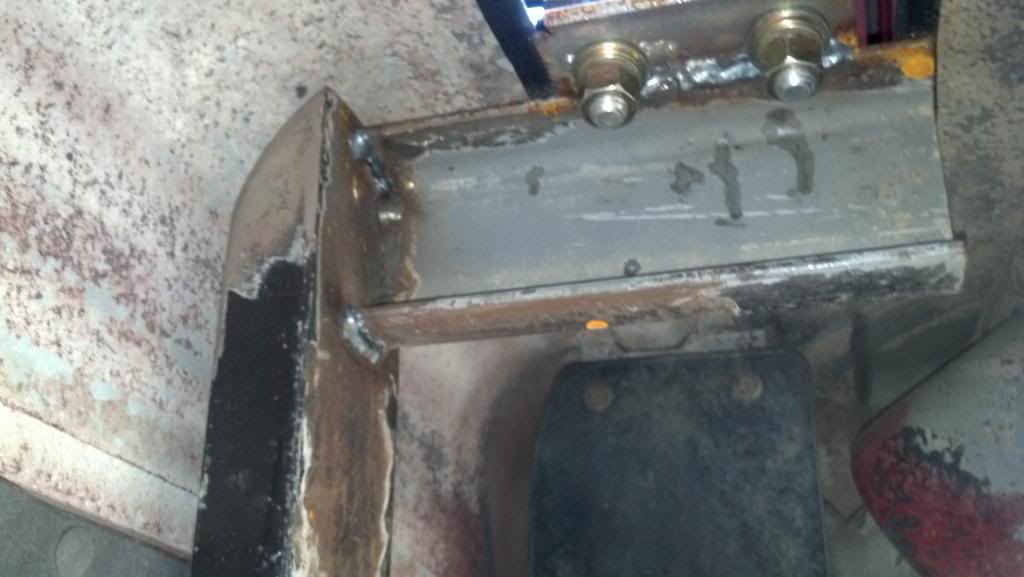

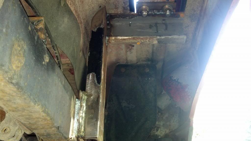

I needed to shim out from the frame a bit to clear the body at the wheel well, so we welded some 1/4" plates together. To get nice and neat up in the top of the wheel well, I cut a curve in the bar. That was a bit tricky. I cut a piece for the horizontal part and dry fit everything to see if it lined up, and surprisingly, it looked like it would work without much jimmying.
It seemed logical to weld the parts from the top down since the location on the frame wasn't critical, but the location on the plates at the roll bar was VERY critical due to the bolt holes. So we welded the plate to the horizontal piece while bolted to the plates on the bar.
Then put the bar in place and welded the vertical piece to the horizontal piece and finally to the frame (we had already welded the shim plates to the back of the vertical pieces).

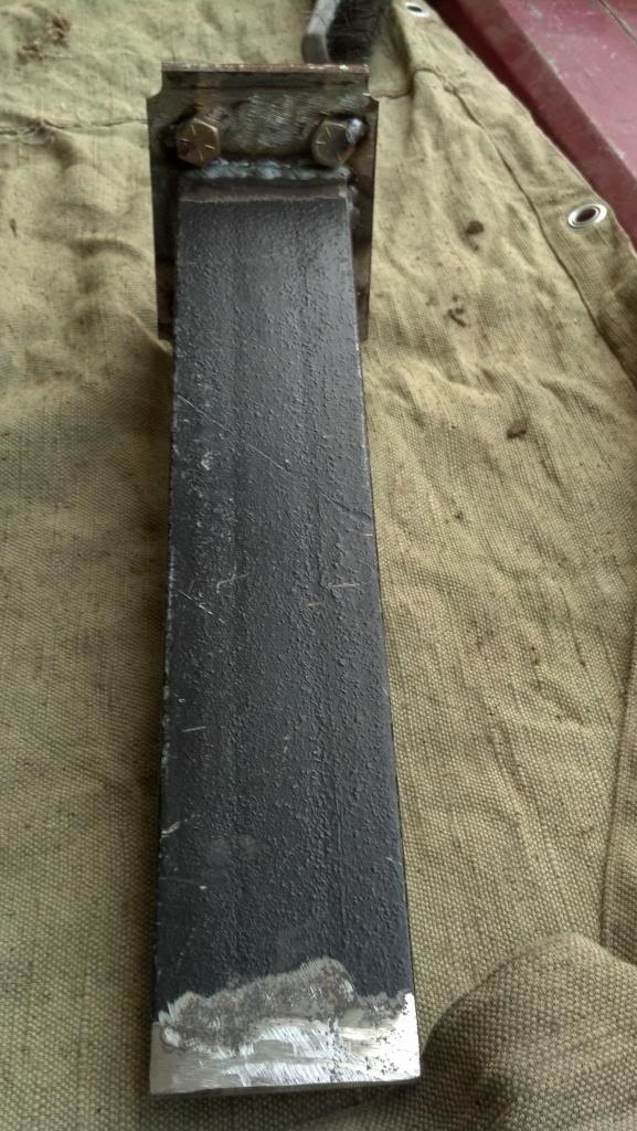

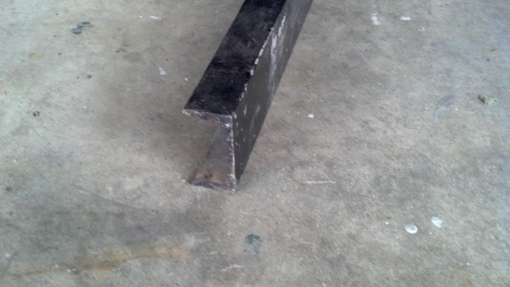

Now for the front mounts. These were going to be much trickier since the frame mount location happens to be precisely where the body mount is for the bed. Actually it was good that it located where it did since an inch in either direction would have made it impossible.

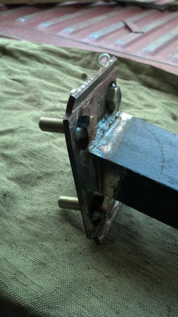

In any case I needed to angle this piece to keep it away from the body mount. This took some time for sure. Firstly, I had only about 31" of the steel bar left, so I cut it in half, which happened to be just about the perfect length for each! I used a plastic protractor thing to get a pretty close guess and then made several cardboard cutouts of the piece to mount. Basic geometry says that the top and bottom angle of the piece would be complementary (minus the 90 degree angle). And since I only had a fixed length of steel, It didn't take too much time to get it right. Once I got a cardboard template to fit just so, I traced the angles onto the steel piece and hit it with the grinder. Dry fitting it found it to be close enough!
Since it would be nearly impossible to weld this bar to the plate while it was on the truck, we did the weld in the vice and even spot welded the bolt heads to the back of the plate since installing them was a booger way up in the bed cavity.

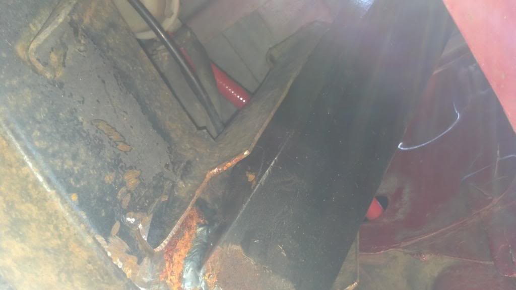

Despite the centered location at the body mount, I found there was no way to weld so I had to cut away some of the bottom of the body mount. I think there is still plenty of frame contact with the body mount but I'll keep an eye on it.

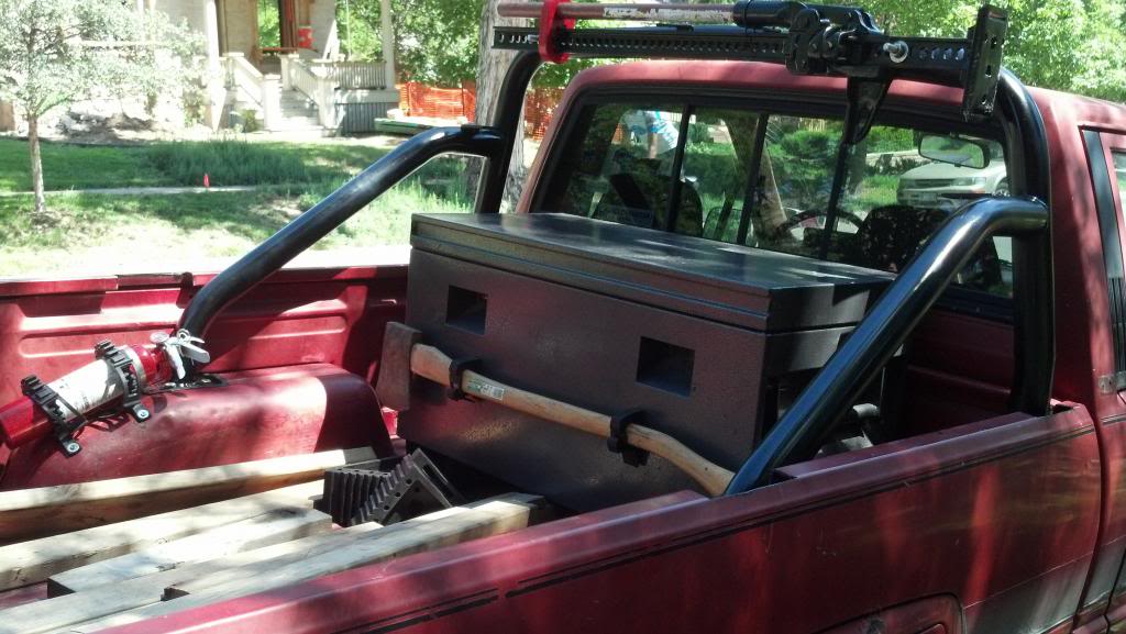

Wow, it takes alot less time to tell you how it went down than it does to actually do it! Long time coming but look at her now!

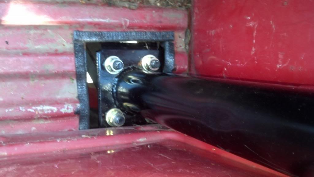

Yesterday I took it off and hit it with another coat of paint to touch up scratches and to cover the welds and plates. I found this rubber and metal edging stuff at the local hardware store (McGuckins shout out!) to cover the sharp edges of the bed holes and installed that.
