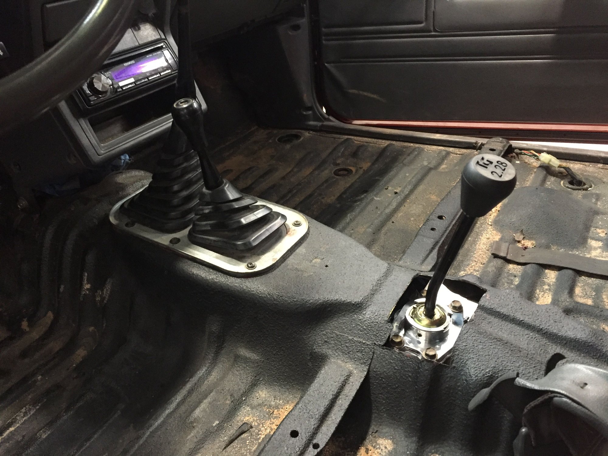

Daul cases are completely done. I still need to figure out a shifter boot for the rear shifter.

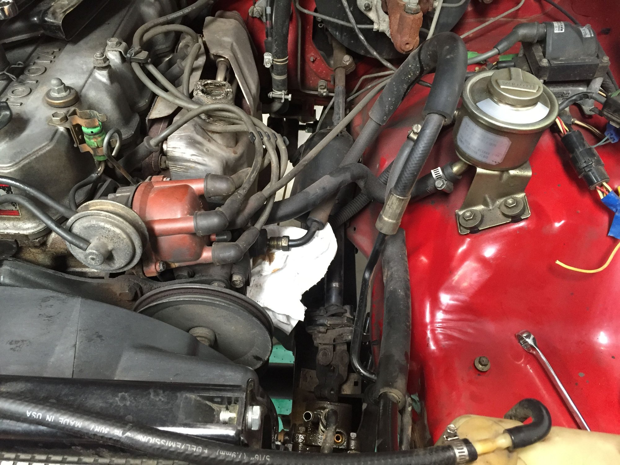

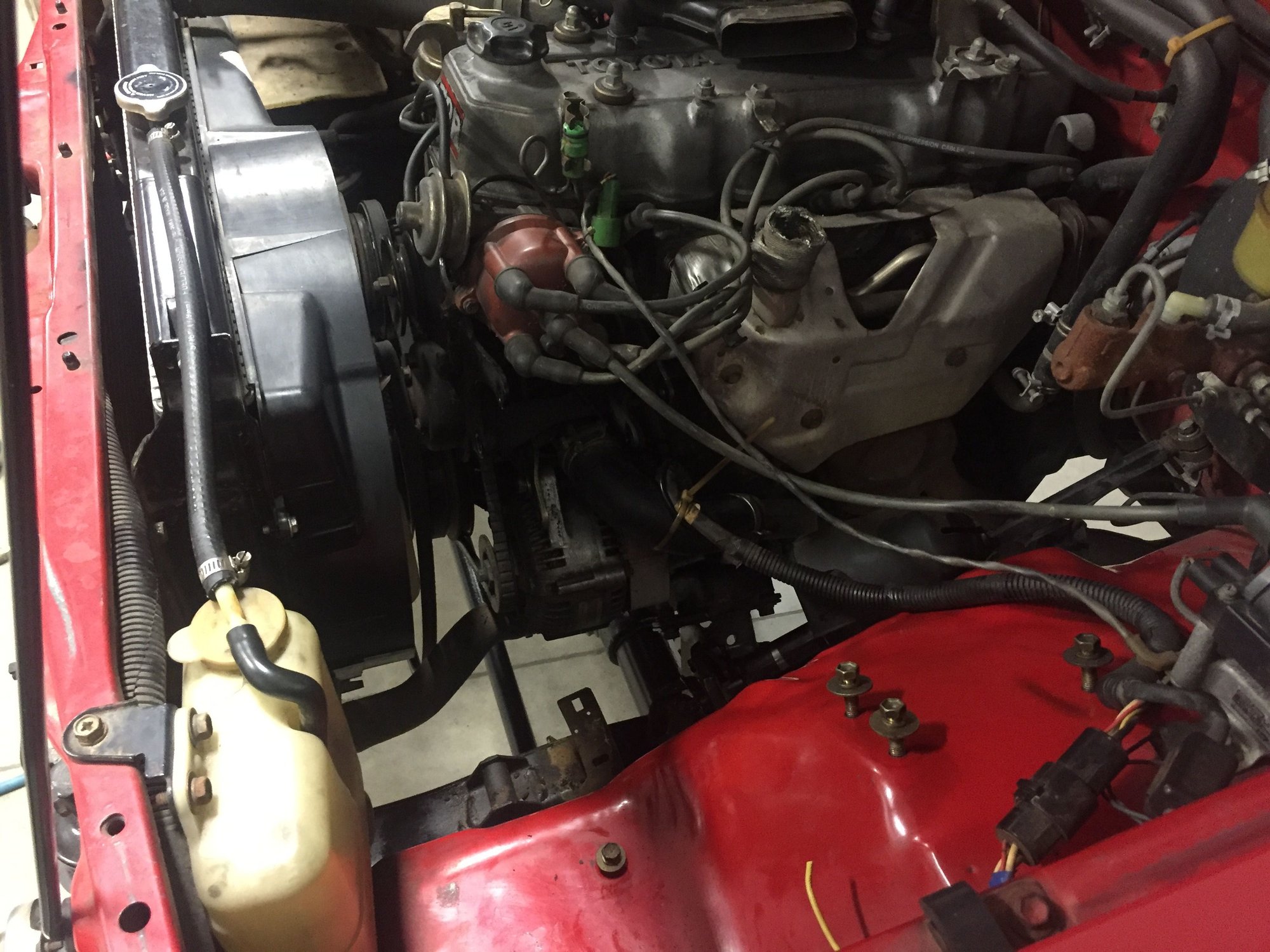

Yesterday i pulled all the stock power steering out because ALL of my PSC full hydro stuff is supposed to get here today. Pretty excited about that and i also made a tempary rear driveshaft. I'm gonna be order real drive shafts soon and then I'll keep this one as a trail spare.

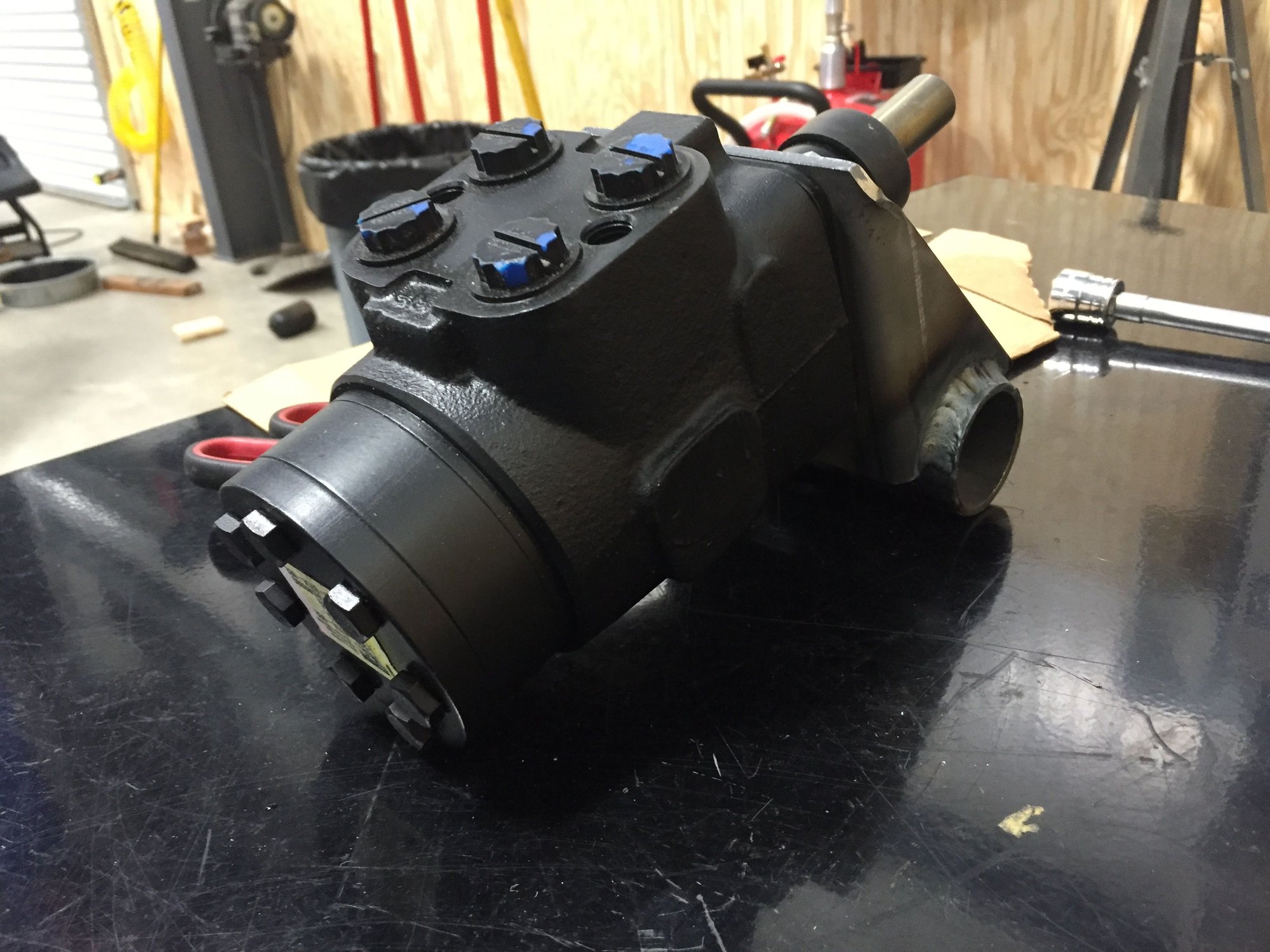

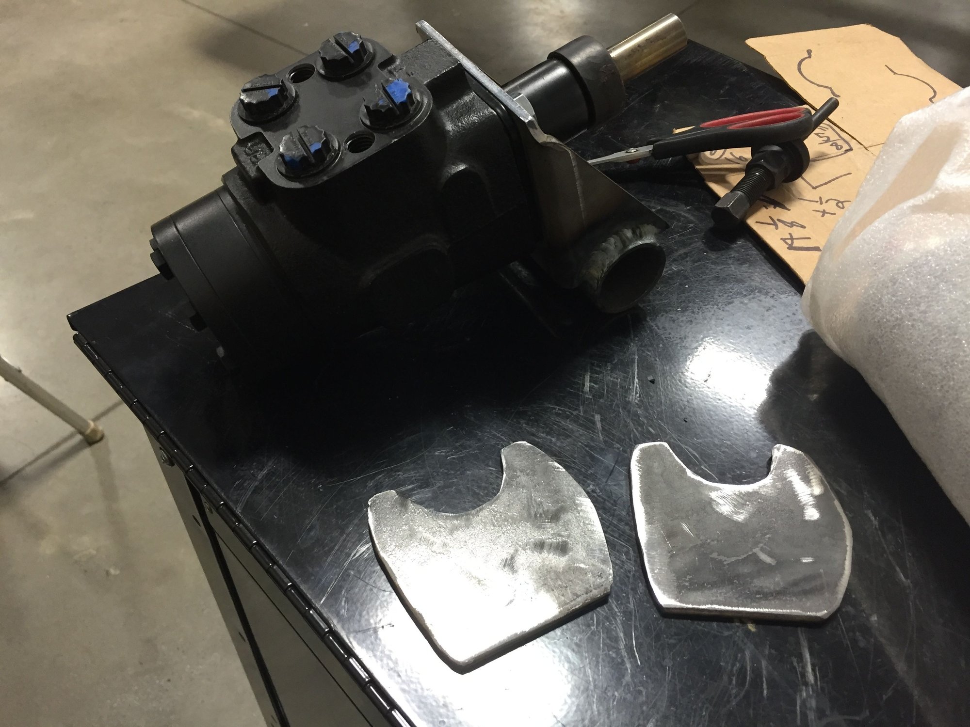

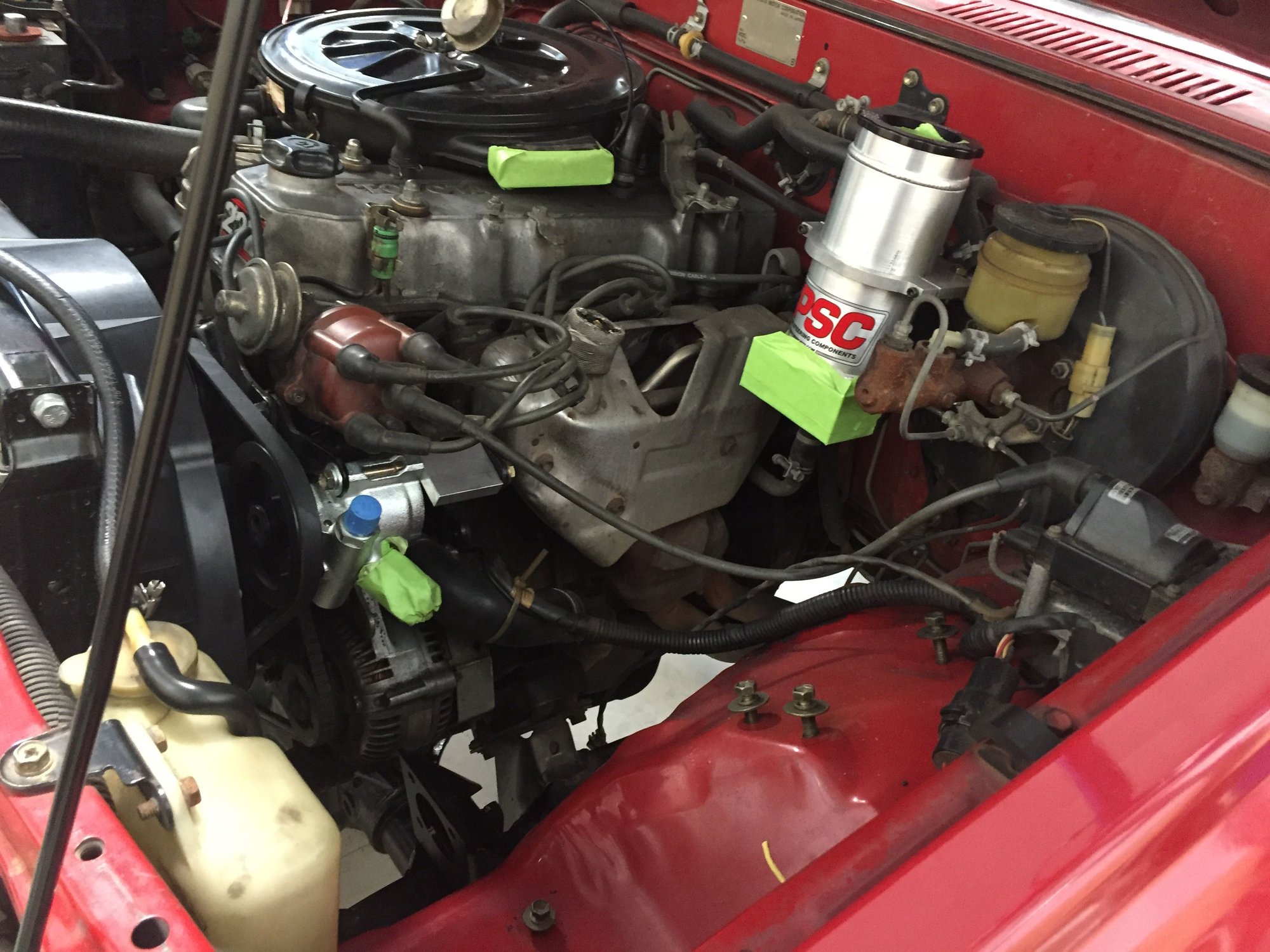

Finally started working on the toyota again. Started by mounting the psc full hydro orbital. I took me a while to figure out a good way to mount it and finally figured it out. I ended up welding a piece of 1.75 dom to the bottom of the mount that came in the kit. Then i made some tabs that welding to the tube and then the frame. Pretty happy with it. I then made a mount for the huge psc resi. Next it mounting the cooler and the ram. Thinking about doing high steer but not sure if i wanna spend the $$ on it though. (Sorry the pics are not in order)

Here are pics of the resi mount

Nice! Clean work! You'll have to let me know how you like the psc Kit. I'm torn between that and TG kit just for how cheap TG kit is. But then again I'm against everything TG. They steal more people stuff and every time I look there warrantee is gone, changed, or nonexistent. Anyway looks real nice!

Thanks. I finally feel like the yotas coming along. I chose the psc kit over the trail gear because psc only make steering product and have been around a long time and is proven. I consider the tg hydro but heard a couple bad reviews that they leak. The tg kit is definitely alot more "bolt in" because the psc kit is pretty much universal and ive had to pretty much make mounts for everything. Once its driving ill give u a review on the performance but I'm sure it'll be awesome.

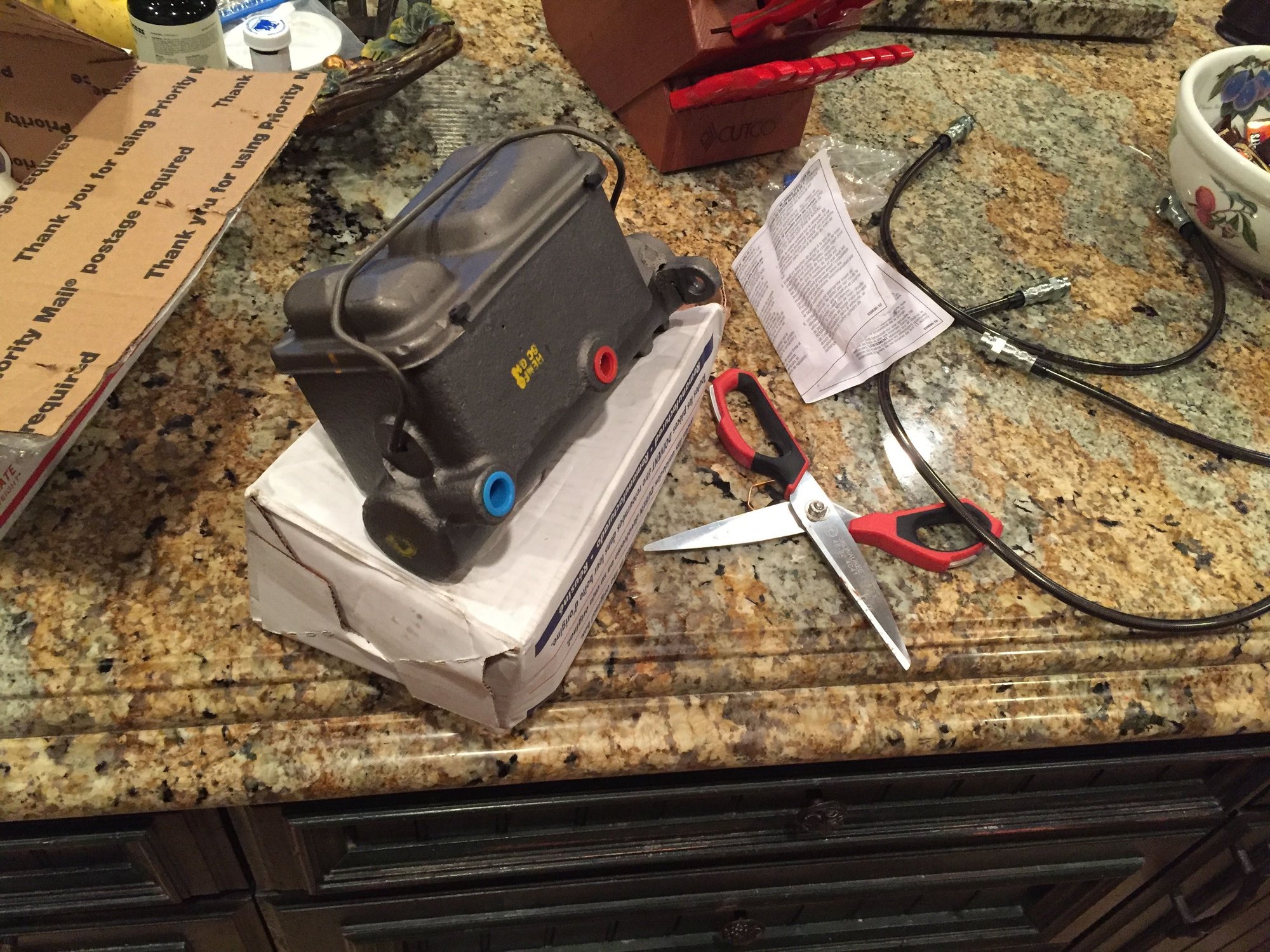

ok thanks for the info. I think im gonna try the gm master with the sky mfg booster and line adapters.

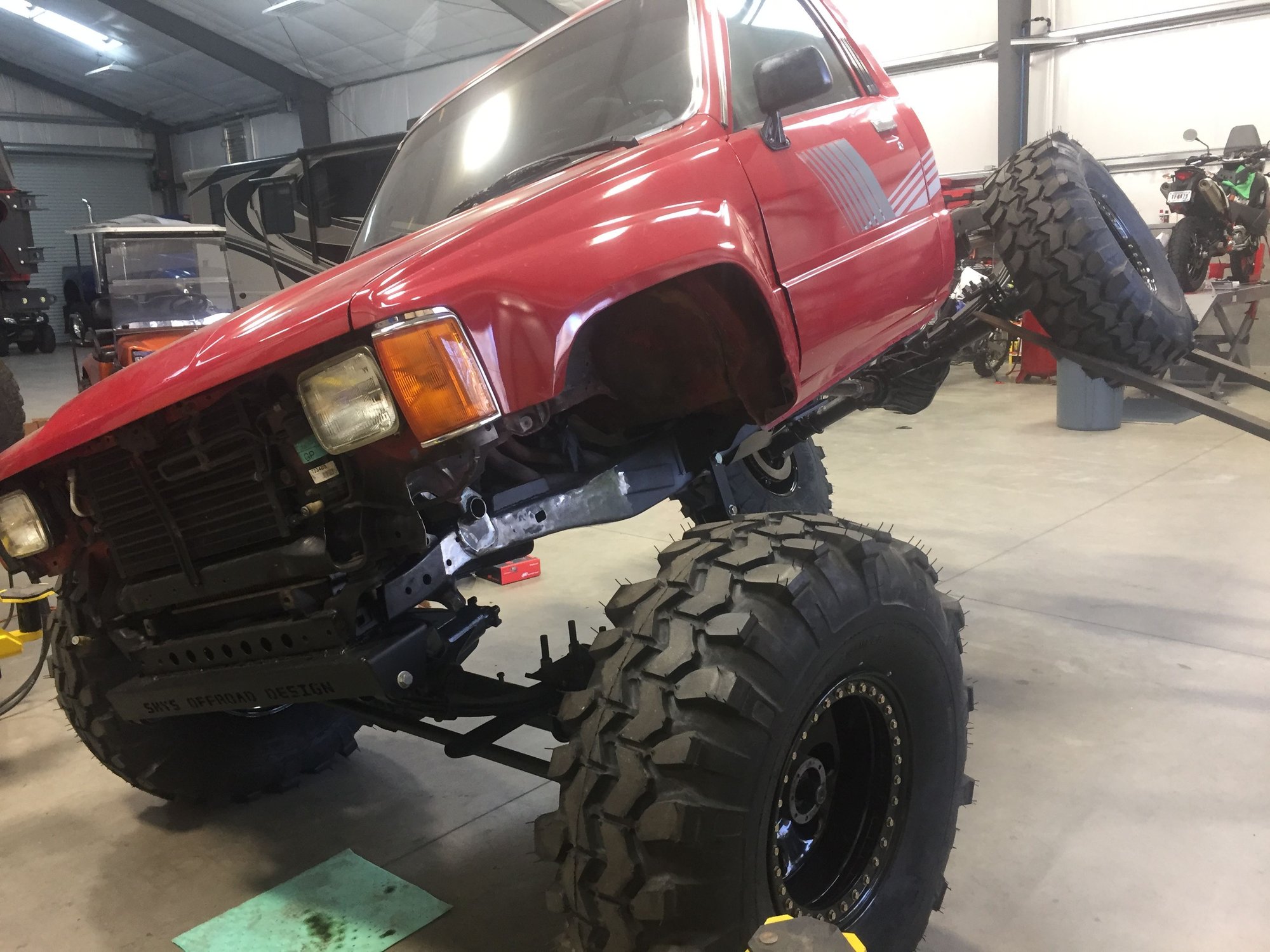

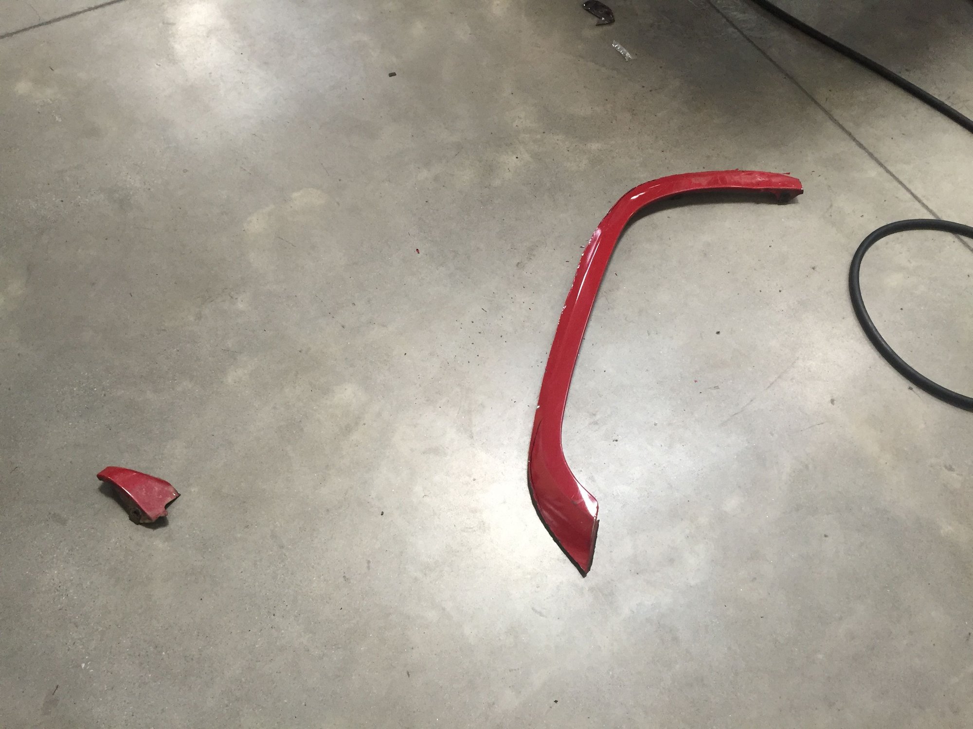

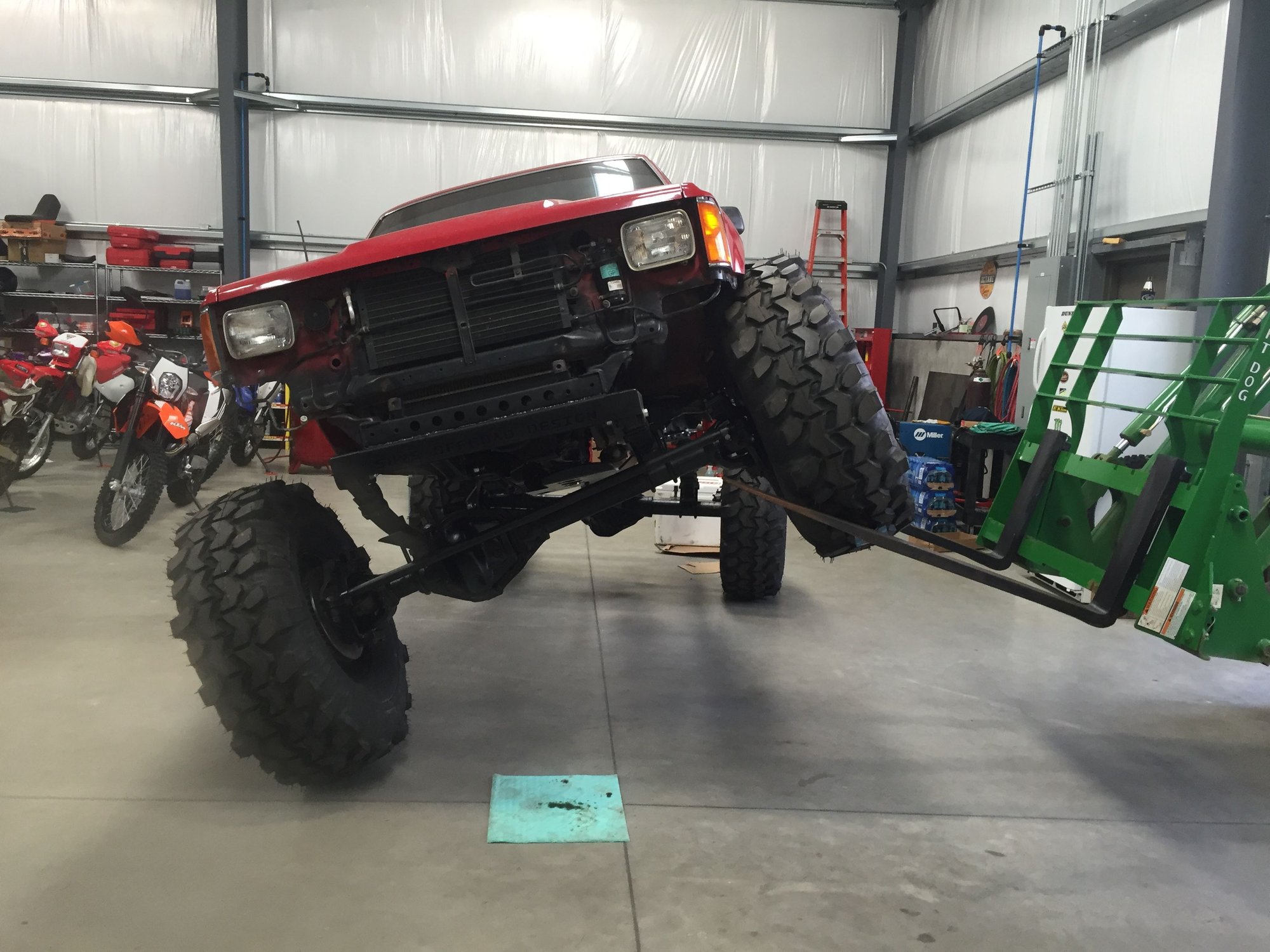

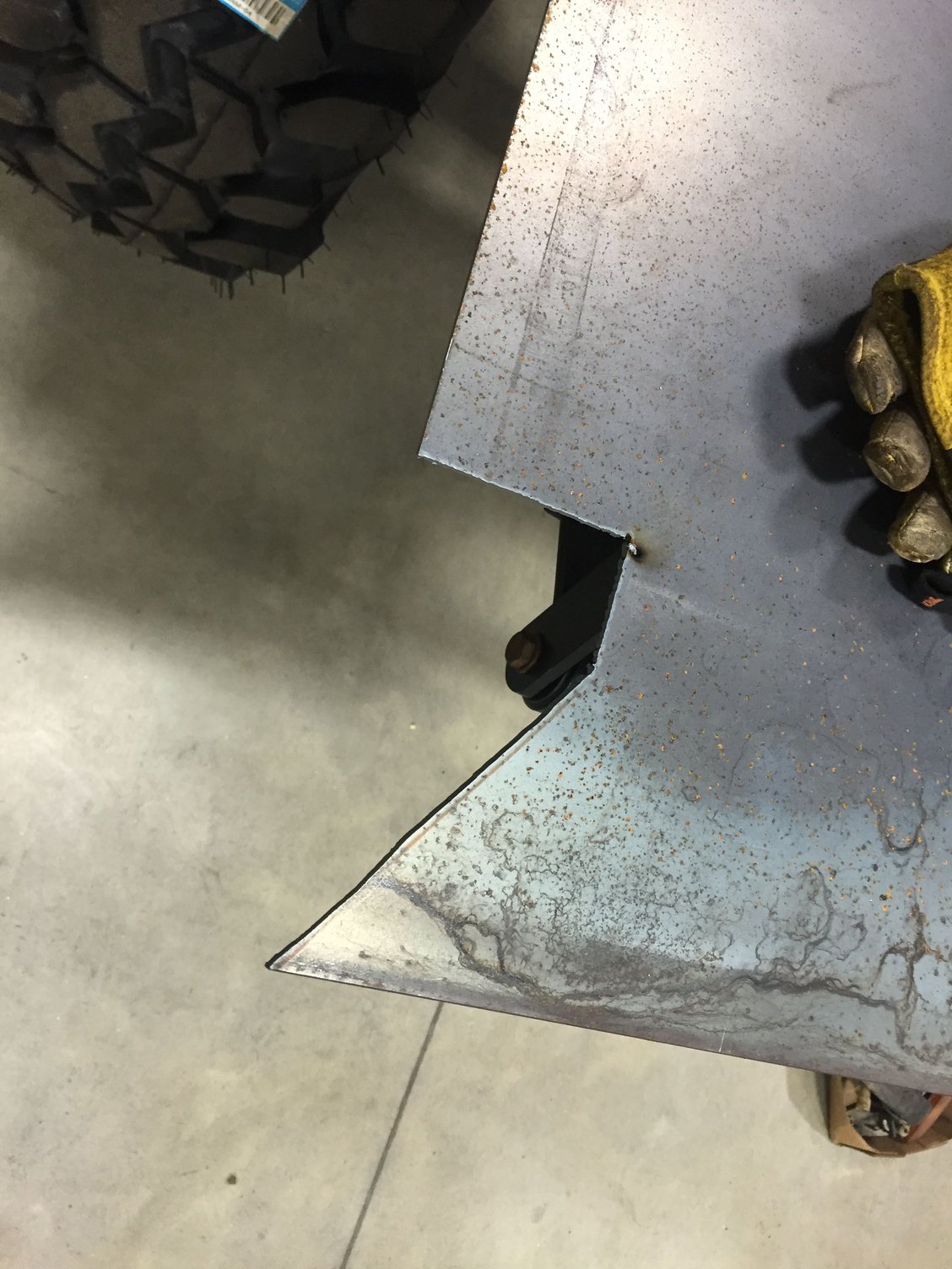

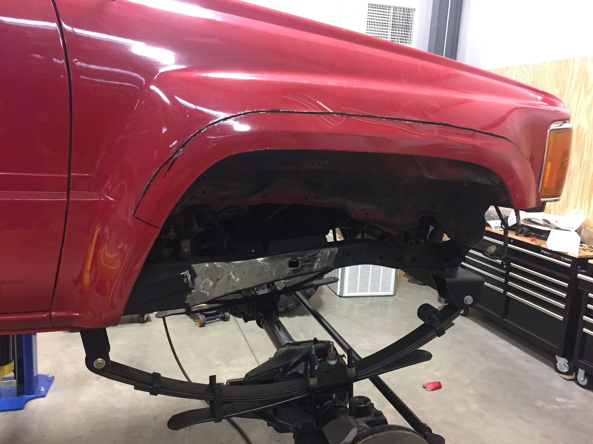

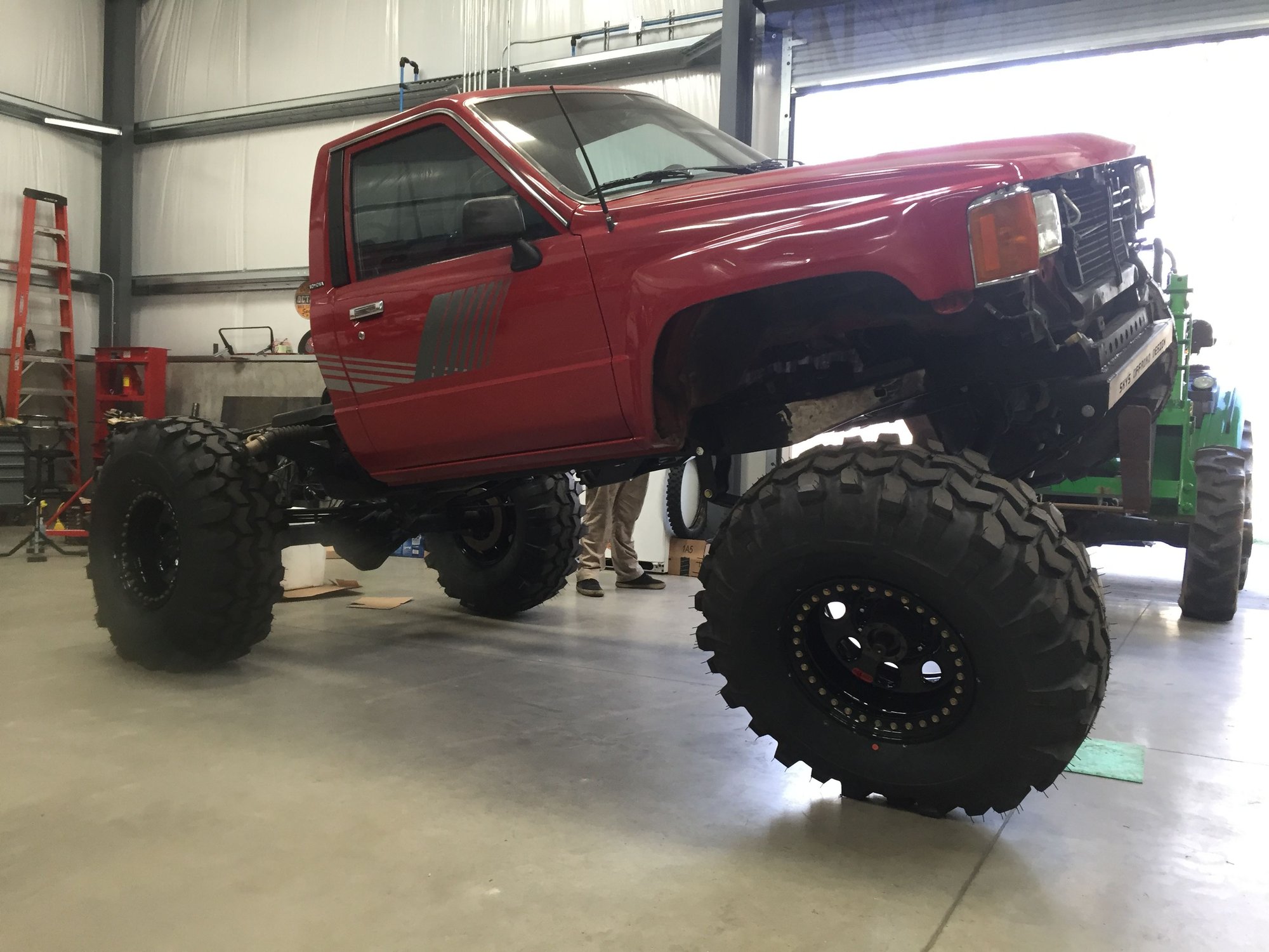

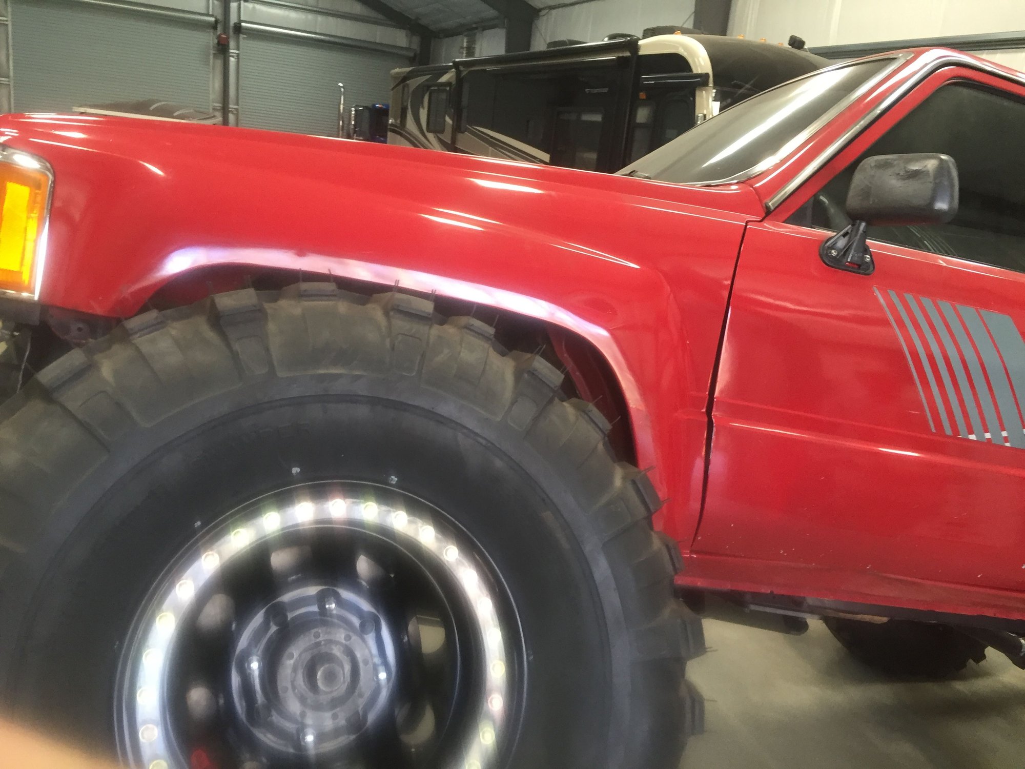

I ended up fork lifting it again but for the first time with the ruf. Then I cut the front fenders. I really like the new fenderline. Hopefully i cut enough but once im aired down and turning and flexing it'll be close.

Heres pics of the fender chop

42s? Looks like it. When I had 42s on mine I had to cut/beat/plasma a lot of the front body mount. Then I beat the crap out of the front wheel well (where your feet go). I want to say it moved it back an inch or 2. I'd still rub the tires in the rocks all the time. if I remember correctly the big trick was to light beat the pinch weld over, then take the big 8 lbs sledgehammer and beat the crap out of it.

No 39.5 and they measure out to right at 39 mounted. And aren't u running toy axles? With the width of the dana 60 i think im gonna clear the body but only one way to find out and that to get this pos finished and wheeling.

Lol yup I'm on toys still. Sorry 1/2 awake post this morning before I ran out for work. My bad sorry! But looking at the pictures I think your going to rub! Full steer it and flex it out again. Then you can build bumps now in the shop and have a better 1st trip out.

Ya i hear you. Im definitely gonna fork lift it again once the steering and brakes are done to make sure nothing binds or rubs. I wanna do high steer but I think the tie rod is going to hit the frame at full bump at a minimum and if i do high steer i need to make sure i mount the ram in a place that willnt hit anything either. Thats the only down side to running a low rig. But i like how she sits and im a fan of a low cog.
Edit: (the pics of it on the fork lift was before the chop. That why its so close) lol

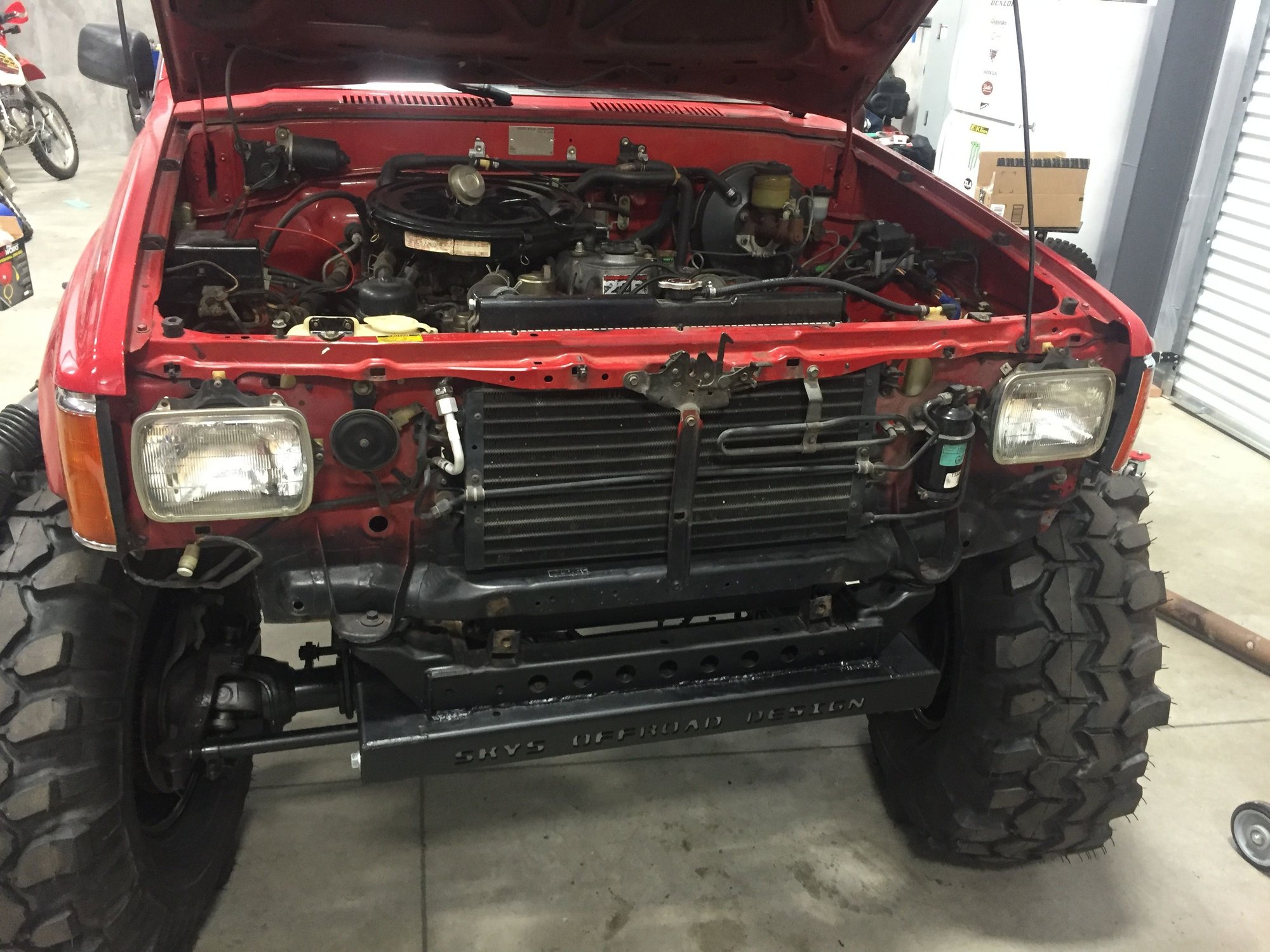

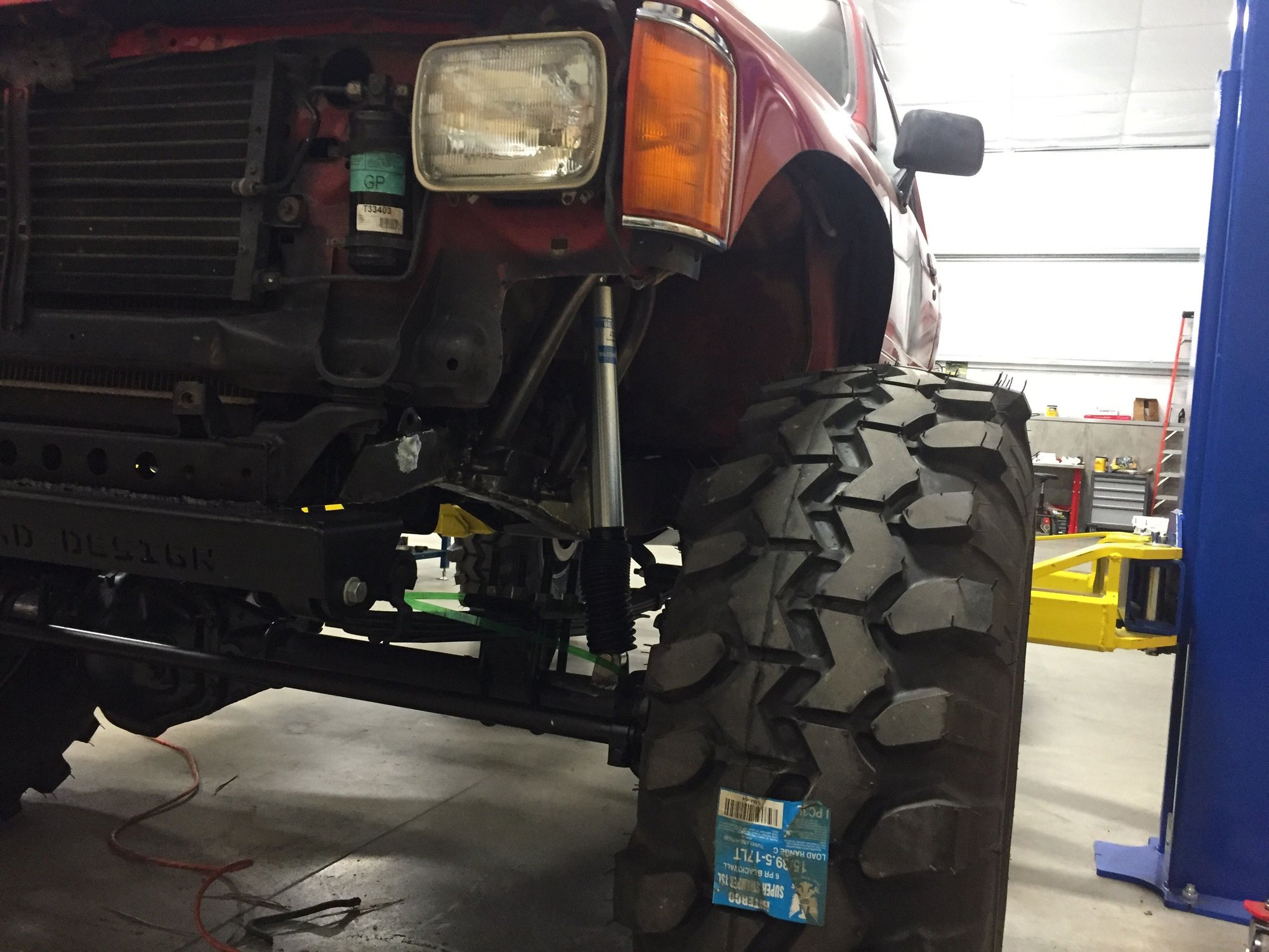

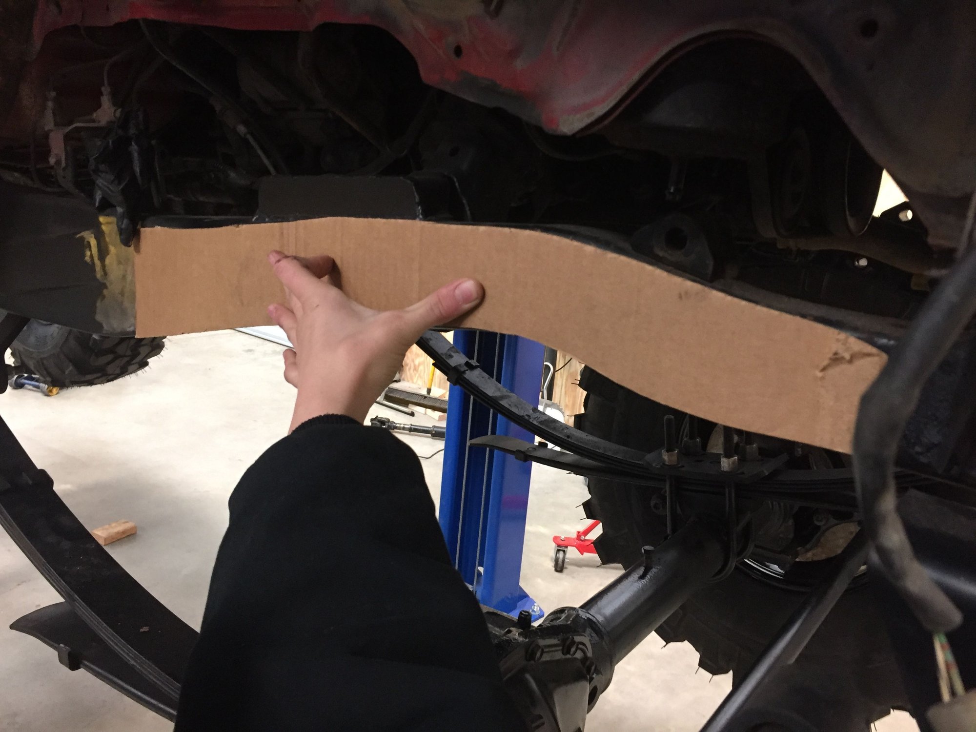

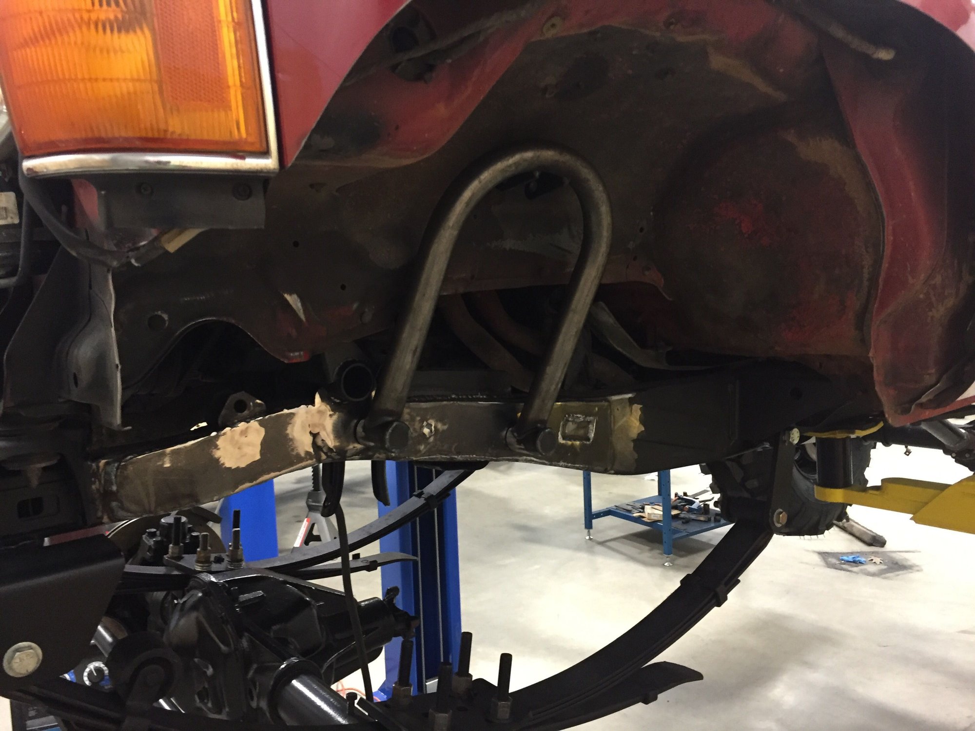

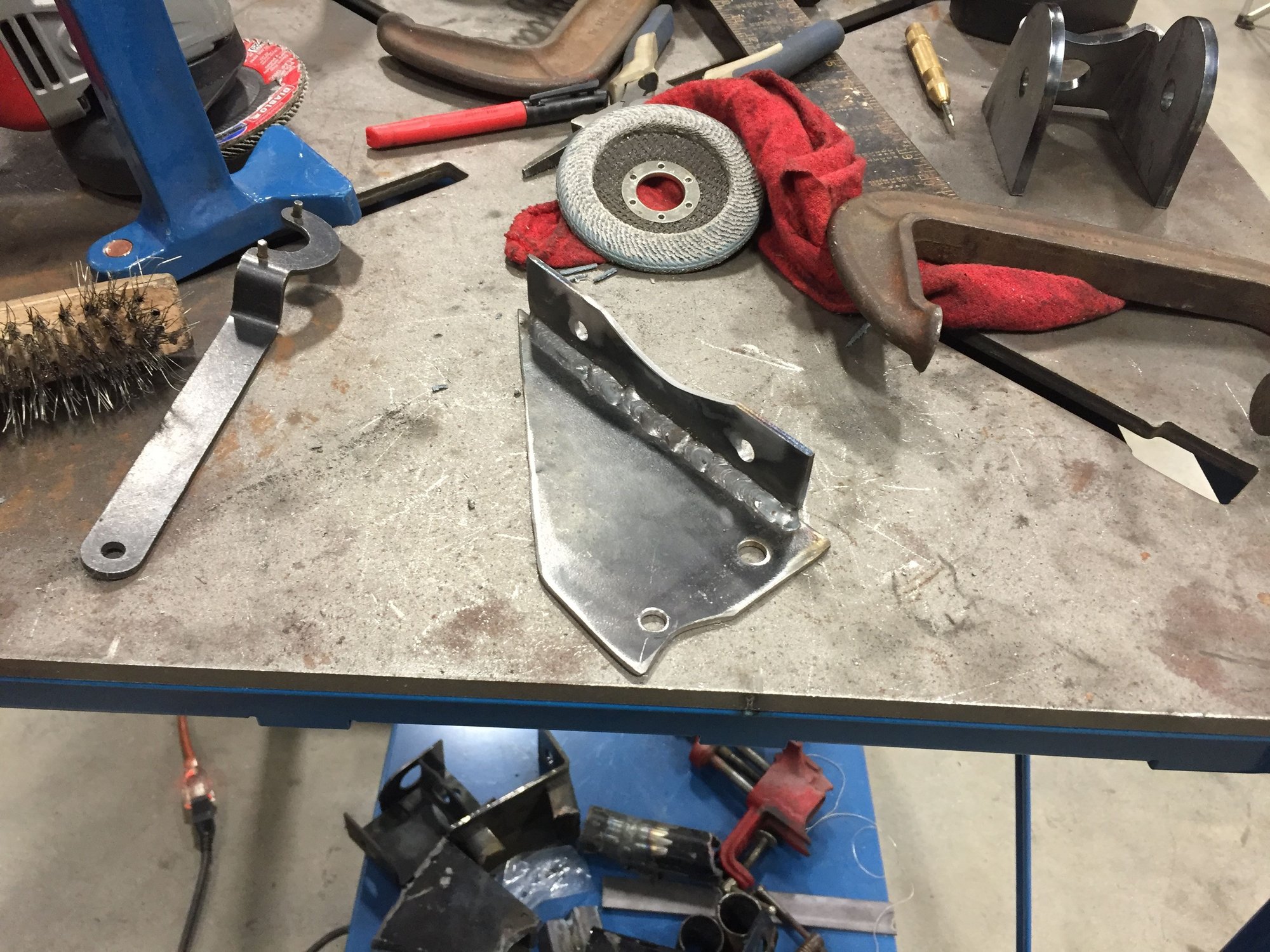

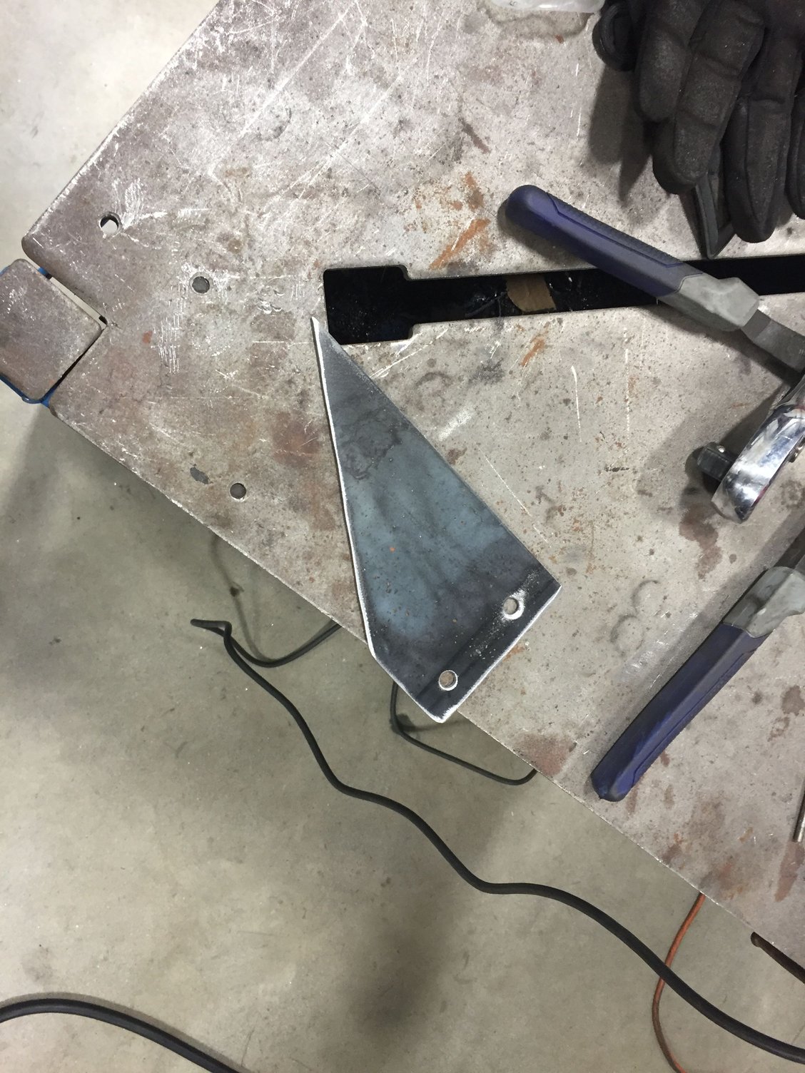

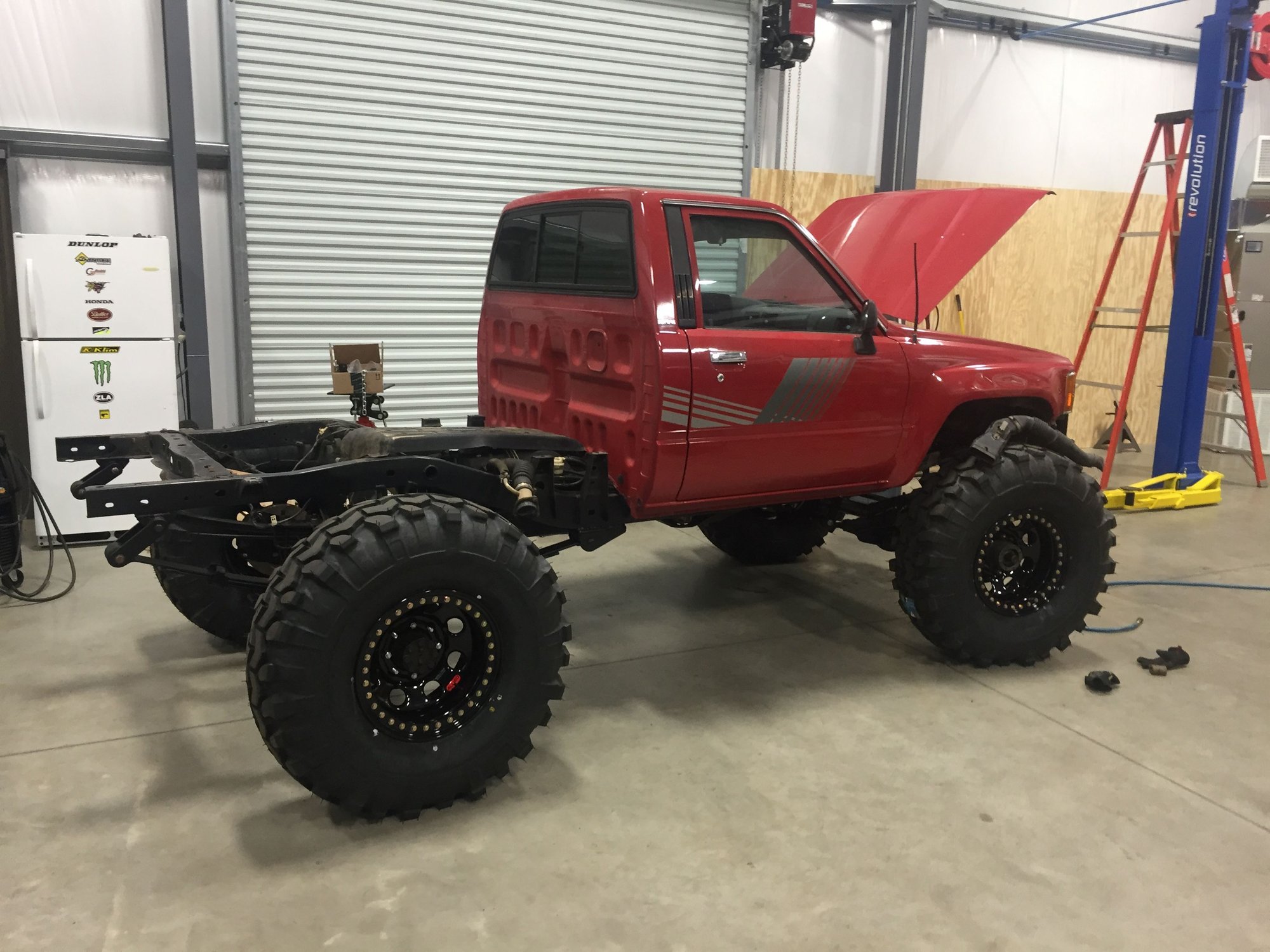

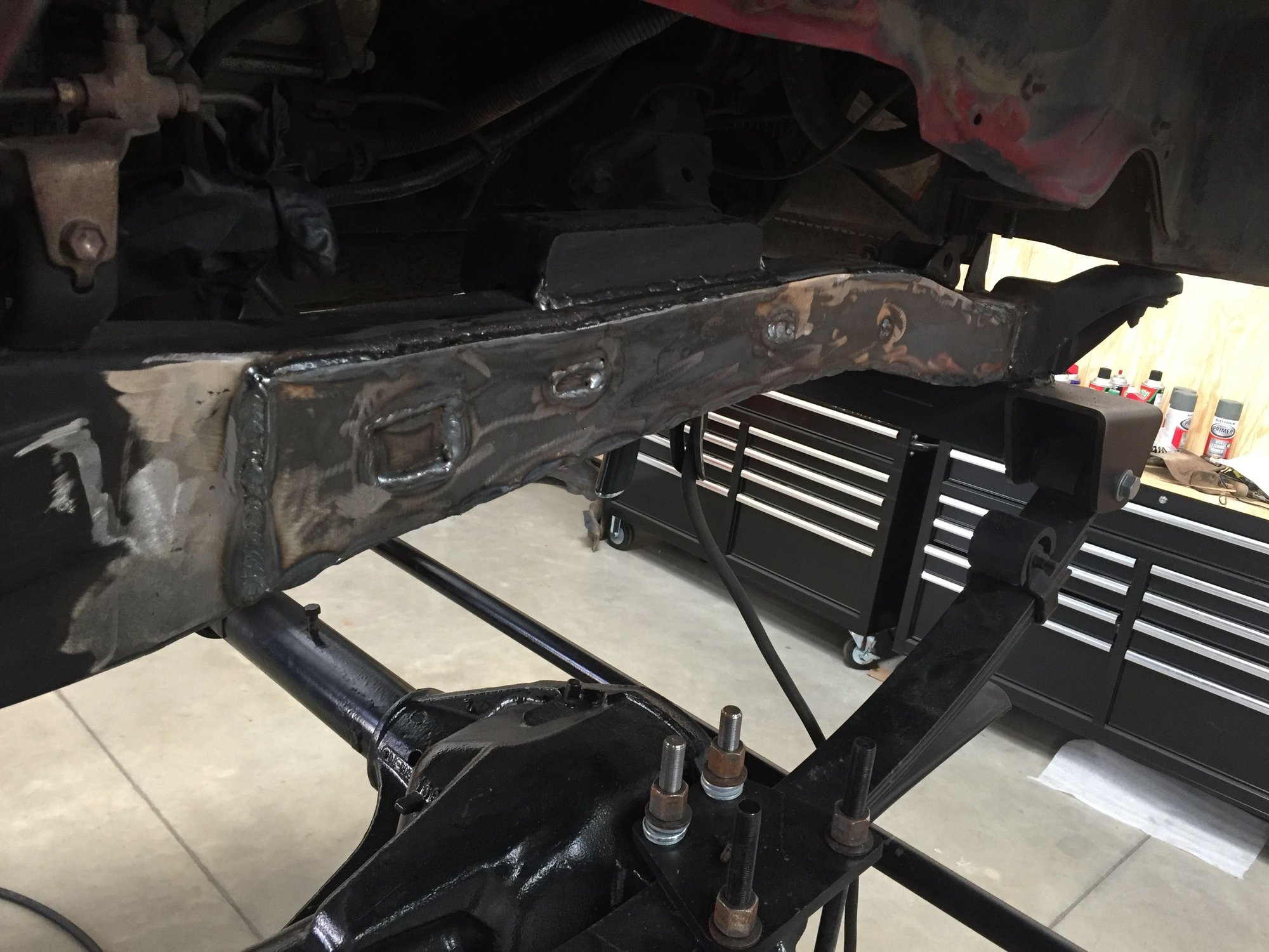

Well I've been pretty lazy about updating the thread but i have gotten a lot done. I have ordered all axle parts (r&p's and lockers), bought socks high steer arms, and all stuff to do brakes. I made custom frame stiffiners up front. Heres a bunch of pics of it all
