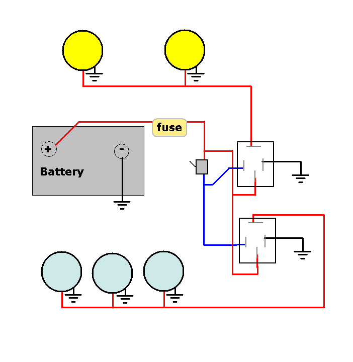

ok, so you can get rid of that wire from the lights to the battery. the frame of the runner is ground/negative, so just connect the neg of the lights to bare metal on the frame/body. also, give the lights their own fuse. if you plugged something in the outlet with the lights on (with what you've drawn), you could blow the fuse.
here is a circuit for the front lights
for each light (55 watts or less) add 5 amps to the fuse. here, you would use a 10 amp fuse
edit: the upside-down x-mas tree thing means "ground". in this case, its the frame or body

Ok that seems fairly simple. Is grounding to the factory bumper sufficient?

yep. that should work

yes. the frame is better than the bumper. but as long as it's bare metal and not something like a winch you're connecting, you should be fine. if not, then yeah, attach to the frame.

Alright thats good then, i'll probably end up grounding to the frame anyway. My relay's should be here in a few days. I'll let you know if i get stuck. Also what is the purpose of relays exactly?

to control a large load with a small load. in other words, you can control a bunch of lights with a tiny switch. that also keeps high amperage out of the dash. if the starter motor didn't have a relay, then 4 gauge wire would be needed to run to the ignition switch (key hole)

That makes sense, i assume that helps prevent wires heating up and starting my truck on fire (my biggest fear). So are you suggesting that i get multiple relay's and switches for my lights or run them all on 1 relay and switch? OR can you run multiple switches off 1 relay? Sorry i'm so unexperienced in electrical. I can do bodywork, i can do mechanical but i can't do electrical.

i suggest using one relay for the front lights, one for the yellow roof lights, and one for the white roof lights, each with it's own switch. if you want, you can run multiple relays from a single switch, so, for example, the roof lights would be controlled by 2 separate relays, but those relays would be controlled by a single switch:

Alright, i see. I'll pick up 2 more relays then.
