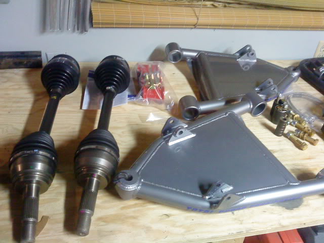

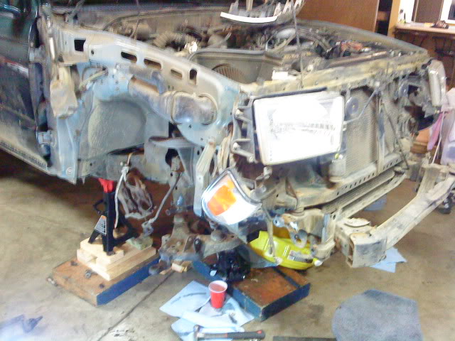

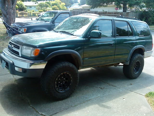

So the cv's went out on my girlfriends runner. Im guessing it s because of the 3'' revtek lift. So my solution was TOTAL CHAOS long travel kit up front, and a SONORAN steel 1.2 rear. (later on maybe deavers and some expensive shocks, but for now 1.2) Here are some pics of the kit and our progress.
BEFORE PICS

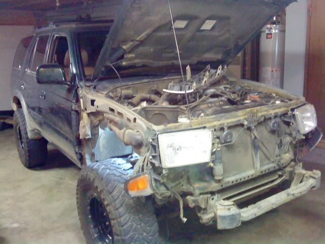

WORK IN PROGRESS

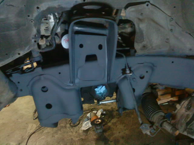

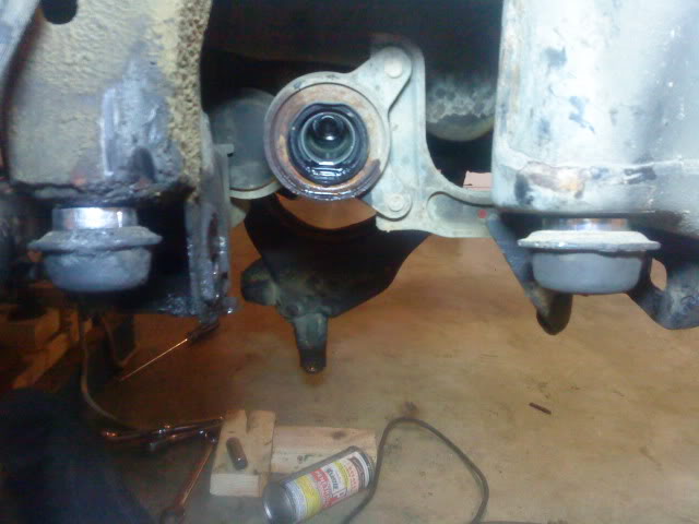

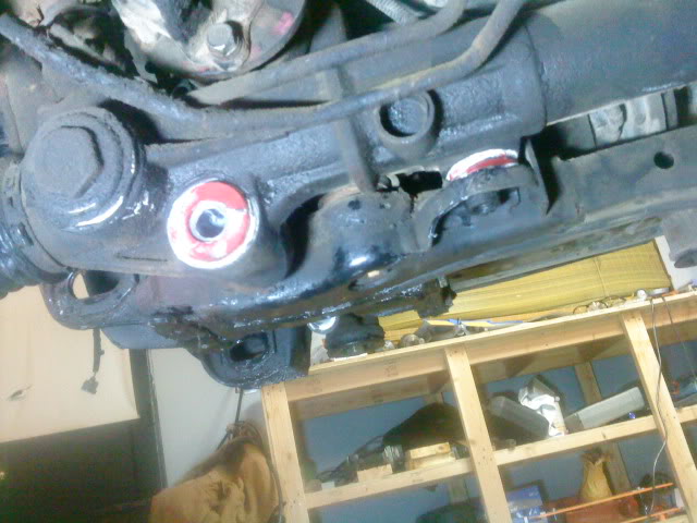

Tonight we didnt get a whole lot of progress, but we did some stuff. 2 of the 4 mis-alignment spacers on the lower control arms were rusted together so i had to cut them off with a sawzall. ugh that took forever and a few blades. Once we got those off we installed the new steering rack bushings and re-located the bump stops from the lower control arms to the place on the frame where they used to hit.
2 of the 3 steering rack bushings

FOUND SOME RUST TO GRIND AND PAINT before all the goodies go in.

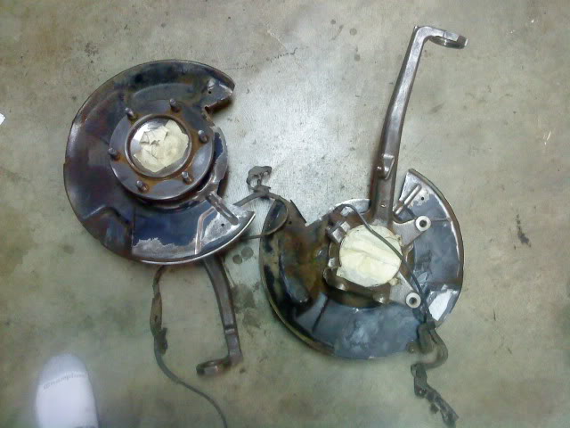

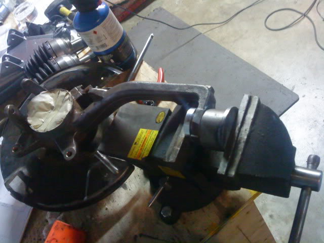

Also wire wheelin and cleaning spindles for gussets and paint

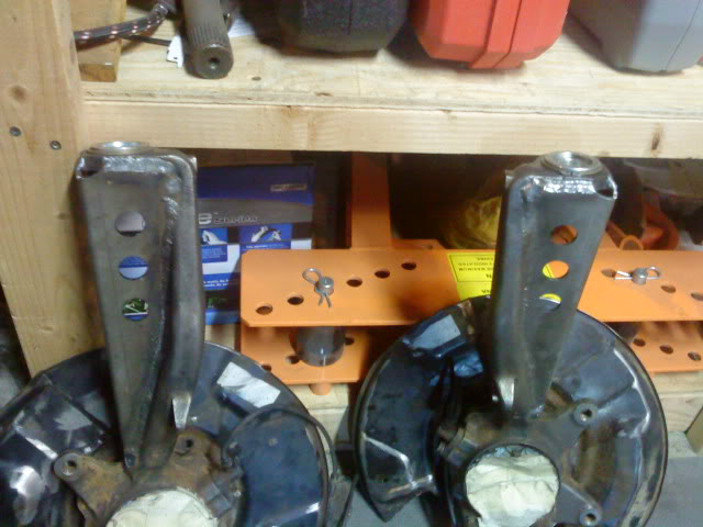

Got some more done tonight. I wish i didnt have to work so i could just do this all day. haha
Ash ground down the rust. There is lots of grinding to do, tryin to get it as clean as possible.

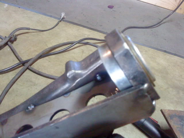

Also installed the uniball slug adapter.

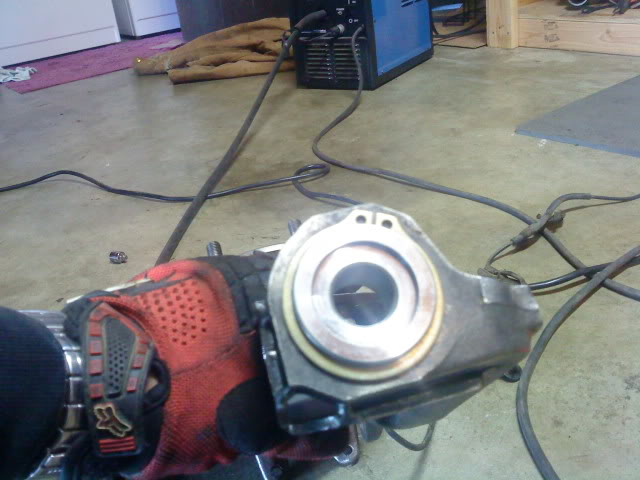

And welded on the Spindle Gussets
had to add this pic i just found in my phone. she took it when i was'nt lookin
