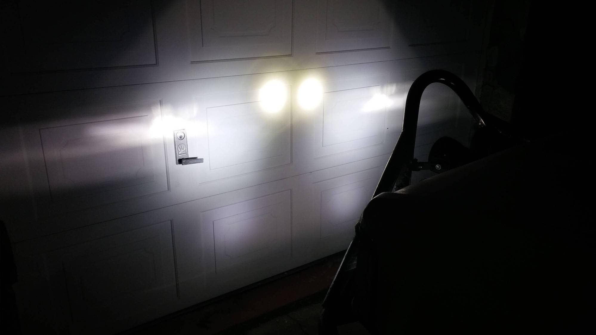

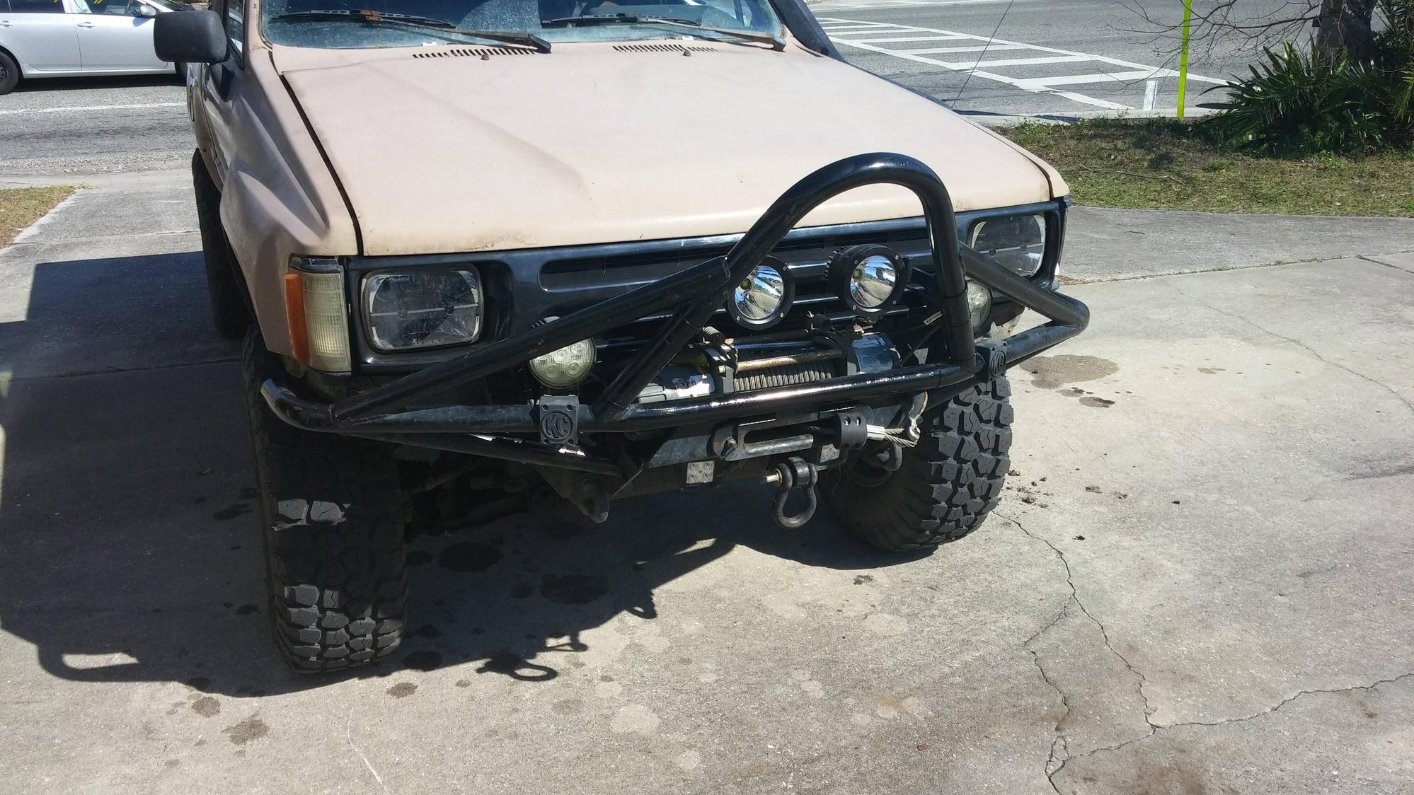

New engine installed, been working out kinks, coolant loss and oil leaks.... Trans input bearing seems to be going.... looks like time to save for a marlin W56HD... In the meantime, new grille (3rd gen 2wd pickup grille) and more lights. New lights are Aliexpress clone visionx 4.5" cannons and some stupid anzo dually clones that oreilly auto talked me into... not very impressed with the dually clones but I suppose they work well for seeing just in front of me and lighting up some stuff close to the truck when all other lights are off. Ordered 2 sets of hilux 2 bulb style corner markers, going to hope one pair is well glued (previous pair had a lens blow off on the interstate) and install some LED 194s in them.

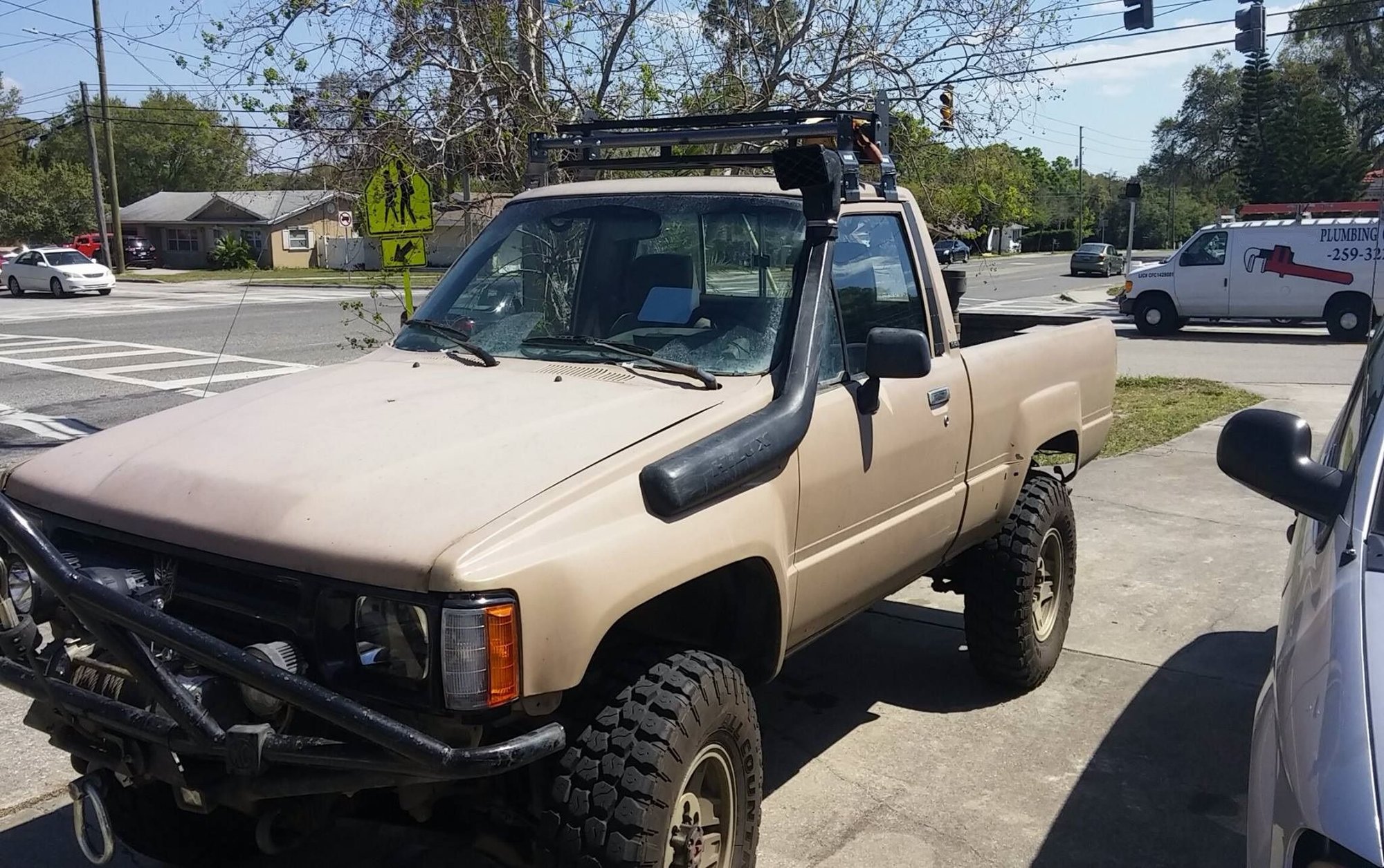

Built a roof rack using a cheap amazon gutter mount ladder rack kit for vans and a Harbor Freight 500lb hitch mount cargo carrier. Fun welding project.
