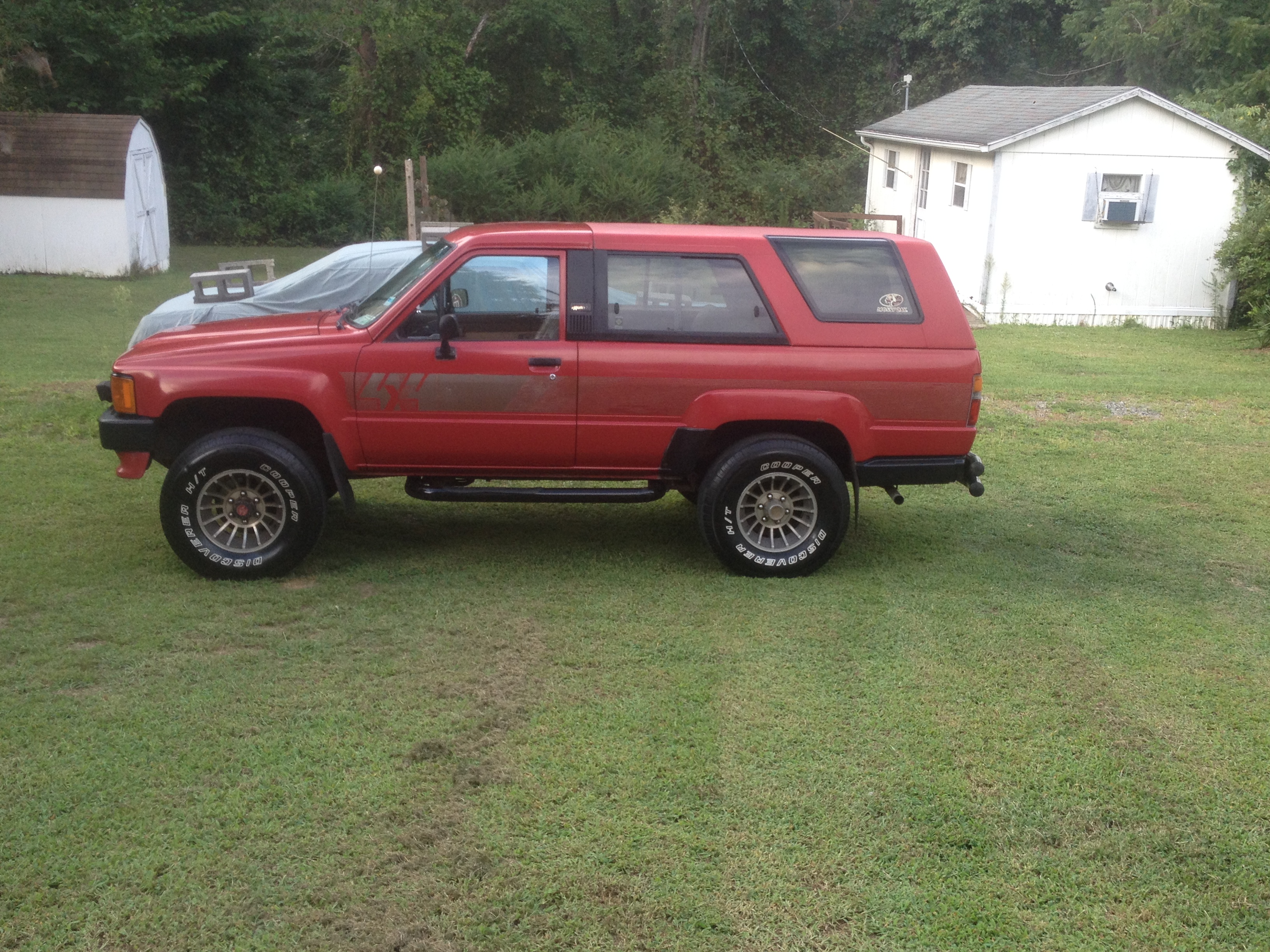

Maybe yall can see this

That's a clean looking 4runner!
I've done the "no cut" Zuk mod on both my 86' and 87' 4runner's. On my 86' I used 97' and up^ Jeep TJ front coil springs. They worked well, fit snug around the upper bump stop and the smaller end fit perfectly around the rubber bump stop. I was pretty happy with them, then sold them when I got my 6" AllPro rear lift.
On my 87' I ordered what I thought was jeep TJ front coils, but I'm pretty sure they sent me the rear coils, which still work, but I don't like the ride nearly as much, i have alot of potholes in my driveway, and the ride is a bit harsh. I will probably replace them with some front coils. Price wise they are cheap, you can find them for $20-$50 range on eBay or your local pic n pull. Alot of people use Black Magic springs too, but I don't have any experience with those. I think they are safe, I've never heard of anyone having any problems running them. I ran them on my 86' for a couple years, and flexed the suspension pretty good, they won't just pop out, lol. (My 86 had a SAS front end so would flex more than your IFS will.) Most people use a spring compressor to get the spring in there, I just used a bottle Jack between the frame and the leafsprings and compressed the spring a little with a ratchet strap. Hope this helps you out some.

Yea its pretty clean rusted, 5 speed 211,300 miles and counting. and thanks for getting back on this, ive read both your threads and am keeping up with the 87 now. Sucks you had to sell the 86. Thanks ill give it a shot cause ive looked the mod up on diffferent ones but wasnt sure
