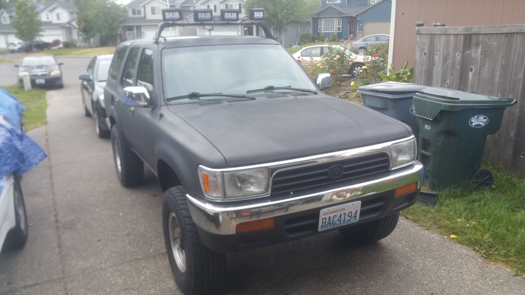

That's funny, I really don't like the color...and just painted it...still needs some touch ups...but...I'll give a little teaser of my progress...
Like I said, Iwill be posting up more about the progression and how I have got to where I am now with it...soon to come...
