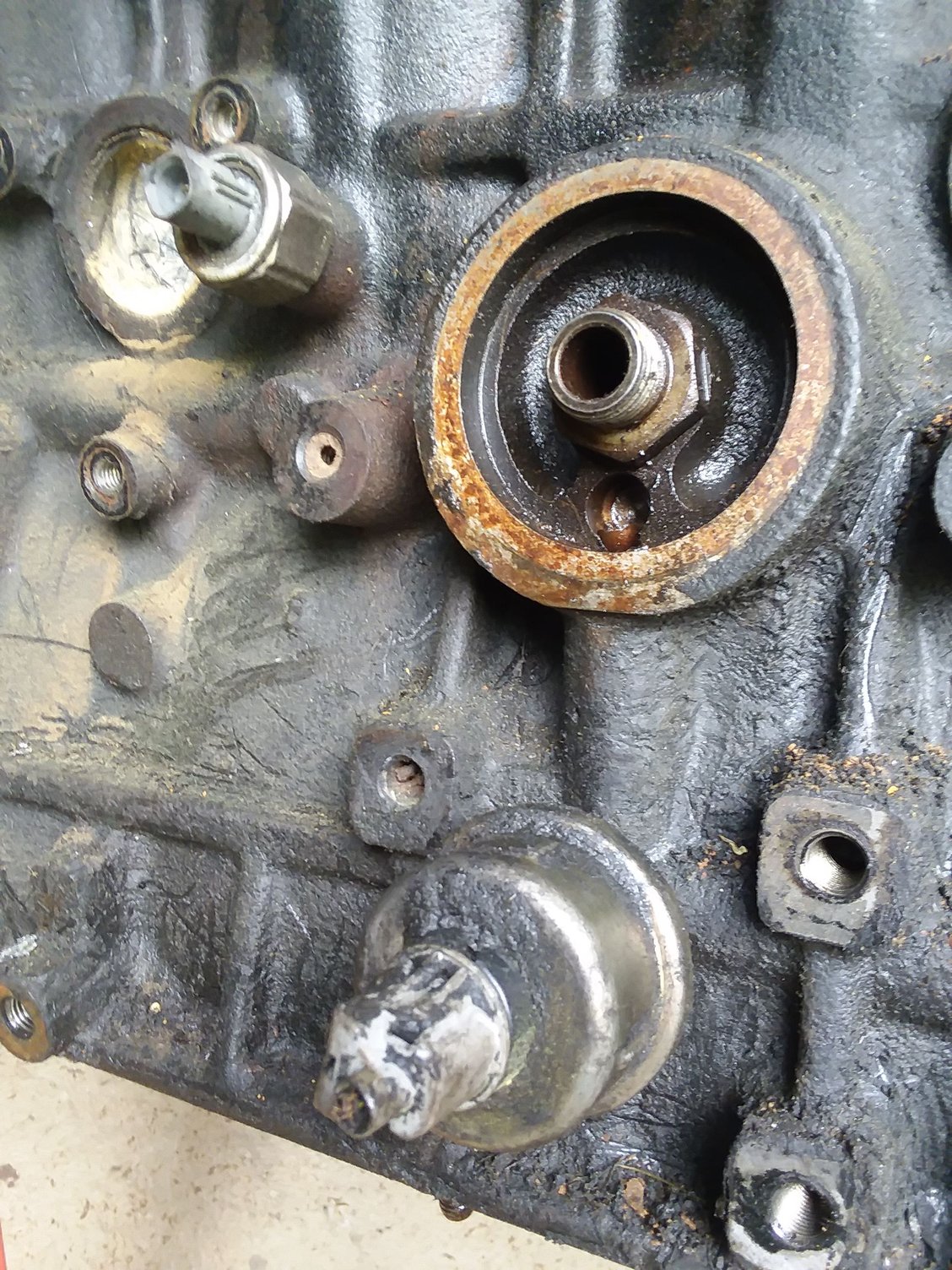

I will imagine I am not the only one who has had the wire wear in two on this little thingy under the oil filter. It didn't leave me much wire to splice with. What is that thing, and is splicing my only option?
Thank You.
Rg.

That's the sender for your dash gauge engine oil pressure. Dlx's like mine just have an idiot light to tell us we weren't checking our oil and now it's probably effed...
You can get a used pigtail from various sources, eBay or any of the reputable yota scrap yards are usually happy to ship stuff. Not sure if you can buy a new one.

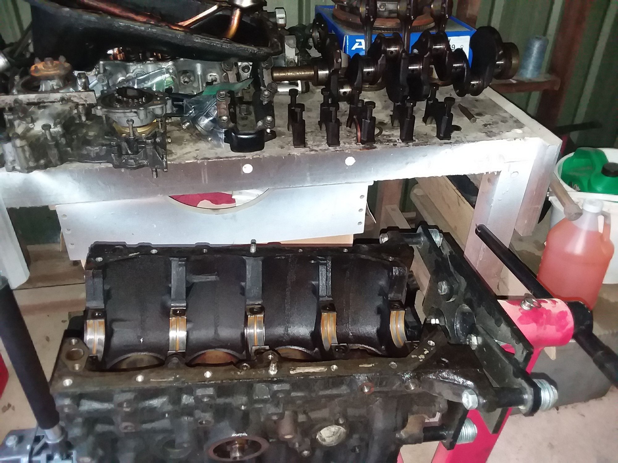

So, back at it. All bearing clearances are right down the middle. I am (was) ready to start buttoning the bearing caps down. Then I read a post about thrust washers?!?! Huh? You mean I was supposed to check something about the thrust washers? Check what, and how? I have no micrometer and I see no way of using plastigage. The machinist is VERY reputable. Did he forget to tell me something? Any input is welcome. Thanks in advance.....RG

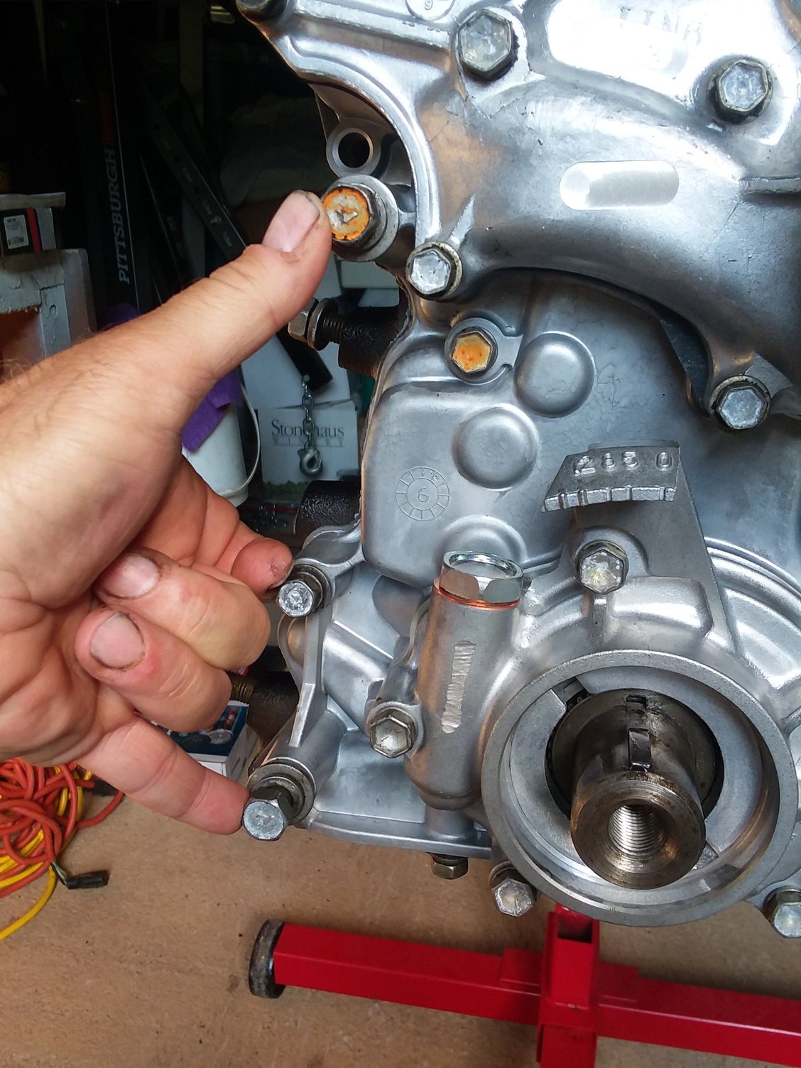

I was very careful to make sure these bolts went back in the right places. I kept my old timing cover, water pump and oil pump with the bolts where they belong.....suddenly however these bolts are not bottoming out. Am I missing a bracket or spacer. Thank You.....rg
Old Jun 22, 2020 | 10:31 AM
  #29
Claytonlane's Avatar
Joined: May 2020
Posts: 9
From: West texas
mine had a smog pump that went there and could be the ac compressor bracket I can check when I get home

This is off a 94 re we have at the wrecking yard I work at

Found it.
Thank You for responding. I found it after digging through my old pics. It's been so long since I started this build that I forget stuff. Plus I'm old.

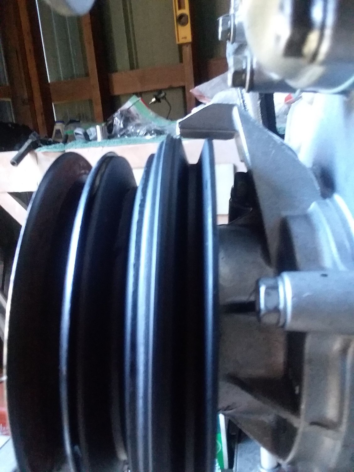

Looks Odd

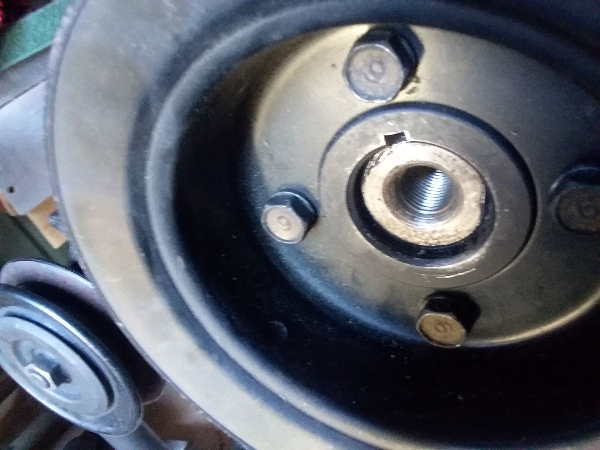

Installing a new harmonic balancer/crank pulley. Does this look right? I can't remember if this is as far in as it goes? Any help greatly appreciated.
