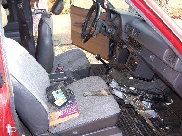

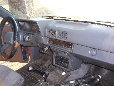

Before:
Attached Thumbnails Rice ETR 87 4Runner Build thread-before-100_0525.jpg   Rice ETR 87 4Runner Build thread-before-100_0526.jpg   Rice ETR 87 4Runner Build thread-before-100_0527.jpg

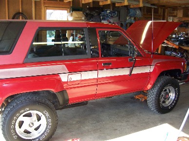

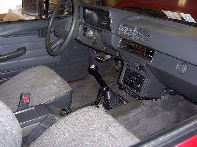

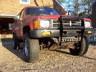

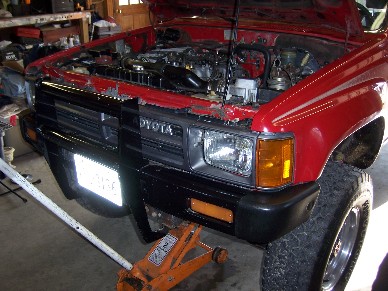

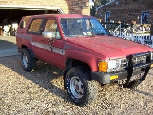

And after some elbow grease, two bags of trash, one of which was almost all mulch from the back and a fresh rebuild.....pardon the greasy parts and lack of shiny juice on the engine....I had just gotten it back together. Also, I swapped glass and put the original red door back on. Still need to polish the wheels again, they were gross!

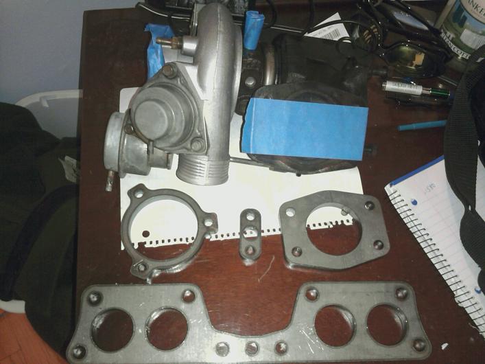

Well I haven't posted in awhile...I've done a few niknak things to the 4runner but my latest venture can be seen in the pic. I can't access photobucket from work but will put all the pics up from there so they are easier to see what's going on.
