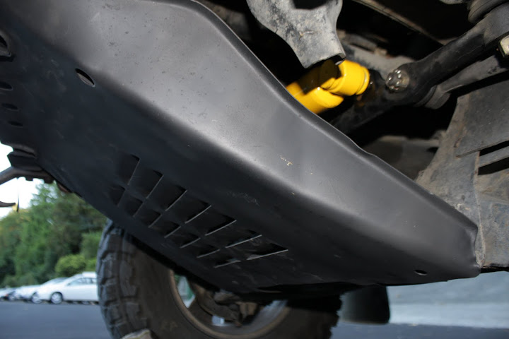

Couldn't wait, so I pulled off the brush guard and swapped out the steering damper! Makes a huge difference, can't wait to have the torsion bars and bushings done on the front end....
Also forgot to mention while I was putting the hose away, I hooked it on one of the leaf springs sitting in my garage. Long story short it tipped over, and landed square on the knuckle of my (bare) big toe. The toe is assuredly nice and broken. Its all sorts of green and purple, zero movement, swollen like whoa. Miserable luck...at least it cushioned the impact....

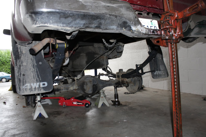

I got a late start today, so I decided to start with the (easier) rear suspension first.
It took a few minutes to jack the frame up, onto 24" jack stands, and get the axle housing and drive shaft supported by a cylinder jack and a couple more short jack stands.
(Another ninja edit image from the future, showing 3 different jacking devices used to position everything just so)

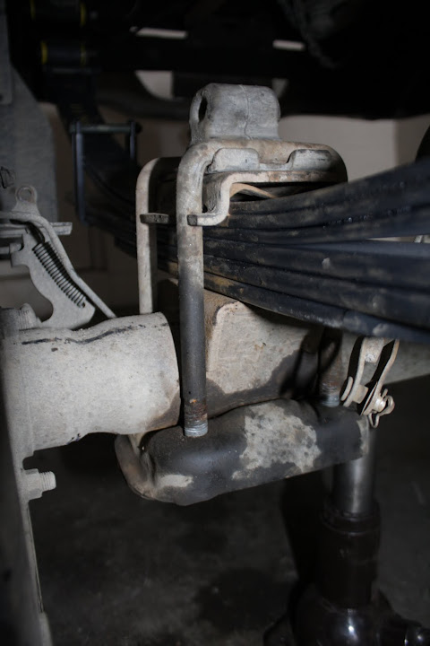

Hanger bolt nuts came right off, but the bolts themselves wouldn't budge. I missed all the threads about the pain and suffering they cause. Mine were just like everyone elses: completely seized. No choice but to cut.
Drivers side: I used a cut-off wheel to Grind off the bolt head on the outside, and on the driver side I had enough room to use a grinder to cut the inboard side of the bolt flush with the bracket as well. I then used a pickle fork to spread the bracket a little bit and pop out the leaf.
Unfortunately on the pass side, the gas tank is about 1/2" away from the hanger bolt and there is no room to get a 3" wheel in there (which is the only size arbor/wheel I happened to have on hand :C ). If I had a thin 5-6" wheel it would've been a snap... I didn't though, so I could only grind off the bolt head.
(Pass Side image, all done, from the future)
For the inboard portion of the passenger side hanger bolt, I ended up using a hack saw blade to cut through the hanger bolt on the -inside- of the mounting bracket. It took a while, but the spring fell right out, no need to coax it with a fork. For those of you bemoaning how "hard it was" to use a sawzall....I used -one- hack saw blade, no problem
Unfortunately, its Sunday afternoon and I can't get a bolt anyplace easy right now.

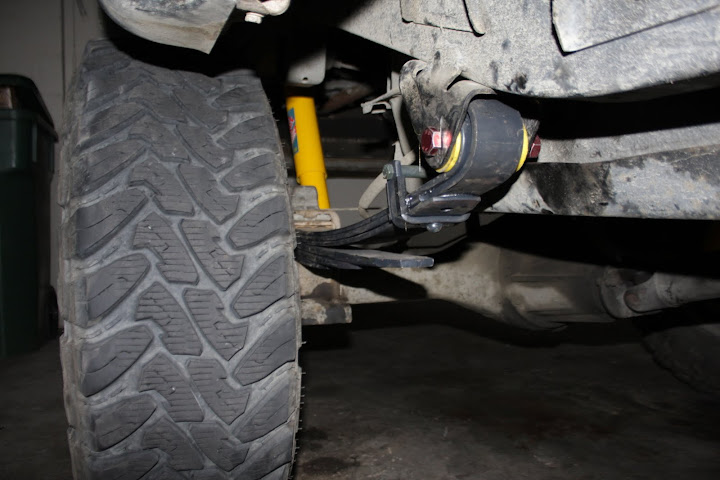

So after a few trips around town, I ended up with a couple 8.8 14mm x 100mm bolts. NAPA didn't seem to have any 10.9 14mm hardware in the size I needed, only the "weaker" 8.8. The guy convinced me to buy the grade 8 9/16 hardware "because its close" but it was much too large to fit in the bushing, and since the metal sleeve was so thin to begin with, I didn't think reaming it with a 9/16" drill bit was really the way to go. I went back and bought the 14mm hardware and it fit like a glove. As I understand it, the 8.8 is a little more ductile, it'll bend, but won't snap easily. From what I understand, the 10.9 is stronger, but more brittle, and prone to shearing.
It cost like 14 bucks for the bolts, washers, and nuts. Home depot had something similiar for around 5 bucks, but it was cheap galvanized 'general purpose' hardware, and I really didn't want to have my everything being help up by 2.50 that I didn't fully trust.
As you can see, everything got installed, and it is waaay up there now. The rear shocks I removed were completely lifeless. Wherever they are compressed to, they just stay there...and the springs are -very- flat. The ass of the truck is pointing way up now, because the front isn't done

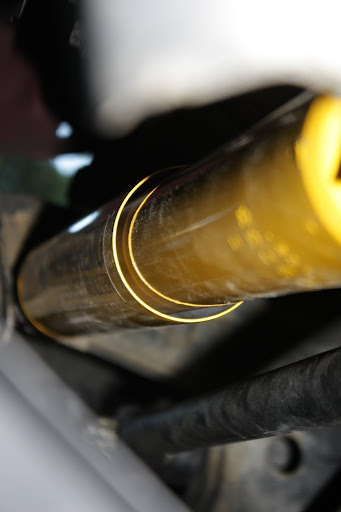

Well. Torsion bars are a real bitch.
I got em out, but it sucked. The tension bolts were really bound up, even after a few days soaking in pb blast. The new struts and t bars really make a huge difference. I'm taking it in to get an alignment tomorrow. Pictures soon
