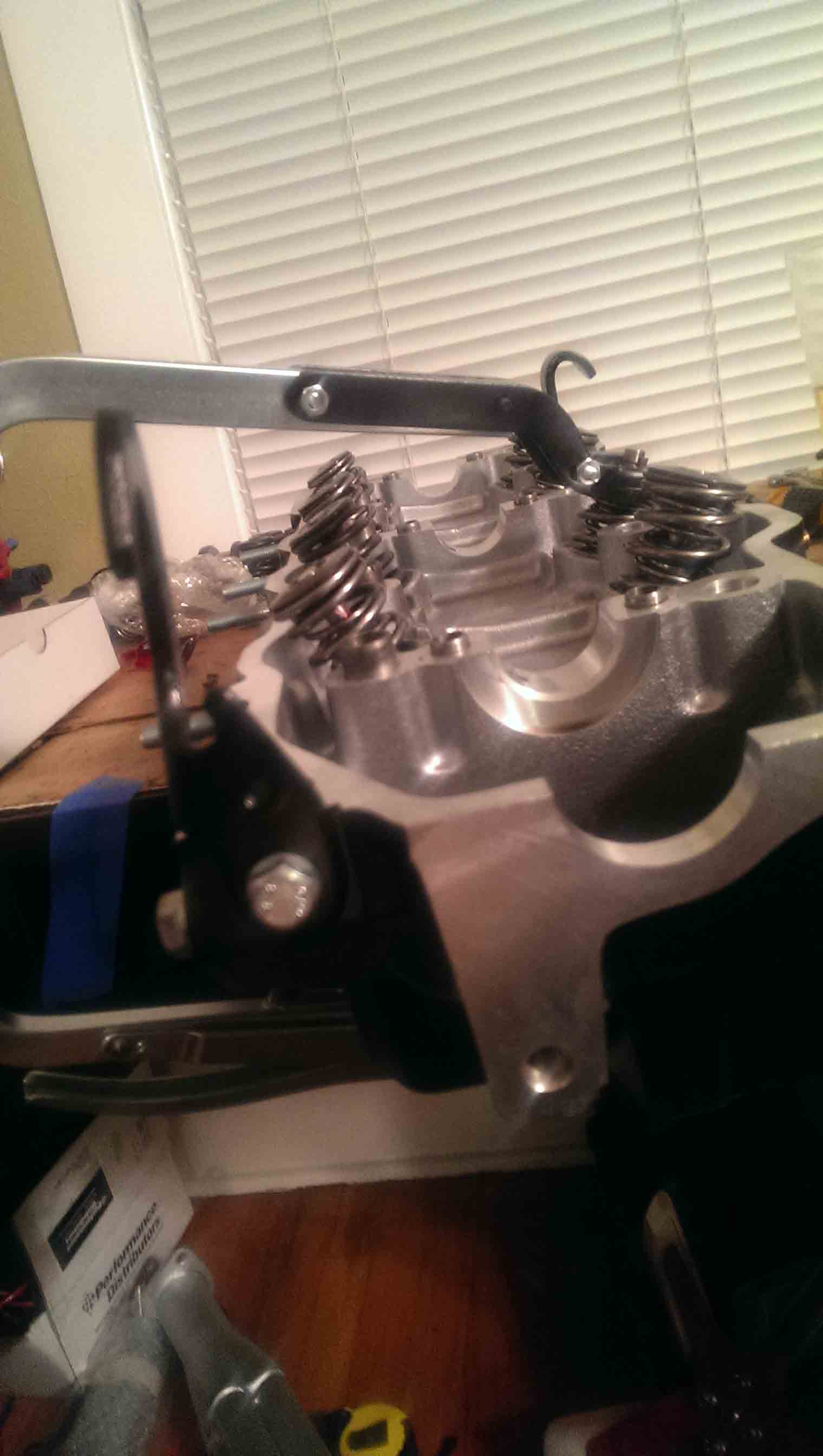

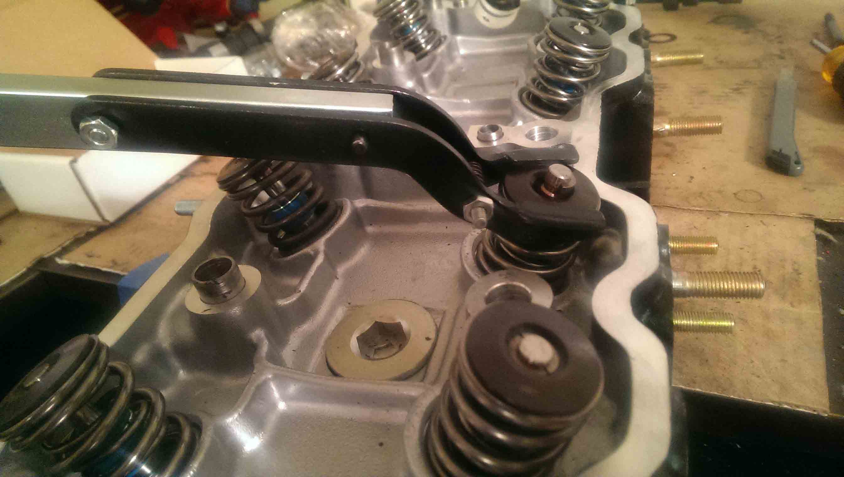

here's some shots of the actual removal / installation of the springs.

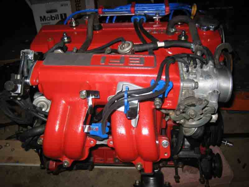

This weekend I'm going to get the head bolted up, along with any remaining brackets, the exhaust manifold, intake, and start piecing back together the vacuum lines. With removing the center vacuum line metal tube thing (sorry I don't know the technical term for it), along with the EGR, PCV, and other emissions crap, I'm sure I will have some of the lines capped. I also plan on making some easy metal brackets and using some spark plug separators to keep the vacuum lines clean and organized like the image of a fellow YOTATECH member's engine shown below.
Every hose I'm replacing is upgraded to Silicone, including all of the vacuum lines, as well as the upper and lower radiator hose. I'm not 100% sure on what belts I'll be getting, but I will definitely be purchasing whatever turns out to be the best, and will also be buying extras to keep in the truck, JIC.

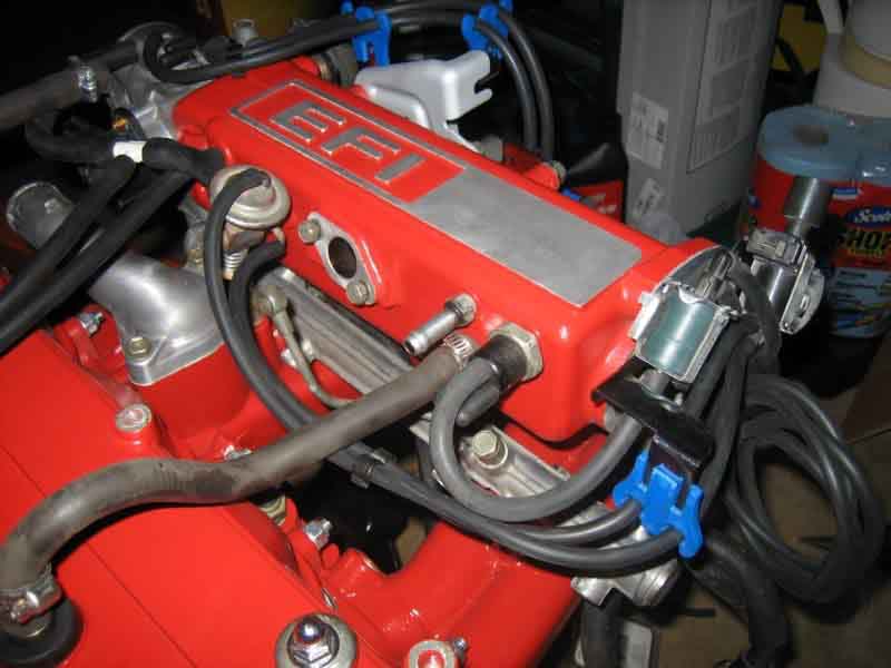

HA! I wish I had a garage or even a paved driveway to work on as well. I'm doing this in a gravel drive and my living room....Even a carport would be a huge help, but sometimes you've just got to work with what you've got.
Also, the above images aren't of my engine...they're ones I found on here and liked. I just got the head finished up at the end of last week, and will be bolting it to the block tonight, and then getting the intake, exhaust, other brackets and components, and the vacuum lines installed / assembled each night after work this week. I'm hoping to have everything ready to install this weekend, and may even take off Friday or Monday to make sure everything gets finished up.

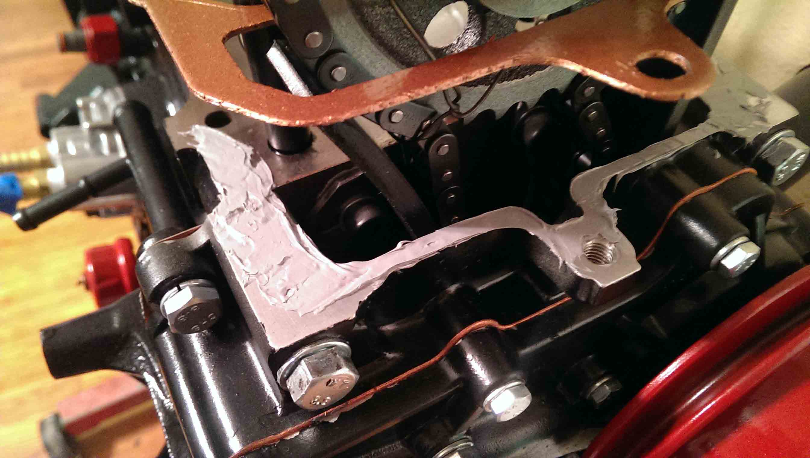

I got the head bolted up last night. Before I did so, I finally installed the front "seal saver or sleeve" which is a very thin bearing metal to help protect your crankshaft / pulley from wear by the seal. I know it sounds ridiculous that a rubber or plastic part could wear into the metal surface, but I've seen several instances where the wear was a good 1/16" - 1/8", and this bearing metal is much more resistant to wear, which means it makes it a much tighter fit with less oil leaks and less issues in the future...aka more bulletproof.
I know a lot of people have their opinions on whether or not to use any type of gasket sealer or coating, but I have used Permatex copper coat on every paper gasket so far, and decided to go ahead and use it on the head gasket as well. I used a Nippon made in Japan Very high quality head gasket, and coated it completely with copper coat. I installed 6 of the 10 ARP head studs to keep the gasket in place, and help properly guide the head into position, and keep it from sliding around. I used Ultra Grey RTV silicone on the entire front timing cover (and evenly spread it with a razor blade to prevent excess "bulging"), and had previously shaved the excess gasket material from the Timing cover gasket off with a straight edged razor. It is very important to get rid of that little bit of excess gasket to keep leaks from happening there.
Here is some pictures of the copper coated Nippon gasket, as well as an up close shot of the Ultra grey around the front lip. There are a lot of "Tips and Tricks" out there about how to get the Camshaft timing sprocket onto the camshaft, and my solution was to use a wrench handle to give the right amount of leverage and lift (with a rag on the soft aluminum surface so the wrench doesn't scar the head), and a non-marking hammer to gently tap it onto the dowel pin. Remember, you don't have to get the sprocket the entire way on at first, you just need it in place enough to get the distributor drive gear, spacer (important!), and bolt in, and then let the bolt drive the sprocket back until it is completely seated.

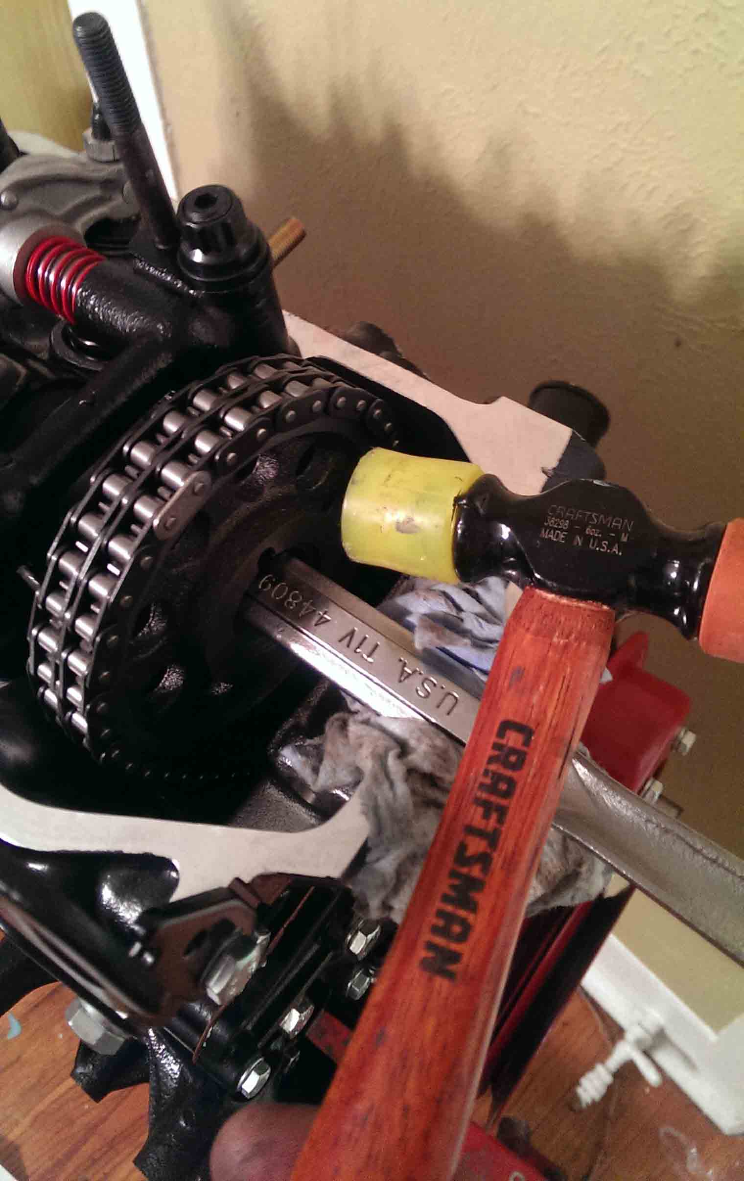

Getting the Timing Right....the first time
making sure everything is in the right position as it is installed is essential to getting the timing right. You may have to "wiggle" the crankshaft to get the timing chain tensioner to release and allow enough slack for the camshaft sprocket to go on. If you do this, make sure that the pulley lines back up with the zero when finished, and that the camshaft dowel pin is at 12:00.
As you can see from the picture and the location of the magic "silver link" in the chain, I had to jump the chain a row to get both the camshaft dowel pin at 12:00 and the mark on the pulley at zero, but both are dead even, and in reality, the silver link on the chain could be anywhere along the chain as it's more of a guide / reminder than affecting the actual timing.
Once you've got the camshaft and crankshaft aligned together at TDC on cylinder #1, the next biggest step in getting the timing right is the installation of the distributor. If you'll notice the grooves in the drive gear on the distributor and how they line up with the distributor drive gear bolted to the camshaft, you will realize that as it slides into the grooves, it will go counter-clockwise a little bit....usually a full groove. Therefore, my suggestion is to start one gear tooth further clockwise than you think you'll need, so as it slides on and rotates counter-clockwise to mesh up, it will be positioned properly. All of this takes place of course with the distributor rotor pointing directly at the #1 spark point (same position of the screw that mounts the silver clip). You also want to make sure that when bolting the back adjusting screw on the distributor, that you're not maxxed out to one side or the other. This will allow you to slightly rotate the distributor to retard or advance your timing later.
Attached Thumbnails Quest for a more bulletproof 22RE - 89 4runner engine build-imag0768.jpg   Quest for a more bulletproof 22RE - 89 4runner engine build-imag0769.jpg   Quest for a more bulletproof 22RE - 89 4runner engine build-imag0767.jpg

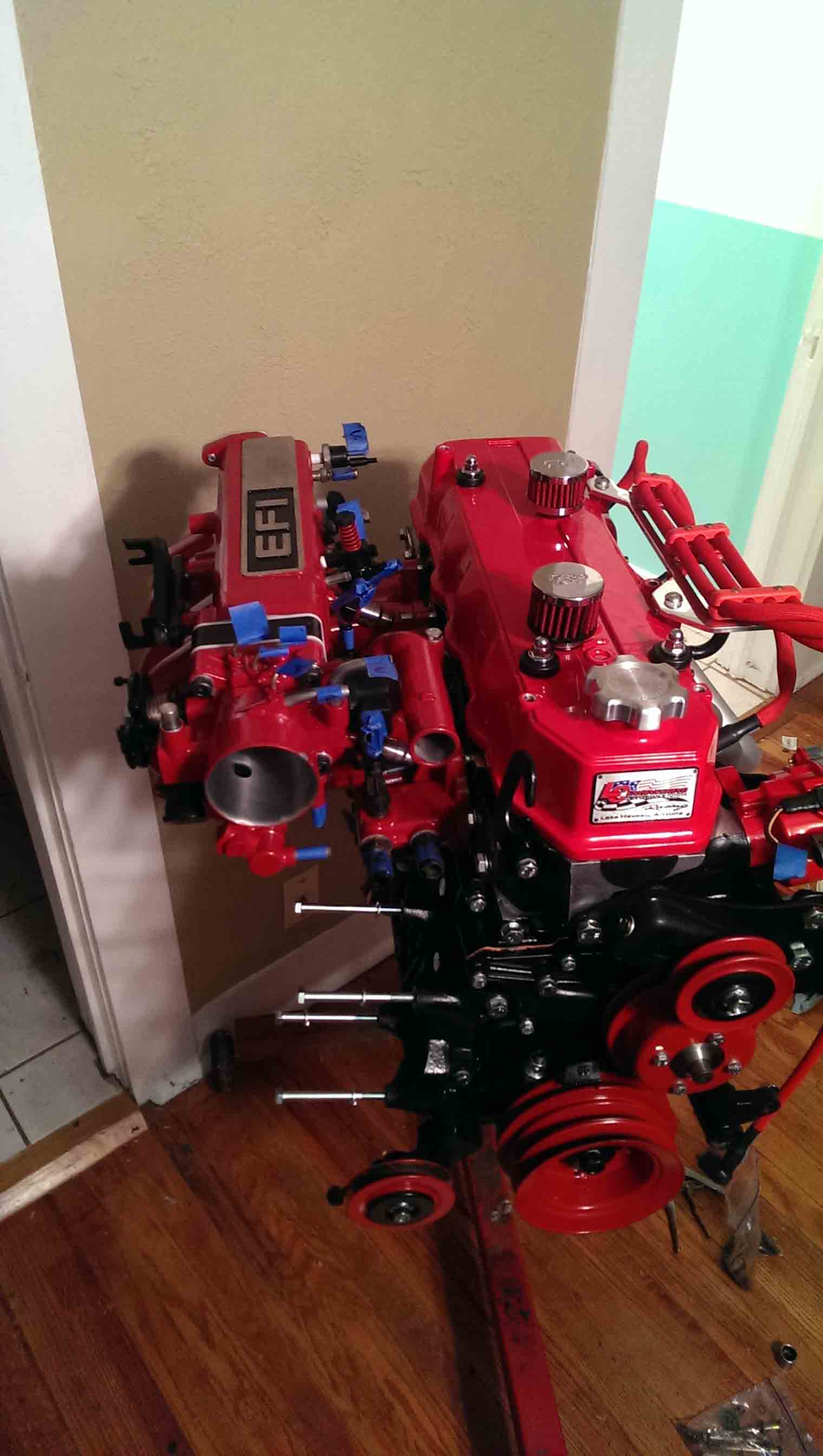

I got so excited to have the head finally on, I threw up the intake and exhaust, and bolted on the valve cover to give me an idea of what the finished product would look like (and to let the valve cover sit overnight so that the ultra grey I put on the hemispherical rubber grommets would cure and hold them in place - one more bulletproof step. Here are a few shots.
As you can see, I've replaced all of the hardware with grade 8 SS bolts and washers / lock washers, most of which have a larger 17mm head than the original. I also put blue locktite on every nut and bolt just an over-precaution to make sure everything stays as tight as possible.
I'm going to strip the powdercoat from the "TOYOTA" on the valve cover to reveal the bright aluminum underneath, and then paint the galley with black so it matches the intake (yeah, I'm one of those guys that likes his stuff to match).
Once that's finished, I'll try to get all of the vacuum lines dialed in and re-routed with spark plug separators. Then I'll get the 35LB billet flywheel and LCE pro Clutch bolted up and will be ready to hopefully put her in this weekend.
I'm going to make sure that before the installation, I get back inside the engine bay and clean everything with Purple Power degreaser. I'm not a clean freak, but I am overly cautious and want to know the instant there is any type of leak, and be able to easily spot the source.

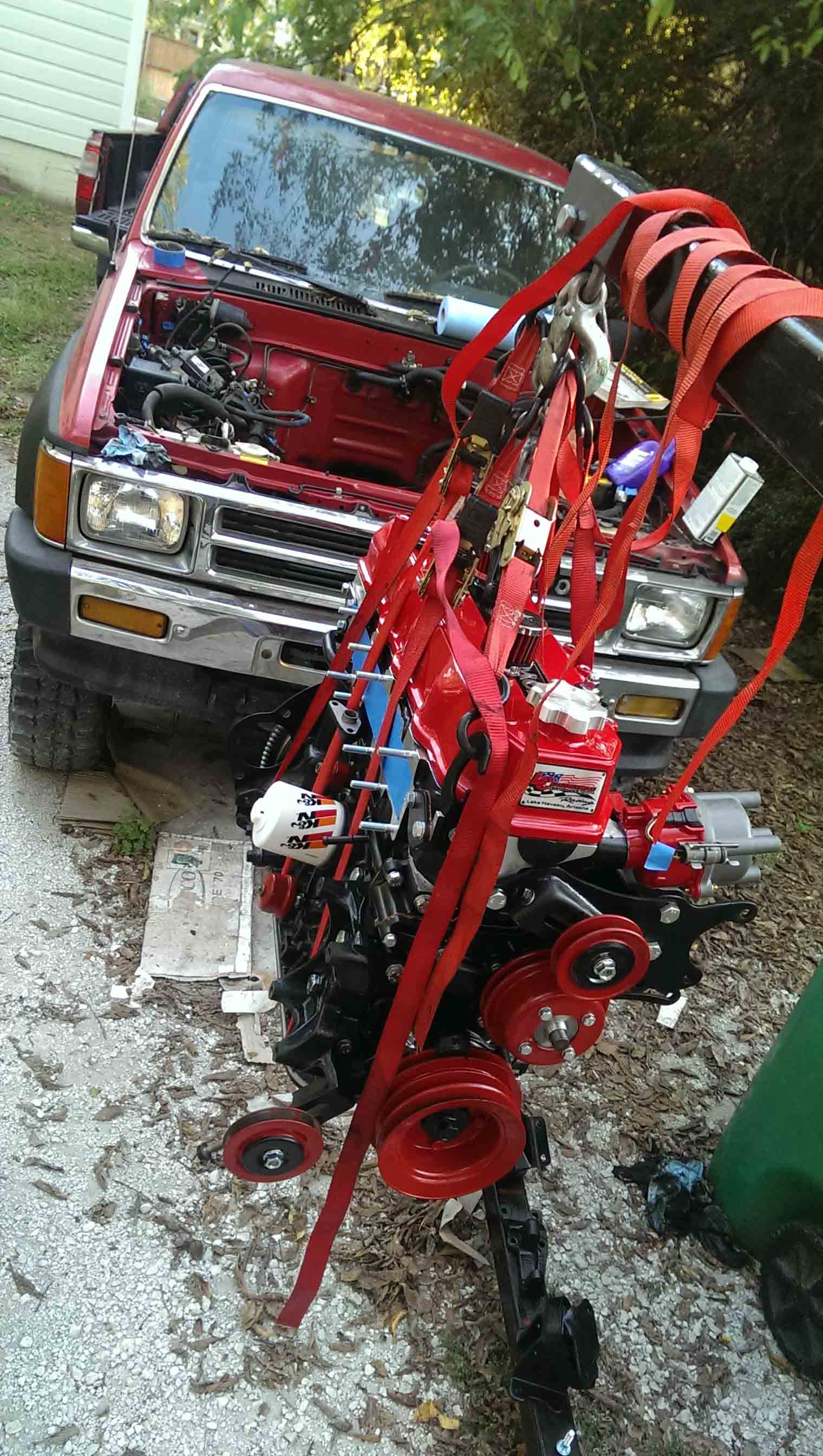

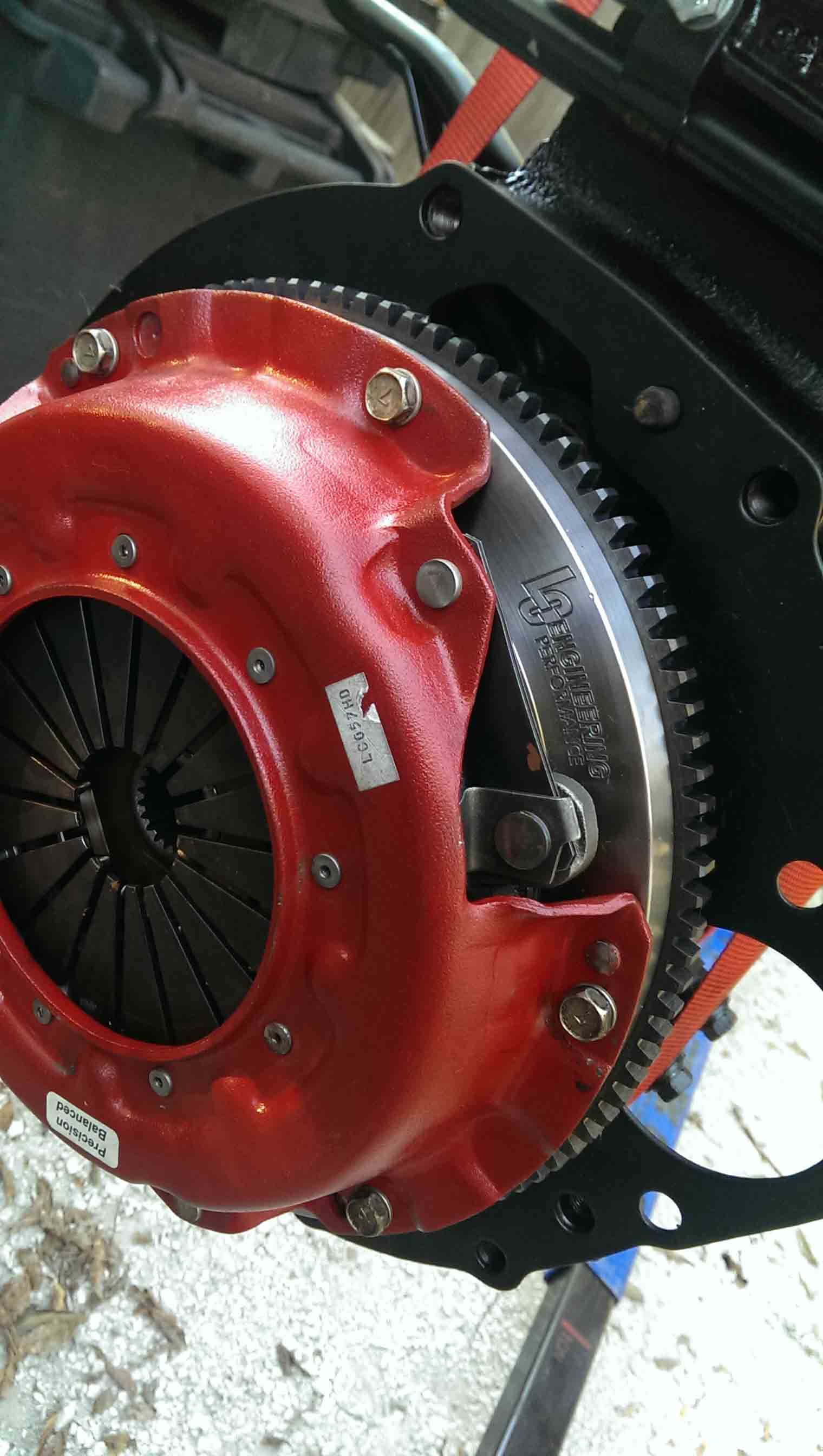

Dropping the 22RE back into the 4Runner
After work, I picked up the engine from the mechanic's, got it loaded back into the truck, unloaded it at the house, and installed the rear seal saver, the LCE 35LB flywheel, and LCE pro clutch. Then, along with the help of a few Shiner Bock beers, got the thing lowered into the engine bay and bolted up.
because most people end up putting the wrong bolts behind the flywheel to hold on the cover, I went ahead and just left those off, and let the pins align the cover, finally sealing up after I bolted the trans up. Almost every engine I've torn down has the two bolts that hold the cover on completely marred and ground down by the flywheel because the people installing it didn't use the super thin head bolts that you're supposed to. I don't think it'll hurt a thing if they're not used, as long as your cover stays ligned up during the install until you can get the motor mounted to the tranny. In fact, I think there's less of a chance to screw up your flywheel and have a horrible grinding sound if the bolts that normally cause this aren't there.
Normally, I would have wanted to have the intake, exhaust, and everything else already bolted up to the block before installing it, but because I had rented the hoist from sunbelt, I was under a $40 a day timeline to get it in, and return the hoist...and decided just to install the longblock without everything bolted up.
In doing this myself, I didn't install the alternator bracket, the radiator return tube, or the motor mounts, because I needed the "wiggle" room to align the tranny and motor up so I could get them to mate.
I must also say, I beat the heck out of the old throw out bearing trying to get it off the cast iron fork clip....mainly because I didn't have a gear or steering wheel puller....but we all know who won that fight.

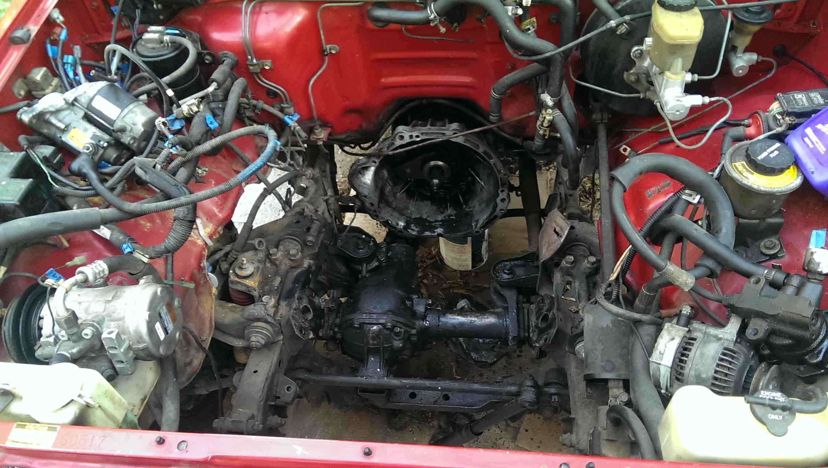

Here are some shots of the empty engine bay with all of the accessories (ac, power-steering, wiring harness, etc) pulled out of the way and ready for the install. The motor hanging from some ratcheting straps (best thing ever if you don't have a "leveler" or chain for the engine), and a picture of the LCE 35LB flywheel and Pro clutch bolted up.

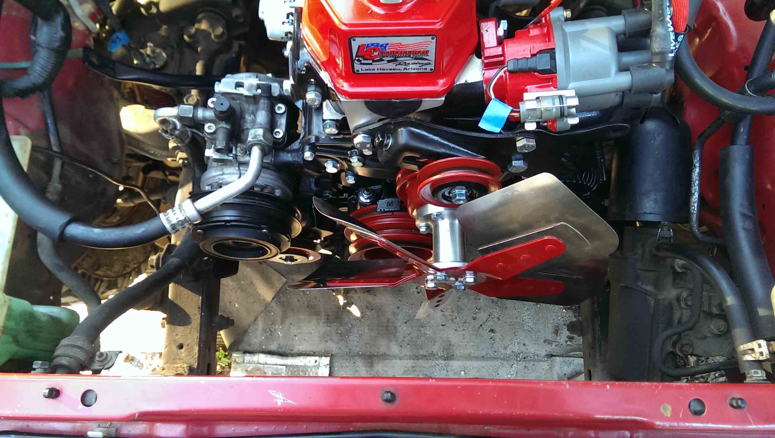

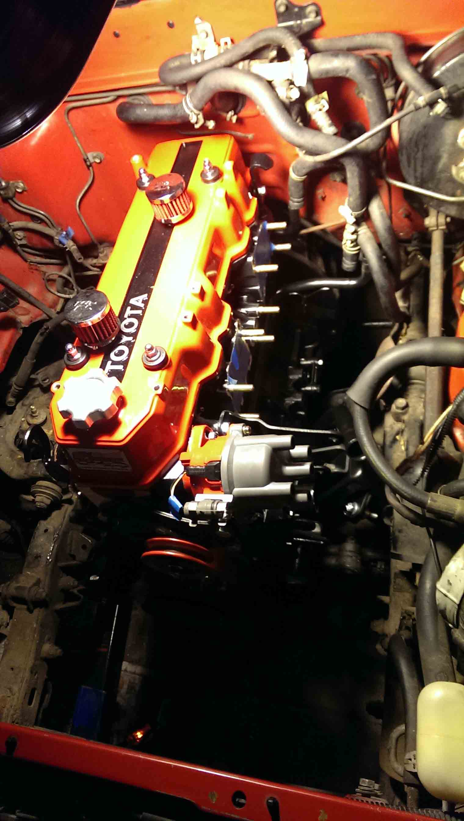

Here's a picture of the motor when I finally got it in and bolted all the way up - yeah..it was already dark, and I had resorted to the infamous clamp light.
The ratcheting straps look a bit gangster in the previous pictures, but were priceless when trying to tilt the motor at the right angle to get the splines to match up, because once all of the straps were on, I could ratchet one or two up and tilt or rotate the motor accordingly....almost like I had the right tool for the job (an engine leveler).
I'm pretty busy with work this week, so I will try to clean up all of the accessories and try to get them and the intake / exhaust bolted on after work this week (probably in the dark with the clip-light). I plan on having it up and running by the end of the month.
I also sanded off the powder coat on the "TOYOTA" and polished it, then painted the entire top recess black so it would match my intake.
Attached Thumbnails Quest for a more bulletproof 22RE - 89 4runner engine build-imag0800.jpg   Quest for a more bulletproof 22RE - 89 4runner engine build-imag0801.jpg

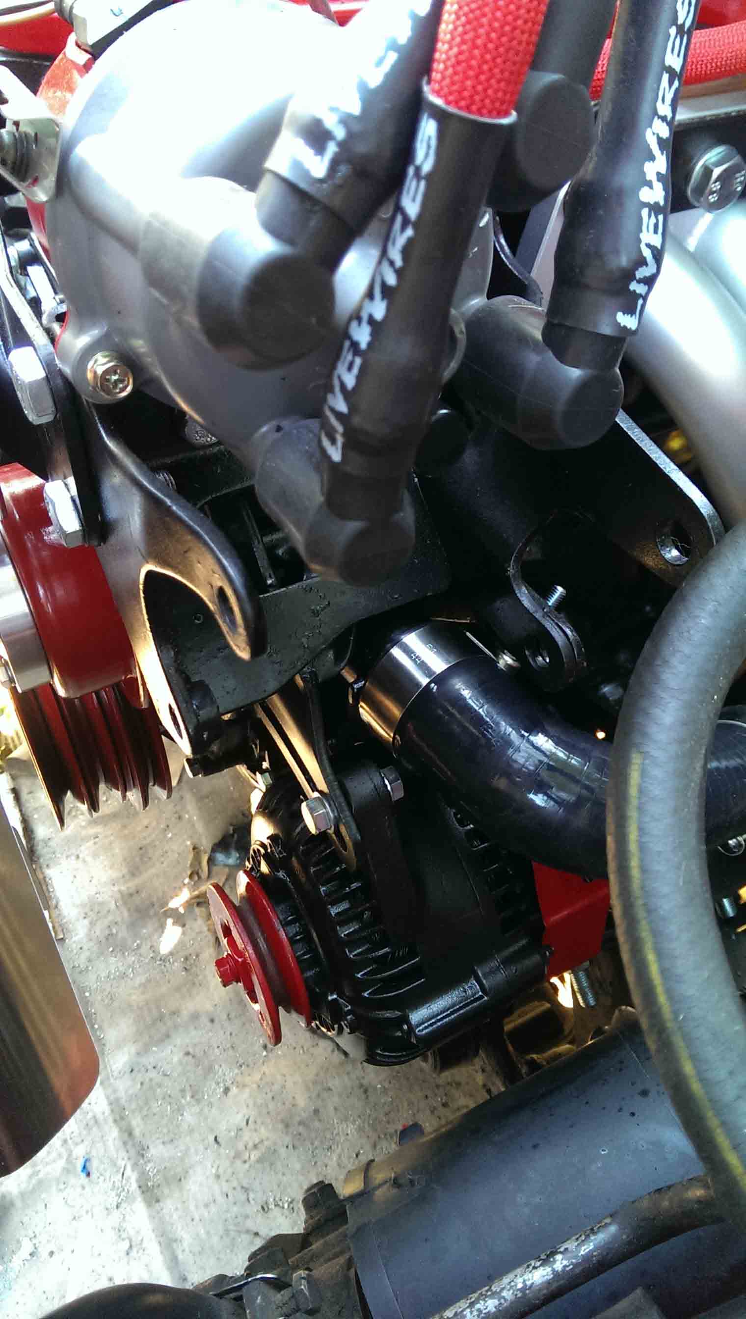

Bolting the accessories on

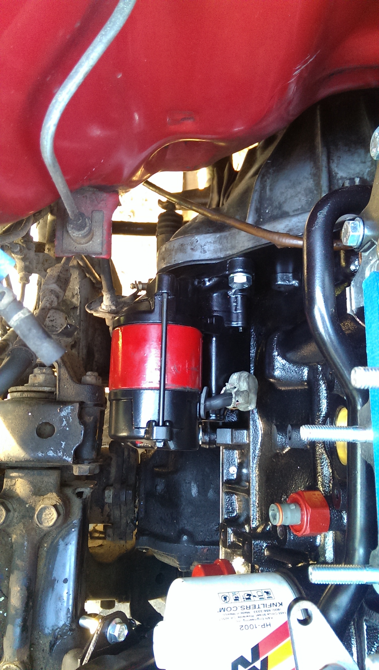

Well I had a lot of interruptions this weekend, but I managed to get a few things done on the motor.

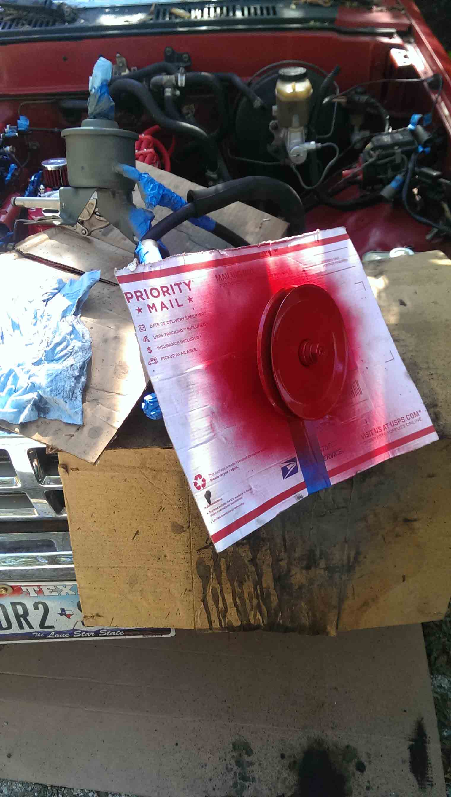

I got the Starter, alternator, and Power steering pump and reservoir painted. I didn't want to drain the PS pump and lines, so I sort of painted it in the vehicle as you can see from the pictures.
I plan on getting the GM alternator bracket and much higher Amp output alternator later on when I switch over to a dual battery setup for extra lights, winch, air compressor, etc. But for now, I'm low on funds and really need my car back up and running, so I just painted the one that was on there and threw it in.
Lesson Learned:
Never under-estimate the ignorance of the PO. The motor blew because the Previous Owner mixed and matched parts from the early 22R and the later 22RE. Apparently he also had the wrong flywheel on (which is why I purchased the LCE 35LB billet one). To make the starter work, he had jammed 3/8" worth of washers to "space" it away from the trans enough to keep the wrong flywheel from rubbing it. There's a lot of shortcuts in life, IMHO I listen to my grandfather's advice from the "greatest generation"....If anything is worth doing, it's worth doing right. He used to talk about how if you take shortcuts in smaller things in life, you were much more prone to cheat or half ass some of the larger more important things like Marriage, Parenting, Finances, Business, etc. Yes, there's always an easier way to do something, but that doesn't mean that's the right way to do it. Don't get me wrong, I'm all about working smarter and not harder, but for many things in life, you've got to put in the wrench time to get the results you want. I've also found that in the process, you'll gain more knowledge than you ever thought, and have a much deeper appreciation for whatever it is you're working on than if you take the easy road. Do it right the first time.
Anyway, sorry for the Monday Morning Sunday School lesson.....I got the rest of the accessories bolted on and started running the wiring. The challenge this week is going to be chasing all of the vacuum lines back to their proper places. I deleted most of the EPA Emissions junk and took out the center metal vacuum extension, as well as moved several of the sensors around to help "clean up" the engine bay. Most of the parts have been labeled, cleaned, sandblasted, and re-labeled, but in the process, a few of the blue tape labels have come off, so I'll be relying on pictures taken during the tear down, schematics, and images of fellow Yotatech members' engines.
When labeling everything, I used letters for any hoses (A, B, C, etc) and numbers for electrical. I made sure to put a dot next to the letter or number, because it's been 5 months since I took the thing apart, and "H's" can easily be mistaken for "I's", "6's" can easily be mistaken for "9's" and "3's" can easily be mistaken for "E's" if you don't have any frame of reference to orient the alpha-numeric label.
I plan on taking my time with the vacuum hoses to really try and clean up the engine bay and run everything the most efficient way possible. I'm also low on funds and it will be a week or two until I can get a new battery, break-in oil, exhaust, and the other "finishing touches" I need to actually get her running.
Attached Thumbnails Quest for a more bulletproof 22RE - 89 4runner engine build-imag0826.jpg   Quest for a more bulletproof 22RE - 89 4runner engine build-imag0820.jpg   Quest for a more bulletproof 22RE - 89 4runner engine build-imag0828.jpg

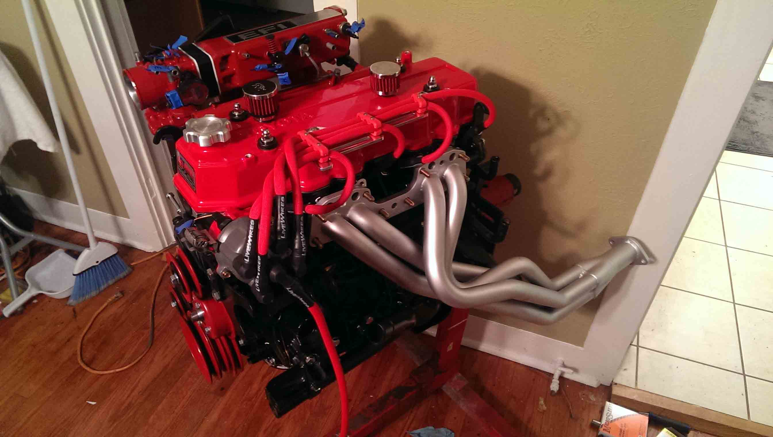

Here's a couple of shots of the alternator, the starter, and the header.
I was really impressed with the quality of the LCE header, and looking back, I should have bought the larger "non-street legal" version instead of the street header, as I'm registered in a county with one stop light, and my baby just turned 25 years old this year and is exempt from any type of emissions in my state. Sorry to those of you who have to deal with any of the PITA that the EPA demands. Honestly, it's a 4 cylinder...the fact that it's 25 years old and still on the road and not in some junkyard probably outweighs the carbon footprint of you running out every couple of years and buying a F350 double cab dually to drive back and forth to work.....which is pretty common here in Texas.
During the 1980's California was the largest market for Toyota, and during that time had some of the strictest regulations on emissions and EPA gear due to the smog in the SF bay area and LA. Therefore, these little motors were way overprotected and over scrutinized by even today's standards for how much emissions they produce versus the usable output of the engine. I don't feel bad taking most of the emissions junk off of the motor and am not required to have any of it in the state and county I live in.
Attached Thumbnails Quest for a more bulletproof 22RE - 89 4runner engine build-imag0821.jpg   Quest for a more bulletproof 22RE - 89 4runner engine build-imag0825.jpg   Quest for a more bulletproof 22RE - 89 4runner engine build-imag0827.jpg

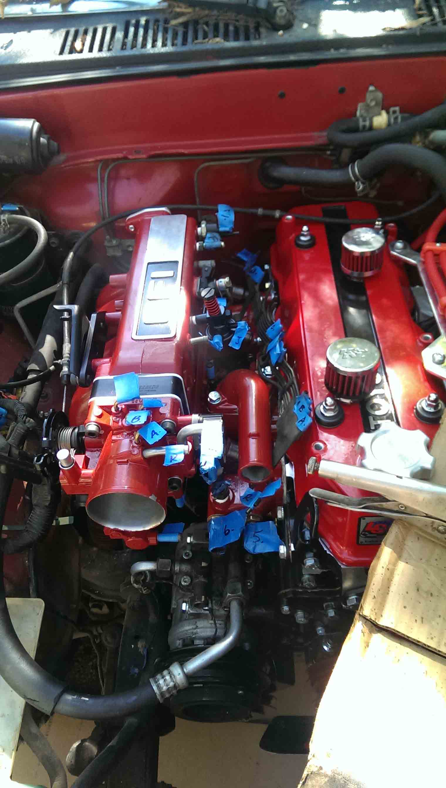

Originally Posted by joelsmithdesigns
Soooo....the whole reason I had become a Toyota guy is for ease of maintenance and reliability. I like things that aren't overly complex or have "extras" that constantly break, and it seemed like a good fit.
Agree 200%
...Eventually, I'm planning on switching the battery and intake sides because it makes more sense if you're trying to get cooler air...
Agree! Also, a long weak (plastic) duct between the AFM and intake manifold presents more opportunity for leak and hence, INaccurate readings.
Re this setup...
Do you have details on how filter is isolated from hot engine compartment air?
