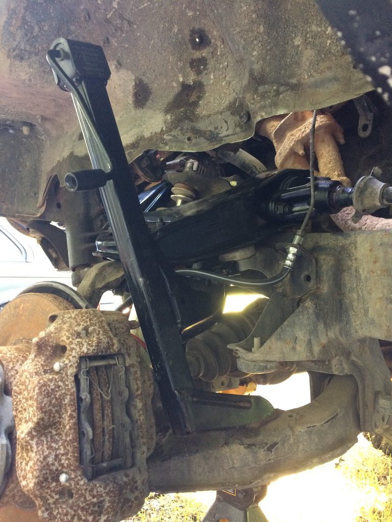

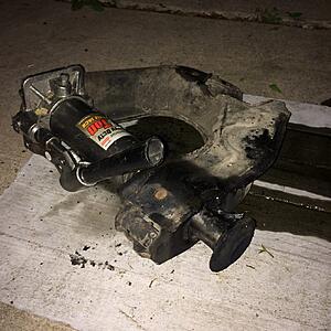

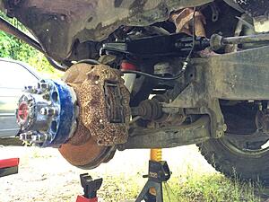

Another month of chipping away on this in between work and also hacking away on my BMW E30.
I made good progress on cleaning the old rubber bushings out of the control arm, leaving the pressed in metal sleeve for the poly bushings to use. Everything was going fine, but when I tried to bolt in the new bushings the nut cross-threaded, and it ruined the axle in the control arm.
I need to put the E30 on jack stands for some deep surgery before a track day May 16th, so I didn't have the luxury of time I'd need to hit the junk yard to get a replacement control arm. I went ahead and ordered Moog pre-built control arms. I was also worried about all the squeaking I hear about with poly bushings, so I am actually glad that I've ended up using rubber instead.
Burning the old bushings to weaken them.
I used a bottle jack to press out the old bushing.
That nut on the right is what cross threaded. The shaft it threads onto is slotted so you can punch the flange of the nut to lock it. That slot, along with trying to press the new poly bushing in, made it hard for me to realize I was cross threading it. Not a cheap mistake.
Because of a shipping mixup it took a couple weeks to get the new control arms. Yesterday I finally had all the parts I needed to get to work.
I decided to use the ball joints that were preinstalled in the new control arms. This means I'm not running ball-joint spacers anymore. It was faster to go this way since I'd need to grind some clearance into the new arms to fit the spacers. I also want to see how the geometry works out without the spacers... I may prefer to not have them. I can always put them back in if I decide I want them back. (So far, not having the spacers seems to have fixed my camber. I can't adjust the camber since my camber bolts are frozen. Replacing the camber bolts and bushings is next on my list.)
Once I got the new control arms on, I couldn't get them to fully droop so I could get the torsion bars on. I ended up using the factory jack from my E30 to pry the lower control arm open against one of the bump stop brackets. I made sure it was secure before wrapping my hands up in the torsion bar.
And finally, here's the new control arm in!
The driver's side took me, what, two months? I did the passenger side in a couple hours. The truck rides so much better (as is to be expected). I'm so happy to be driving it again.
