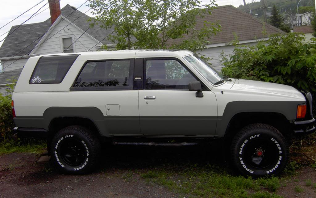

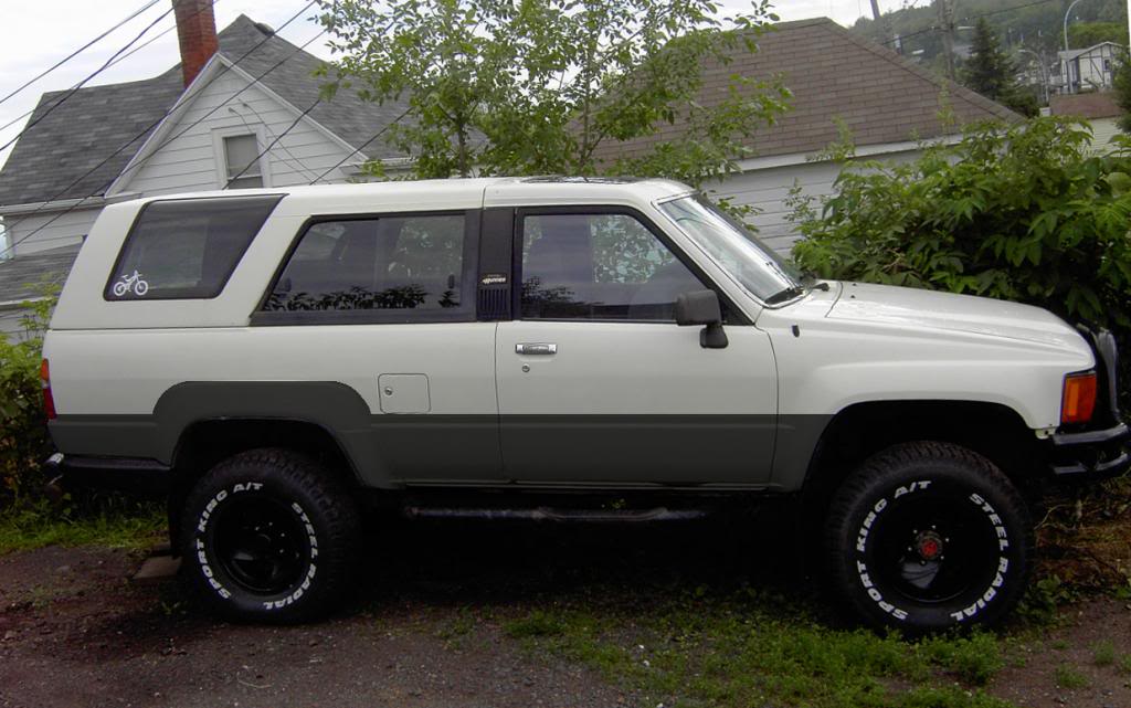

Well, still snowing it's azz off up here, so no painting. So I did some photoshopping. With the rust that I'm trying to cover up, I basically need to do this much:
Trying to decide if I want to do up and over the front fender to match:
Front fenders are half as old as the truck, and have never had the chrome trim, so they're not rotten at all. Also, I think it looks better without.
