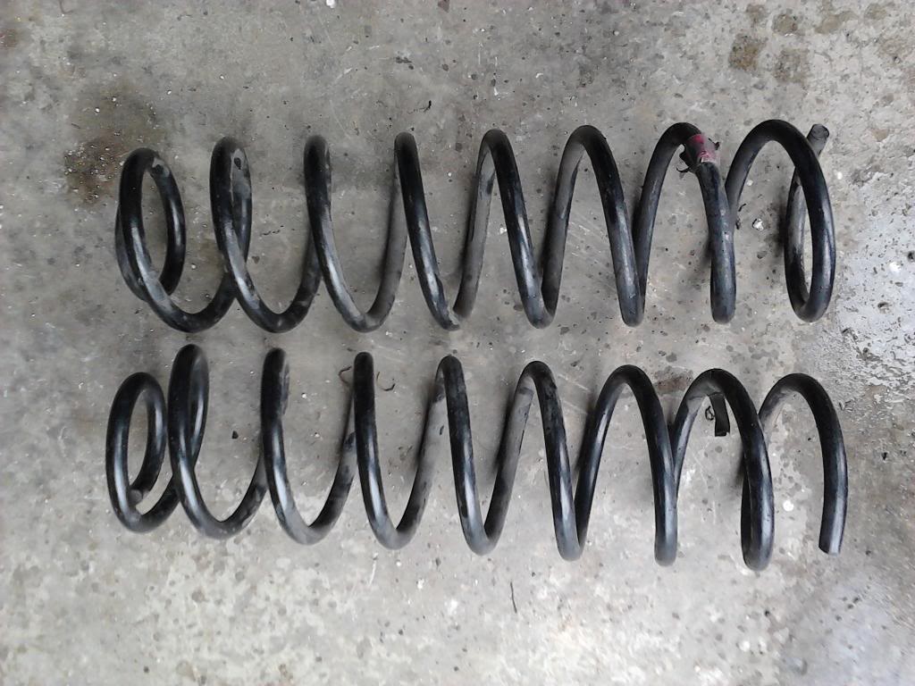

Zuk Mod & Exhaust
I've been trying to think of ways to deal with my saggy rear springs for a while now and after considering a few options I decided to go with a zuk mod!
From what I've read the zuk mod is usually done with a new set of black magic springs, but since I'm on a high-school budget I went the cheap route... I was at my Uncles house and found his stock height front coils off of his '01 Cherokee Sport (now lifted) and I thought I would give them a try. Turns out they worked great! They were originally 18 inches long and that was WAY too much so I cut them down to 12 inches long and it seems just about exactly where I wanted it to sit!
I was at my Dad's friend's house since he was bending me up a new exhaust so I asked him if we could just take advantage of the fact that he had all the tools to do it, so with the help of a forklift and spring compressors we got 'em in!
The donor springs:

The back does sit a little high, but I think I'll get either get beefier torsion bars or BJ spacers to level it out. At least I'm not riding on the overload springs anymore!

rear looks good with the springs they will settle a bit so id wait a bit before doing more

Actually looks good to me, Nick. Mine setttled to 9.25 bottom of frame to top of leafpack after a few months. How much does yours measure now?
