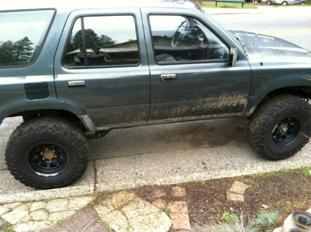

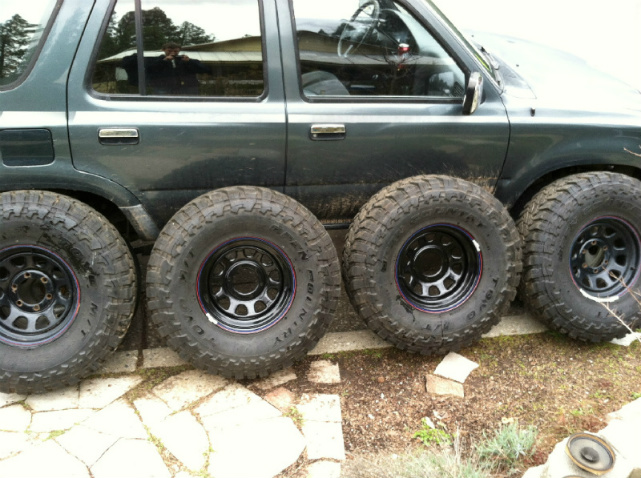

I also now have 33x10.5R15 Toyo MT's on Les schwab steelies, (pics coming soon). I had to hammer the pinch weld slightly and use a cut-off wheel to cut back part of the lower part of the stock front bumper. Barely rubs only at full lock.

Pics as promised:
And also, I have had no issues with having no rear bumper or side steps on my rig, even with the wires which are just for my CB antennae and the light for the license plate and they could easily be re-routed, but i just ended up zip-tying them in place for now.
