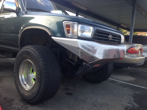

i wanted a bumper with features that i wanted. and i wanted it to look aggressive so i made one. its got decent clearance. im thinking about getting rid of this one and making one with slight changes to shape but id be ok with sticking with this one. i could squeeze a bit more out but i also wanted to be able to mount a winch behind it. i wanted a place to stand. almost done. got a bit more welding and some supporting to do and cut some holes for winch i dont have and fogs and air cooling some hook mounts but looks close enough. its gotta be sanded down so paint is not proper. 3/16" sheet metal with 3/16 angle framing.

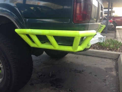

i did the rear bumper a while ago. did all this with just a grinder lol. so no bending. i removed the stock bumper then cut and welded the tow hitch up to give me more room. then added to it. i still need to do some sliders which is the main thing i wanted. all this metal ive gotten so far has been recycled so i have come accross anything to do sliders.
