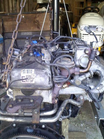

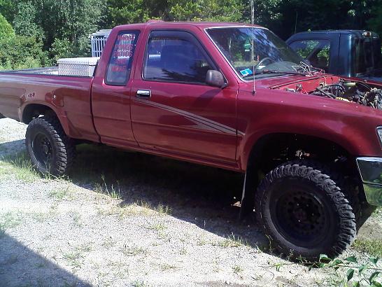

Hello All,
I'm new to the site and starting my first build of one of my 2 yotas!!
I'll try to update as much as possible. This build was started on 8/16/09 and is still in progress.
New Parts -
Sealed Power pistons(.20 over)
EngBldr C268 Cam
Pacesetter Header
Luks Clutch
Rebuild stock injectors
Radiator 2 row
Oil & Water pumps
The motor went to the machine shop on 8/19 and i'm waiting for a price on them building the short block,and cleaning/surfacing the head.
This truck is completely stock i'm hoping to due more then just the motor this yr but not sure how far the funds will take me.
Does anyone know anything about gasket porting intake/head/exhaust? I want to do this but not sure how far to go with it any ideas? Here are some pics of the start of the build will post more as i go.
Any tips or suggestions are greatly appreciated this is my 1st build any help would be great....
Attached Thumbnails MuddinRI's 1994 Pickup Build-Up Thread-0824091027a.jpg   MuddinRI's 1994 Pickup Build-Up Thread-0824091027.jpg   MuddinRI's 1994 Pickup Build-Up Thread-0824091029a.jpg

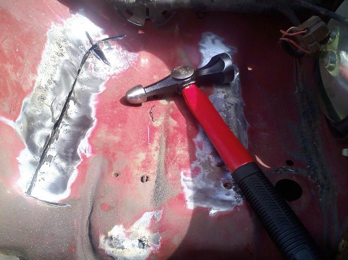

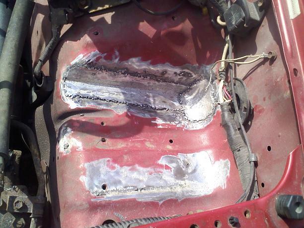

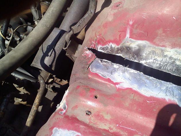

Battery relocate mod
Ok so this is how i did my relocation of my battery. This is a pretty easy mod if you don't mind cutting into the drivers side lower fender!!
Tools you will need-
Cut of wheel
metal hammer and dolly
18 gage piece of metal
welder
Ok so the battery fits without cutting, but it will rest on your coolant overflow(not so good) and it will be way off kilter. 1st thing i did was measure my battery and mark out my cuts. Once you got what you need cut start hammering away to make a level surface for the battery. Now your left with a gap so cut some metal and fill it in.. Keep checking to make sure your battery is somewhat level and has room between the overflow. These are things i've been doing while waiting for the machine shop with my motor..... One more thing there is a bolt on the fender that you will have to cut out of the way and weld to fender.

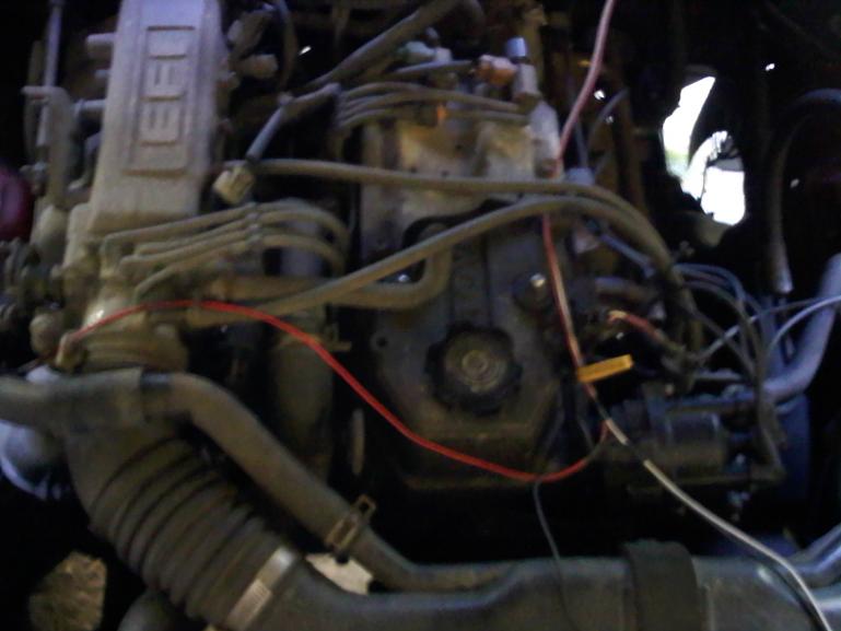

Supra afm

Harleyman... lol is that a suggestion to put a supra mass airflow meter? Is this possible/easy to do?? Sorry man i'm new to building from the ground up you know lots of stupid questions and ideas floating in my little brain
Yes if you can get your hands on one , Is it easy/possible also a yes
You just have to do a little fab work to mount it but it is doable I just did this one on my full rebuild and for now till I find a better solution this will work but I have a plan to redo this mount and it should work a lot better.

i got a 87 supra maf for free.. brand new form autozone. it helps that i work there.ahha.. i use it on a 88 v6 it really has more power and better throttle response

Will the 87 MAF from a supra fit on a 94 22re? sounds like it's what i'm looking for

yes it will

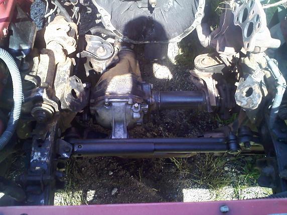

Ok here's an update Got my cam-radiator-electric fan-new injectors all yesterday. Engbldr sent me a complete rebuild kit yesterday 2 day mail, should have that tomorrow. Machine shop started my block and it should be ready late next week i hope. Today before the rain i sanded/wire brushed the frame-front axle housing-upper and lower control arms,etc. I painted everything 4 coats
