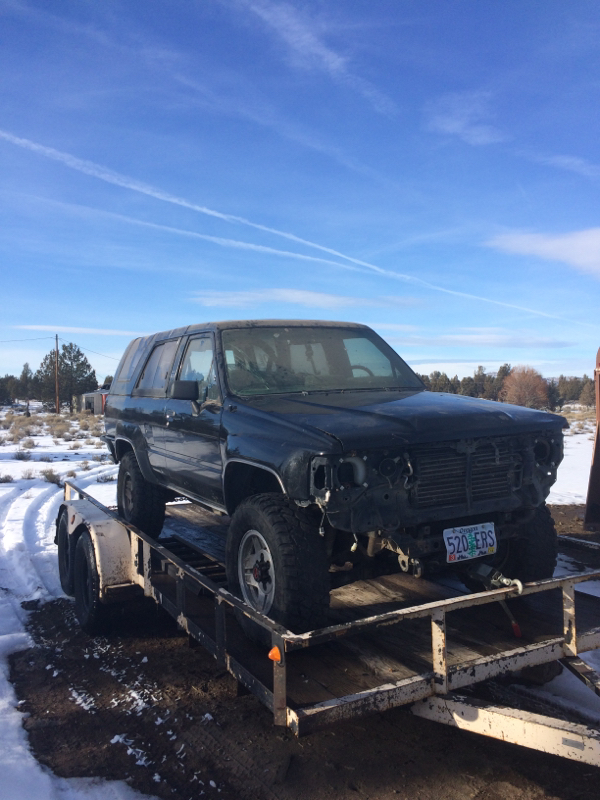

Hello all, been silent for a while but I'm back (not that anyone would've necessarily noticed). Picked up this beauty about two years ago and have let her sit in the horse field up until July of 2016. Figured I'd get to it eventually but life happens and other projects can take priority. Back story is, I picked it up with a smashed front end, interior torn to pieces and thrown in the back and the transmission sitting next to it. Figured at $500 it was a heck of a deal, right!? Previous owner claimed "somethings wrong with the tranny, so we pulled it." Here's how I bought it.

Here are a couple more photos of where I started. I have since tracked down a new drivers side fender, grill, a straighter hood as well as some misc. interior pieces.
