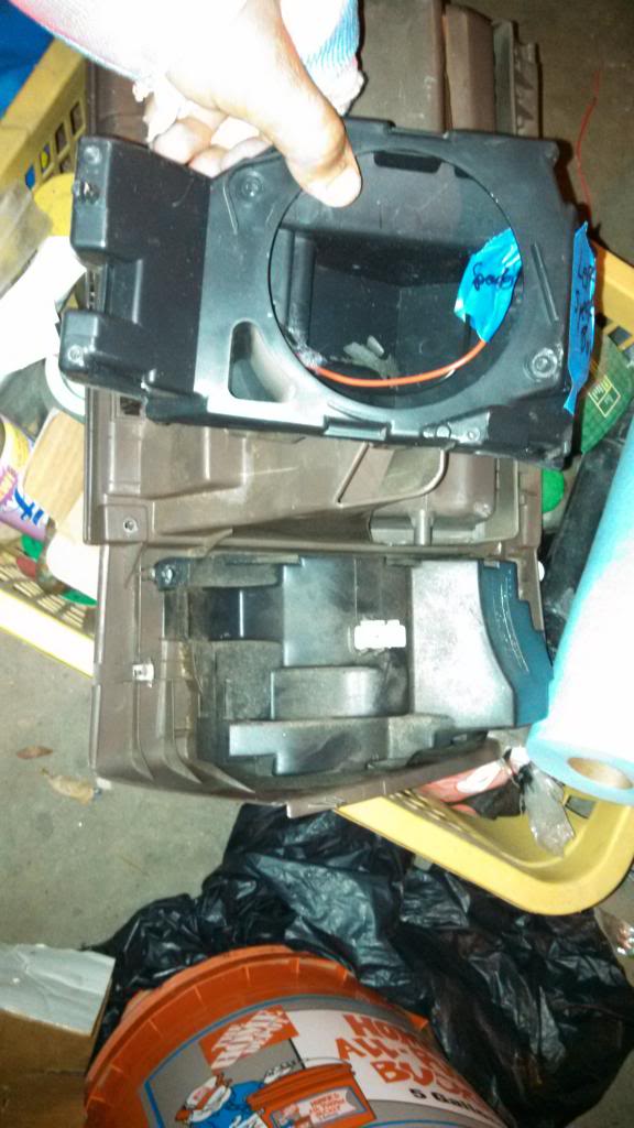

2nd gen speaker boxes in 1st gen?
It occurred to me after I replaced the speakers in the dash, that there is nothing really behind them, unlike in a 2nd gen, where they sit in a box filled with insulation.
So I'm wondering if I could make these 2nd gen boxes fit in my 1st gen. Anyone try this before or have something else they tried instead?
Here's a pic of the drivers box (in my hand) and the passenger attached to the glove box.

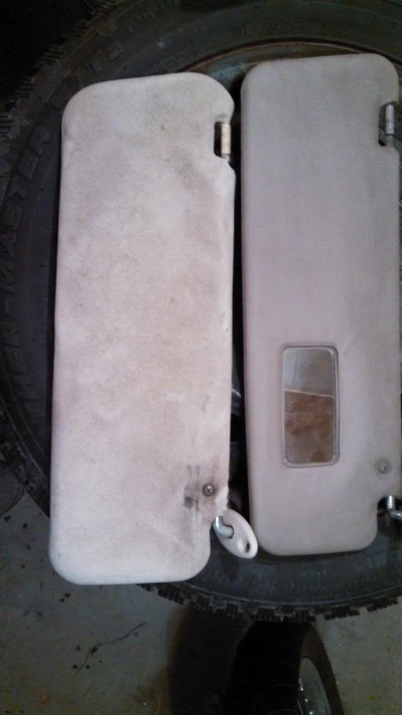

Replace headliner? + upcoming work
The interior of my runner leaves a bit to be desired. Particularly my headliner - it has stains and at least one cig burn hole.
I was thinking that my parts car (2nd gen) has a pretty decent headliner, and I'm wondering if anyone has tried to do some sort of swap - 2nd to 1st?
Maybe this is a stupid idea, I dont know, its just that I already have the 2nd gen.
I know I definitely plan on taking the sun visors from the parts car, cause the current ones look like poop.

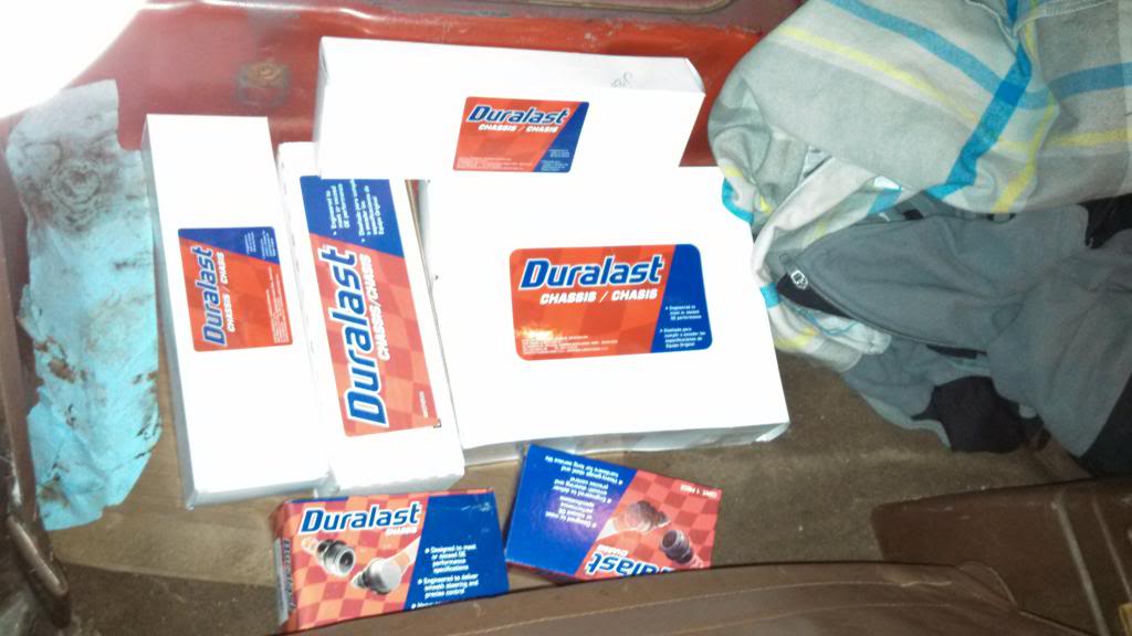

On a different note I plan on installing this stuff today - new steering components
This stuff came out to $110, which isn't too bad for: idler arm, pitman arm, and inner + outer tie-rod ends
Ill do my best to take pics of the process. I need to do this stuff so that I can get my front end aligned.

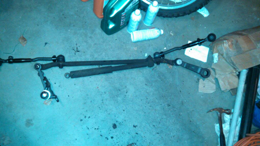

Nice! Yes, please do post about your experience with replacement parts. FA5040 for idler arms, correct? If not, suggest you visit 4Crawler's site and this
Thanks Rad, Yes the shown parts include the FA5040 idler arm per 4crawler's recommendation. One thing I forgot to get at the time I purchased the other components was the adjusting sleeves, fortunately they had 2 at autozone for 8 bucks a piece.

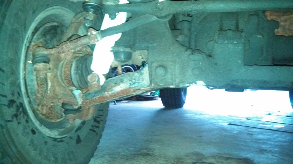

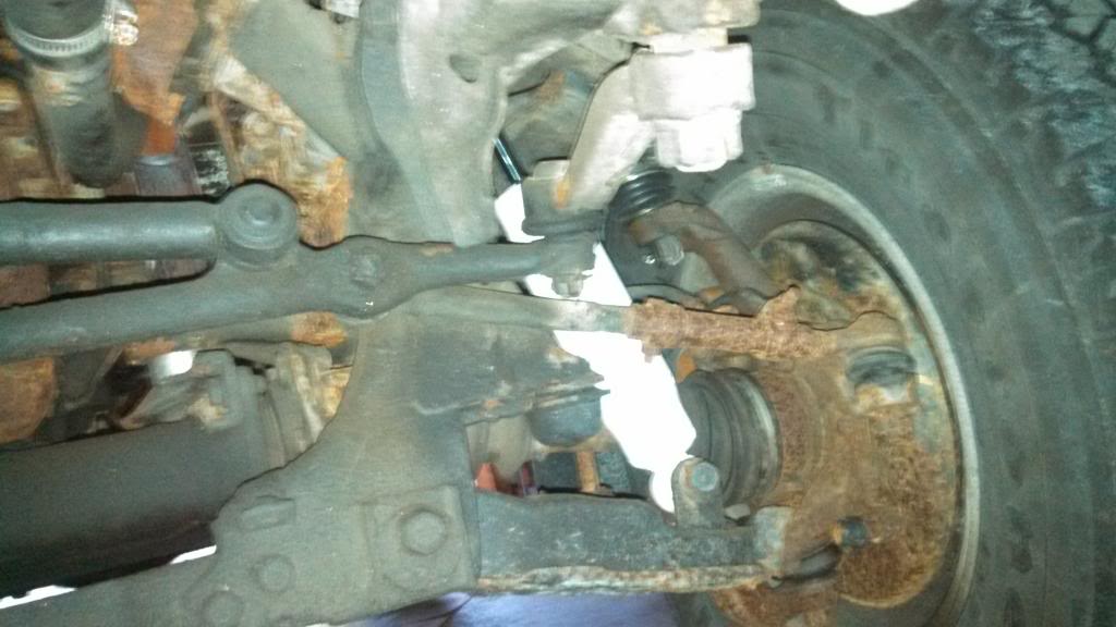

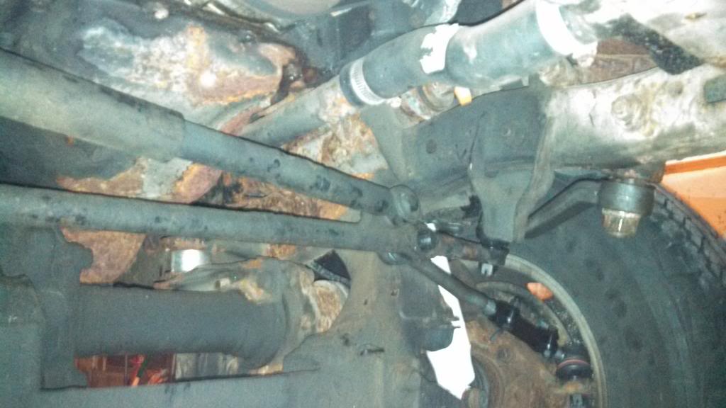

This is what my steering system looked like earlier today
and..

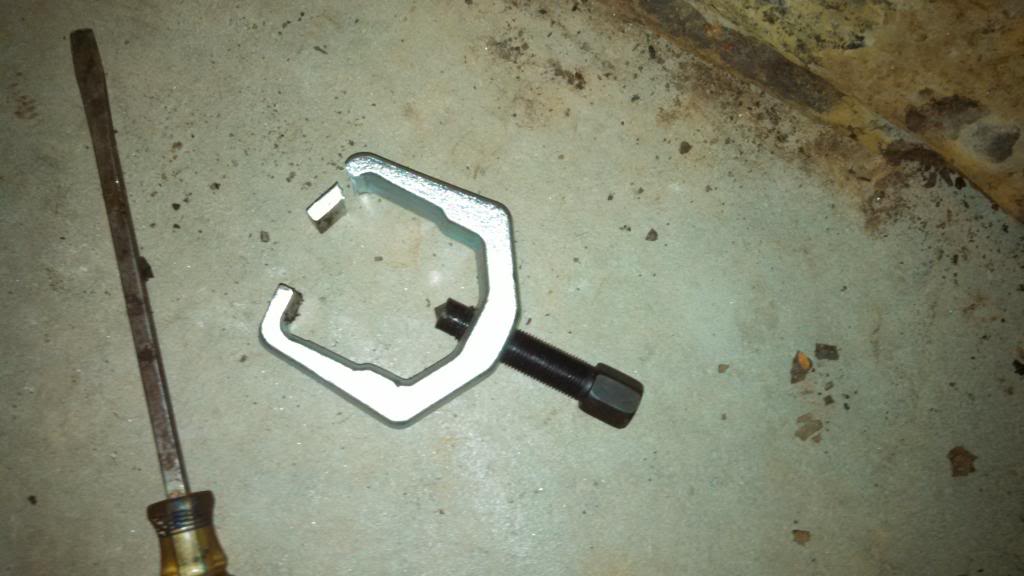

as you can see, the adjusting sleeves were basically "nature welded" to the tie rods, and most of the seals were totally shot.
Tools:
-pitman arm puller
-ratchet + 17 & 19mm + other assorted ones..
-extension (section of pipe)
-1 1/4 in wrench for pitman arm
-BFH
-propane torch
I didn't realize how difficult the pitman arm was going to be to take off.
Now I know that when using a pitman arm puller, the strategy is:
1. get as close to braking the puller as you dare (see above for extra bold)
2. heat where the arm attaches to the splines w/ torch- I did ~5-7mins w/ a propane torch
3. turn the steering wheel all the way to the right and hit pitman arm with BFH

The guy that replaced my pitman arm used a snap on puller and he said it stressed it out cause it was such a bear to remove
Old Nov 13, 2013 | 06:37 PM
  #36
MaltDisney's Avatar
Joined: Aug 2011
Posts: 51
From: NH
completed and future projects
For sure it was a bear to remove, the heat + BFH were definite necessities.

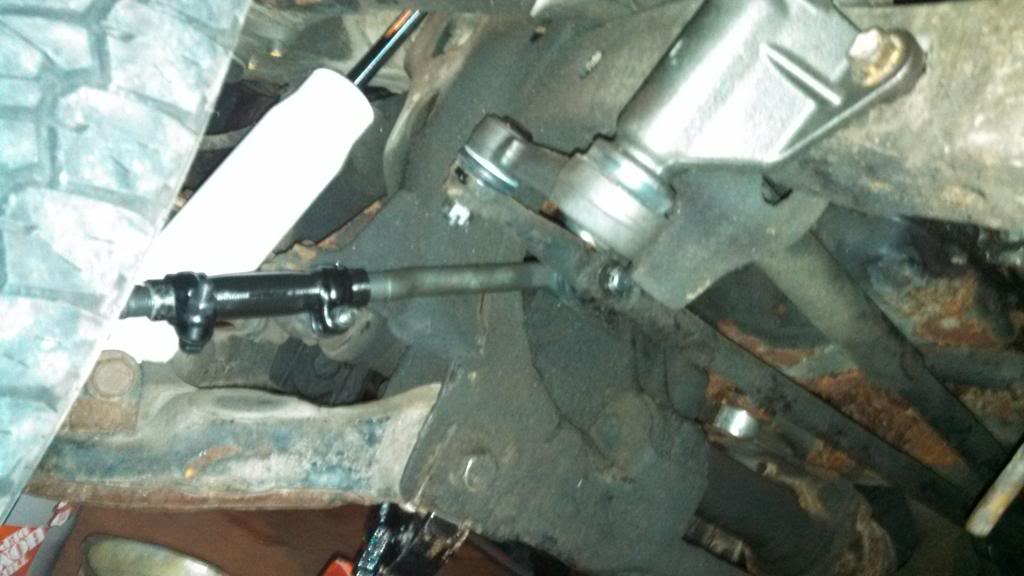

I got the steering together before putting it back on
drivers side
passenger side

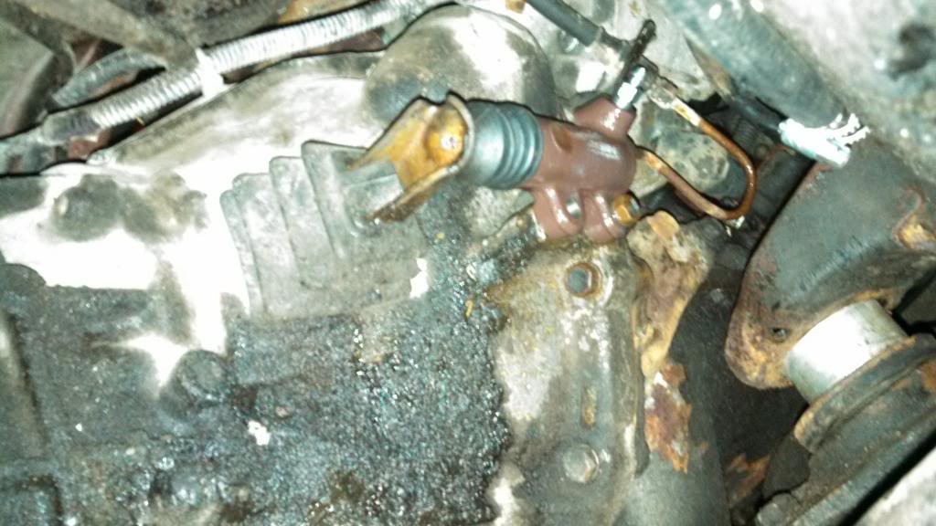

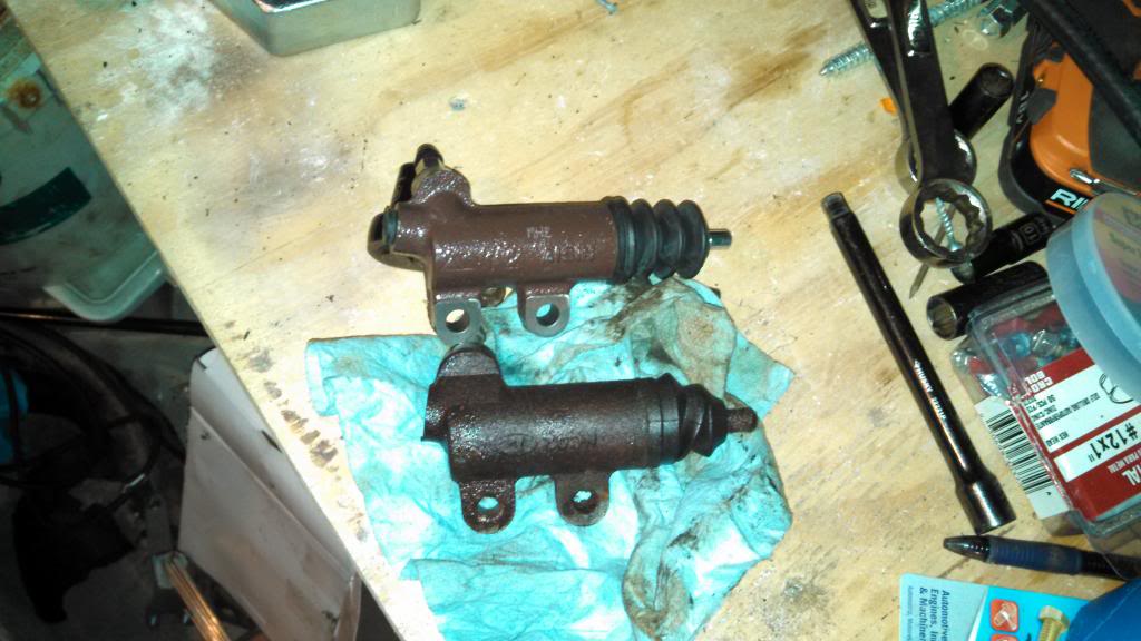

Anyway I finally installed my new clutch slave b/c the old one was leaving evidence on the floor(and on tranny), and I got this replacement for $15 on amazon and it's aisin. Here's the new one in place.
new vs. old

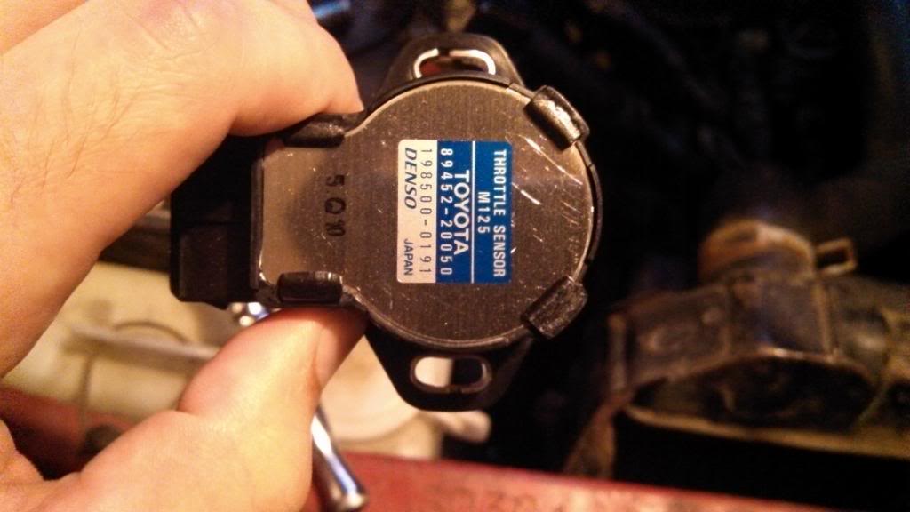

Help! High Idle Happens all the time now
So Ive been trying to figure out what is causing my high Idle in neutral. It used to only happen after the car got warmed up, where the engines revs to 3 or 4k rpm when not in gear (clutch in or in neutral). It also used to be somewhat intermittent (it would mysteriously go away).
After talking with a couple mechanics, I decided that my problem must be a sticking throttle cable. But I'm sorry to say that I just replaced it (got a used one for $30) and it did not fix the problem. Now it has a high idle when cold as well.
I think this seems like a sensor type problem.. My two guesses are IAC valve and TPS (brand new, but duralast brand). I tried turning the idle adjustment screw all the way in, and this did not change the idle at all - ~3k rpm, but I'm not sure if this proves anything.
Anyone have any suggestions??
This is really starting to piss me off b/c other wise my truck was finally running great
Old Nov 17, 2013 | 04:37 PM
  #38
MaltDisney's Avatar
Joined: Aug 2011
Posts: 51
From: NH
solved kind of.. Found likely solution
I can say with relative certainty that my idle problem is/was directly related to my cheap tps. Somehow it was WAY off from being set with in specs even tho I had JUST set it properly 2 weeks ago.
It doesn't quite pass test #1 on 4crawlers site after re-adjusting it properly, but its close at 1.2K ohms and it works much better than before- now it has a very slight surge f/ 800-1k rpm once warm but drives OK otherwise.
I plan on trying to get a used toyota tps sometime this week and returning the aftermarket.

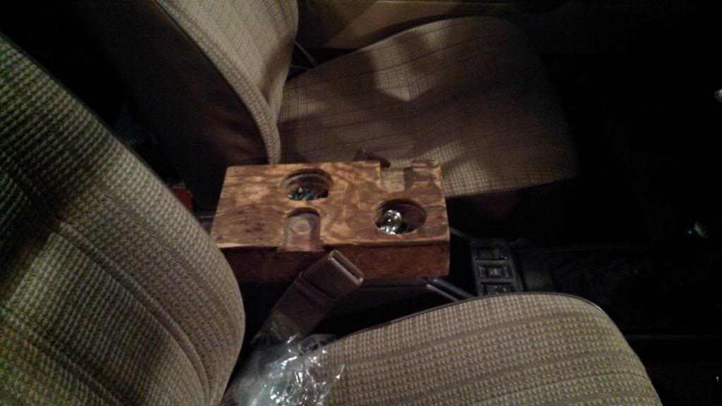

Then I decided to replace this
with this.
I unscrewed the wood from the top of the console and screwed on the cover from my parts rig. Also notice the excellent cup holder. I think they were 4 for 2 dollars at mal-wart.

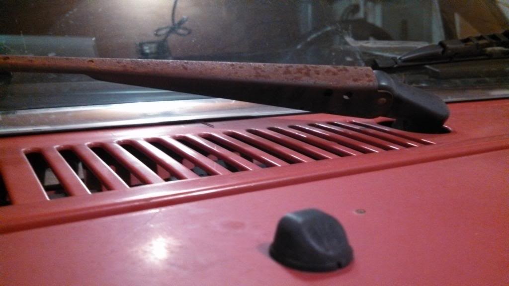

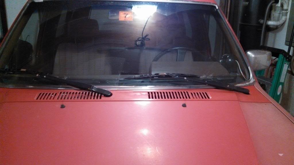

Upgraded my wipers to 2nd gen which seem sturdier and in my case are much cleaner.
Old:
new:

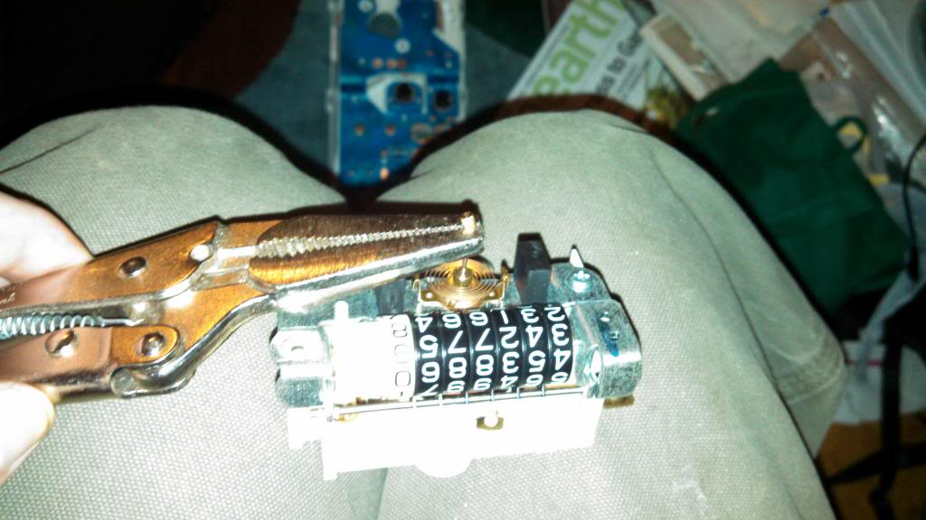

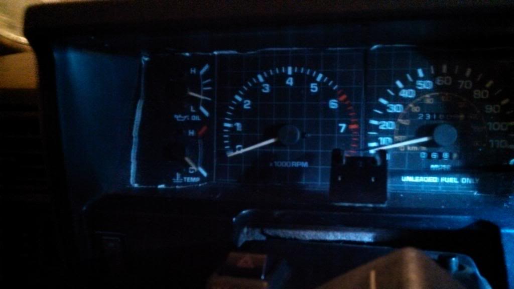

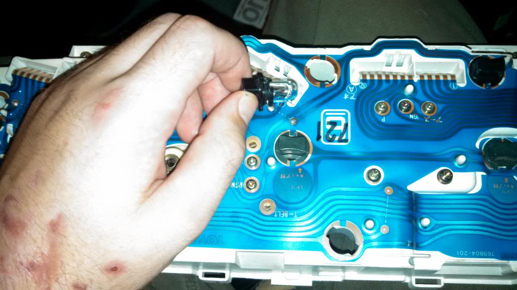

I managed to get an sr5 cluster for $20, unfortunately it didn't have a cover. This was really helpful to follow when I was doing my swap even tho its for a later model truck, its very similar: https://www.yotatech.com/forums/f116...w-pics-179106/
BTW I recommend that you use a dining fork to remove the needle form the speedo if you are going to swap odometers. You just leverage against the black screws.
Here's a couple pics.
Size:  75.9 KBName:  IMG_20131208_224741_3681_zps4b783b34.jpg
Size:  74.1 KBName:  IMG_20131212_200716_8331_zpsc503b6b1.jpg

sorry, crappy cell phone pics, but you might notice that the cluster does not look perfect, that's because I had to modify my old cover to work (it also has a mount for a now-broken compass). I will probably want to go back at some point and smooth up the edges of the plastic and paint it black. Also, I have not installed my new oil pressure sender (old is disconnected) but here is the part # for the sr5 sender 83520-35031 I got it for $50 at the dealership.
I have my replacement oil pressure switch at the dealership along with a check/fill plug for my transmission and a rear wiper blade. Just finished changing my front diff and transfer case fluids. Hopefully I'll be able to remove the check/fill plugs from the transmission and the rear diff. I'm just using 80w90 for everything..
