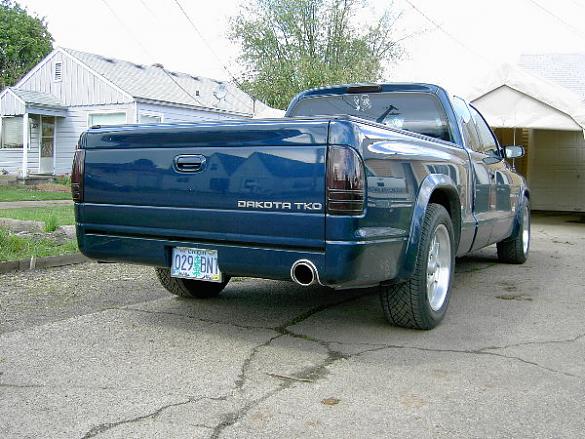

I've used the Nightshades before, when I was more into street trucks, although I didn't go nearly as dark as you did. Before I applied the tint, I sprayed on some transparent red to eliminate the backup portion (legal here), then two pretty light coats followed by two coats of clear gloss. The medium-intensity tint and the gloss really made the lenses stand out in a subtle way.... looked kinda burgandy, but if my truck would've been black, I would've gone as dark as you did. Turns out that I could've gone almost black, because I gutted the bulb housings and installed custom-shaped LED's.... HYPER BRIGHT! I love Nightshades.... One recommendation: You might want to shoot some clear on for protection - lasted me years with zero chipping or flaking.
Cheers, Broeheem

Yeah, believe me, I did not intend for it to be that dark. One thing I have learned in all the times that I have used that stuff is that it reacts differently to various tail lenses. Some take one coat and they're black and some take five and won't darken up. These only took two coats and it didn't look dark at all and then when it dried I was like holy crap
Old Jul 26, 2010 | 07:22 PM
  #58
Broeheem's Avatar
Joined: Jul 2010
Posts: 3
From: Albany, OR
I guess I was assuming that you wanted them to be that dark. If I remember correctly, I could've put a lot more coats on, but the first time I tinted them, it WAS too dark. I just wiped it all off with common paint thinner and started over. Actually, on the second incarnation, I put one coat on then used some pinstriping as masking tape to create a horizontal pattern, then a second coat, but when it was finished it looked cheesy to me. Third time really was a charm.
