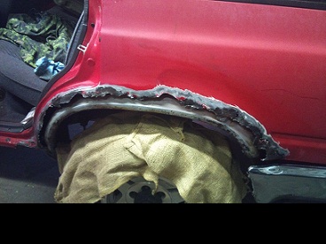

some pictures.

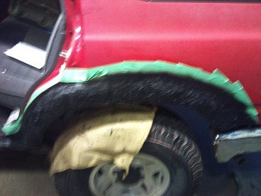

the first is the problem, once i had sanded it all down. for the sanding i used 40 grit with a sanding disc on the drill. once the sanding was done i used marine clean and metal ready (came with the POR 15 starter kit) to clean and prep it. once that was dry and ready i did the first coat of POR 15. went on well, the only hard part was the inside of the fender, but with enough scratched knuckles it went on.

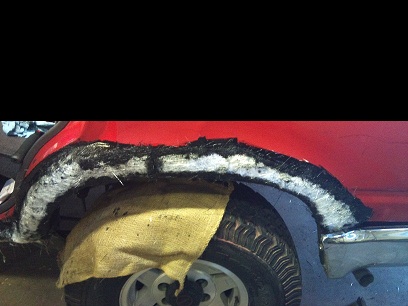

now on to my mistakes.... i tried to put the fiber glass matting ( should have used the normal fiberglass cloth as its much smoother) to quickly. so i little repaint with the POR and an hour and a bit later i tried again. it went on nicley when the POR was really tacky. the problem with the matting is that it is full of strings that are not braided. after another hour i used the POR to seal the matting onto the truck. I let that dry for another hour or so then painted the rest of the fiberglass with the POR.
Attached Thumbnails Kinkeds 91 4Runner slow Build/Fix Thread-dsc_0030.jpg   Kinkeds 91 4Runner slow Build/Fix Thread-dsc_0034.jpg   Kinkeds 91 4Runner slow Build/Fix Thread-dsc_0035.jpg
Old Oct 22, 2010 | 06:47 AM
Kinked's Avatar
Joined: Apr 2008
Posts: 115
From: Coquitlam
As you can see the matting did not become nice and smooth. I'm going to try to sand it before i paint over the POR with some primer and rocker paint.if that doesn't make it nice and smooth, in a couple weeks i'll be doing this again with fiberglass cloth.
