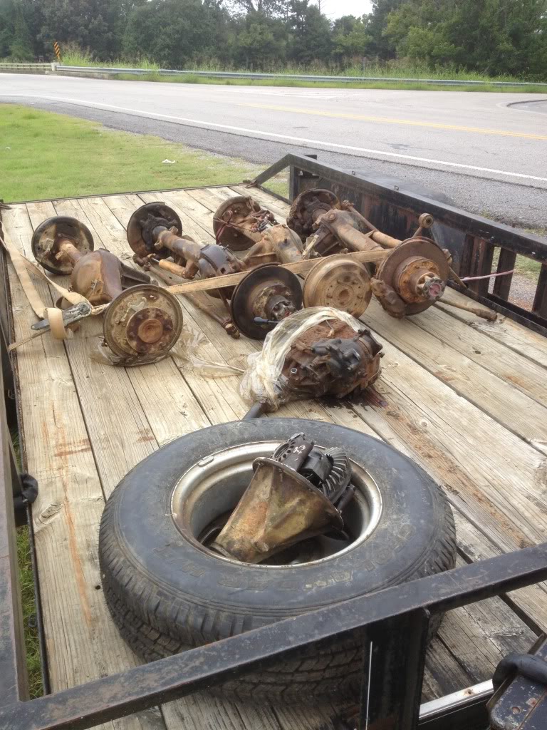

So my buddy and I had a little road trip today. I think we scored very well. In total we got 4 axels, a transfer case, spare tire, gauge cluster with tach, and a bunch of other odds and ends. The front and rear that I bought are open 4.10 gears and I got the stock transfer case. I'll post better pics after I clean them up a bit this week

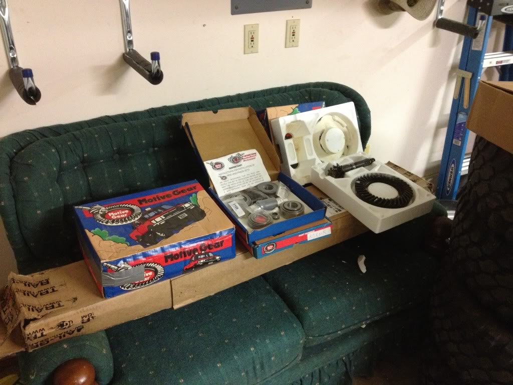

OK I picked up the Motive 5.29 gears, install kits and some trail gear solid pinion spacers. Not too bad for less than $400!

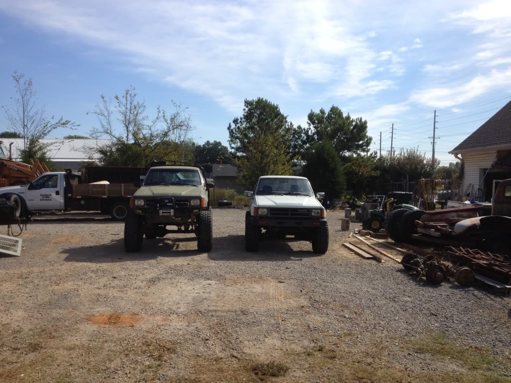

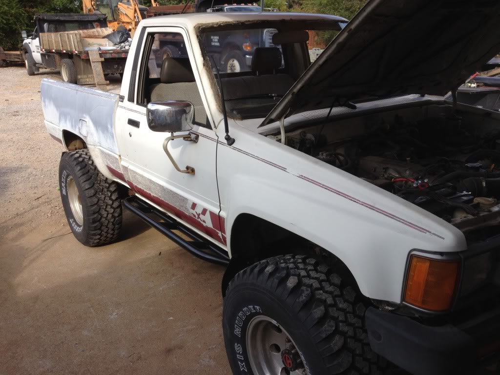

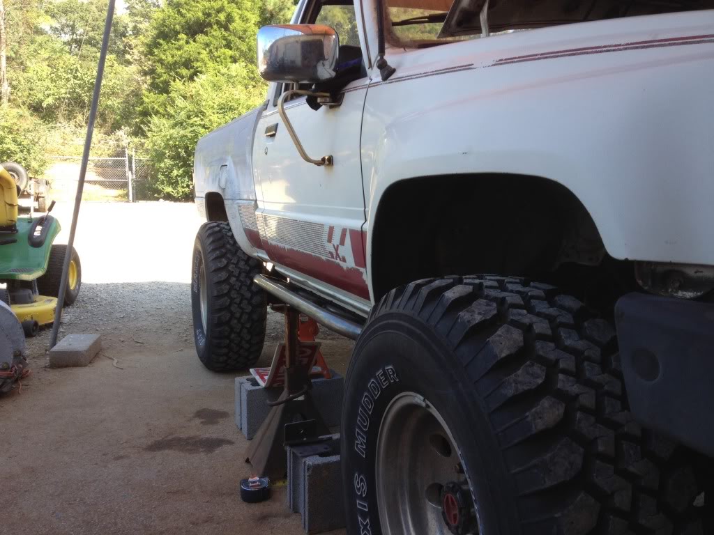

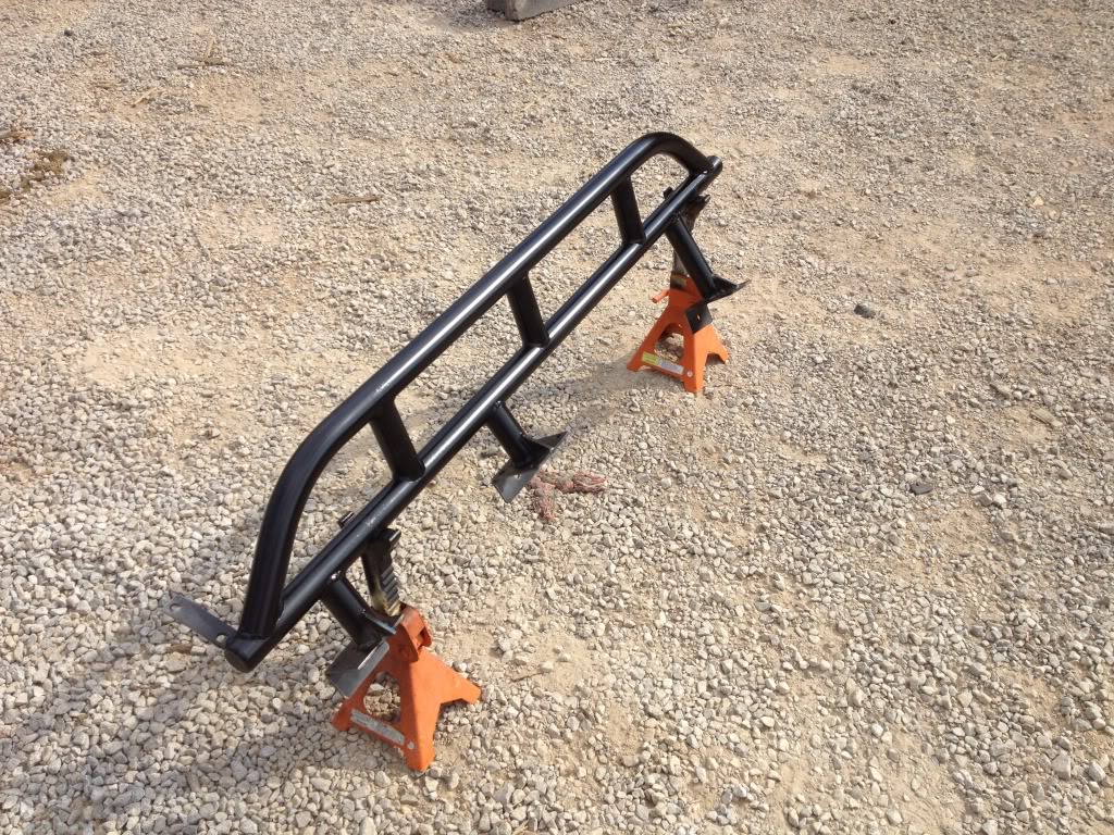

Got busy on the truck this weekend. I cut the 3" body lift down to a 1.5" on the cab. I then got side tracked onto other stuff. I will get the bed cut down this week. I did not have the bolts to do it. I replaced my exhaust manifold gasket only to find the rear most stud stripped out. I will get a helicoil this week. Then we finally welded up my trail gear rock sliders. I will try and keep working on the little things while I stockpile the parts to do the SAS. Next major purchase will be dirty 30's.

My little truck on the right next to my friends monster.

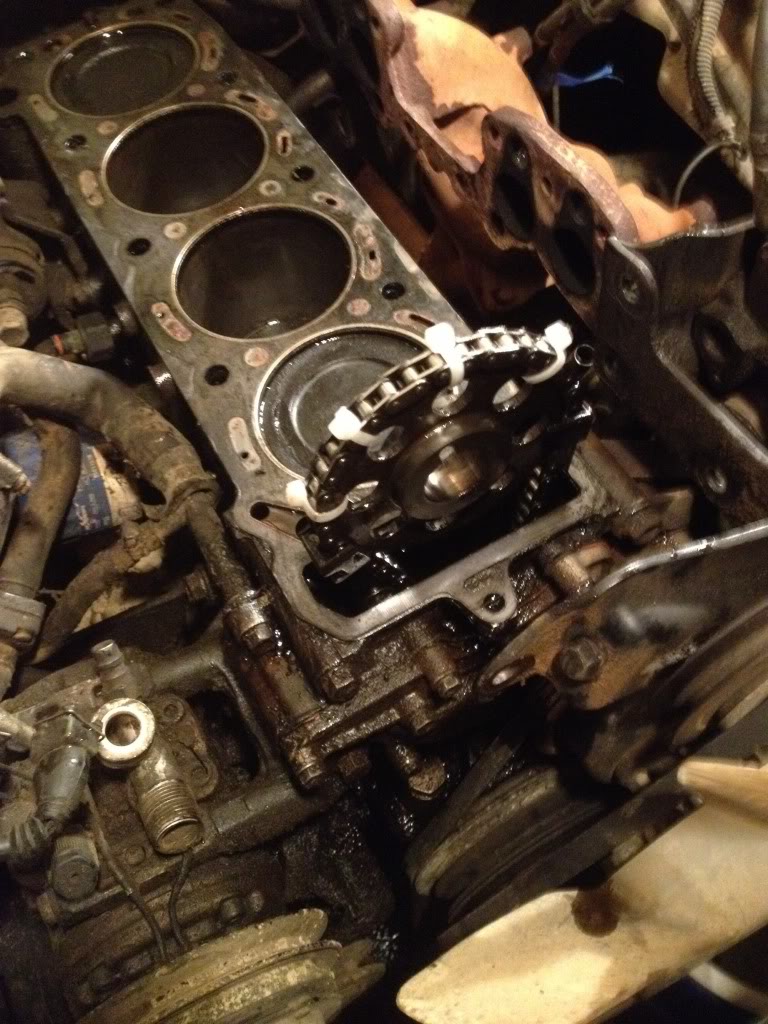

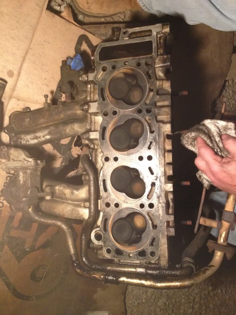

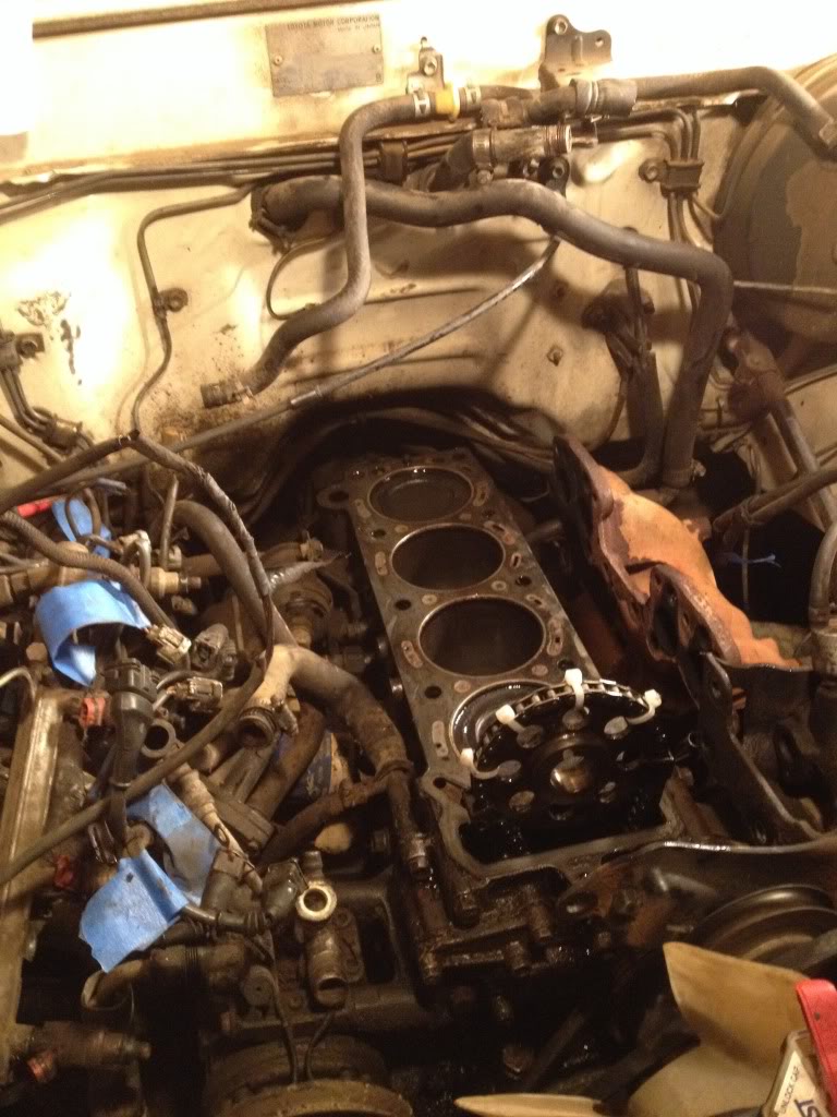

OK so time out on buying toys for now as I have a head gasket that needs replacing. I was loosing coolant so I borrowed the coolant system pressure testing set up from Advanced auto parts. I found 3 leaking hoses and a weeping leak between the head and block under spark plug number one on the exhaust side. At least if I have to pull the head I can put a helicoil in to the head on cylinder number 4 on the bench instead of against the fire wall. Looks like I have a full week on my plate.
Old Nov 6, 2013 | 04:24 PM
  #40
Magichelmt's Avatar
Joined: Jun 2013
Posts: 22
From: Meridianville, AL
Well pulled the head off the motor this week. I will replace all the gaskets and seals in the top end. Maybe the timing chain as well. Learning as I go. Name:  411433C9-E1F8-4AFE-9100-E848D9989900-339-00000095376F46AA_zps1249c8af.jpg
