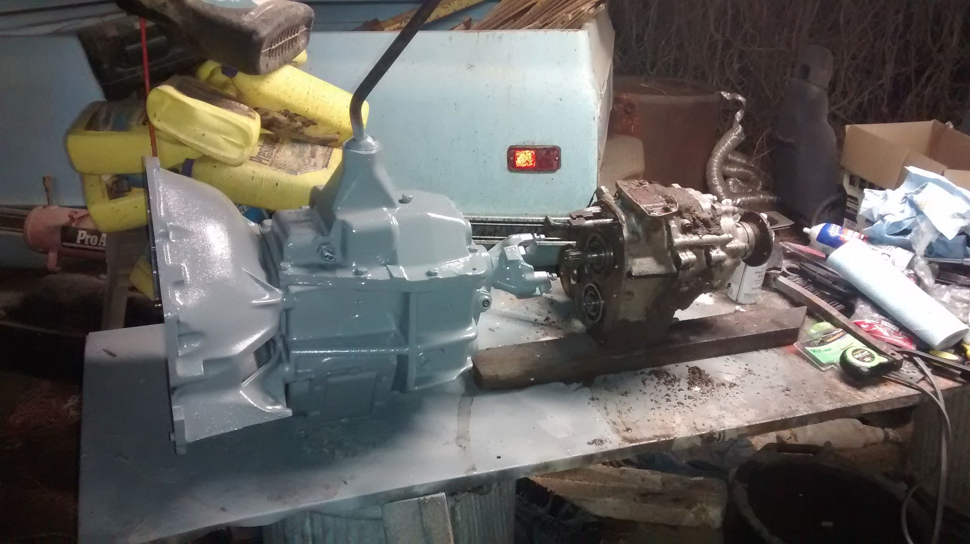

Got the transmission the other day. The guy i was originally going to buy it from happened to bail. The day after i just happened to find out a friend had a 2wd sitting around from a 71. I happened to get it for $180 for the trans, cast iron bell housing, flywheel and all of the clutch components. Not too shabby. The next day I cleaned it up, resealed every where that could potentially leak and, and gave it a coat of paint. here it is as it sits.
I'm pretty sure I'm going to mount the t-case about yayish far from the trans. I'm still unsure how I'm going to come up with a yoke to work with but I'll figure it out.

Precisely. I think I'm going to pull the sleeve off of the out put shaft of an old w56 I have lying around and weld it to a slip yoke off of the blazer the engine came from. Then I'm going to cut out a steel plate that bolts to the front of the t-case and machine the hole to fit a seal. The plate is also going to serve mounting purposes.
