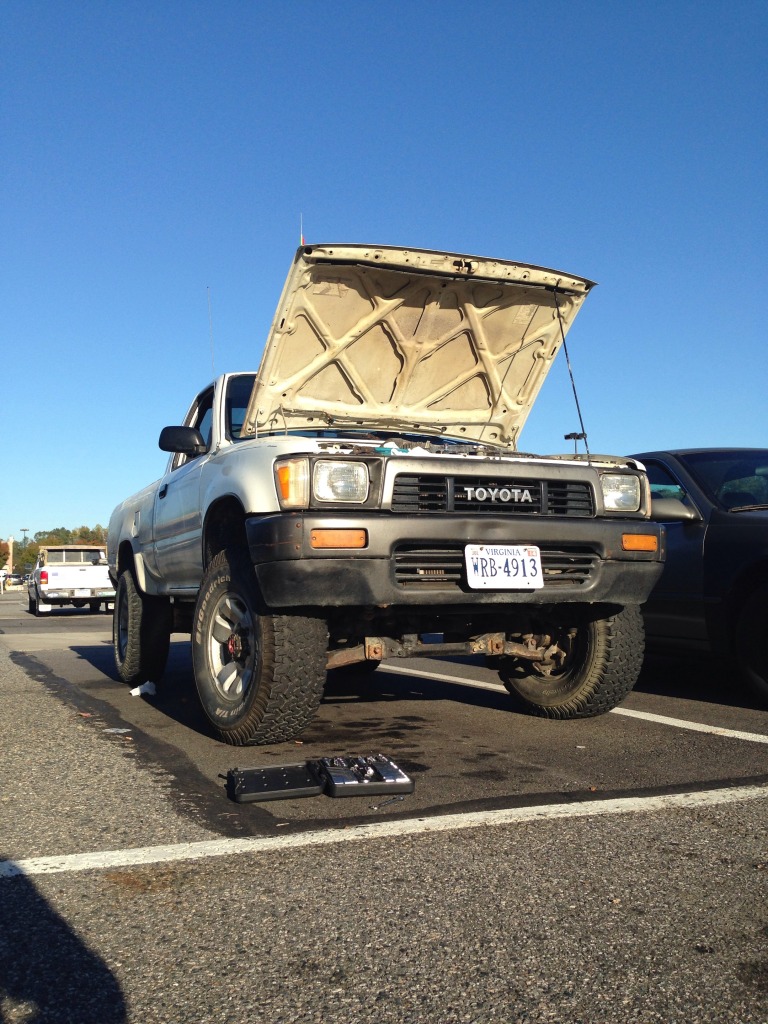

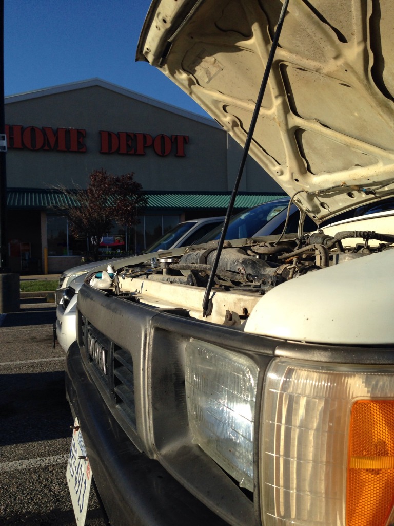

So today sucked, on my way home from work the battery light came on in my white truck, stopped at Home Depot for a few things, came outside she was dead. Not even a door buzz, turns out the wire going to the fuse box was worn, easy fix but annoying

Do tell, did you replace it with wire or fusible link? I made that mistake on my nissan and blew a bunch of fuses. If you just used regular wire do yourself a favor and go to the parts store and buy a fusible link. Could potentially save you an engine fire.
Old Oct 21, 2013 | 04:51 PM
  #153
KirkPayne's Avatar
Joined: Sep 2013
Posts: 184
It was two wires that just came apart.
