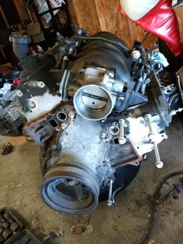

https://fbcdn-photos-c-a.akamaihd.ne...e387c30dae9ed0
For some reason it won't let me post pics so here's a link to the current state of the engine. I just finished up the purchase for all the ls1 accessories as well as the f-body oil pan setup so very soon I'll be acquiring the last needed pieces to install then motor. As for the fj62 front axle i need to get the side bearing preload set again as I had to remove the 3rd member internals to bend the passenger tube back straight. Hopefully this summer its complete.
