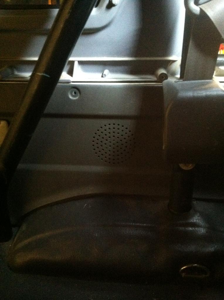

I bought some speakers on Amazon awhile ago and decided to try to install them. The sr5 version of the runner has 4 speakers, and the dlx only has 2. The rear panels have grills for speakers, but there is no way to mount them. Instead of being ghetto and drilling holes in the panel itself, I've decided to attempt some fiberglass work. I am glassing over the rear panels with an insert for 6.5in speakers. So far I have a few spots that need more reinforcement which I just hopefully finished with. I'm not looking to win any car shows but it will look factory besides the speaker part. Im thinking ill carpet then when they're dry.

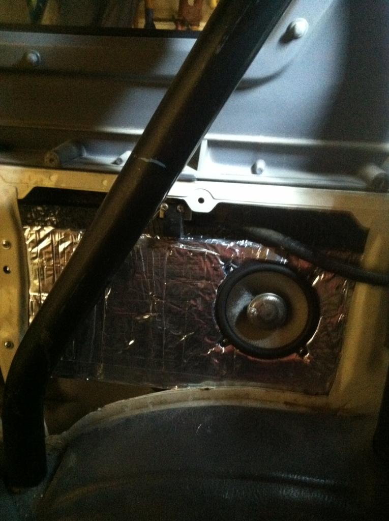

This is how I did it last week:
With plastic on it doesn't show:

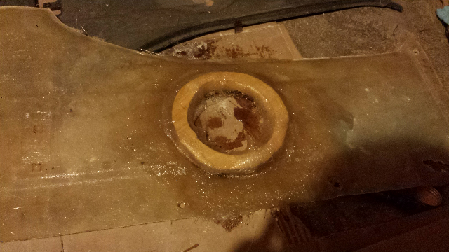

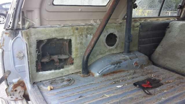

I put on a few more layers last night. It was pretty flimsy but it feels ok now. Maybe a few more then some carpet and the driver side will be done. Im debating on whether I should box in the speaker itself or just leave it open in the back?

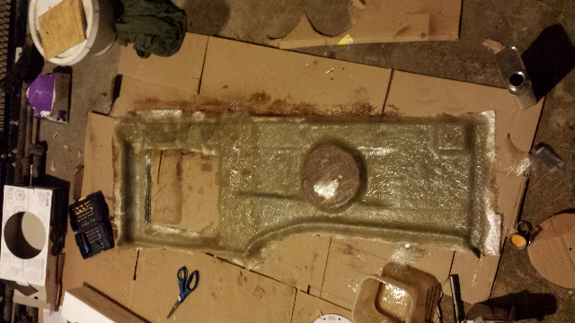

So it's not perfect but I trimmed it up according to the resin line left by the panel and it fits right. I started thinking about how I would mount it and really only had the fiberglass to bolt it to, which isn't even 1/8in thick, so I cut out some wooden rings to bolt it to. The driver side will be sunk in slightly more since this is after the fact. The passenger side glassing will be done tomorrow and hopefully turn out as good or better than the driver side. I'm almost debating on whether I should take a stab at cutting my rusty rear fenders and glassing them...

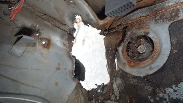

Looked into my rust issue on the passenger front floor. Did some grinding/cutting/buffing proposing it for some fiberglass work when I figured it give gizler a ring. His suggestion to use steel instead of fiberglass makes sense, since the rust is getting to the body mount. Till I get some steel I'll be putting project on hold temporarily. I've been working on my yamaha dt400 getting it road ready.

I'm going to try and make it to the yard this week over lunch and see what's there for some patch panels.
It's not that bad, especially once you get everything cut out and the patch panels separated.
