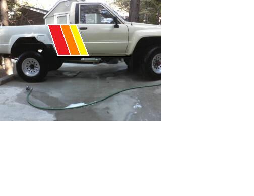

Toyo pics: Ivan inspired graphics I intend to do and the trucks first wash in over 10 year!
