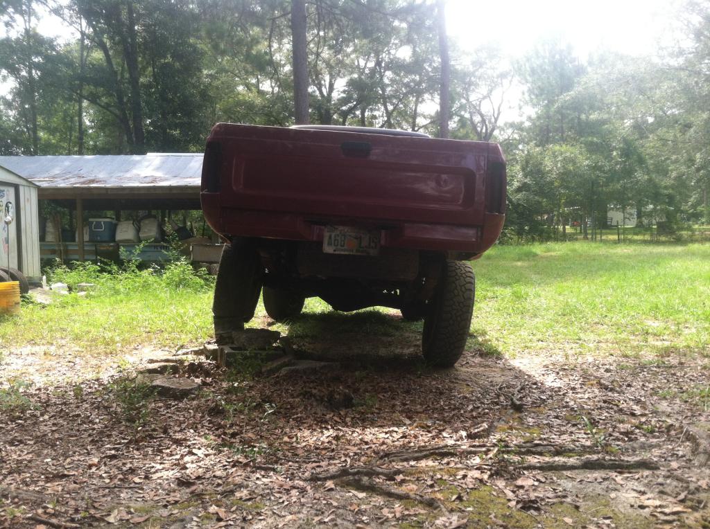

Did the quick release door mod with the trailer hitch pins. It takes longer than you think to line the hinges up, but i guess it's better than having to take the fender off. I was only able to do the passenger side but the door still shuts great.

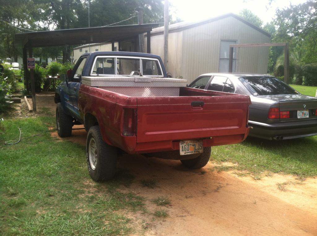

My dad gave me his old tool box. Been wanting one for a good while now. It's gonna be extremely useful.

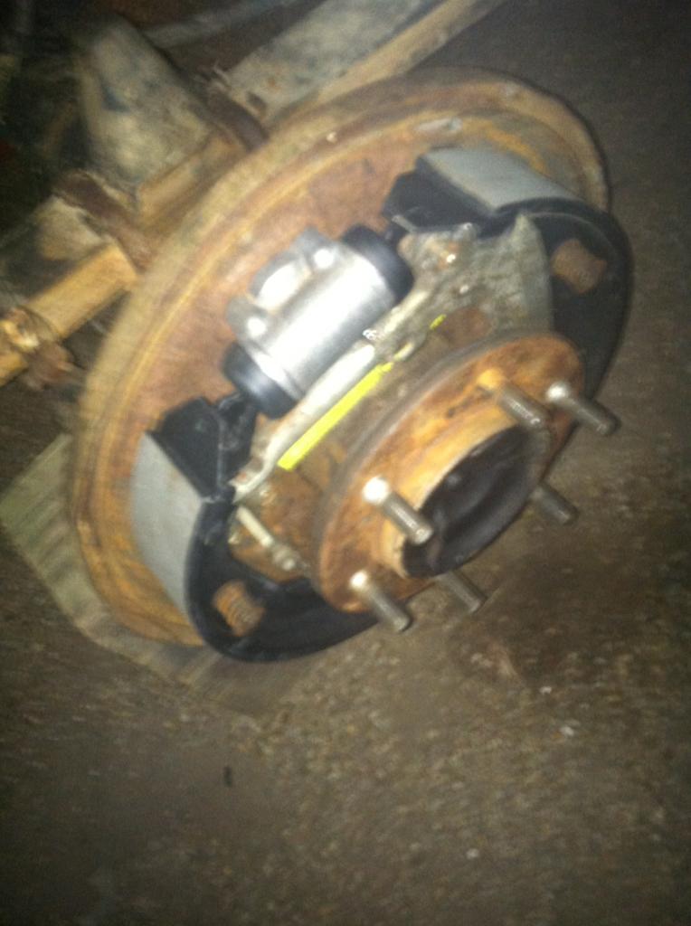

I'm in process of replacing the rear shoes and wheel cylinders.

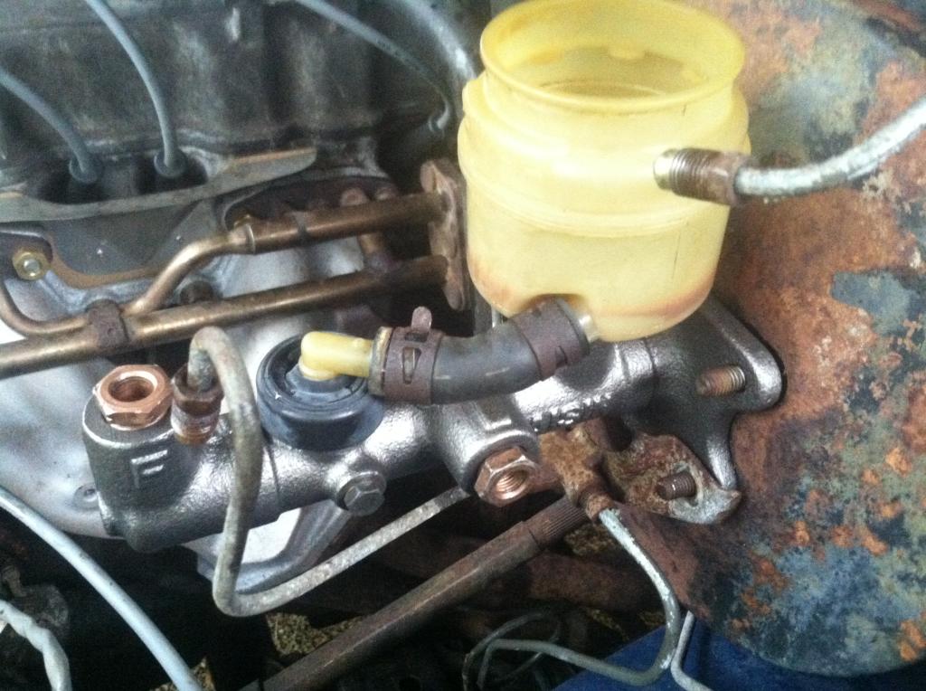

Pretty new shoes and cylinders(little bit blurry)

Shiny remanufactured master cylinder
I'm having problems with bleeding the rear brakes, it seems as though they aren't getting pressure but the fronts are. Any suggestions????

Old Aug 11, 2014 | 01:35 AM
  #89
Terrys87's Avatar
Posts: 11,787
Likes: 28
From: Anderson Missouri
Toyotas are a pain in the rear to bleed for me. Never had such problems in the past with other models. I bleed them and wait a few days and then do it again at a later time seems to work for me. Are you bleeding the Proportioning Valve on the passenger side of the frame on the rear?
Old Aug 11, 2014 | 04:34 AM
  #90
JusToyotAdkins's Avatar
Joined: Jun 2014
Posts: 144
From: Chipley, FLA
Yeah I was trying to do the brakes first then that last.

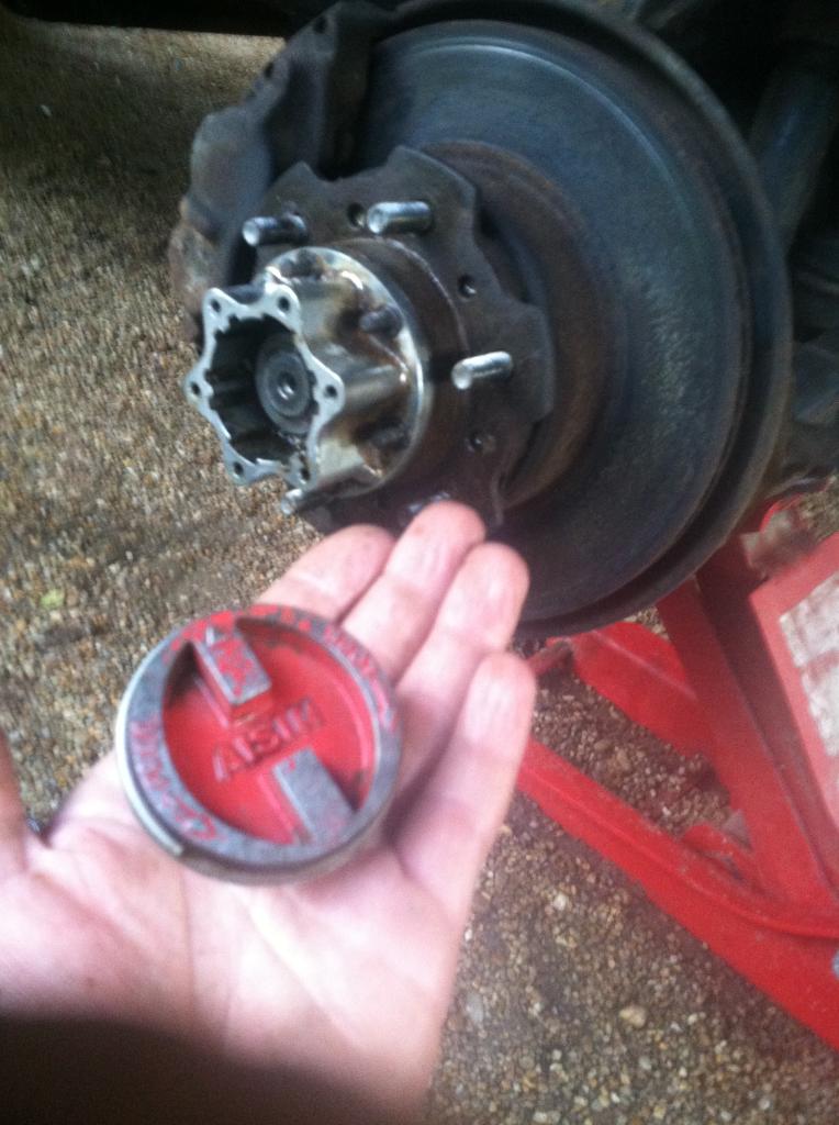

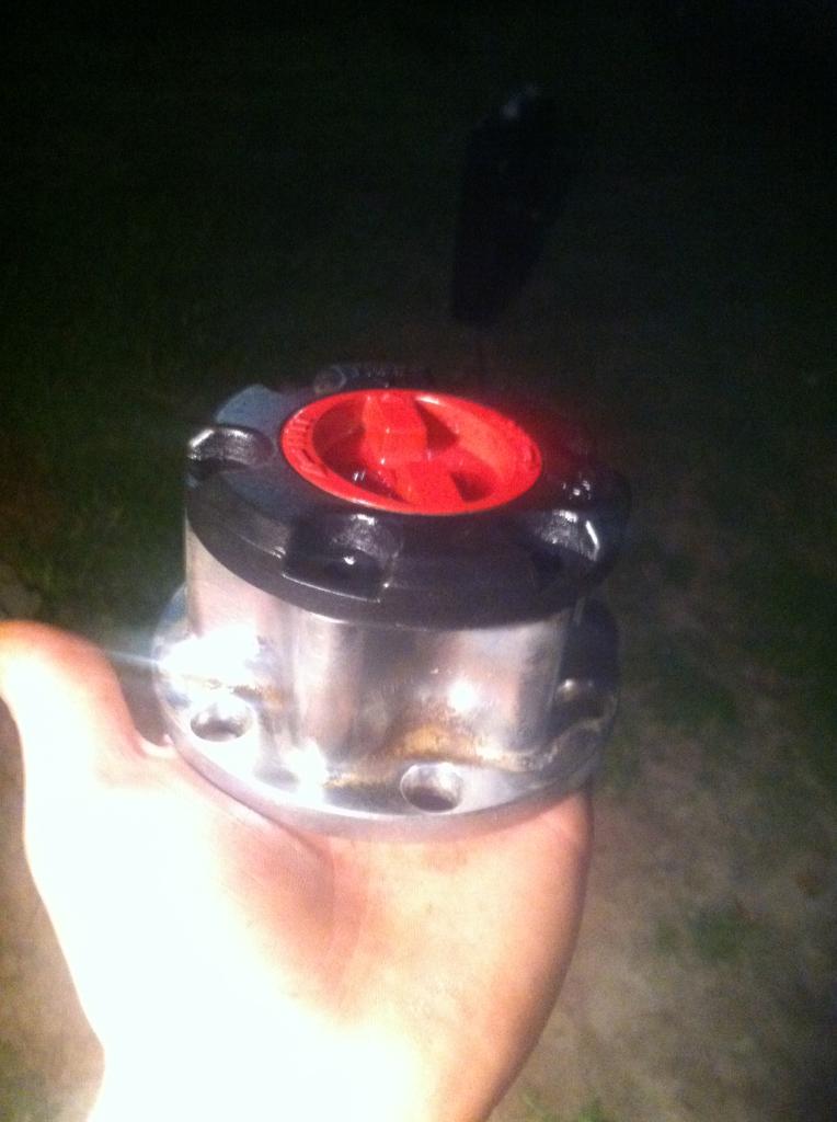

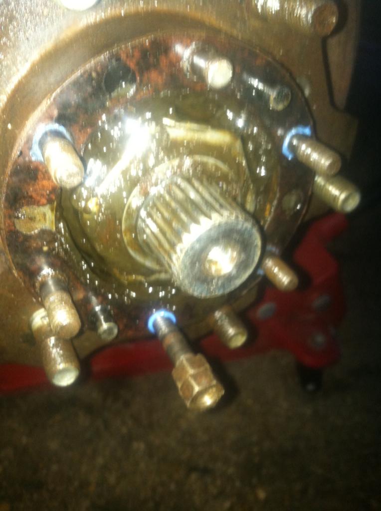

Well yesterday i got bored and decided to tear into the the manual hubs.
I plan on cleaning up and painting the cover to stock colors(black and red)
Cleaning out all the old grease and replacing with new.
Along with new gaskets
And gasket maker on the studs so they don't back out
I started on the passenger side to find this yummy messs
Also you can see where i started taking out the studs and putting gasket maker on them.(I ringed off the top one )

And here's the outcome so far. Hopefully i won't scratch it up to bad putting it back together.

Old Aug 12, 2014 | 11:42 PM
  #92
Terrys87's Avatar
Posts: 11,787
Likes: 28
Not only getting to looking better but getting the maintenance caught up on it so it is a lot really. It all adds up to a more dependable ride.

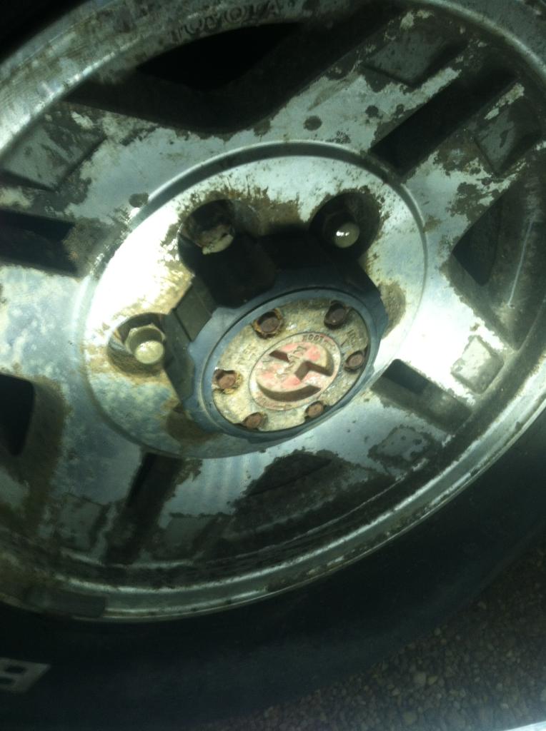

Here's the drivers side but the passenger side looked just as bad..

Old Aug 14, 2014 | 04:37 PM

Nice work on the hubs, they turned out great!
Old Aug 14, 2014 | 04:47 PM
  #96
rattlewagon's Avatar
Joined: Oct 2009
Posts: 4,832
Likes: 332
From: Northfield, Vermont
Real nice work on the hubs! they cleaned up good!
Why were you taking the studs out to put gasket maker on them? Im a bit confused on that one.

Old Aug 14, 2014 | 06:30 PM
  #97
Joined: Jun 2014
Posts: 144
From: Chipley, FLA
I heard they can back out over time and can put damage on the manual hubs. It's just gasket maker not thread lock so it won't be to hard to remove
Old Aug 15, 2014 | 10:00 PM
  #98
Joined: Jun 2014
Posts: 144
From: Chipley, FLA
Having trouble with making the hub retract. It just wants to stay in one position when I turn the dial but I can hold the hub in my hand with a little pressure from the back and it will work fine...
Old Aug 17, 2014 | 09:26 AM
  #99
Joined: Jun 2014
Posts: 144
From: Chipley, FLA
Found out it was the large spring was out of line

I've never seen a center cap like that before,the black plastic one that fits on your front wheel around the hub.nice work by the way.
