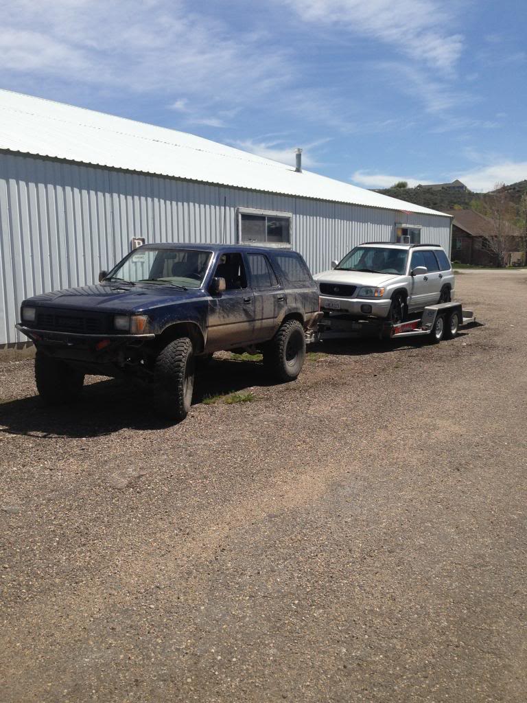

Snow melted off enough that I could park my Forester at my cabin, so I rented myself a uhaul car hauler and loaded it up with the help of a coworker

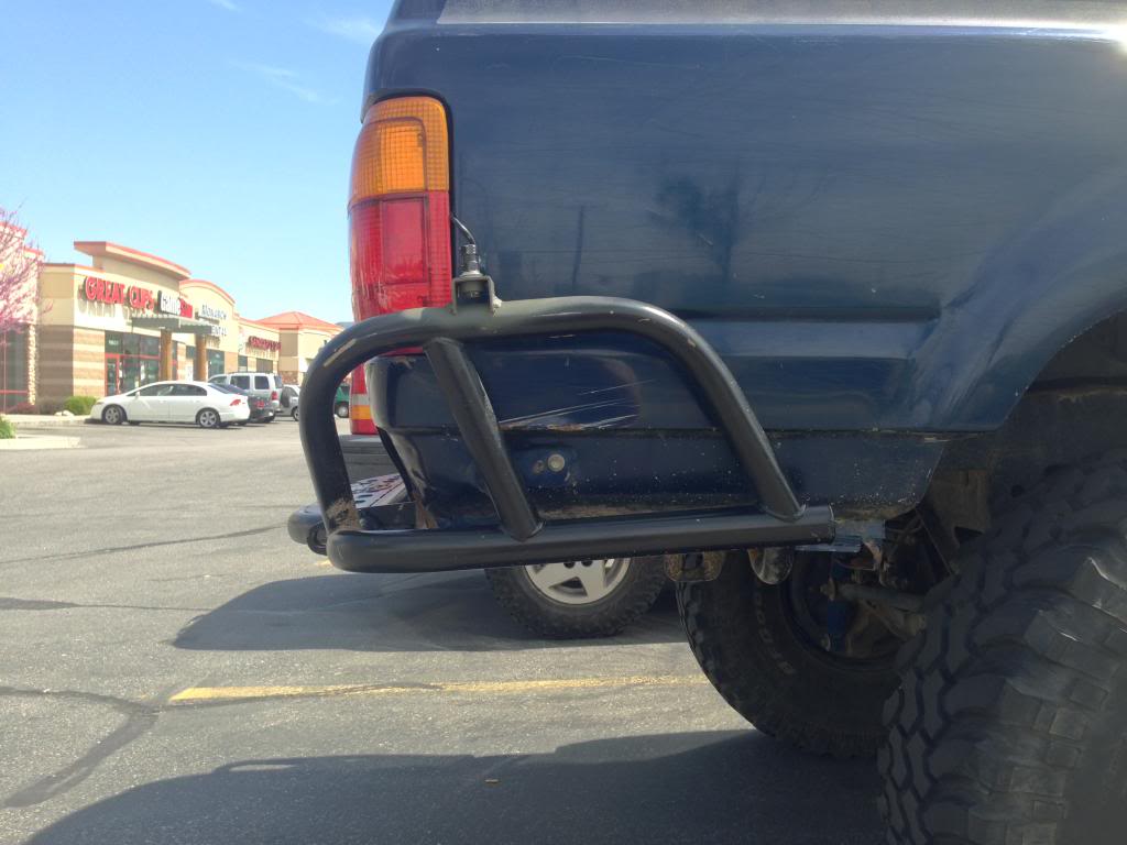

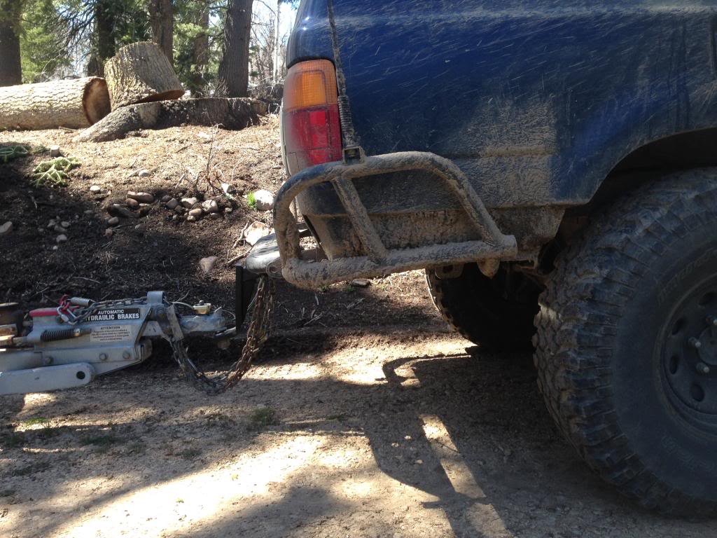

I'm sure it was over the towing capacity of the Runner, but it had it's own surge brakes and I didn't have far to go, really...but here's proof I probably shouldn't have done it
Looks worse cause of the dirt caked on the underside, but it's still not pretty
Mostly just pivoted where the bumper bolts to the frame brackets, but it's bent a little, still. Loosened the bolts and made it pretty close to parallel with the body lines and tightened it up again, I figure the next rock ledge I drop onto will fix it the rest of the way for me.

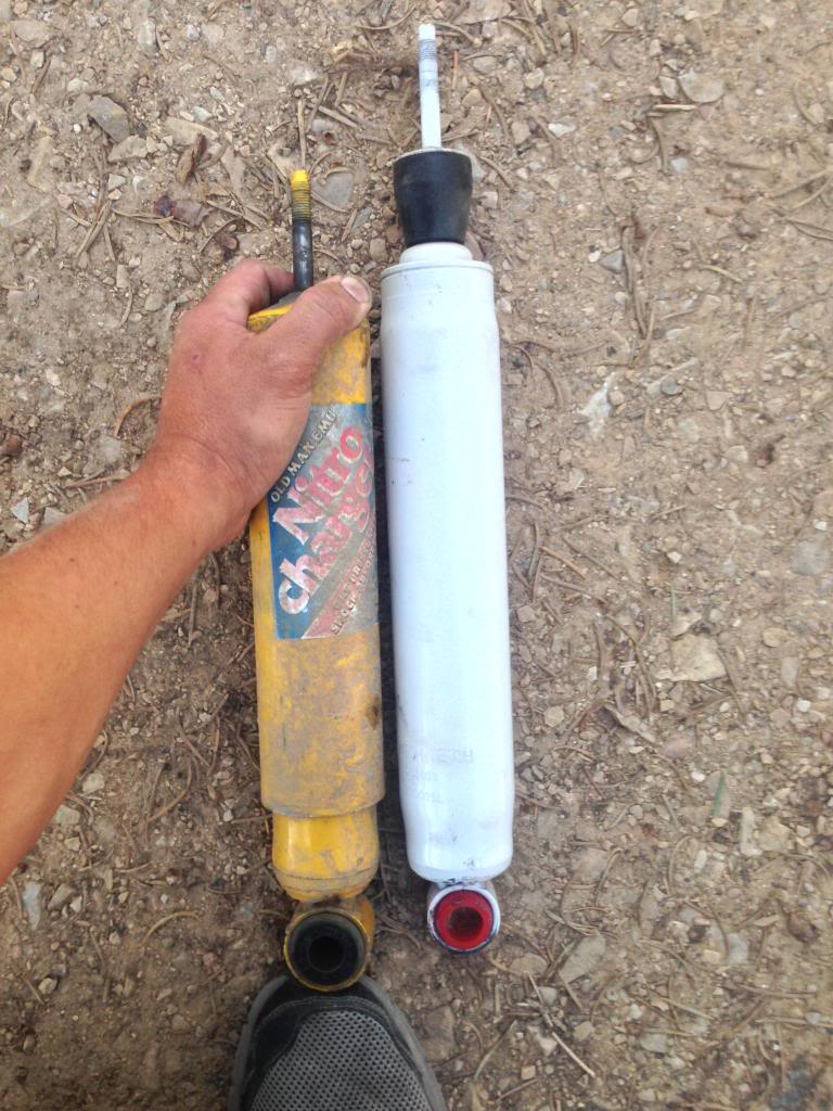

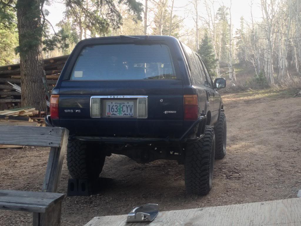

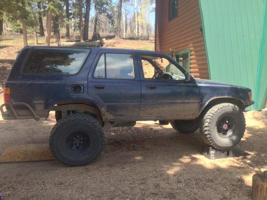

Next issue was my shocks...the road up to the cabin is pretty rough, deep potholes and springs popping up under the paved parts, so I ended up breaking a stud off the top of the right rear OME shock. Got stock replacements, thinking since I'm not lifted that much it'd be ok, shouldn't limit the droop that much...wrong! This is full droop on right rear!

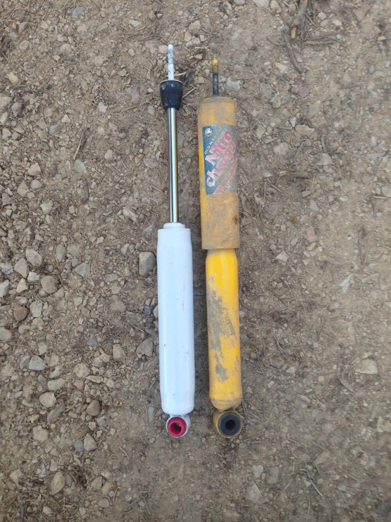

So the best price I could find on something that would work is Doetsch Tech 8250's from LowRange. Comparison to the OME's extended
Compressed(sorta, the OME's are nitrogen charged and the DT's are oil shocks, so I had to hold the OME compressed)

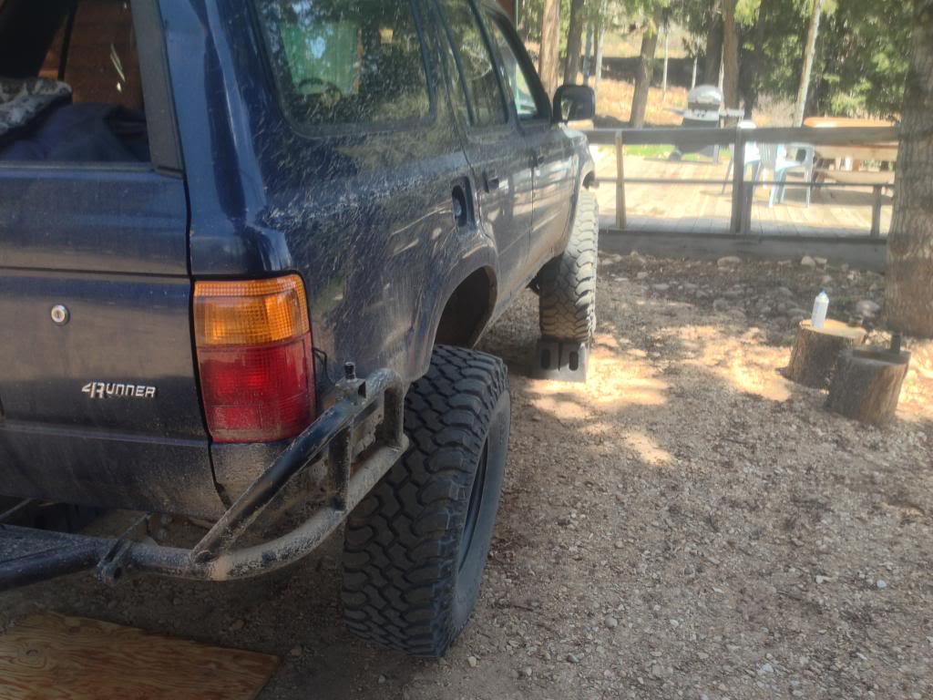

Now it's much better. They ride quite a lot like the OME's did, and this isn't full droop by a long shot. At least 4 more inches of droop at the tire if the other side is fully compressed

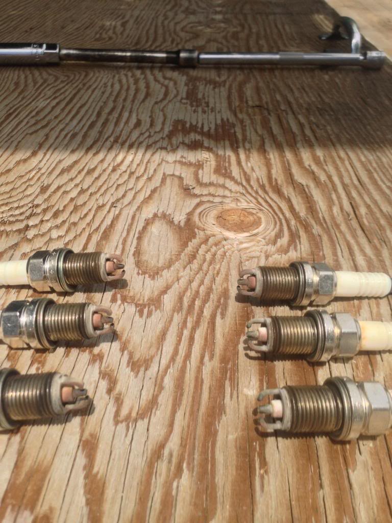

Other bit of information I recently got from Toyotech over on Andrew's(Red Wagon) build thread is that I'm 30k miles overdue for spark plug change, so I pulled mine to check their condition
So a tuneup will be in order soon. Finally changed my trans gear oil awhile back, though, and I can't recommend something synthetic enough! I'm averaging almost 2 mpg better and the trans stays cooler, I got a deal on Royal Purple cause the parts place was out of the Valvoline stuff the guy behind the counter recommended.
