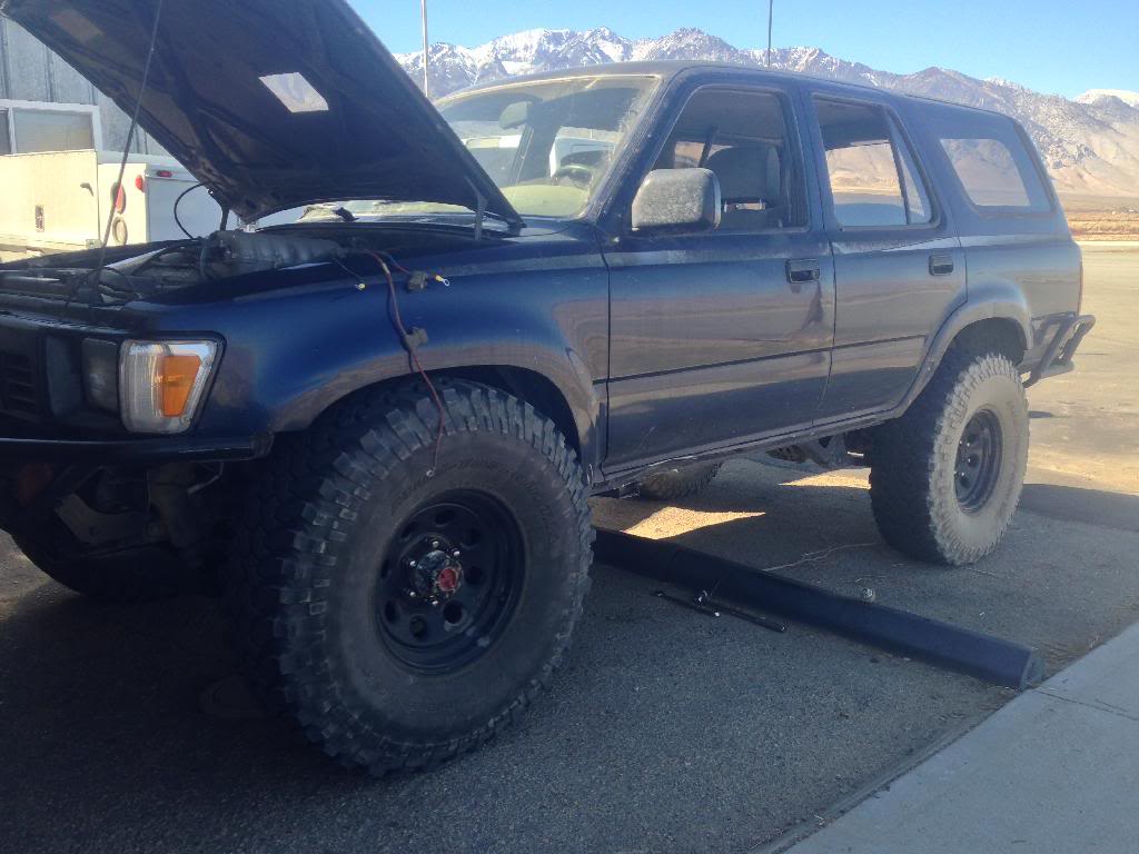

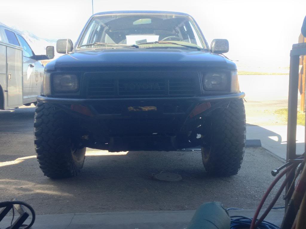

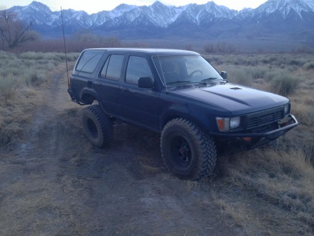

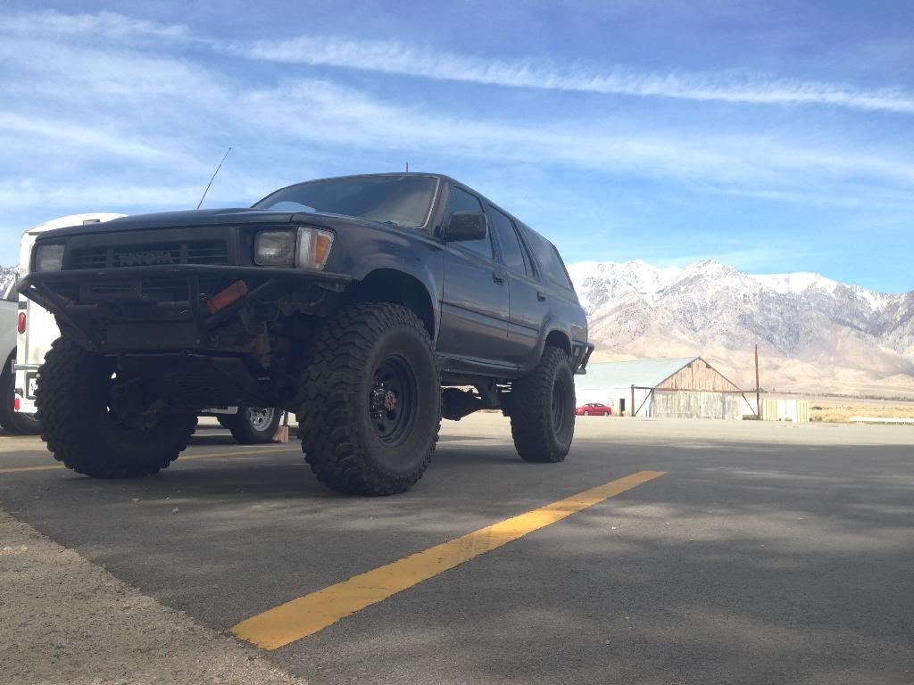

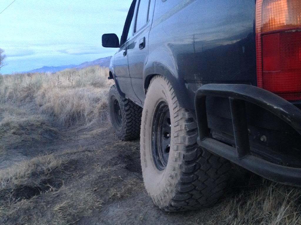

Well here it is with the 35's, probably the last mod for awhile, other than cutting the body for clearance, with me picking up a second job and helping Chef out with his rig.

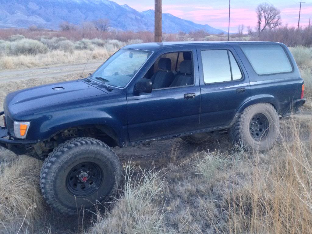

Now don't start thinkin I'm some kinda overly nice guy just cause I'm helping Mark out, just ask him what I said out on the lake bed about the kid who was doing laps near us on a quad.
Mark put up a couple videos in his thread of him recording from his rig, but this one is my favorite of my rig so far

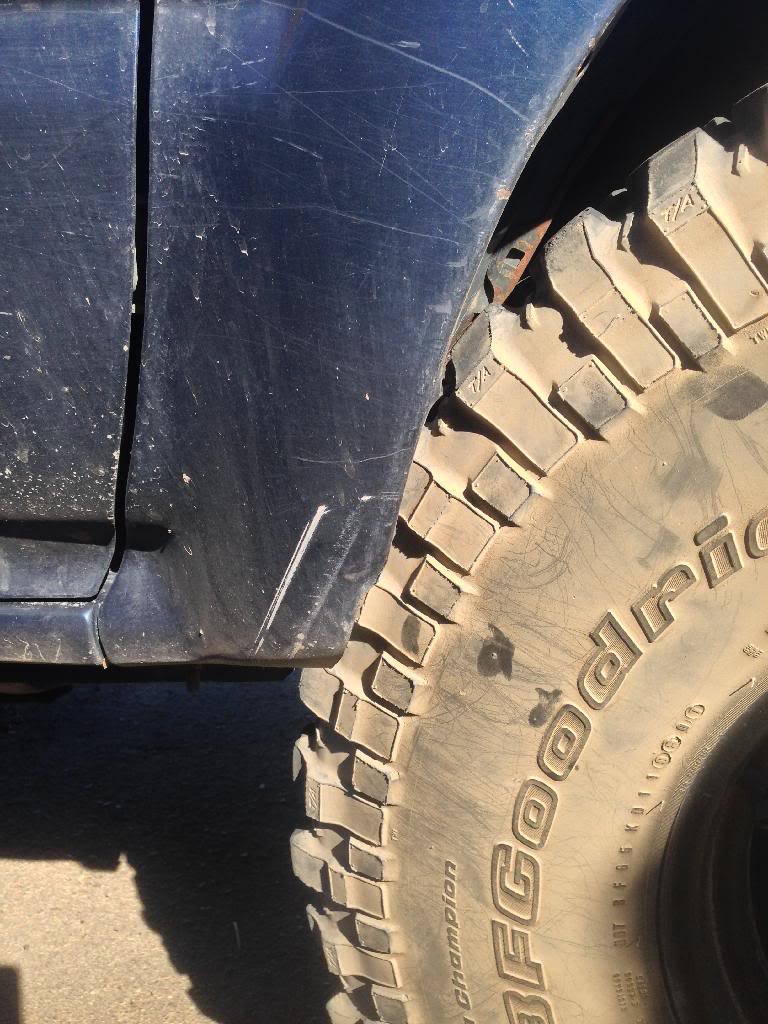

And here's some progress on my clearance for the 35's. So far this was just flex testing to see where it rubs. Obviously the back of the front fender area, but that's it in the front. Got really lucky with my wheel size and back spacing for the rear, though. Just rubs a little on the front edge of the fender there, and stuffs enough to hit the gas fill hose cover on the passenger side. Much different and I'd be crunching my fender!

Great photos man! Are you still only with the BJ lift? Those skinny 33s even looked a bit tight to fit in there, curious as to how the 35s play out. I'm still holding out to wheel with you guys sometime, maybe this summer? Mine will be down under for maintenance for a few weeks but if you guys ever make it up north, i'll be there. I'd even drive down there, doubt my truck would be able to keep up but still. Also, nice rocker damage!
Old Feb 15, 2014 | 09:48 AM
  #288
JonnyBoy's Avatar
Joined: Apr 2007
Posts: 1,580
From: Park City, UT
Yeah, just the spacers in the front and I reinstalled the OME coils in the rear. The 33's would rub a little if I had the wheel spacers on and had the inside front compressed to the bumpstops, but not if I didn't have the wheel spacers installed. Simply put, if I don't trim into the firewall and then patch it with sheet metal, the 35's wouldn't work without a bracket lift or body lift. Thanks for noticing the body damage, too! I forgot to get better pics of that, will do soon.

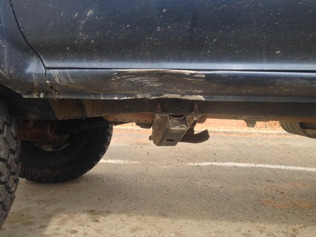

From: Park City, UT
I tagged the crossmember pretty good a couple times as you can see, but I'm not too worried about that. Not really worried about the damage on the rocker panel either, except it was pushed up against the door. Time to get working on building sliders, I guess.

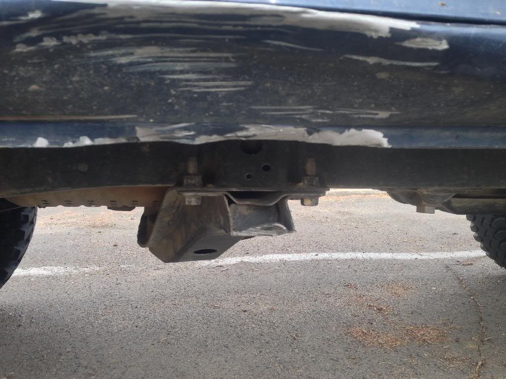

Old Feb 23, 2014 | 01:02 PM
  #291
JonnyBoy's Avatar
Joined: Apr 2007
Posts: 1,580
From: Park City, UT

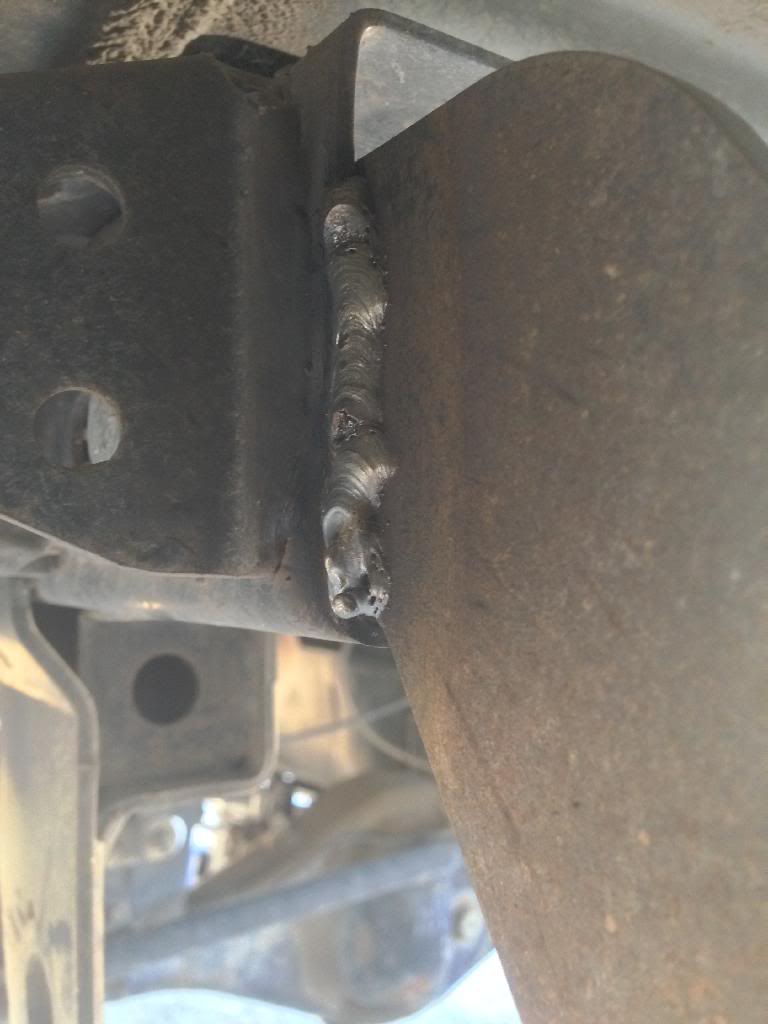

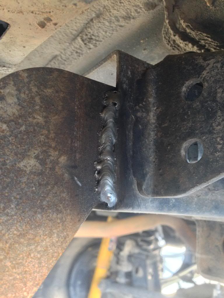

Well I found I damaged more than just the rocker and crossmember at Hammers, the rear bumper(just bolted, not welded to frame) flexed up enough when I landed on it, though never very hard, and pushed the bottom of the tailgate up. Not real bad, but something I'm fixing today since I've got all day free.
So, first time really under the rig welding to the frame... I think it's not half bad. I'll feel a lot better towing with the bumper now
Driver side
Passenger side

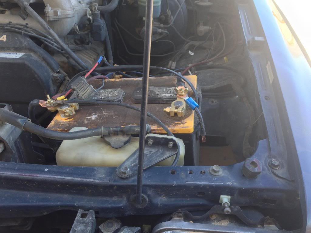

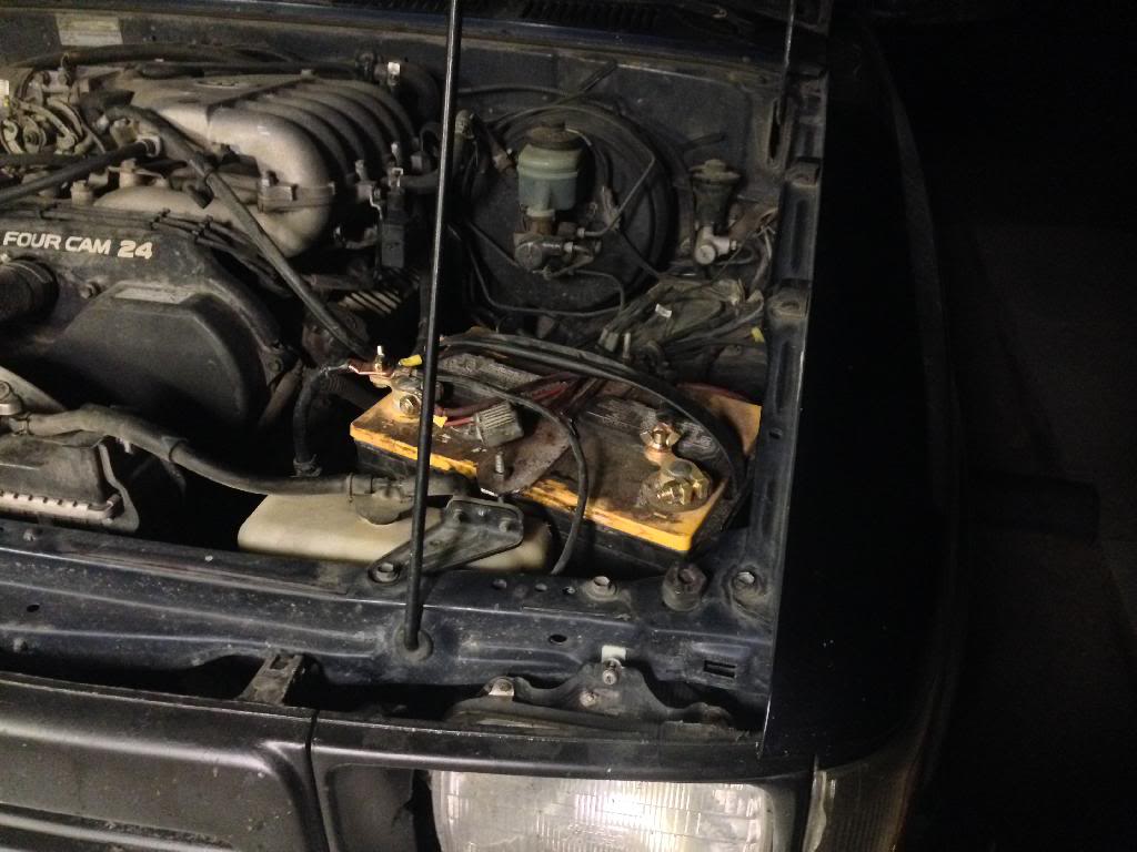

And since I have the day free, I'm also working on a final solution to holding my battery in place. I've temporarily rigged it enough times now, time to fix it how I should've when I did the 3.4 swap
How the battery was setting after the last temporary measure gave up

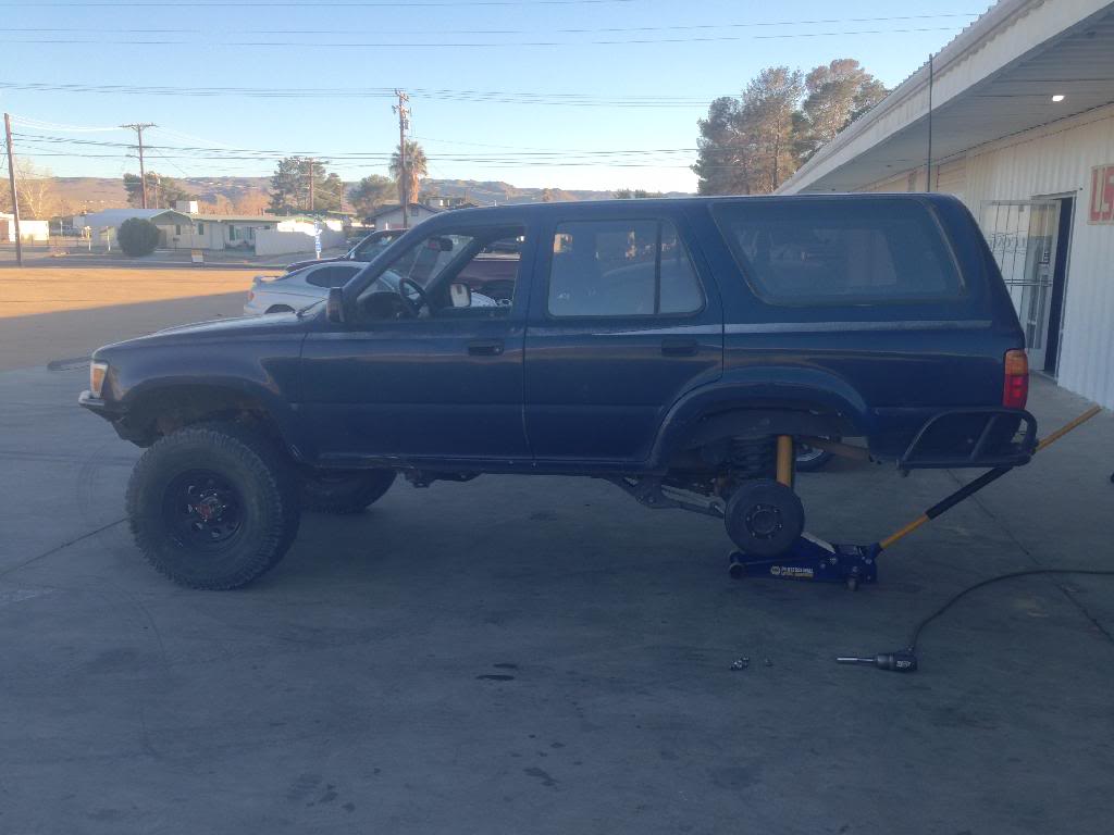

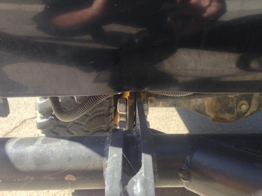

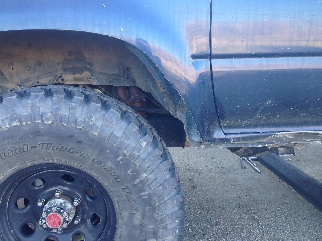

Alrighty, done for the day. Got the rear bumper welded on as seen a couple posts ago, then moved onto clearance...
Got the fenders done, didn't start on the firewall today, but here's an idea of how much firewall I'll have to remove
Before fender trimming
After
Ride height with the fenders trimmed...looks a lil goofy not staying with the curvature of the original opening, but I'm not a good enough body guy to try and make it perfect

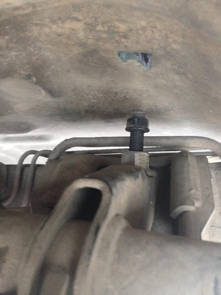

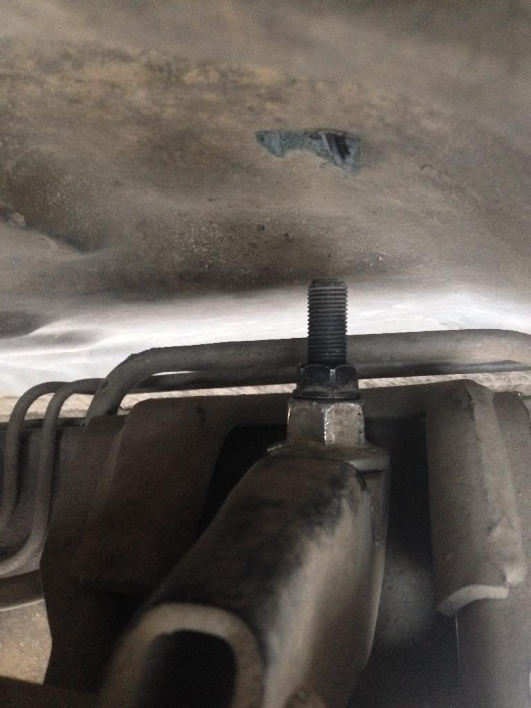

While I'm doing stuff with the torsion bolts, thought I'd show you one of the tricks I picked up on YT awhile back. First, when reinstalling them it was advised to put some anti seize on the threads. Then, noting that the nut on top has sort of a depression on top of it, and with all the sand around here, I felt it was a good idea to put a regular nut on top of it
Then win it tightened down on the torsion nut, sand won't pack in the threads sticking to the anti seize making the bolts snap next time they're adjusted
As you can see, the bars were under tension when the last set of bolts snapped

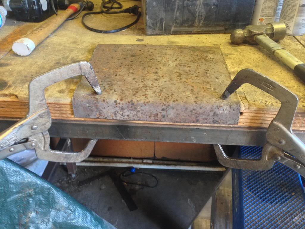

Lastly, making a battery holder out of scrap laying around work. Redneck way of bending right angles in sheet...
And done!
I'd give you all a better look at it, but it's embarrassingly ugly and not all that cool tech wise. We'll see if it holds, worst that could happen is the battery explodes, right?
