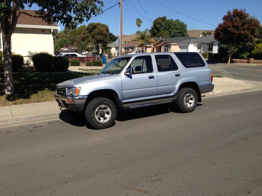

In October I bought a 1990 4wd 5spd 150000k mi 4runner. I swapped some parts from my 93 on to it back in November. So here's a few pics the day I picked it up...

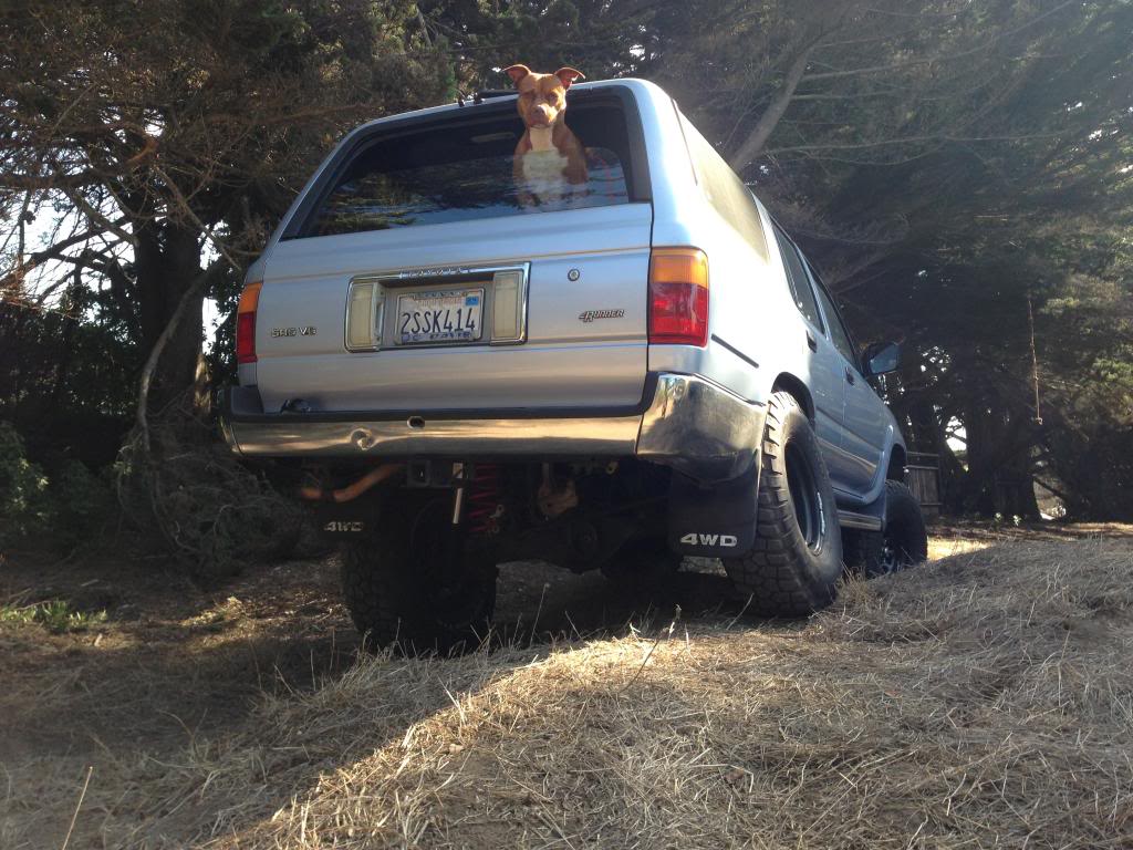

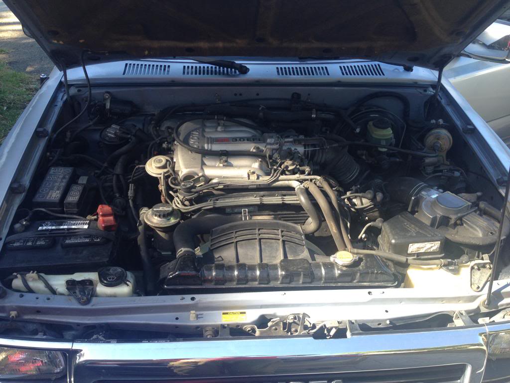

When I drove it home it wouldn't go over 60 without a gnarly shake and it ran pretty rough. I did a little work on it. Changed the plugs, rotor and cap, and adjusted the timing. Got it smogged so i could register it. I swapped in my coils and torsion bars from the other truck. Stole the wheels and tires off of it too! Found out why the 93 had been riding so rough in Tahoe all summer, one of my shocks was trashed. So I ordered some 5125's!! They arrived and wouldn't fit. So I had to order some grade 8 hardware I swapped all of the parts over and took the truck over the hill to Big O tire in San Mateo, had them rotate and balance the tires, and give it an alignment. It was way out. I peeled outta of there and got it up to eighty on the freeway. Still had a little shake after about 65, I think the idler arm is toast. Add it too the list...

Other than the ding in the bumper its clean...

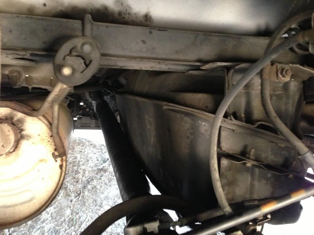

My drive shaft is rubbing the gas tank skidplate when I flex it out....
