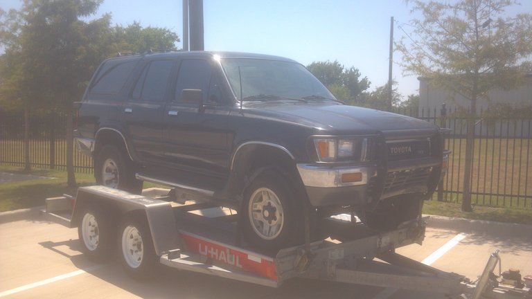

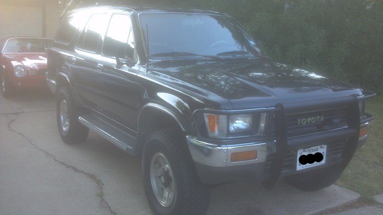

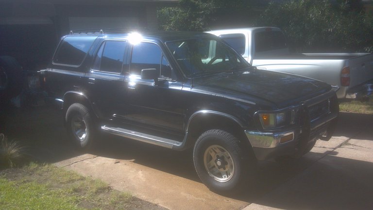

So a little backstory: My first truck was an F150, my dad bought it brand new in 01. Well 2 years ago my sister and I had to share it because she didn't have a car. I would come home from working at night and in the morning she would take it to school. One day she went to school and totaled it. So, i went and bought my dream car, my 79 Camaro. Fast forward to two weeks ago. Been working on my brother's 01 Taco, which is the reason i signed up on YT in the first place, and i loved how simplistic and straightforward the 3.4L is. So, i decide i am tired of no A/C, constant exhaust leaks from headers, and an overcammed motor shaking me to death. So, i start looking for another vehicle. I wanted another F150 at first, but everyone wanted 8K+ for a 200K mile vehicle. So i started looking around and found a few toyota pickups and 4runners i liked, and went to check one out. Guy only wanted 1700 for it, so i figured what the heck. I was pleasantly surprised, i got there and it was in pretty good shape, 5spd, 4x4, v6..... it really just needed some light TLC to be a great car. Told him i needed to mull over it, and that i'd let him know. Yesterday we went and got it, talked him down to 1500 to boot!

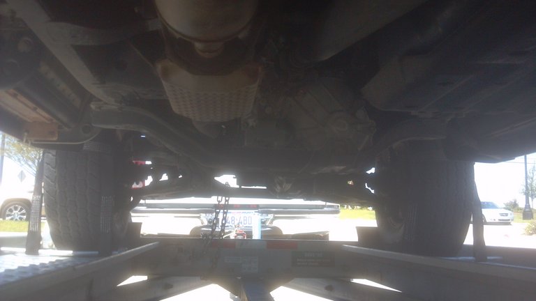

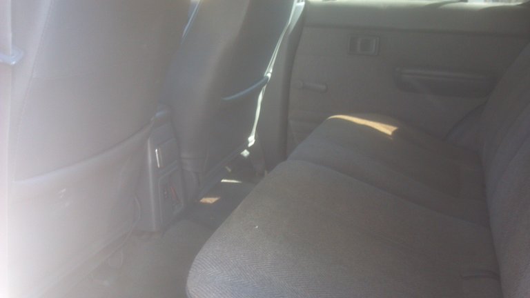

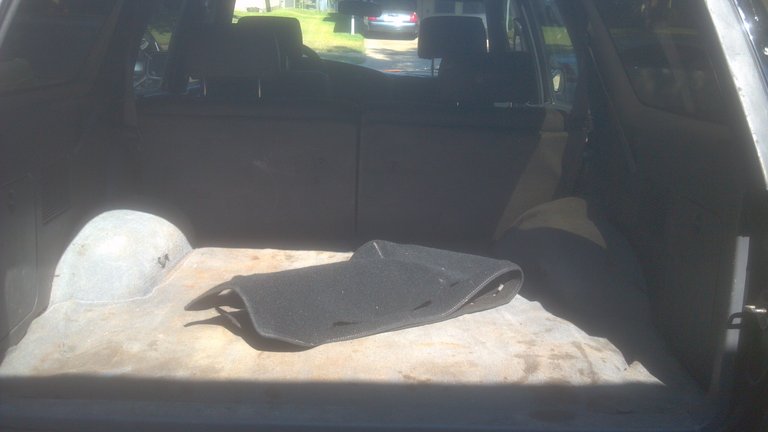

I got to work right away, it got a bath because it looked like it hadn't been washed in forever. Windex-ed the windows and vacuumed.... Cleaned up pretty good, with the exception of the rear cargo area, its stained pretty badly.

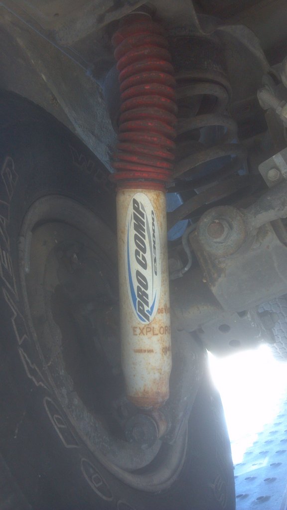

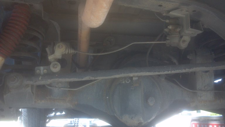

Procomp shocks on all 4's

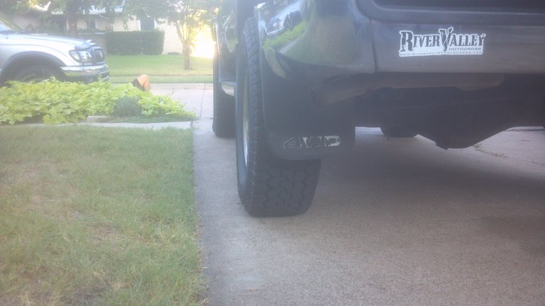

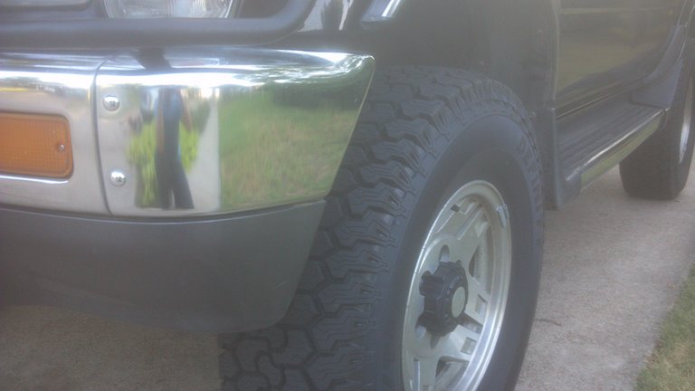

After having a blow out on my way to work last week, pulled the trigger on some new tires. A friend of mine helped me out with a set of pep boy brand Definity Dakota A/T2's. I opted for the 31x10.5LT size, it feels like it has a bit more rigidity to the sidewalls and the truck tends to not have as much body roll. But, anything is better than the crappy tires from 01 that were on there. Got it aligned as well.

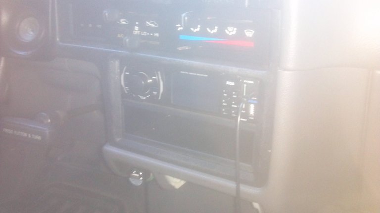

Almost forgot, also got the new headunit installed. Just a cheapo 40 dollar one from sonicelectronix.com. Just wired it up to the stock speakers since i'm on a budget, works well enough for what i need it to do! Sorry for the awful pic, the phone just would not adjust.

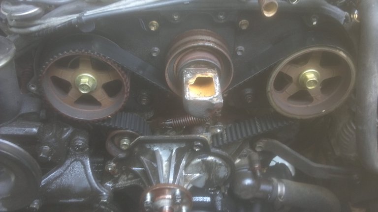

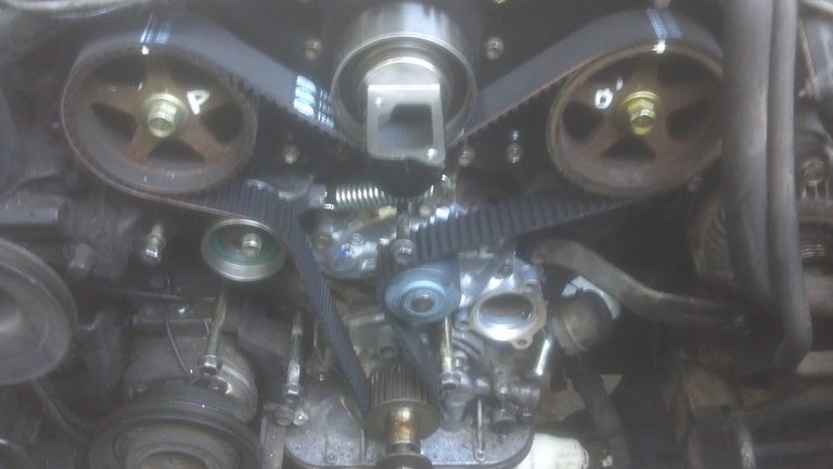

I bought all the stuff to do the timing belt, WP, cam and crank seals, tune up, 02 sensor... Just like christmas!

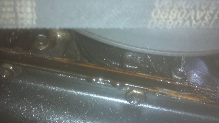

Just about torn down- (It was crazy messy, i think its been leaking quite some time.)
New stuff put back on-
Runs like a champ now! Oh, the tool i bought pn#64300 does not work on the companies website it lists that it works for 3.0L v6's, but does not work with the 3vze, just so everyone knows.

That's why I had to ask about the tool..hahaha, something was fishy about it but I couldn't remember. Anyways, it's looks good! Did you use Toyota parts or some aftermarket set?
Old Sep 18, 2013 | 01:08 PM
jb451's Avatar
Joined: Jul 2013
Posts: 254
From: Mesquite Texas
I used an Aisin WP, and a gates timing kit, which included Koyo idler/tensioner pullies. The only two things i had to go to the dealer for was the tensioner spring (the kit didn't come with one), and some FIPG. Radiator was a spectra, and for the seals i just used timken stuff. 250 and some change from Rock Auto.

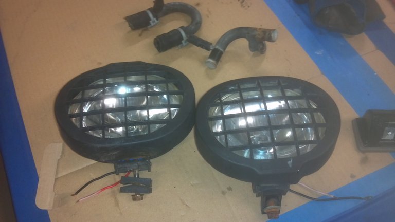

Junkyard score!!
Cruising around the jy today and i found these on an old chebby, i have no clue what brand they are-
They are H3 bulbs, so i'm gonna get some 55w replacements. I'm think 12 gauge wiring should be fine with a relay and 10 amp fuse and a relay in-between .... sound okay? Trying to run two lights off of one wire.
