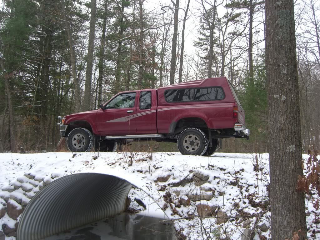

i couldn't make it up the hill, so i backed around. ended up between the stump (left) and the tree (right)
got out, but destroyed every light under the bumper

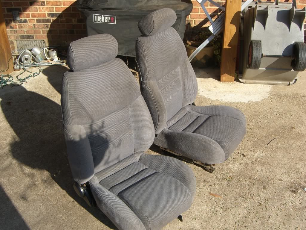

thanks. i'll have more on the seats tomorrow, but i got them both (just the two fronts) for $120. they both have the rear "escape switch" to lower the seats from the back. also, the driver's seat has electric lumbar support (oooooohhh). and a note: they will not bolt right up. i'll need to fab some brackets, but they do not match the yota bolt pattern at all

here are the seats. i tried them out, and they are comfy

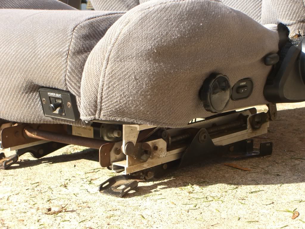

i got a bunch o' stuff done today. well, actually, just the front seats. well, actually, just the driver's seat. so here's how i did it:
my original idea was to make my own transition bracket. ha! the mustang seat sat too high.
first i took the brackets off of both seats. the mustang seat:
here you can see the mustang bracket (back, with all the motors), the yota bracket (the pair of tracks), and the yota seat:
the mustang seat had holes that lined up almost perfectly. just needed to tap them:
so i did. i was surprised that they were metric bolts on the ford seats:
some minor enlargement of the hole was necessary:
i needed to extend the adjustment lever. more on that later:
here's the yota bracket on the ford seat:
and how all the holes lined up:
front left:
front right:
back left:
back right:
almost a direct fit. at least i didn't have to make anything too complex or heavy. the brackets that were made were tiny:
a square hole to accommodate the carriage bolt:
and how they're mounted:
they go on first, followed by the seat:
and they're out of the way:
now, for the handle. i had to extend it, so the first thing to do was cut it:
then i found some tube that just fit around the outside:
and welded a small piece on the handle side. this is before mounting it:
finally, a hole was drilled and a bolt inserted. that was the last step (besides re-installing the seat):
and the final product:
compared to:
