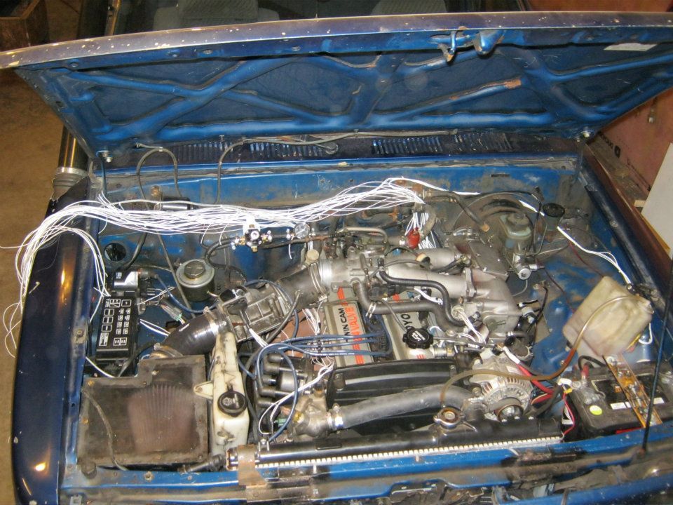

the swaps are almost complete, the front axle is hung from the frame, just need some shocks so I can mount up the shock tower, the engine, transmission ans transfer case are mounted up, but the clutch fork popped off somewhere along the way so it has to come back off.
I used the wiring instructions from supracharged and it worked great, almost. my gauges aren't working right as of now, i'll be working on that later. i had a huge headache trying to figure out why the engine wasn't starting after i had the wiring done. I was so frustrated I drove the hour and a half to the nearest toyota dealer and got them to photocopy some pages out of the fsm for the supra and pickup. it became very apparent what I did wrong when he handed me the page with the location of the relays for the pickup and it dawned on me I had cut two wires on the circut opening relay. when I got back I fixed that mistake and turned the key, fired right up. I then went to work on fixing the rust holes in the floor and wheel wells. It didn't take too much, and I then bed linered the inside of the cab and ran my stereo wires while the carpet was out.

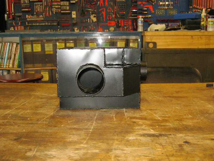

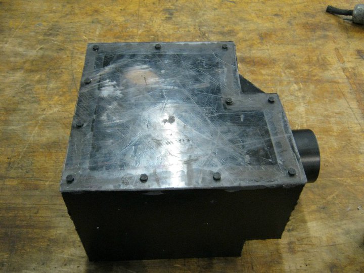

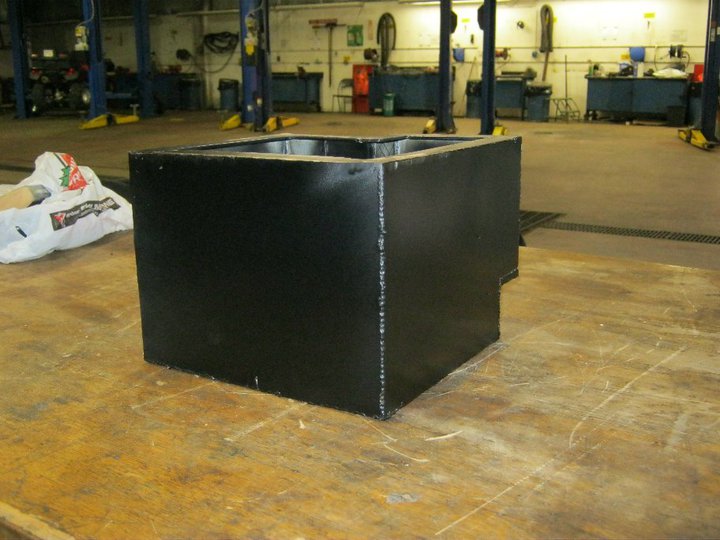

once that was done, the interior all went back in. a set of 4 runner seats are now in place of the 60/40 split bench and theres also a centre console from the same 4runner between the seats. I picked up an E-locker with the switch and control box that will be going in the rear once I regear it. I fabed up a snorkle and airbox as well, used 3" exhaust tubing for the pipes, some thin steel was cut and welded up into the airbox and the cover is made of plexiglass so I can see the condition of the filter without taking the cover off.

airbox pics.

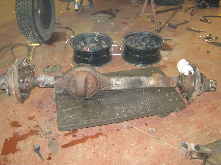

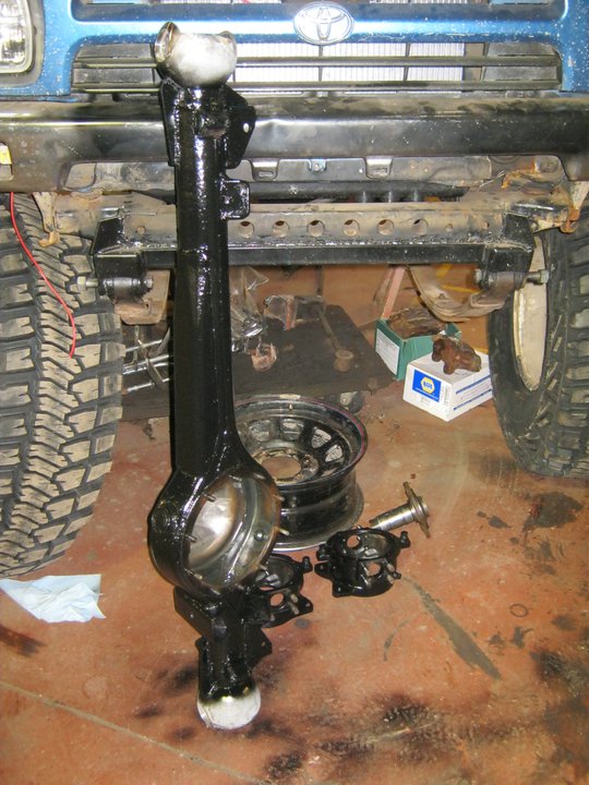

here we have the front axle with all of the un-needed brackets cut off, my Fiance helping clean up the housing and the housing and knuckles painted and ready to get put together.

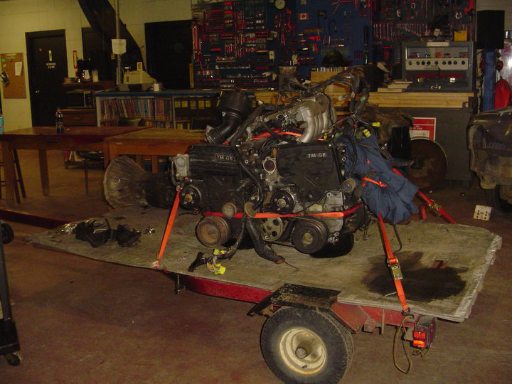

here I've got the 2 engines I had originally picked up for the swap, I was told one was a runner, but it was a guess as to which one it was. I guessed wrong and ended up with an engine I couldn't get running.

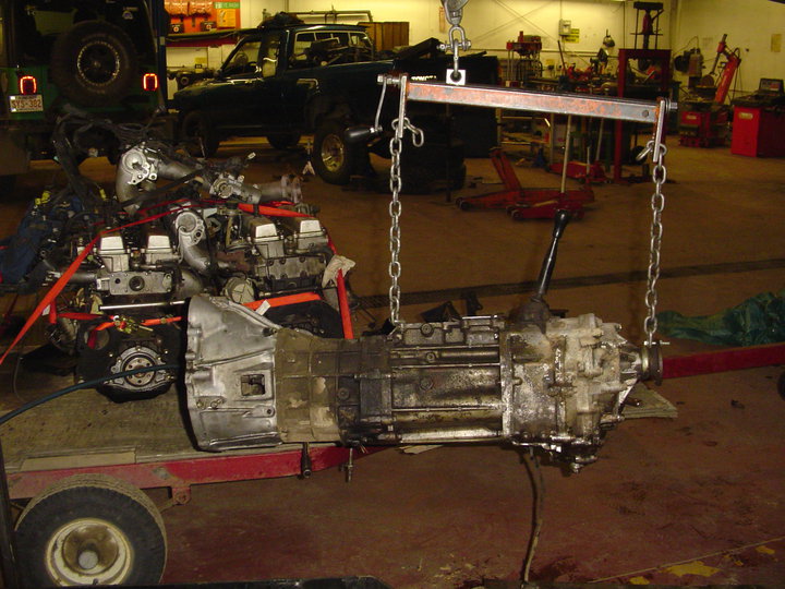

the guy I got the engines from did give me a really good deal on the transmission and bellhousing. I think I payed $60 for both. the trans its still running strong.

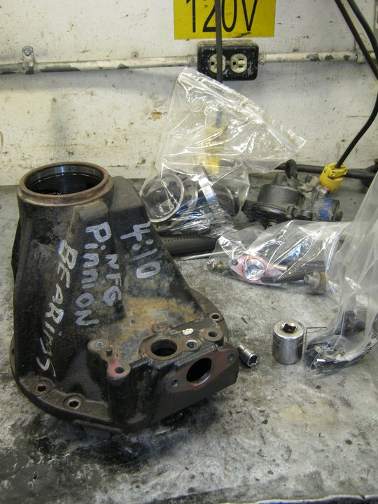

I got the E-locker used and need to regear to 4:88's so it got pulled apart and rebuilt with new gears and a solid pinion spacer

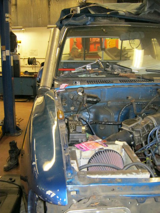

I got spic of the airbox and snorkel installed. the snorkel goes down the passenger side a pillar, which I welded 2 tabs onto and 2 corresponding tabs onto the tube and they bolt together. the 45-ish degree elbow was a spare part from either the 22re or from the 7m.
I had to do a bit of trimming under the fender to get everything to fit, but it turned out pretty good.

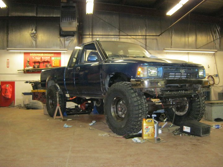

so after a while I manged to get everything buttoned up and it all works! the first pic it was sitting low, I liked it, but I had my almost no up travel, so I added a few cruiser leaves to my packs and got a couple inches.
