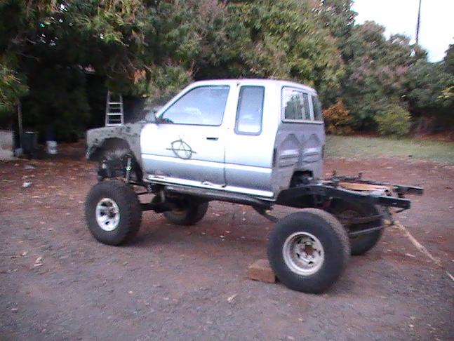

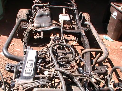

Alright so far ive done quiet a bit in the ways of getting every thing preped for this gloryious feat of human enginering. Heres the big picture. 91 single cabframe with a 92 xcab / dubble bobed bed. So far I have got the single cab off the frame and have been cleaning the crap out of it with a wire brush, wire cupwheel, and some elbow greese mixed with a little degreaser. I have got the body mounts and the 2 front bed mounts cut off cleaned up and ready to weld. Seing that the 92 is a 3.0 I had to remove my wireing harness and in the process of cleaning it up with electronic cleaner for the plugs and some mild solution of dawn for the casings. Its been alot of prep and reserch up to this point but im ready to pull full steem ahead. A few mods that i can think of off the top of my head are as follows.

    Got the day off today so I proceeded wiht hooking up the wireing harness installing the dash, uninstalling the dash, install the vents, reinstalling the dash... Kinda where im at now in all reality im pretty ready to give a testfit see how every thing sits. From the looks of it im probibly going to have to put spacers in the front 4 body mounts to make up for the incline in the frame where I got to install the rear body mount. I orderd my body bushing last week so they should be here any time now.

    I know Trust ive been taking gang loads, just no cord and I havnt left the house cuss 4 day weekend from work and every hour i can has been on my truck, cant just run to walmart where I live =) But now for the good news!!!!! I got the xcab on the fame today and got the whole thing in the garage. Now its only sitting blocks right now and im not ready to star reassembling competely yet... Got to weld up my headers ( got a mean crack in it) just to get it goin before I order new headers. I figured im going to leave the cab mount where it is and taking the cab mounts off the other frame, bolt them to the cab and weld them in place. The only problims im running into is where the fuel fill is at. It seems im going to have to run it back into the bed of the truck. Beyond that the frame starts going up a little in the rear and so im going to have to put spacers in the front 4 body mounts.
