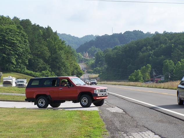

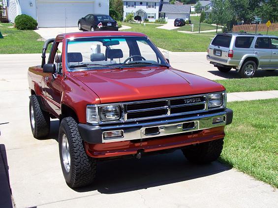

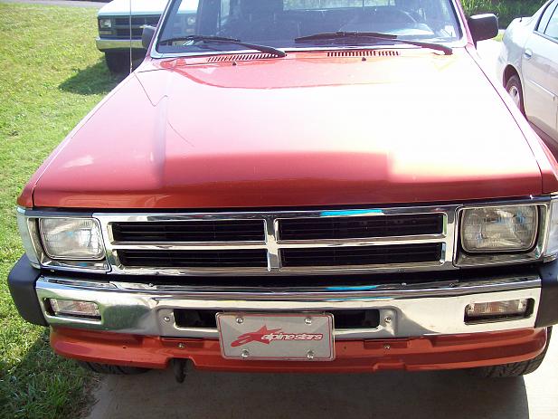

So....I joined the first gen club. I admit it. I have been giving cpr to 2 dying 2nd gens...when all I really needed was a first gen. I gave into my envy o' the 2 doors......Ill probably sell/part the 2nd gens.
Im in love. Chris....an employee...found this on CL in Knoxville TN.
He wanted 4000 with some ghetto style black wheels. Chris asked him if he would take less with the stock wheels.
I got this for $3000. When we got there after driving 540 miles, we crashed in a hotel and in the morning went to see it. I was excited but expecting a let down. I was stunned. I saw it...she was sweet. A father and son rebuilt this rig in the garage. They had skills. I have a billion reciepts....tons of extra parts....extra paint....they set me up.
22re has 10k miles on complete rebuild with new head...etc...
seats recovered. Great paint with a couple small bubbles.
Ill post some pics of what they started with because they deserve the props.
I just got real lucky.
I put these whels on before even going inside when I got back.
The 99 4runner is my DD and suprised me with 20 mpg with the air blasting...and the 87 got 24 on the highway.
Few pics. Like?

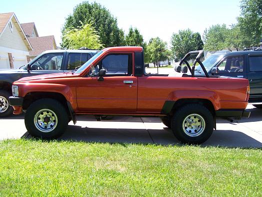

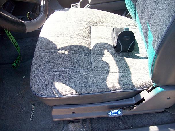

Its not an sr5.....but the cluster is I think...and I have the tippy guage doodle. Inclinemeter? sp.
