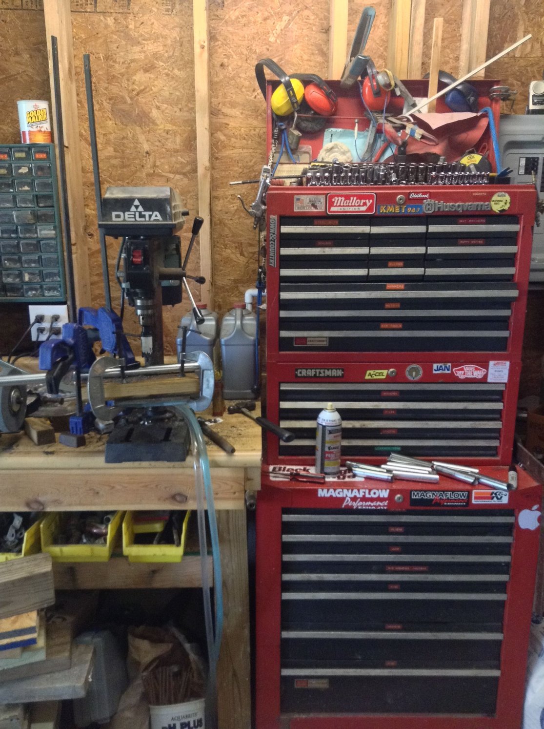

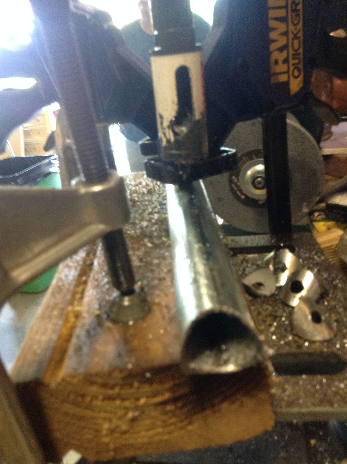

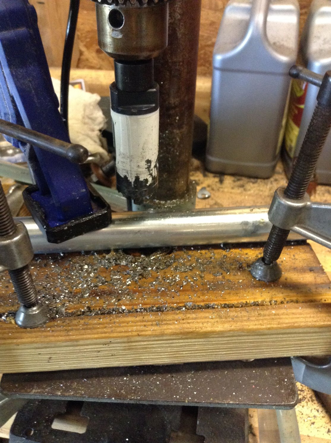

This was our tube notching setup. Pretty cheap and efficient. Used a router to cut a groove in a 2x4, clamped it to my fathers drill press, used a 1 inch bi-metal hole saw...bam tube notcher.
closer look...
It worked pretty decent, especially for what I needed out of it.

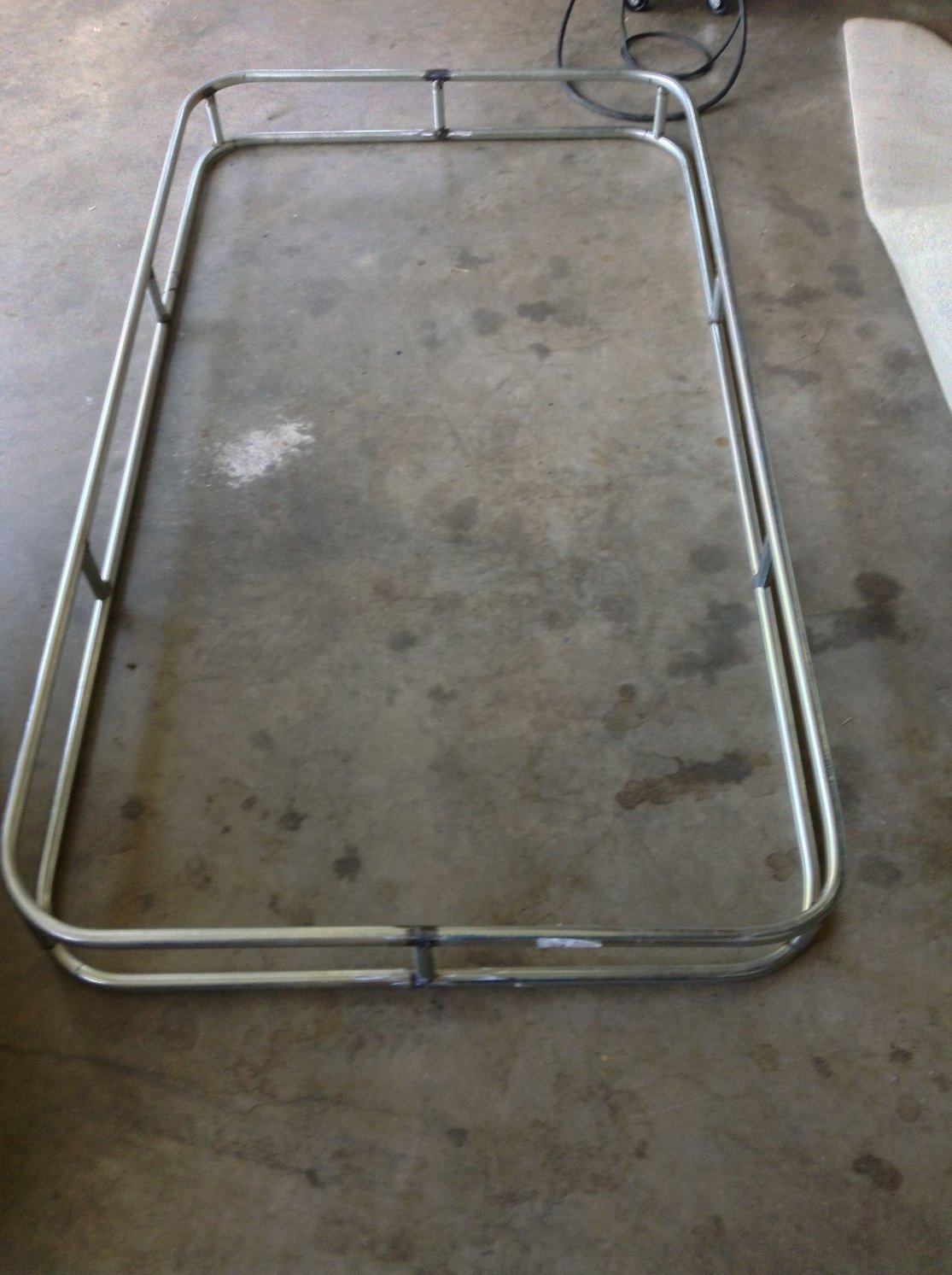

After the upper and lower hoops were welded together, the notched pieces were tacked in.
and looked something like this.
Not the best welds, but it'll do

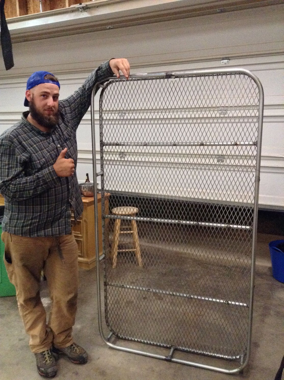

After all the supporting structure was welded together it was time for the expanded metal to be placed into the rack.
lots of snipping to size here.
And now it's seen here all welded together.
Size comparison. I'm 6'2"

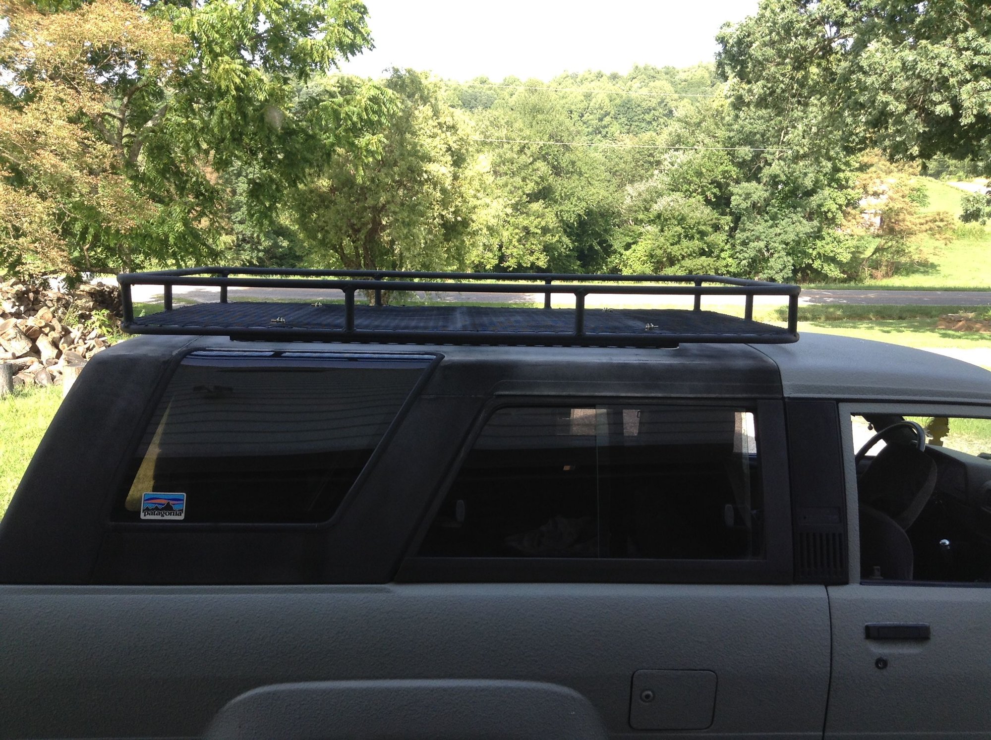

And finally here she is mounted on the roof.
Boom.
