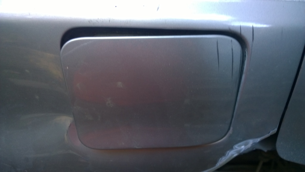

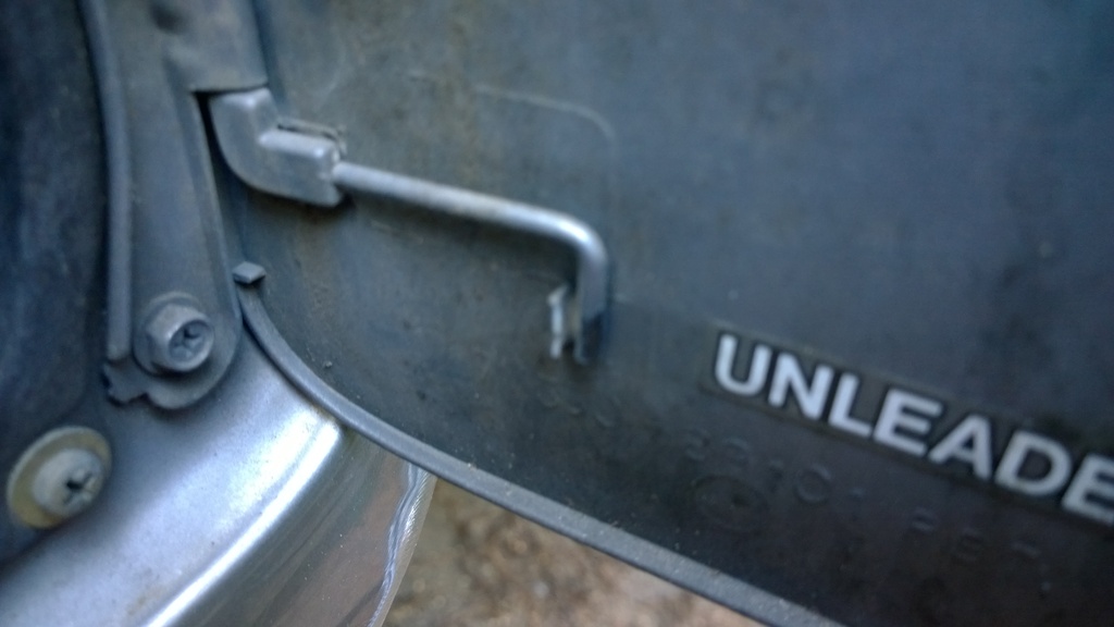

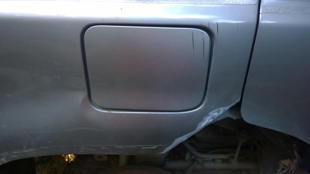

Gas flap was saggy. Turns out the plastic tab inside was broken.
Out came the plastic welder for a zero budget fix.

Good as new on the outside!

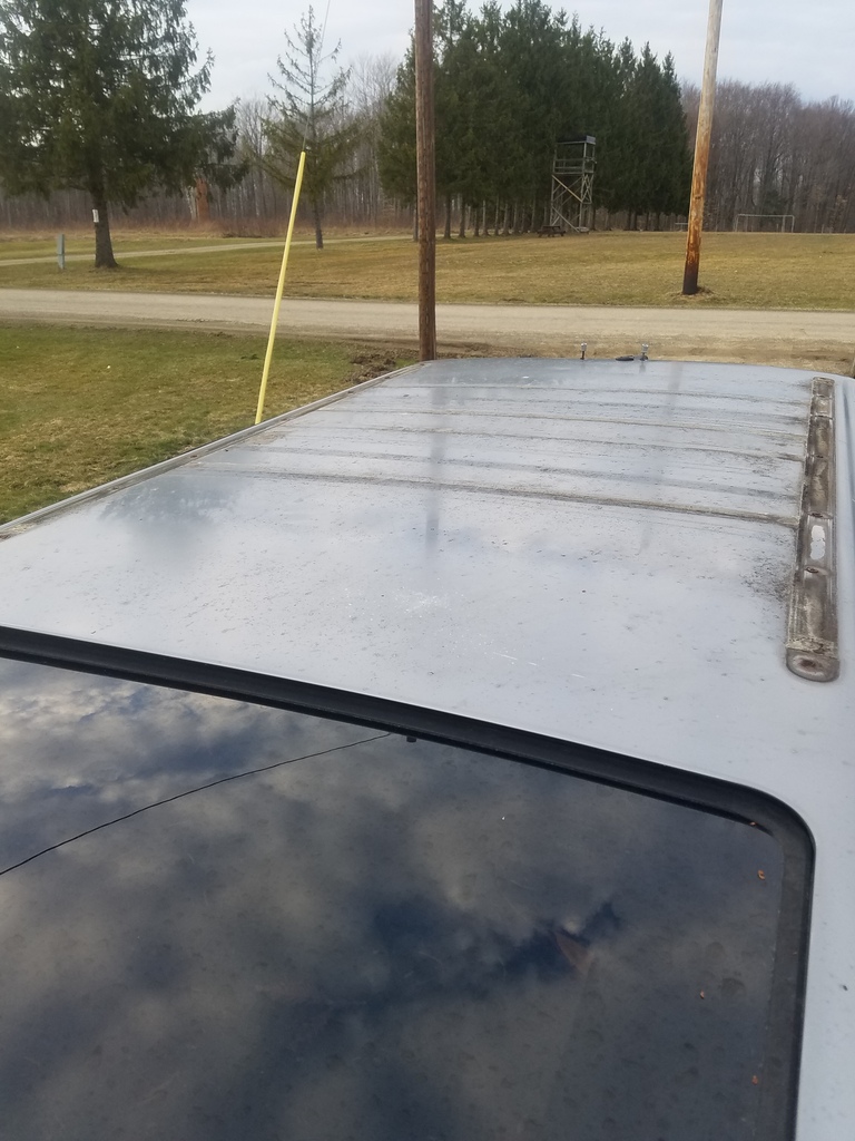

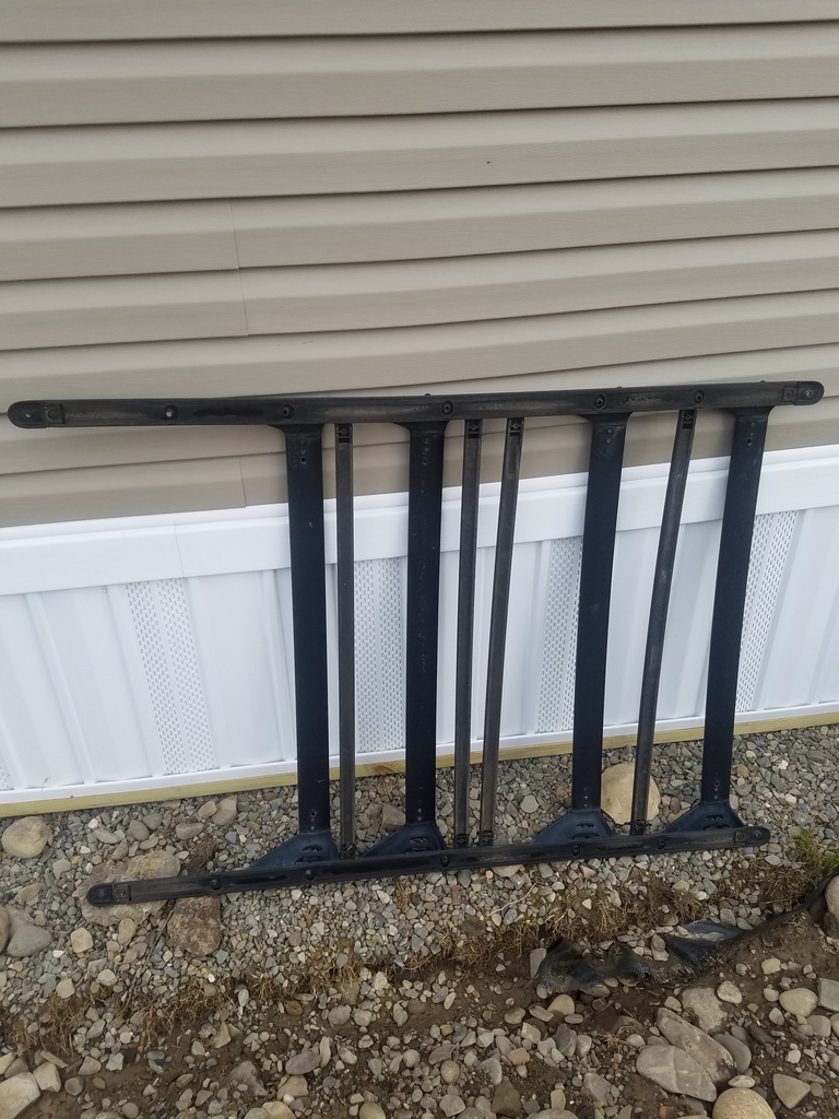

Getting ready for some paint soon. Pulled the roof rack and the rear spoiler thingy. Gotta clean it off. Bought some 220 grit sandpaper to rough up my old paint so the new stuff can stick and not flake.

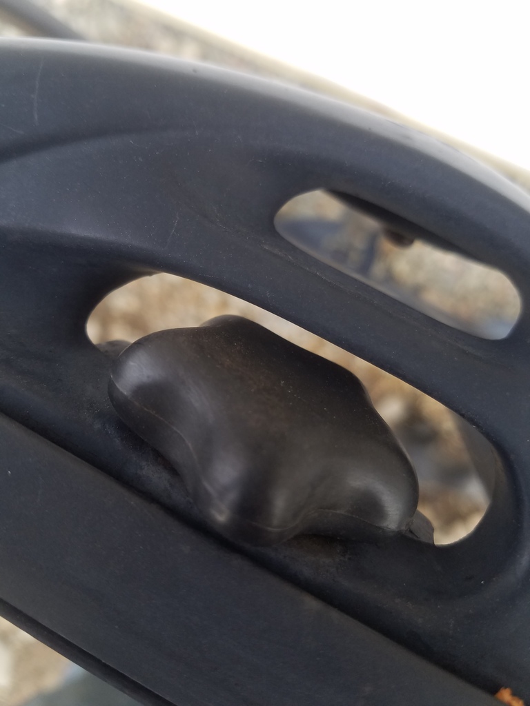

Missing one of these little screw tensioners for one of my roof bars. If someone has an extra one taking up space in a garage or something, or can grab one from a boneyard let me know. 3 weeks til trout season and counting.

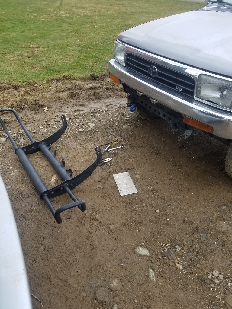

Dropped the brush bar and moved it to the shop. Bar is not that heavy. Will either beef it up or build a better one later.

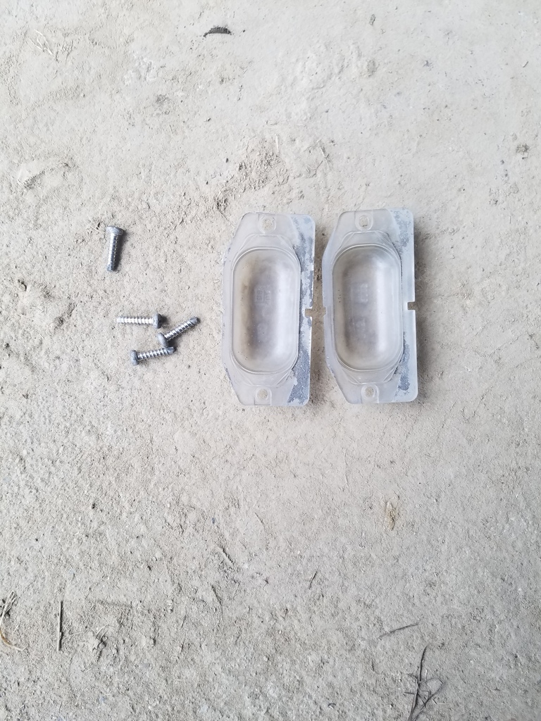

Pulled the bulbs for the license plate illumination to be ready to pass PA safety inspection with no snags. Wiring it was the only unfinished part of my tail gate swap. Spliced it in and installed new 194 bulbs and worked just fine.

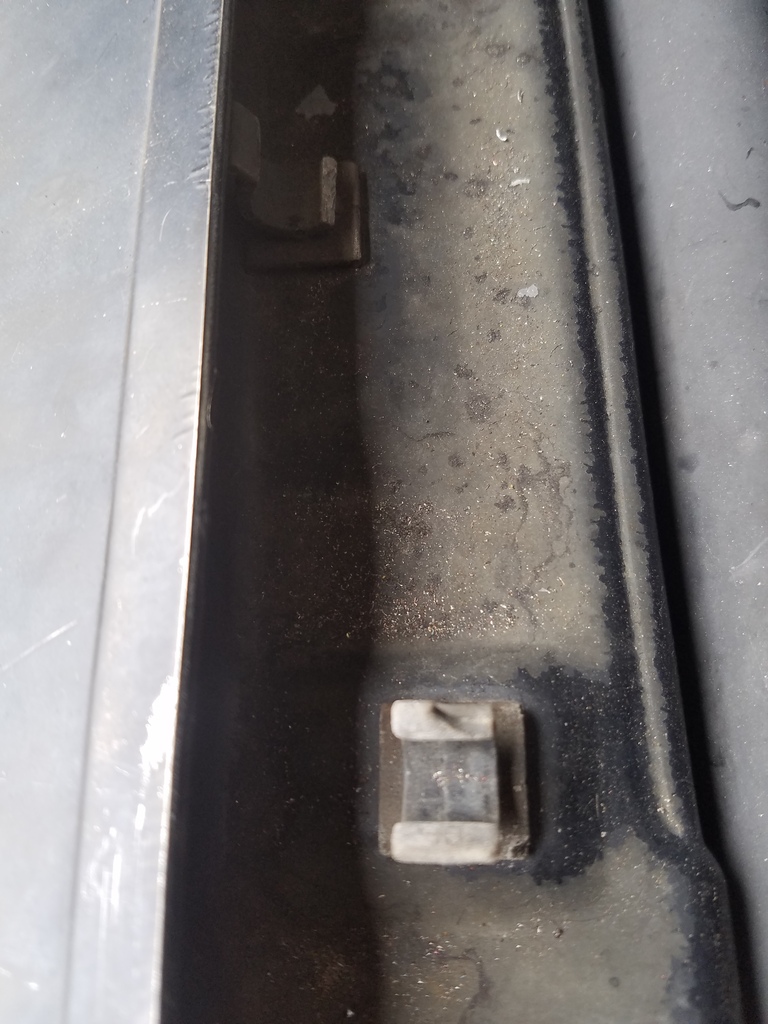

Anyone know a source or part number for these clips? These two are for the lock pin for the swing gate. I'll check and see if they're the same as the one for the prop rod.

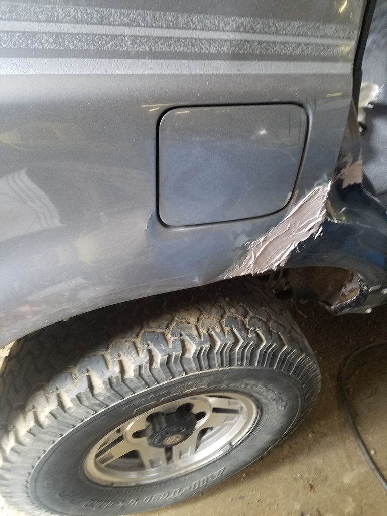

Began with a layer of fiberglass for strength and then bondo for my quarter panel seam.

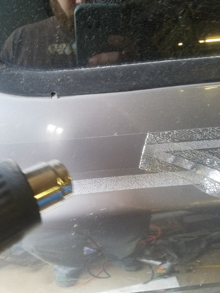

Heat gun and a razor blade slowly got the decals off. The two replacement doors must have baked in the sun more than my truck did because there was no removing them this way. Used an angle grinder and sanding disc to take those off and down to bare metal. Palm sander and 220 grit to smooth it out.
HOLY COW! I must have tried for two hours to get that adhesive off. Didn't want to spend $30 and wait a week for the 3m wheel. Tried paint thinner, sap remover mineral spirits, carb cleaner, sanding, nothing. Finally found some graffiti remover and soaked it with that for 30 minutes, Still took some scrubbing but got it off.

I would final sand with something a bit finer than 220. At least 320. You will likely see the 220 scratches in the finished product

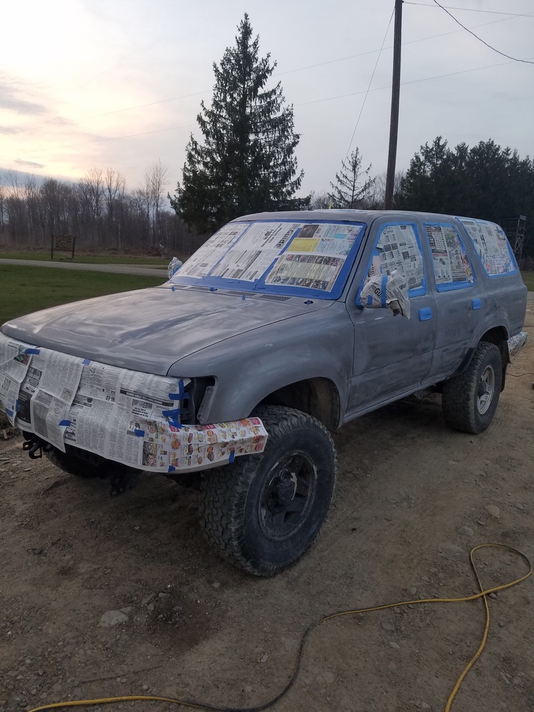

Well, here goes. Cleaned the last of the decal residue up and sanded the last of the bondo spot smooth. Rough sanded it with some fine grit sandpaper.
After I'd covered every inch, I gave it a wet wash to remove all the dust and let it dry.
Taped it up and rolled it into the shop last night.
It's green now, but the dim light and tight space made for poor pictures. Will update tomorrow probably. Will be doing the mirrors and trim in a flat black to match the olive.

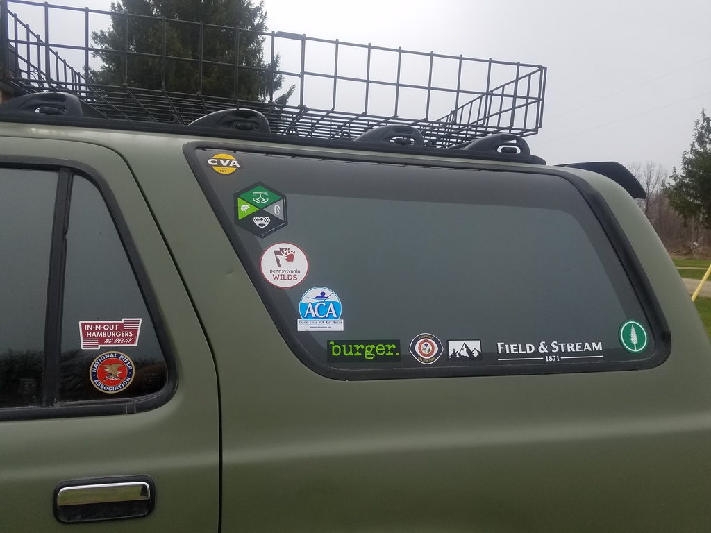

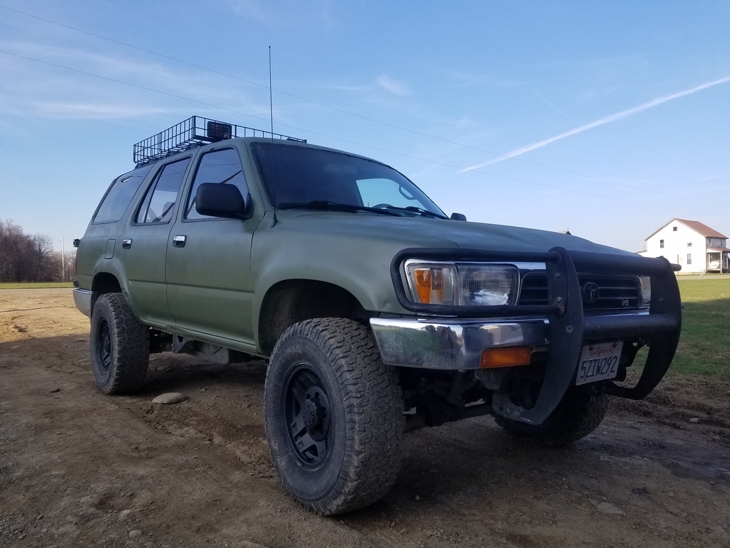

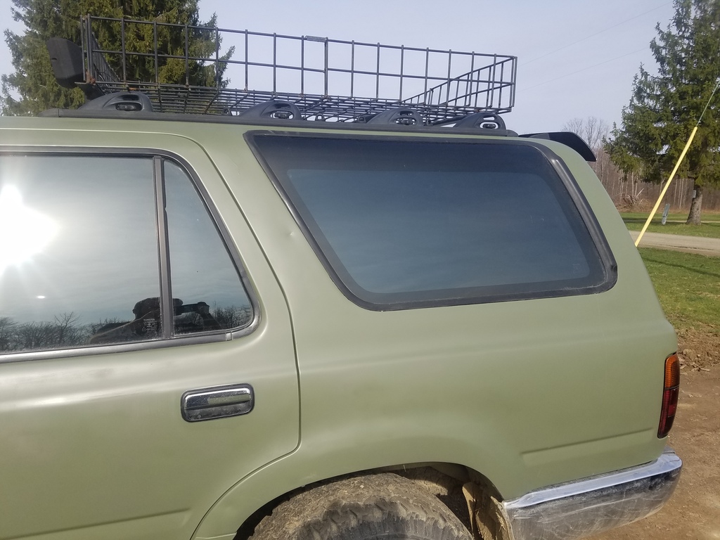

Ahh... Much better. Now it looks like a romper/Mountain vehicle instead of another beater,

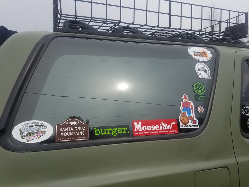

Had to class it up with some stickers. Just too bare. Been assembling a small stack of them for a while. Mix of both Pennsylvania and California and a little in between.
Leaving in an hour for my fishing trip. Got the dogs in the back and the rods and gear in the back seat.
