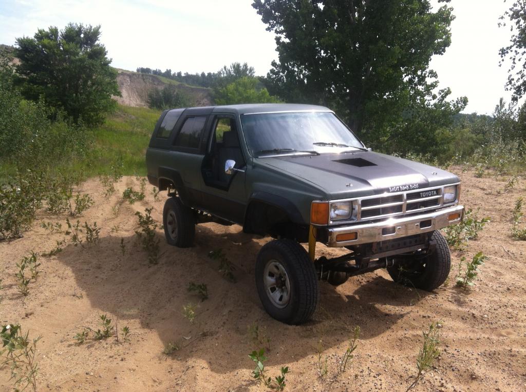

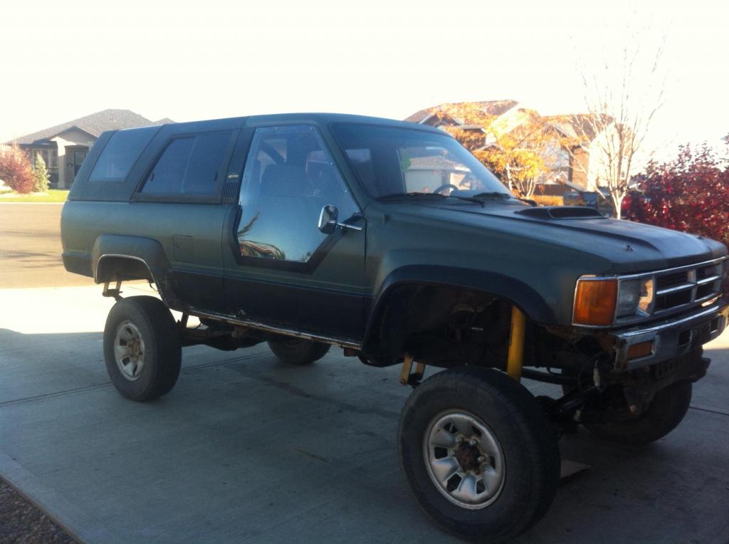

So I guess to update the truck got its first day on the road and....Hauls ass. The feeling of going from a 22re to the 7 MG-TE is hard to describe its a whole new truck.
Some pics of the progress

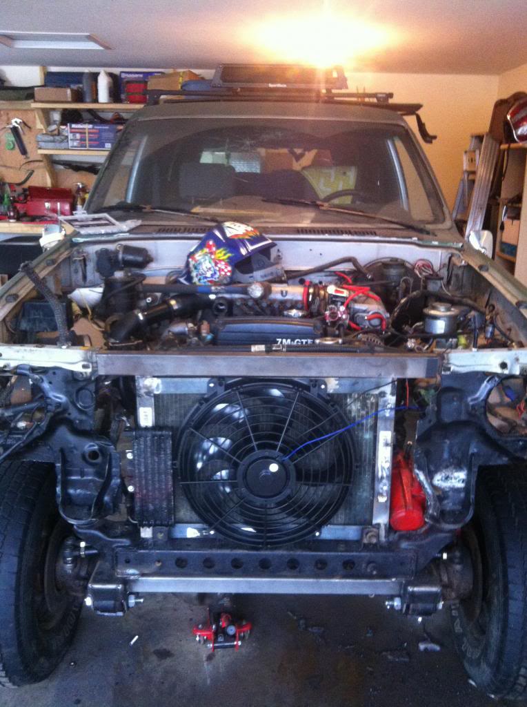

Front End and rad support (hood pins, latch gone) Keeps around 185 on the temp with the fan on.

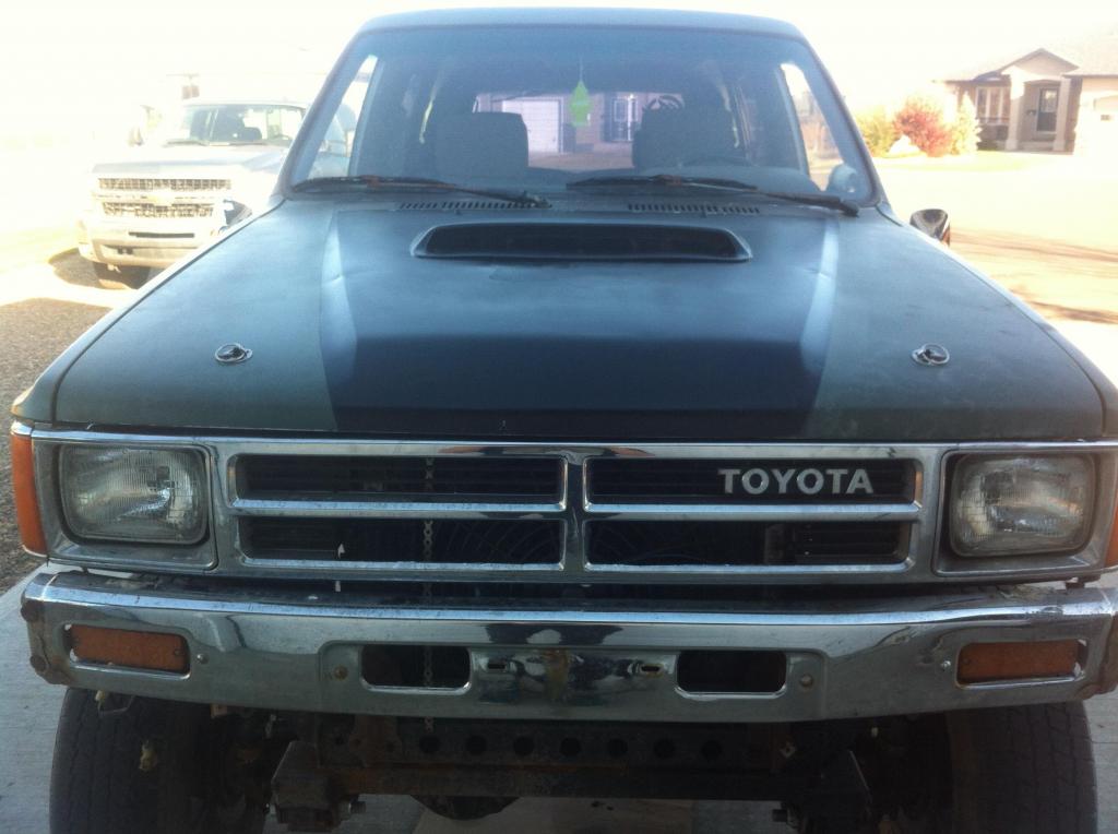

need a scoop!

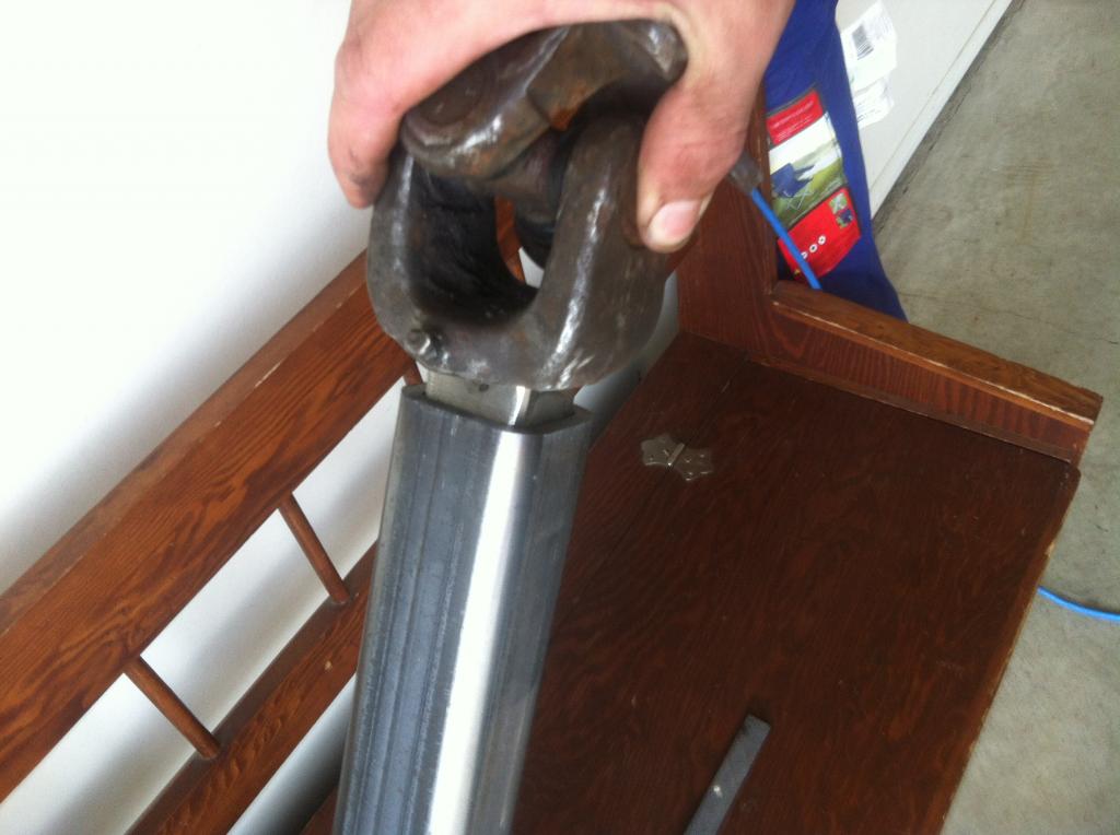

Building front square shaft
also got a new windshield!
The immediate to do list:
Re gear to 5.29's
Buy 35" tires. Any suggestions of kind are appreciated
find some doors for winter
Finish front driveshaft

looking good. I get distracted easilly and I forgot to reply about my top mount intercooler. Sorry about that.
Without reading back through the thread, how much boost are you running? The difference between 6psi and 12 psi is huge. The ct26 has a very simple boost controller you can build into the vaccum line to control it. Will only cost a few bucks. Google knows how to make it.
One of the best things I did was clean up the vaccum lines as i found mine were always leaking from somewhere. Now I have one to the fuel pressure vsv and one to my brake booster. Looks much cleaner once I took them all off too.

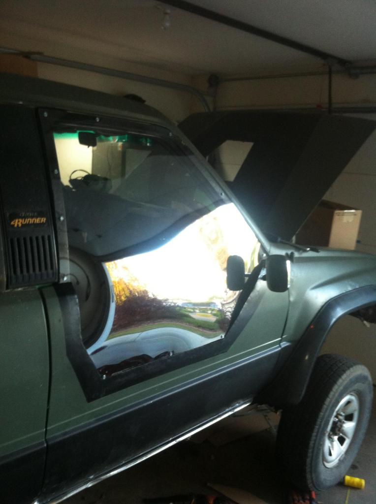

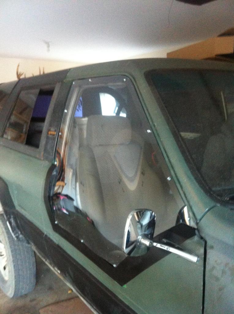

with winter coming I thought that maybe I should upgrade the windows from a cut up shower curtain to something a bit stronger.
so I decided to go with lexan

Nice work on the windows! I really hope I can get some 1/2 doors made by next summer....that and a soft top would be sweet too!

Subaru scoop

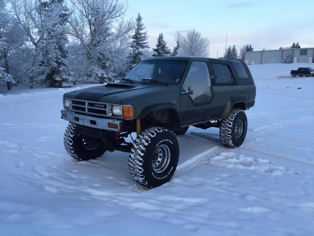

Got my tires!
So I'm having some issues with heat in the cab. Ever since I got the truck it hasn't produced any heat. I always figured it was the heater core so I took the dash apart today and pulled the core. It seems there is nothing wrong with it. Coolant flows freely through it no rust or sediment . I omitted the valve on the firewall to make sure it wasn't the issue. This problem existed with my 22re as well as with the 7mgte. Any ideas?

I like the Subaru scoop! I've thought about adding some kind of functional scoop or hood vents to reduce engine temps under the hood.

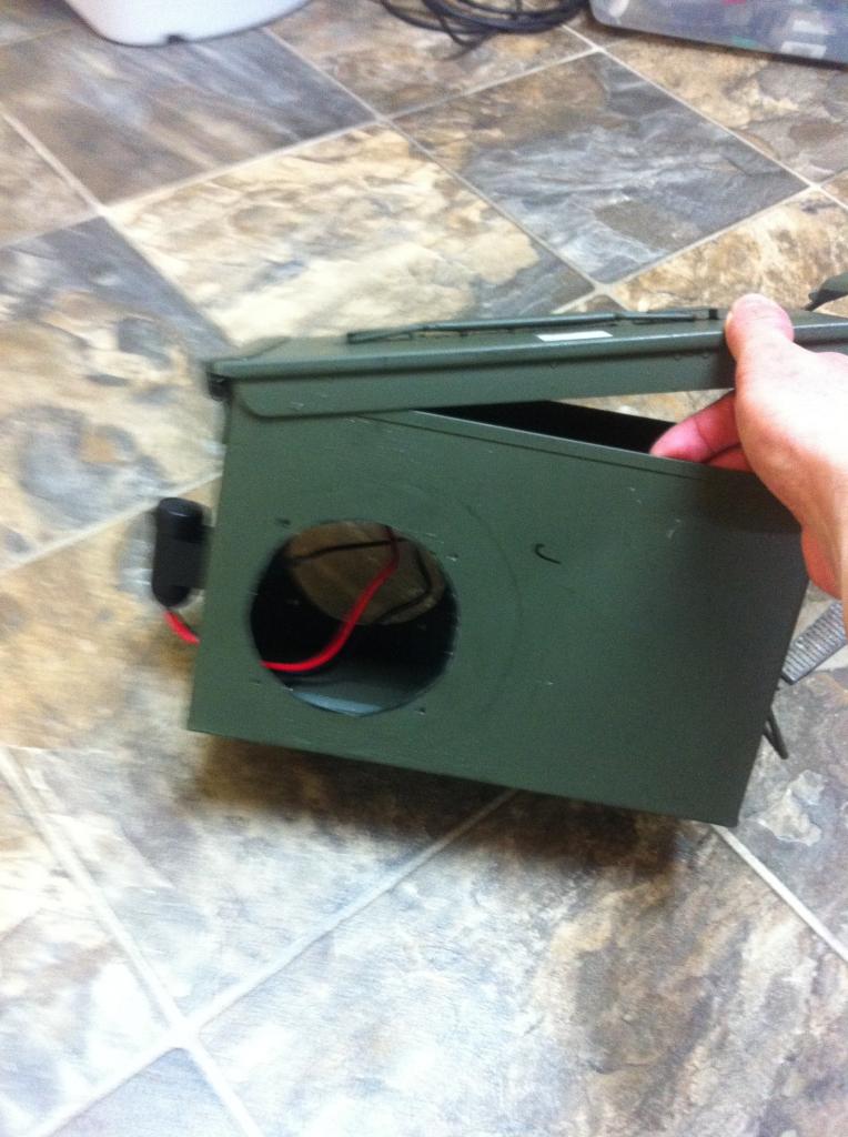

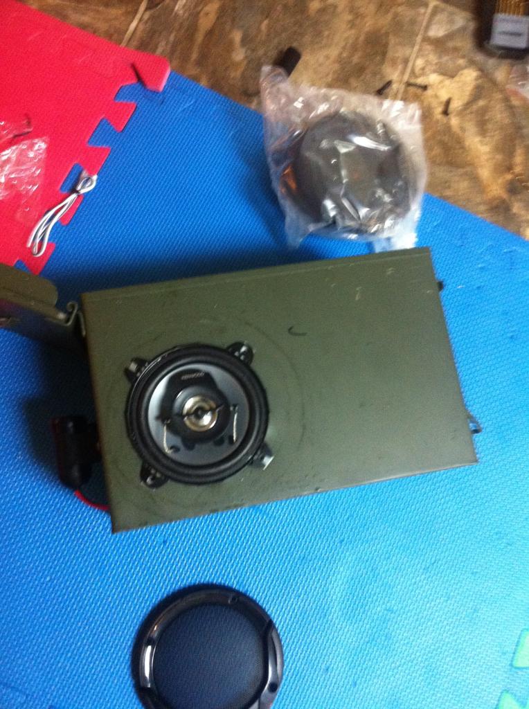

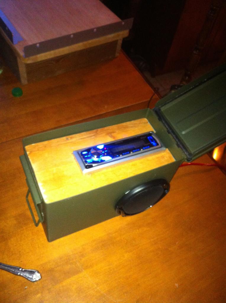

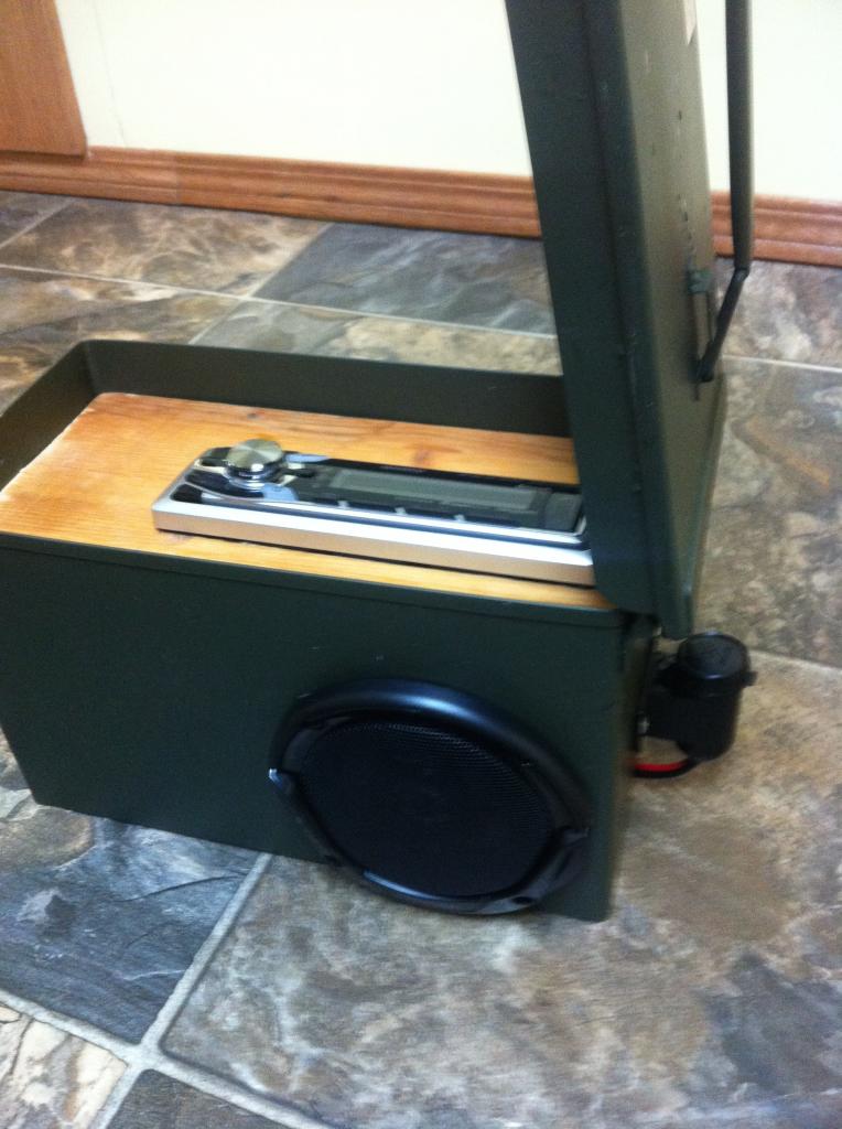

With the dash out already I figured what better time to put the stereo in. Im always a bit reluctant to leave my truck with the half doors and top off in the summer because I dont want my stereo to go missing. This will be the center console and will have a small lock on the front. It wont be unbreakable but it should at least keep the stereo hidden
