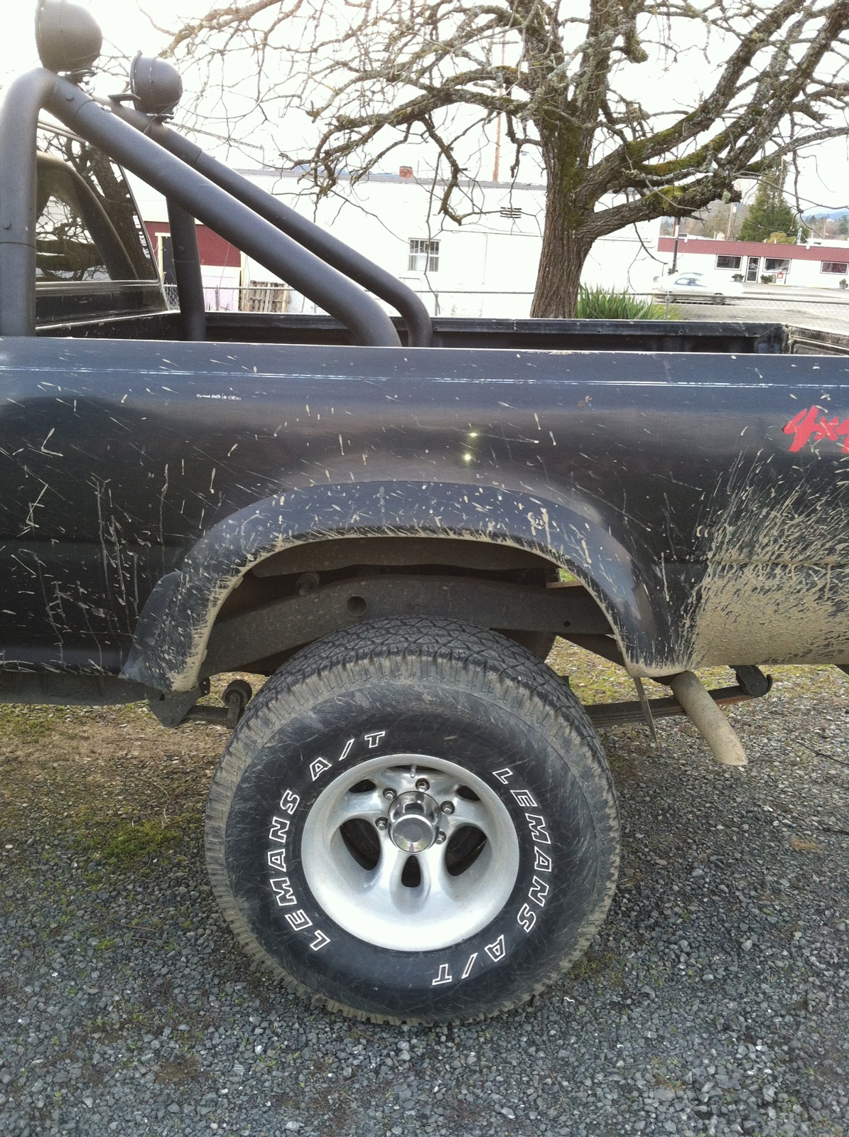

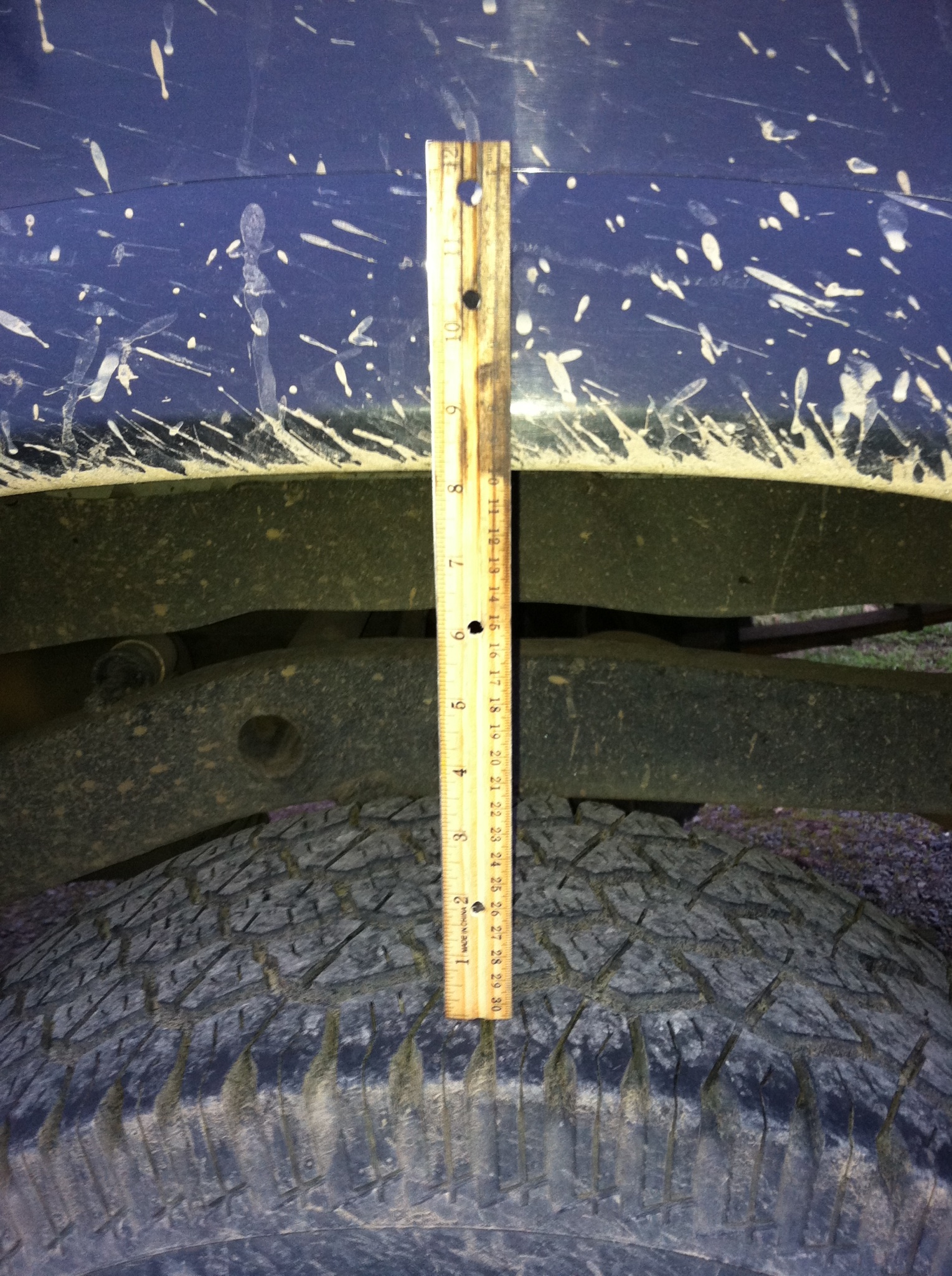

So im getting rid of this god awfull body lift and plan on putting in a real lift. What I want is to see how you guys have lifted your rear suspension and all the possible combos like blocks stacked leafs or shackles. I already have a add a leaf so any suggestions are welcome.

I would keep the add a leaf since you already have it and put a set of BJ spacers on the front.

I plan on doing bj spacers in the front but the rear is already really stiff and rather uncomfortable what I'm worried about is if I just add more leaves will it make it worse. Currently it has a 3 in body lift

depends on what you want to spend, and what you want out of it.
BLOCKS are BAD.
I'm not a huge fan of Bj Spacers either, and the lift gained is not alot.
What are your goals with the truck?

I don't plan on putting Chevy parts on my truck anytime soon. And plans... It's a DD/ wheeler toy but I want to keep the height and have some good flex, and well money is a bit on the tight side

How high are you going?
Blocks are a big no-no regardless.

If money is an issue, don't spend anything on a lift, trim your fenders and drive it!
Blocks cause axle wrap, broken springs, and other badness.
Longer Shackles will get you a bit.

I want to achieve 4 inches of suspension lift plus a smoother ride if I can

4" isn't possible with BJ SPacers, if it is, you'd have to CRANK your torsion bars, which would definately not give you anything resembling a smoother ride.
if you want 4" you've got to be looking at more of a suspension system.
