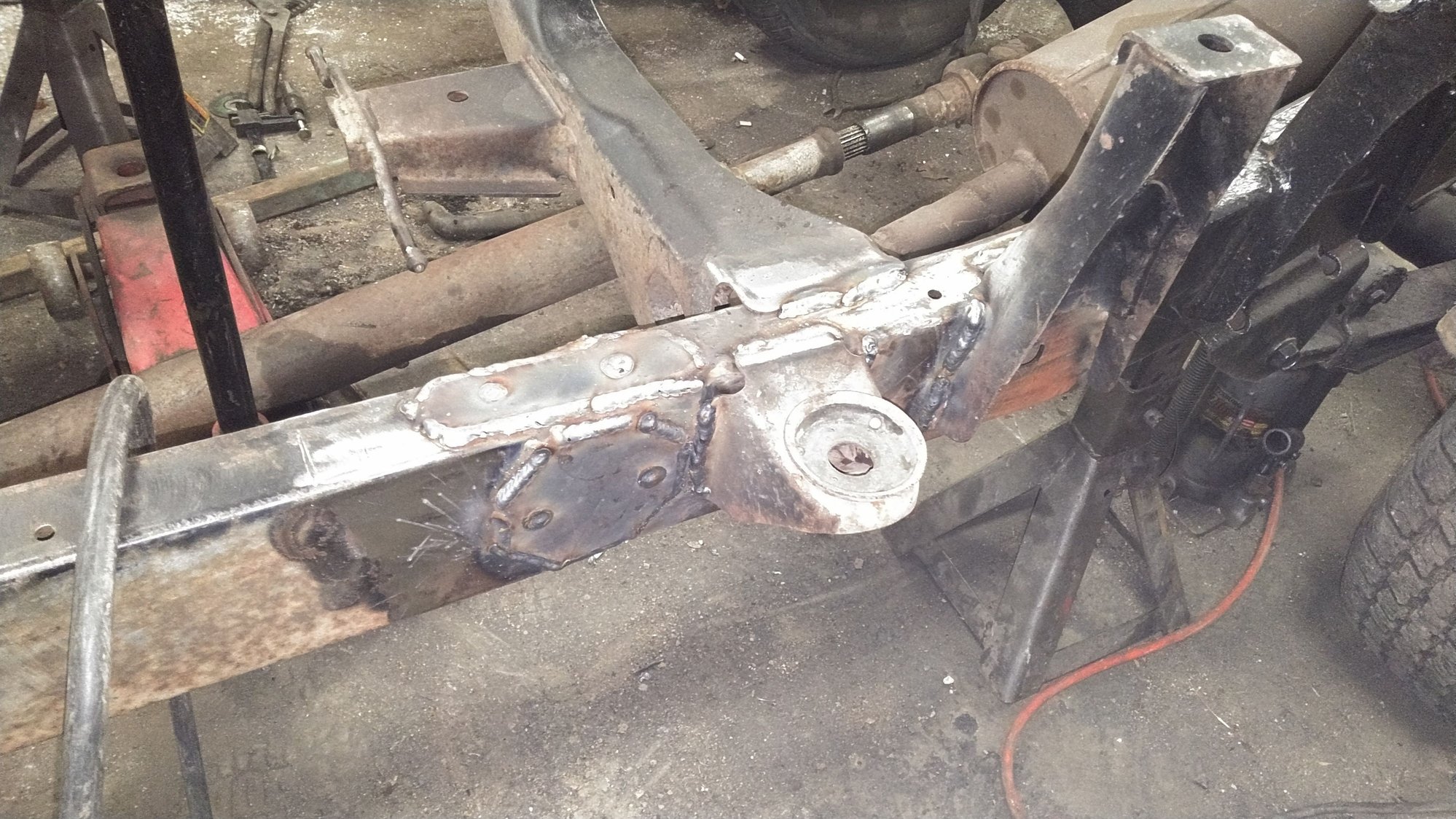

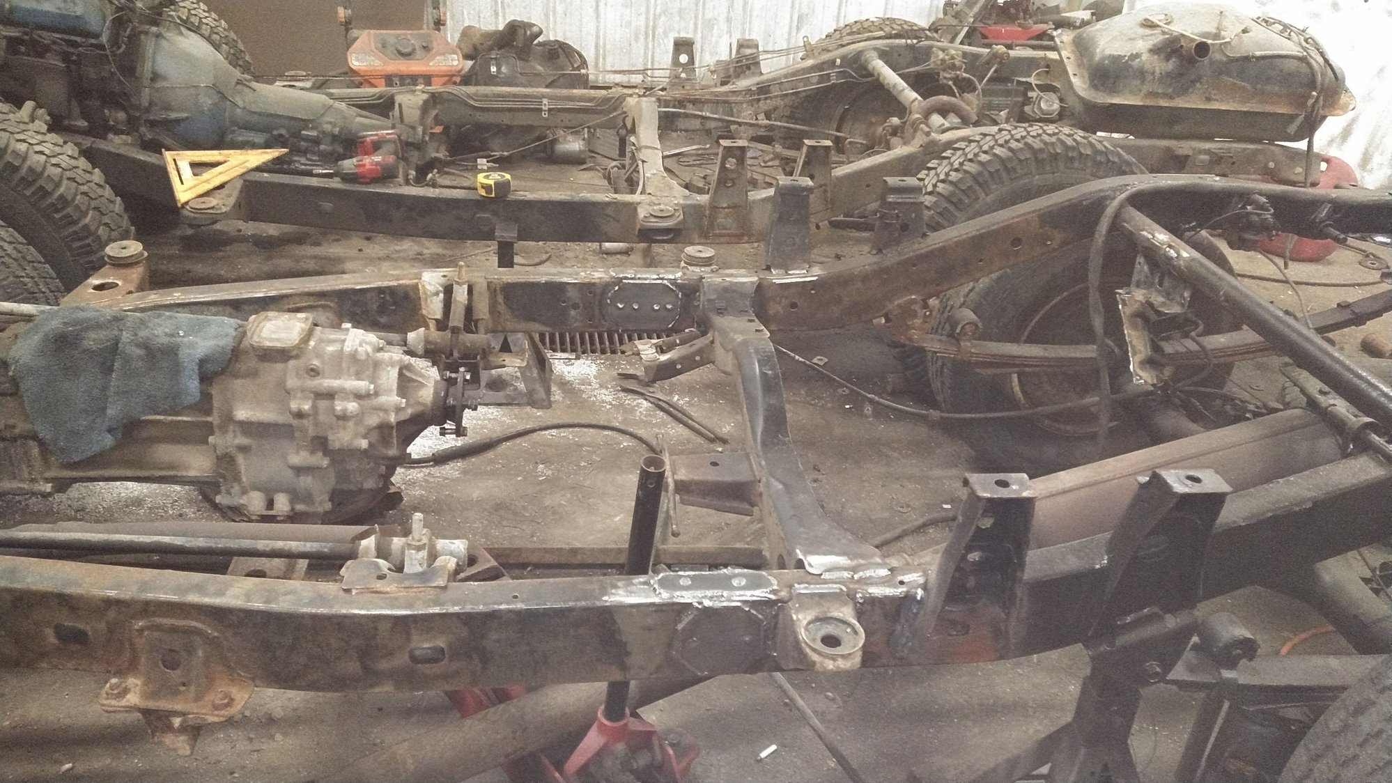

i just did the same thing, 89 swb body on a 86 lwb frame.
my biuld thread https://www.yotatech.com/forums/f199...evival-310300/
there is a pretty straight section of frame under the cab. i took the 9 inches out just ahead of the cab mount. had to cut off the rear cab mount front two bed mounts and the cross member. after shortening the frame weld back on the rear cab mounts move the cross member use the short bed fuel tank and move the front 2 bed mounts rear most bed mounts needed to be re drilled.
whole thing from pulling the donor off the trailer pulling both trucks apart to having a running driving functional truck again was probably about 40 hours worth of work.
